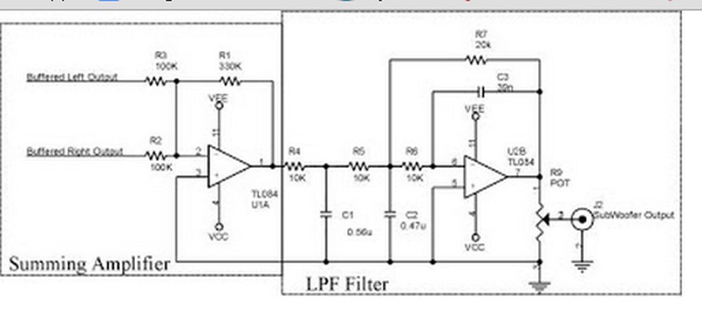

I haven't come across any two input low pass op-amp circuits for the lm358. Some are single input. I'm new to op-amps, so if the chip is similar enough could I just use it instead?
With the single input, is it really an two input and I'm just supposed to know? Or Will one channel work for one sub out?

Maybe this diagram can help you and shed some light on the subject,
http://4.bp.blogspot.com/-X5V5isNLZsA/Ta08HwcyiwI/AAAAAAAAAPI/nS88_C5WMuo/s400/Subwoofer+Channel.JPG
It shows that the First section is a two input mixer (signal summing), and, that stage could actually be not used by feeding each R&L signal through their own series resistor directly into the input of the filter stage.
But, It is common and good practice to use a buffer stage to the input of the filter as it is shown in the diagram.

In that diagram you posted, I could just use a lm358 instead of the chip used? Exactly as shown?
And some schematics have only one input, so I'm a little confused there. Does it only take one input or is there two combined and I'm supposed to know that?
Yes, you can use the 358 just the same.
And then later you can just swap it out for a higher quality opamp at will, if you wish.
If you are only building one sub channel then you should use a two input mixer (summing circuit) to combine the L&R signals as Andrew pointed out.

Thanks I appreciate the help. I will use one lm358 to build the audio mixer. It shows three inputs for the mixer for the second site posted, but I figure two inputs, L and R , should work.

post90 can be simplified.
The first opamp and all it's resistor can be deleted.
Duplicate R5. Each R5 is an input to the inverting opamp that follows.
The output is the SUM of the two input signals times the gain of the stage.
The gain is set by the ratio of R7:R5, i.e. the Output is four times the left channel input = right channel input, or two times the Sum of the L+R input signals.
Make sure that your common Ground between the Two supply's are connect together as well.
Also you should have a DC blocking capacitor on the output of the filter or at least on the input to the amplifier.
If you can, A full schematic of what you have so far would help us a lot as well.
jer 🙂
