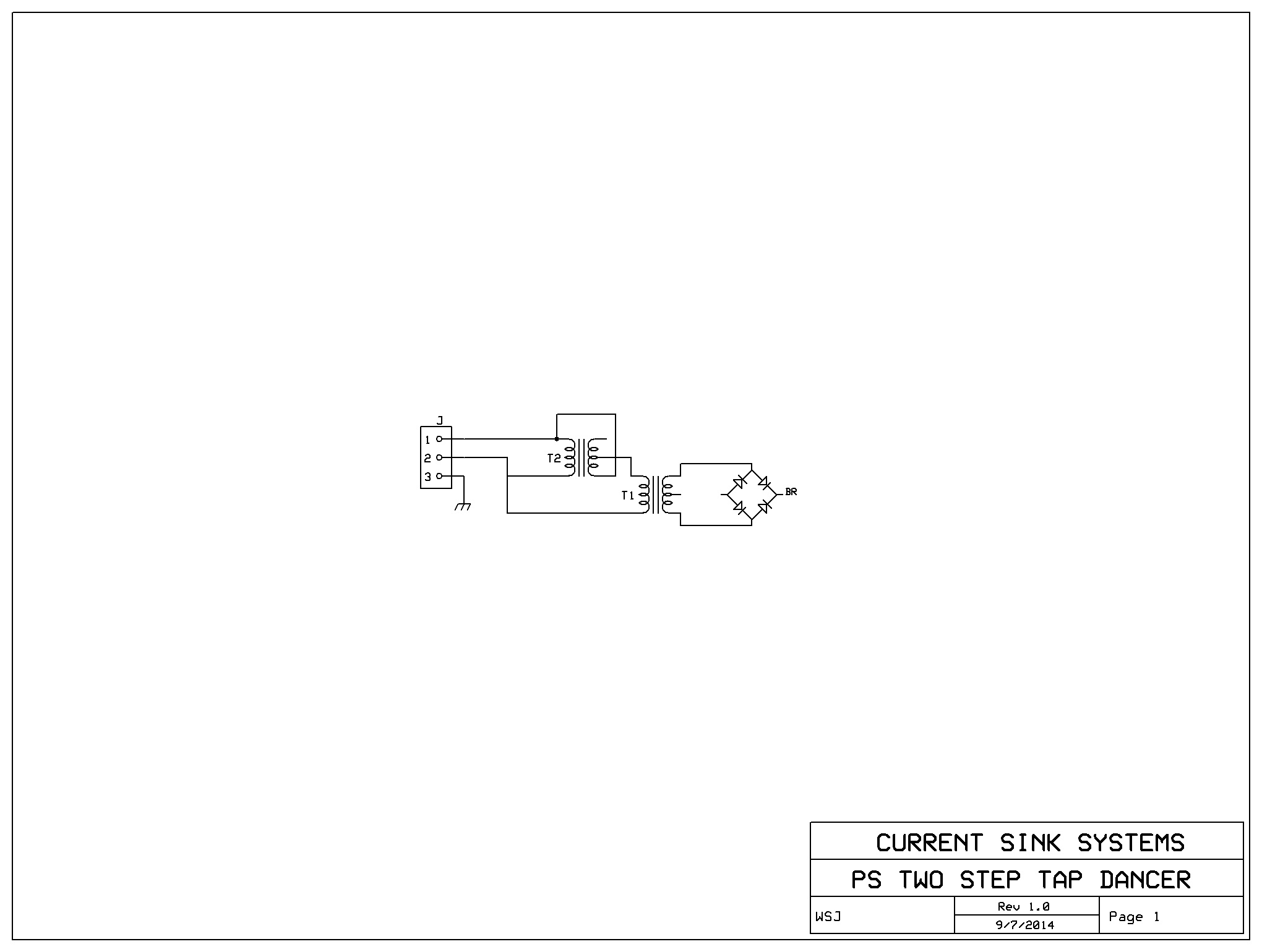

Lower the PS voltage by wiring an out of phase winding of a second transformer in series with the existing primary.

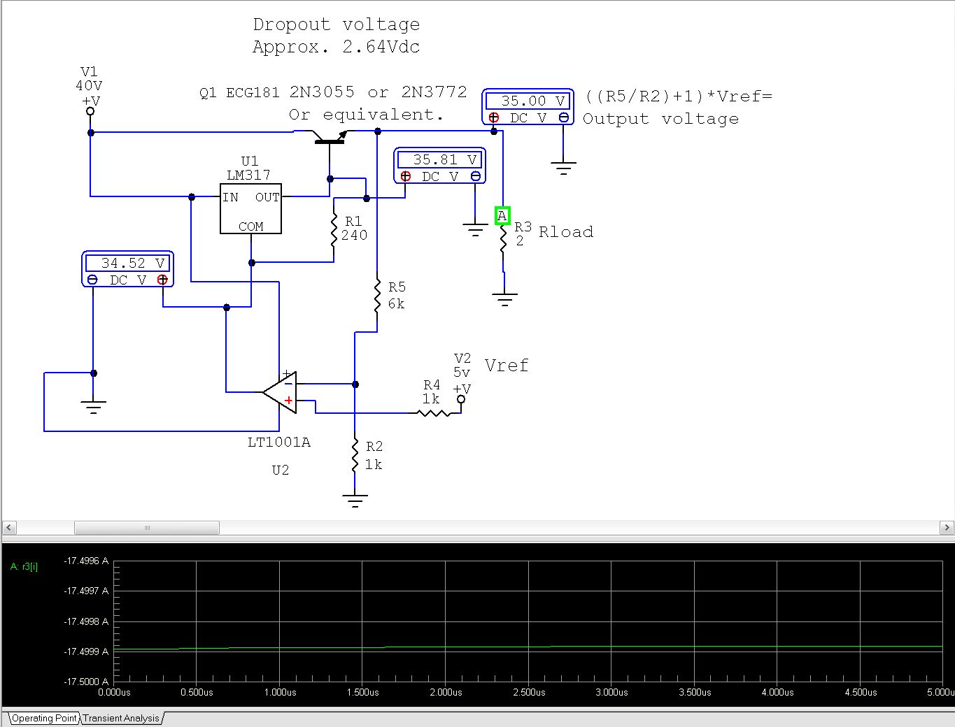

As it turns out for the circuit I posted it is working very well and the LM317 is very stable.
But due to the configuration it is not able to track the output voltage properly and can not self adjust for the slight voltage differences caused by the transistor.
Therefore as mentioned a correction opamp should be employed in order to make the output voltage super stable.
With only 200ma flowing through the LM317 with the transistor connected the dropout voltage is lower as it is supposed to be and it does regulate with in it's .1% load regulation range.
This test was made with the LM317 set at 10V as measured at its output while connected to the base of the transistor and are as follows
LM317 no load 10.03v, 10 ohm load 10.01, 4 ohm load 9.99v
NPN output voltage no load 9.55v, 10 ohm load 9.25v, 4 ohm load 9.02v.
This about 3.14% to 5.55% of load regulation voltage drop for the two test loads respectively.
However it is producing more current and having a lesser amount of voltage droop for a 4 ohm load than was tested with a single LM317 by itself at 10v.
For a 4 ohm load the drop was 8.07v at 1.98A where it brickwalled due to the raised dropout voltage factor from the amount of current being drawn, and the transformer voltage being dragged down.
This 10v setting was chose in order to not drag the transformer to the point of having drop out issues with the LM317.
Adding the transistor does seem to improve this, but it does not show this because it is not able to actually track the output voltage to the load.
I am not sure if adding a simple resistor can correct this but I will try and see if it does.
Meanwhile I will try this configuration next as well and see if matters improve,

I simulated few days ago lm317 vs lm317+transistor. With a simple resistor load the lm317+transitor gives a quite good regulation. But as soon as the load is changing (like at an amp), the regulation is LOT worse then with a simple lm317. And it was only a 100mA load.
You seemed to have missed the whole goal of this thread.
To build a regulator that can drop the OP's 45 volt supply down to a safe level to run his chip amp.
The only linear regulator chip that is available to handle anything above 40v is the LM317HV but it can only handle 1.5 amps.
1.5 amps is not enough to power a chipamp if driven to reasonable level of power.
The LM338 on the DD site is a good choice as a regulator due to its current rating but again it is only good for a maximum input voltage of 40v.
Therefore in order to increase the current rating of the LMx17(HV) series it is possible to use a series pass transistor.
The simplest method is by using a 2N2955 power transistor.
Since they are becoming more rare to find (although not impossible), A more commonly found NPN power transistor can be used instead.
One of he First circuits I found had the lowest parts count by simply adding the transistor.
So, I decided to give it a try and find out exactly how it performs and compare it to that of a single LMx117.
I had already realized that the load regulation may be off due to its configuration as I had explained.
Although my testing voltages are lower at this time the current range is in order and the effects would be the same even if it was running at a higher voltage as needed.
Therefore the drop out voltage at X amount of amperage is what is of concern considering only about 3v to 5v need to be dropped.
As more current is drawn form a LMx17 this dropout voltage becomes greater.
I just happened to be working on this type of circuit at this same time, although my little supply may not a be a very good example.
But I assure you I do have the components to build the same circuit for the higher voltages in order to test it, and that is my plan.
But anyhow, I have just shown what the capabilities are of just using a simple series pass transistor to increase the output current of a LMx117 regulator circuit.
Although its load regulation is not perfect with this configuration, it is enough to drop the OP's voltage down to where it is needed very cheaply and should work with the LM317HV and a 2N3055 or equivalent transistor.
Since I do have these components and plan on testing it out, I am in the very same boat with my 10 35v transformers that I have, and I have been wanting to pursue this for quite some time.
I am sure that you may remember that conversation from a few years ago !! 😉
At a higher voltage of +40V the less than 1V drop error across the transistor will have an even lesser % effect on the load regulation at the 3 to 5 amps of current drawn than what it shows at 10 volt level.
The second circuit I posted is more commonly used and should provide with a better load regulation factor, and I plan on checking it out too.
The second issue was that nowhere in the data sheet does it describe the current limiting factor of the LMx17 and how it is derived.

Here is my variation of the circuit I posted a link to in post #30.
I have this circuit working only I have it on a 25.25V supply as of right now.
By adding a 5Vref (LT1021-5) and an opamp (LT1001) and three resistors, I have solved the load and line regulation issue 's.
I am able to pull 4.44A at any voltage below 14V without any voltage droop what so ever.
This is only limited because of the small transformer that I am currently using.
I have my highest voltage setting set for 24Vdc but as long as the transformer can supply the current in to the load it shows no voltage droop or fluctuations as expected when the load is applied and disconnected repeatedly
I did a simulation of the second circuit I posted in post #34.
It does show good load regulation but fails at line regulation.
If the input voltage fluctuates at all, then the output voltage will as well.
Also the resistors in the series pass transistor section need tweaking in order to get good performance at higher currents.
I am not even going to pursue that circuit as this one is showing me super performance and with less parts.
The LT1021 I am using is good for up to 40Vdc in and the LT1001 is good for up to 44Vdc.
Even though this is less than the OP's target voltage of 45V max there are ways around this by using simple resistor voltage dividers.
One can be used on the Vref LT1021 to lower its input voltage or a simpler Vref can be made as well out of a simple resistor and a zener diode.
I just happened to have an LT1021 in my parts bin and I wanted my bench supply to be very low noise and precision as well as drift free.
For a higher input voltage operation a resistor divider can also be used to raise the V- pin of the opamp higher above ground as well.
This will satisfy the 44v power supply maximum of the LT1001 too.
Or you can use a higher voltage type opamp such as the LTC2057HV, LTC6090 or Analog Devices ADA4700-1.
Whatever opamp you do choose to use keep in mind that most opamp's cannot go fully to the rail and this could limit your highest (and lowest) voltage settings.
Especially if this factor is more than the dropout voltage of the regulator circuit.
Depending on the conditions this shouldn't be to much of an issue, but do try to use a Rail to rail type for the widest rage if it is to be adjustable.
As it is it, currently it only goes as low as 1.55v.
Going down to 0V output will require using a true V- on the opamp of at least -2 to -5v below ground.
This is technique is explained in the LMx17 datasheet and app. notes.
Originally I was getting as low .825v out of it, but again it is higher now because the LT1001 is not a Rail to Rail type of opamp and cannot get any lower than it does.
This part of its performance was even worse when I swapped the LT1001 out for a LT1007 type as well.
I will be employing this technique in my bench supply version so that it does go all of the way to 0v, as it will produce 4.44A even at 1.5v!!
But, It is not actually necessary for this particular application.
The circuit I am presenting here, I have running.
I will show a final version for the OP's projected input voltage 45Vdc as the transformers that I have are 35Vac types and produce 49.5Vdc and will satisfy the OP's requirements.
This a great little circuit and it has cost me nothing to build as all of the parts came out of my junk bin pretty much except for the LT1001 and LT1021 that I got as samples from LT.
Cheers !!
jer 🙂
