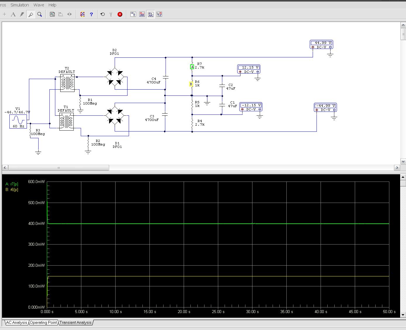

If you are just using a few opamp's in your circuit then you can use a simple resistor divider to get V/2 for the virtual ground.
But if you are using a whole lot of opamp stages then you need to have a low impedance virtual ground system.
This is best accomplished using a unity gain buffer opamp to supply the virtual ground line.
Or, you can reduce value of the resistors of the V/2 divider to allow more current flow. But, this unnecessarily eats power and raises the wattage rating requirement of the resistors.
Since you already have a Bipolar Supply configuration just adding the proper regulators will work the best and solve all of the issues of even having to have a virtual ground system at all, and all of the grounds will be common to the ground system as a whole.
There are certain rules you must follow when mixing the topology of both systems together and they are explained in some of those threads.
If you don't have the regulators you can also use a resistor voltage divider to drop the voltage on each half (+ and -) of your power supply to feed the opamp's +/- Vpins as well.
Opamps require only a small amount of current, so the resistors not need to be any low value and/or high wattage rating.
For instance, If your supply is at 45V as discussed earlier in this thread then you could use a 4.7k and a 1k resistors and this would drop the voltage to approximately 9.57V and they would only have to be 1/2watt types.
The actual power dissipation of the 4.7k resistor will be about .267 watts (267 milliwatt's) or so, and if you use 1/4 watt types they would be marginal and may eventually burn up and fail if used.
You would do this for both V+ and V- with the 1k connected to the ground bus.
These values will allow for about 7.538ma of current to feed the opamp with and this should be enough for your application.
You can also use a 3.3K instead a 4.7k and this will allow up to 9.5ma to supply the opamp and it will also raise the voltage to a nicer 13.63V range as well, But you must still use at least 1/2 watt types as the power dissipation will now be about .2982 (298.2 milliwatt's) for the 3.3k resistor.
You could also maybe use a 2.7k instead this would bring you to +/- 16.66v and a little more current for the opamp at 10.49ma. providing that your opamp can handle the voltage.
This is not a problem for the TL07x's but it may be just over the limit for a LM324 I will check the data sheet.
Yes, it is just over the limit for the LM324 as it is rated for 32V max, you can do the diode trick if you wish as well here, But there is no reason to need that much supply voltage for your application so stick with the 3.3k and 1k resistors with this method.

I screwed up on my Voltage Divider calculation's and I do apologize for that.
I was doing it quickly in my head and I used the wrong formula.
Do use a 2.7K and a 1K for your divider.
Here is the simulation I created to show the basic setup in circuit maker.
Ignore the values feeding the transformer as i didn't have the time to tweek those exactly as it was driven from the wall socket.
The output voltages are set exactly as you had described at 45v for the chipamp's.
I did not include the diodes or whatever you are using to drop that voltage for them.
The voltage out of the dividers are at +/- 12.15V for the opamp's and is sufficient to run them.

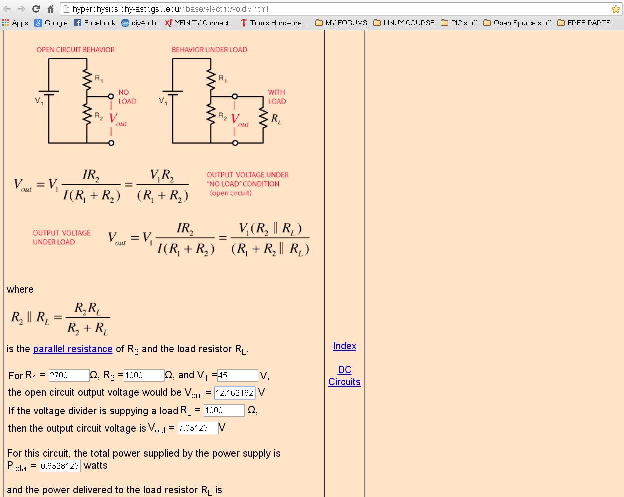

Do to my previous error I also check the simulation with a Voltage diivider Calculator just to be sure that it is correct , and it is.
Voltage Divider
The voltages are displayed in the meters, and, The Power Dissipation for the resistors is shown in the graph to be 400mw for the 2.7k resistor and 150mw for the 1k resistor.
The 100meg resistors are only there to make the simulation work in Circuitmaker 2000 and all of the ground points are referenced as a common ground.
This will end your virtual ground issue as this is the proper way to set up your power supply for your application without having to using regulators.
It also provides plenty of headroom for any line voltage fluctuations as well.
Cheers!!!
jer 🙂
