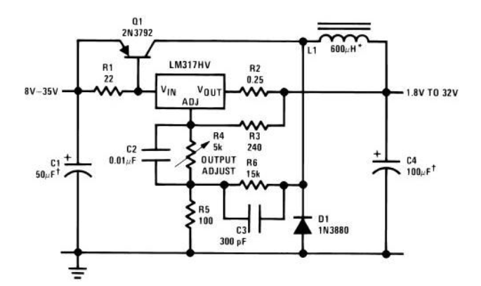

I've never seen an LM317 oscillate, but I've seen them ring and have poor settling time.
Is it possible to make one oscillate? I'm not convinced either way, but it's not necessary for a reg to actually oscillate, in order to generate spurious. The regulator is getting current impulses on every zero crossing in a class B system.

This circuit appears in the Nat Semi Power Management Handbook, but I picked it off a website. If you look at the impedance curve of an LM317 without any output cap you'll see it has a high-Q peak:
Nobody is advocating zero output capacitance, at the very least there are normally several 100n's distributed around the regulated rail.
To a first approximation you can regard the output of a regulator (almost any series regulator) as consisting of:
a DC voltage source
a noise voltage source (mix of white noise and ripple etc.)
a series inductance (possibly with a resistor across it)
a series resistance
Add a capacitor to this and you have a low pass filter, but potentially one with a high peak near the corner frequency. The peak is a peak in both noise and output impedance. You get to choose where in the spectrum you want this peak to be.

by eliminating the capacitor on the output they have exploited the impedance peak in the LM317 to use it as an SMPS controller. You mentioned that you had not seen an LM317 oscillate. under these conditions it oscillates purposefully.
