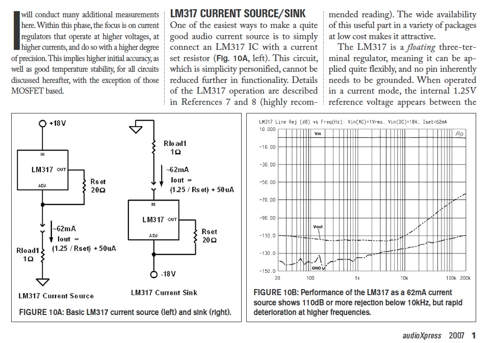

That does not look like a voltage reference, does it?
< Lt3042_DH44 | Low noise regulator consisting of LT3042 and D… | Flickr >
When I read things a DIY audio I strongly doubt most measure the things they talk about. Getting even a LM317 to work as well as it can takes lots of experiment. Often the PCB one tries to make is harder than a Dead Bug circuit.

When I get back to the lab will show some more experiments with the LM317 -- just don't have the graphs on this laptop.
One way in which too much capacitance can screw up an LM317 is in an attempt to knock down noise through bypassing the ADJ pin -- this results in poor transient performance. TI pointed this out in response to a Nat Semi application note many years ago. Only important for those interested in straightening pins.
No not really. The message in this thread is read the data sheet, and have good reasons for deviating from the suggested circuits. A bigger cap does NOT make everything that much better.When I read things a DIY audio I strongly doubt most measure the things they talk about. Getting even a LM317 to work as well as it can takes lots of experiment. Often the PCB one tries to make is harder than a Dead Bug circuit.

It would be really interesting if one of y'all with access to them $5,000 analyzers would test the little $10 regulator (LM317 / LM337 +/-1.5V~37V Adjustable Dual Voltage Regulator Power Board | eBay) and report the results!I measured the impedance peak of the LM317 (using Bode 100), without any load or output cap at ~33kHz -- the feedback gives it that little push into excitation 15k||300p.

I think a test gig is required,:It would be really interesting if one of y'all with access to them $5,000 analyzers would test the little $10 regulator (LM317 / LM337 +/-1.5V~37V Adjustable Dual Voltage Regulator Power Board | eBay) and report the results!
A high quality op amp fed by the PS on test.

For a test rig I would say a dynamic range of 136 db or better with at least 1 MHz bandwidth. Here is a very cheap device that used along with a lets say 10 MHz scope could give insights. I used the older version of the Velleman 8 bit scope ( 16 MHz dual ). It could if measuring a reasonably perfected design give enough date. Where it would loose out would be trying to show something in the noise floor against the original signal. Even that can be done if the set up is stable. The Velleman is about £25. To blow it up is 2 x KFC big buckets. I think I will buy one.
Send one to me and I will be happy to run it through its paces.
