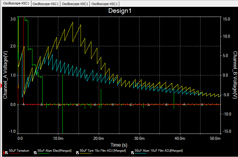

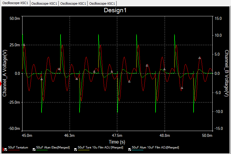

Just some simulations -- will follow up on the bench --
pumped the LM317 10mA to 50mA, a 50uF 1uΩ ESR and 50uF 1Ω ESR output capacitor.
same with 10uF low ESR cap switched on and off the ADJ pin
