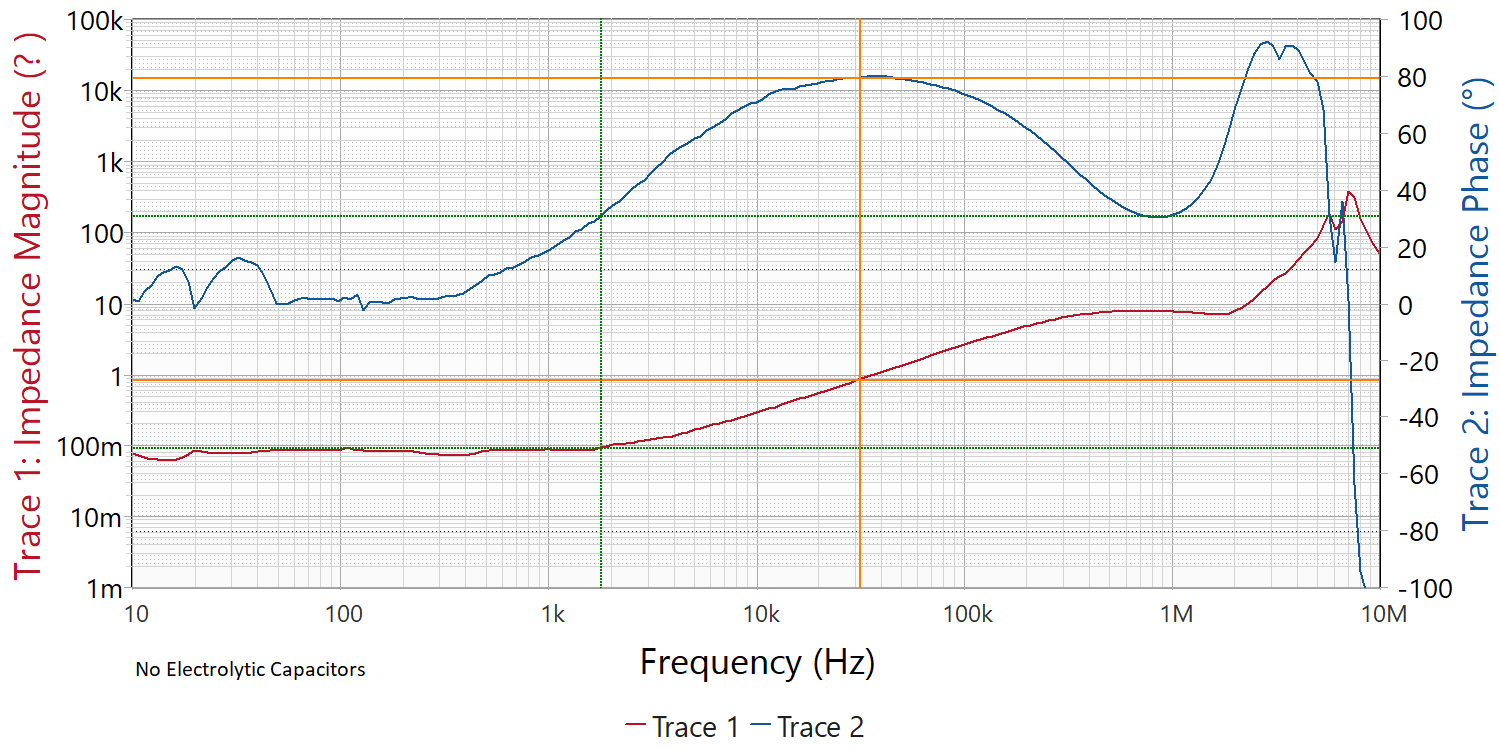

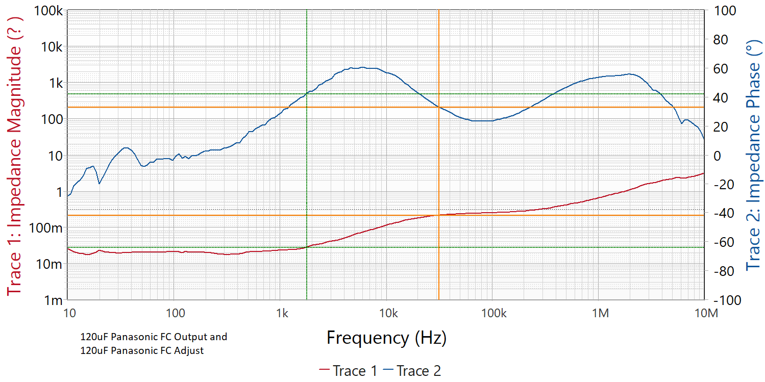

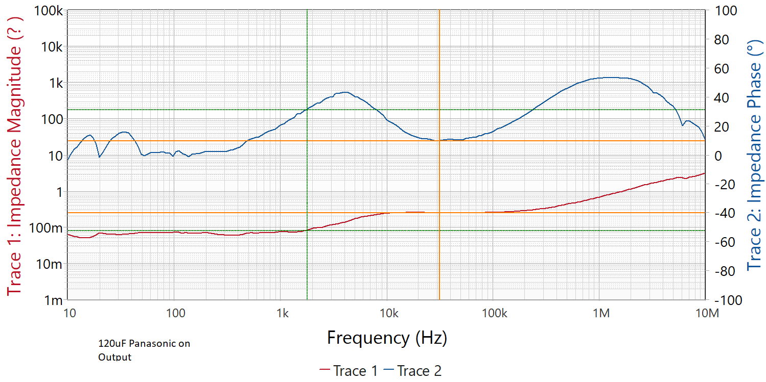

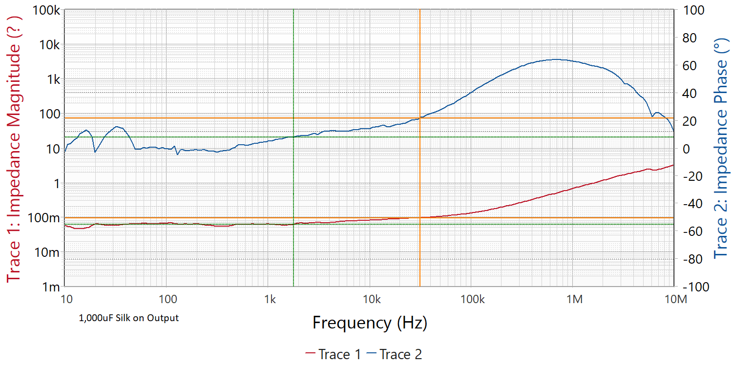

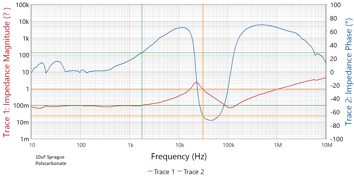

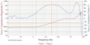

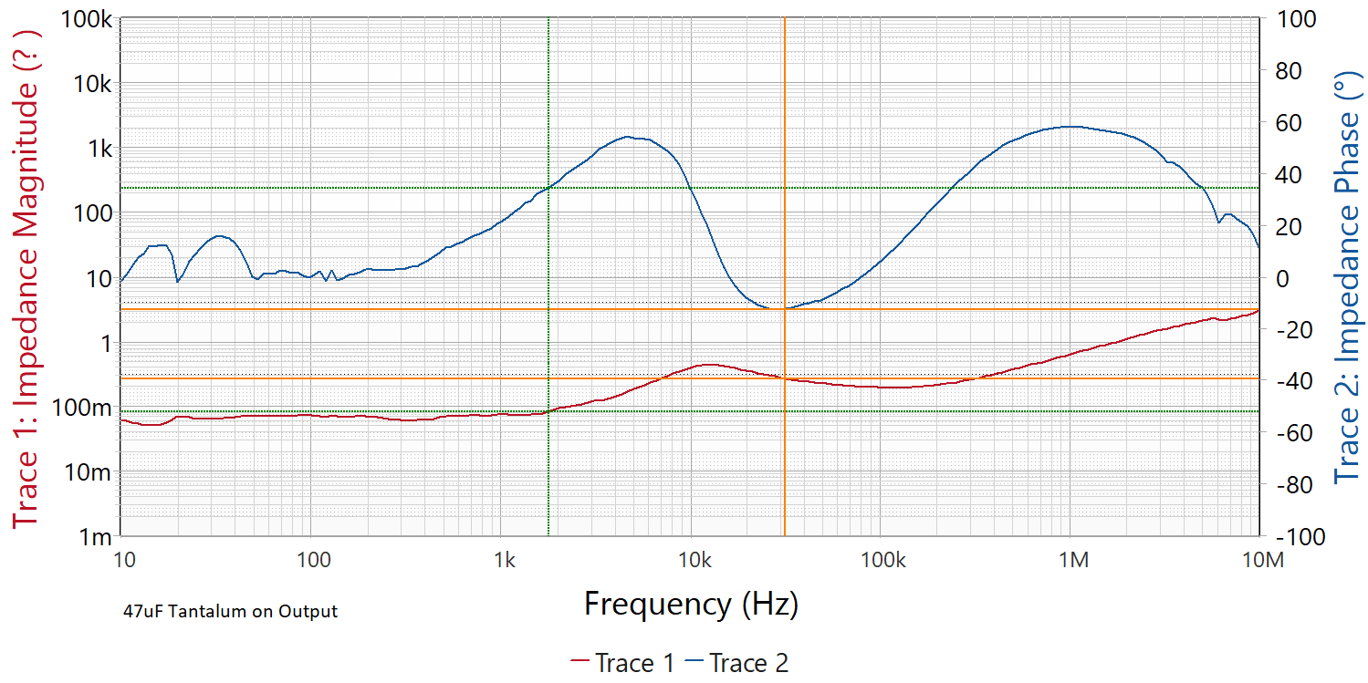

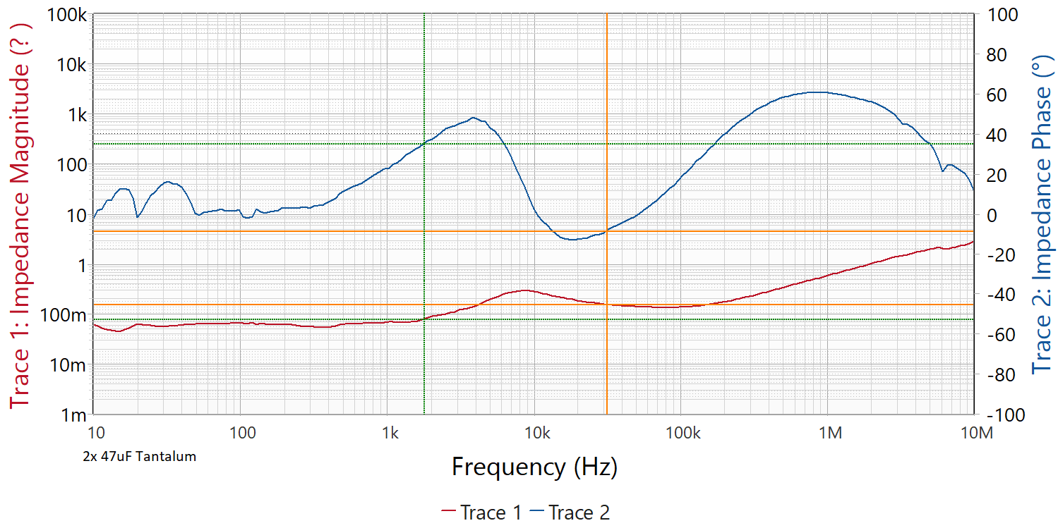

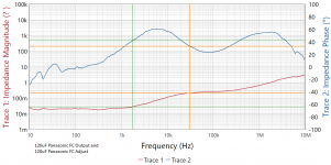

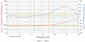

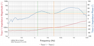

Some impedance and phase graphs:
VERY cool! Thank you! Now, how 'bout noise/ripple graphs with the same combinations?Some impedance and phase graphs:
