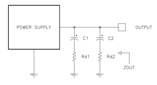

Biggest cap is not the solution, right cap is...that's what's described in this interesting paper
I read the paper few times, indeed very interesting. But I find it hard to implemented numbers on the charts. What would be your practical suggestion for C1/Rd1, C2/Rd2 on LM317 application to lower high frequency impedance?
The Rd's are the dissipation losses of the capacitors, modeled as resistance which are a function of frequency.I read the paper few times, indeed very interesting. But I find it hard to implemented numbers on the charts. What would be your practical suggestion for C1/Rd1, C2/Rd2 on LM317 application to lower high frequency impedance?
Depending on what you mean by 'high frequency' to get low impedance I would add some ceramic capacitors for MHz or perhaps smaller electrolytics for high kHz. You may want these close to the load rather than the reg.
Thank you for your answer, I'm talking about this paper
http://www.diyaudio.com/forums/atta...r-supply-frequency-impedance-improvements-pdf
In it, it said 3 terminal regulator's output impedance you can simplified to some RL, R network, that's why when the output capacitor's esr is too small it will cause ringing or oscillation.
I don't really understand how to do the calculation for choosing right output capacitor according to the article, so the Rd in this case, could be the esr or extra resistor added.
One simple question, If I put decouple capacitor in op amp, then I don't need any output capacitor from LM317 if the distance is close enough, is that what you mean?
