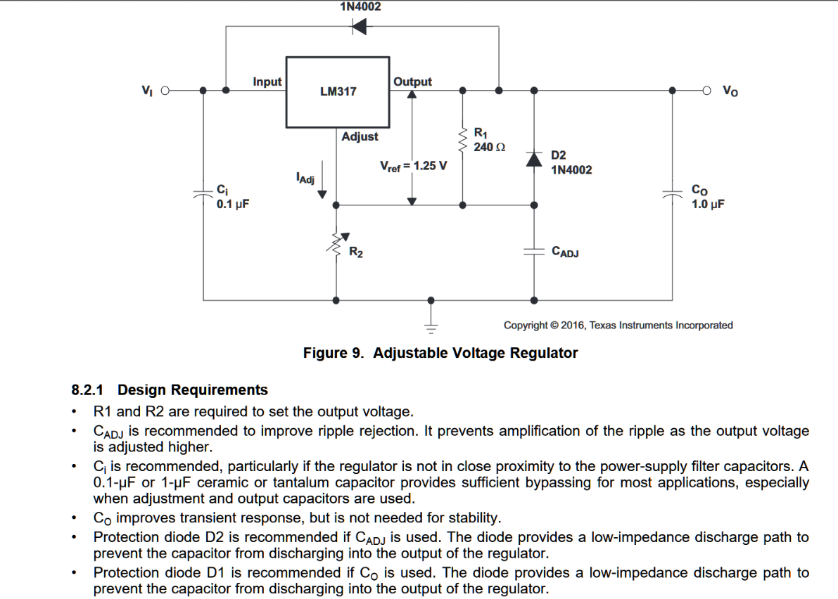

Try Cadj and Co = 10uF solid tantalum. Both close to the LM317.I don't really understand how to do the calculation for choosing right output capacitor according to the article, so the Rd in this case, could be the esr or extra resistor added.
Excerpt from TI datasheet attached.

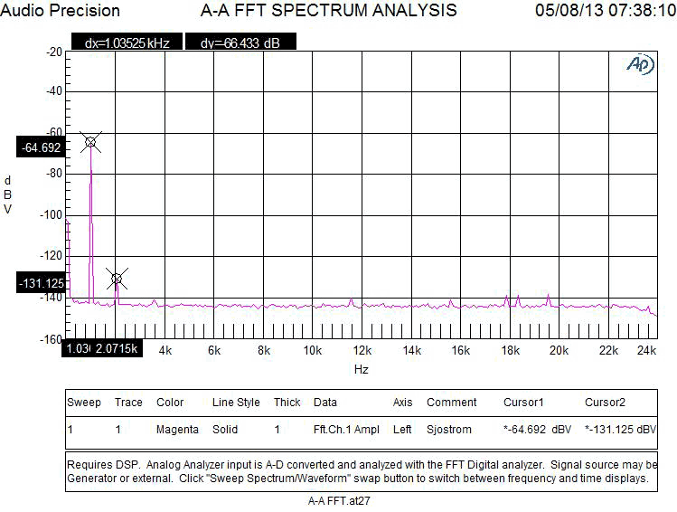

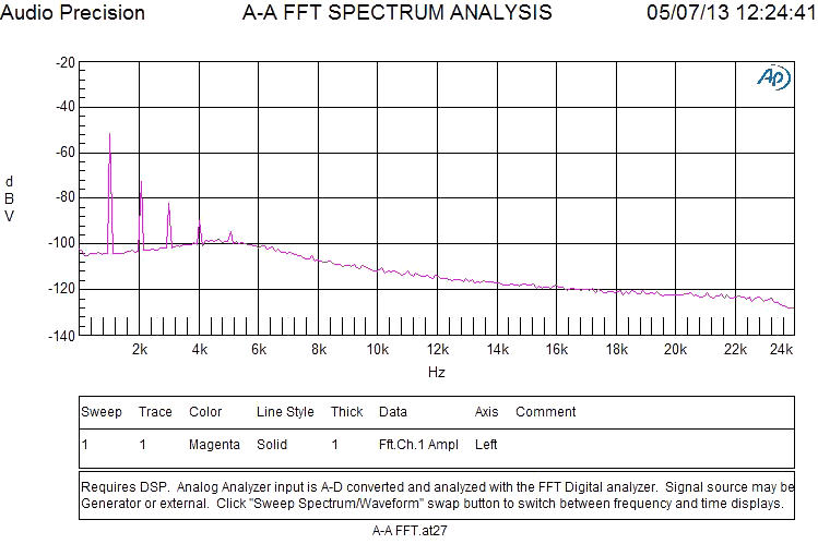

And here is the result of a signal impressed on the power supply rail -- instead of looking at PSRR (signal impressed on the supply to the regulator) look at how the regulator propagates problems.
First the LM317, second the LT1963A, third Per's SJOSTROM:

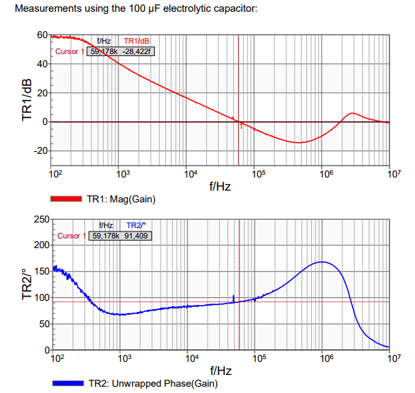

I guess I need to spell this out. The comparison you are making is not valid because one graph applies to a system with higher order than the other and so the phase difference is explained by this rather than capacitor type.Omicron Lab Application Note on Regulator Stability -- 100uF Tantalum vs 100uF Aluminum Electrolytic -- you can see that the phase margin is inadequate using the tantalum:
Check the application note in case you mixed something up.
Doesn't look too clever at 8MHz with the electrolytic either.Omicron Lab Application Note on Regulator Stability -- 100uF Tantalum vs 100uF Aluminum Electrolytic -- you can see that the phase margin is inadequate using the tantalum:
The LM317 is not intended to be loaded with big caps.
Big caps which don't look so capacitative at higher frequencies might be a slightly less bad idea.
Generally, why would anyone think it's going to be a good idea to make the load capacitance 100 times what the datasheet suggests?
I see 90 degrees of phase margin. What's the problem?Doesn't look too clever at 8MHz with the electrolytic either.
Why do you say that?The LM317 is not intended to be loaded with big caps.
TI claims the LM317 is unconditionally stable and it contains sophisticated self-protection circuits. So it can be used for a wide diversity of loads. Why not a big cap? In what sense is it a bad idea to use a large capacitor load?Generally, why would anyone think it's going to be a good idea to make the load capacitance 100 times what the datasheet suggests?
