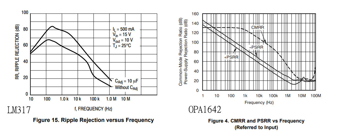

I should have met a wise man earlier. My application is simple, just op amp for tiny amp. Ripple is the least of my concern. Bcs op amp has very high PSRR to filter it again. But as frequency rise, performance decrease. CRC can handle it I guess. Another concern will be output impedance.

What are your concerns? PSRR due to limited negative feedback is common, luckily it still remains good where RLC filtering does not.

Remember the negative and positive rails on op-amps have different PSRR as do LM337 from the 317.
Originally I was thinking main power harmonics and switching power of laptop will have effect on main power. when frequency is higher above 10khz, it will be more difficult for 3-T regulator and op amp to handle. but I read this thread carefully again, RCL filter will be a good fix.

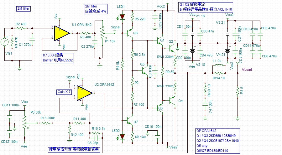

So I don't need to do that? Normally I just short LM317, LM337's Radj GND together, and connect it to star ground. With my new project, I use op amp + buffer. Load is extremely light, with opa1642, only Iq *2 (1.8mA)+ output current in uA range.
http://www.diyaudio.com/forums/attachments/chip-amps/640406d1508104694-project-cute-16w-cute16-jpg
Another silly question, load GND on opa amp is the input gnd, feedback gnd, output gnd, is that correct? So I shouldn't connect decouple capacitor gnd to LM317, LM337 0V.
