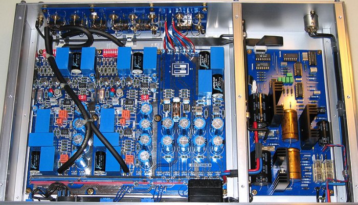

What do they power with this PS ?By the way,

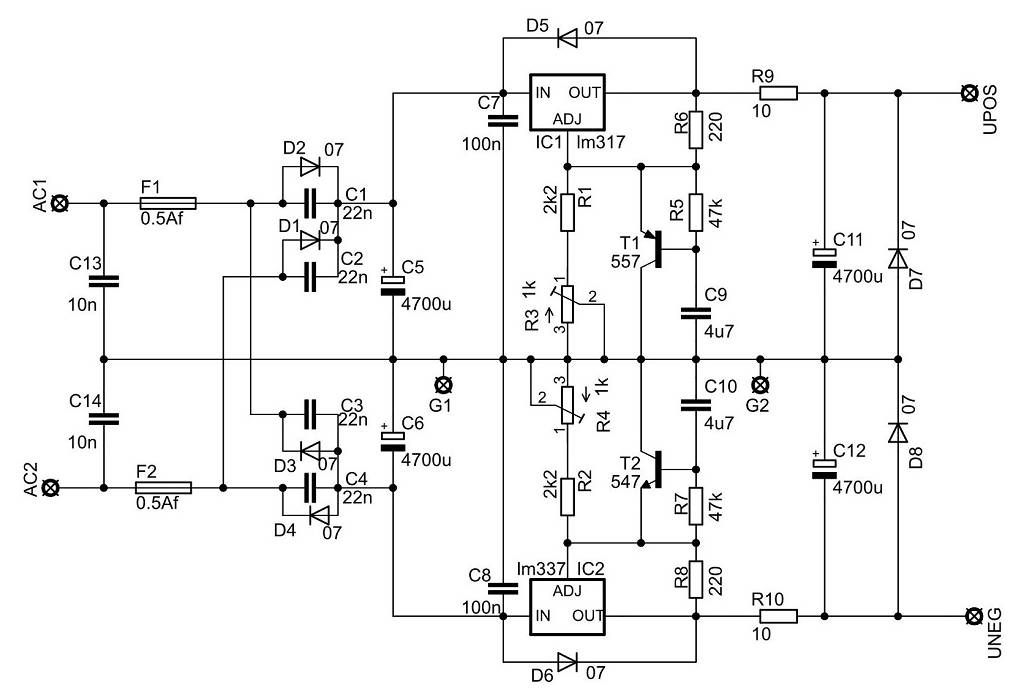

what about this Elektor-approach?
It was provided for "THE PREAMP", 1986.
There is a big capacitor after the Regulator and a 10Ohm series resistor.
(redrawn by me)
What output current ?
The added 4700 uF can improve ripple ( cut off frequency is 3.5 Hz )
The added 10 Ohm ruins load regulation ( 10 Ohm )
The added transistors and associated rc are for a soft start.
As I wrote: "THE PREAMP", from 1986What do they power with this PS ?
take a google search: "elektor preamp 1986"
here you can see a pic:
http://www.analog-forum.de/wbboard/gallery/userImages/71/1160-7196dac4.jpg
don't know, I don't have this device, only the magazine, in which the building instructions were published.What output current ?
Right.The added 10 Ohm ruins load regulation ( 10 Ohm ) The added transistors and associated rc are for a soft start.
For a (other) preamplifier I built a PS like this with a modification. Line- / phono stages with largely constant current are fed by the "UPOS / UNEG", as indicated in the shown circuit. For other components that produce more and more variable current (relay, control lamps, etc.), I have provided further connections before the 10Ohm resistance.
Ok, this is as I suspected.
This regulated PS is used by some parts as a normal regulated PS from the LM317/LM337 outputs.
Then the 10 Ohm 4700 uF add on is to feed some other parts.
Your "redraw" is misleading.
