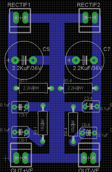

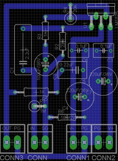

New Board
Hi
I am resurrecting this thread. I am about to make a LM1875 based amp and have prepared board for Amp & Power Supply. I will be trying to make my own boards (for the first time) with toner transfer and Ferric Cloride etching method. Attaching my drawings for Amp board and Power Supply
Any comments/ suggestions to improve the board or etching process is welcome.
PS: I am not an engineer by training so there may be more errors in the PCB
Yatin
you have split your signal ground.
R2 goes to a different point from R1 (22k)
R5 goes to a different point from R1
C1 the DC blocking cap is on the wrong side of R2
There is no DC blocking cap on the NFB loop.
There is no RF attenuation on the input
You do not need 2 Power Grounds. One triplet twisted cable from PSU to AMP is good enough.
The speaker output is miss-wired.
I recommend that all your capacitor locations have at least two pin pitch options.

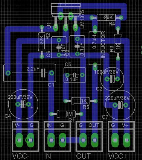

New Board
Thanks Andrew
I have redone the board, I am using the typical application schematic in LM1875 datasheet with different values for capacitors and feedback. Only thing I added new is Inductor at output as I intend to use it as surround amp which will have long cable.
not understood can you please elaborate as to where this should be ?
not understood can you please elaborate as to where and what this should be ?
Just made them so as to fix the connectors, are they harmful ? should I remove them ?
Hope I did them right this time around.
Thanks again for your valuable time
Regards
Yatin
your first layout was better. V+ PG V- all in one 3way terminal block.
input signal hot and signal ground together and away from Power and speaker = good.
Just sort out the three signal grounds.
Put in the DC blocking capacitors that limit bandwidth and protect speakers.
Put in the missing RF filter.
Remove the output inductor.

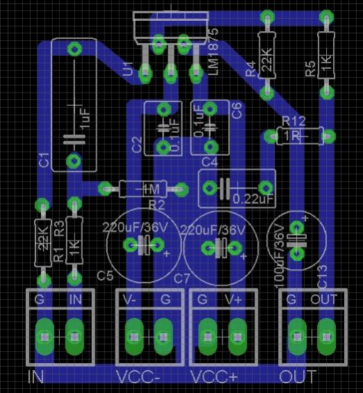

New Board
Thanks Andrew
I am attaching the latest board.
still not followed
"Put in the DC blocking capacitors that limit bandwidth and protect speakers.
Put in the missing RF filter."
Is there any schematic with the above 2 points which I can use ?
Yatin
you have fitted the two DC blocking capacitors (C1 & C2) to give you an AC coupled amplifier. This will protect the speaker from a faulty source.
National's datasheet shows an RF filter on the input.
It consists of just two components. A capacitor and a resistor. 1k0 & 680pF work for most builders, but you will find a wide range of values used by other builders. Your other post of the 3886 shows R11 & C9. What do these do?
The two 100nF decoupling caps are getting a bit far from the power pins.
I wonder if you could improve the layout (and save PCB area) if you bring the output down the right hand side?
Allow multi pin pitch for all your capacitors.
Widen the power rail and output traces and the pads.
Check your Zobel values. 1k0 (R5) & 220nF (C7?)

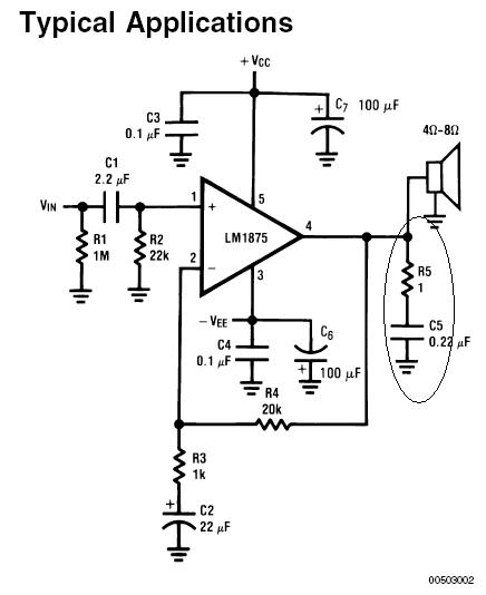

New Board
Thanks Andrew
I am trying to make another PCB with your suggestions incorporated.
When you mean RF filter at Input, does it mean something like attached ?, I will be using 22K pot on the input for volume control, do you still fill RC filter of 1K0 & 680pF is necessary, if yes I will change the PCB accordingly.
Zobel values of 1K0 & 0.22uF are as per typical application in datasheet, do you suggest alternate values ?
Thanks for helping
Yatin
New Board
Thanks Andrew

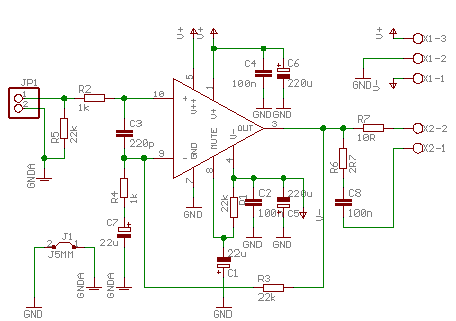

When you say RF filter at the input, what should be the corner freqency ? the config in the picture 680R x 470pF gives a freqency of 500,000Hz (1/2xPix680x470/10^-12)
Frankly the 1K0 & 220pF are copied from the attached scematic, I have read somewhere that they act as RF filter to cut out hum and switching clicks from the other appliances which may be connected on the same electrical connection as the Amp.
Thanks again for your time, I am still on learning curve, not being an engineer makes it still steaper !!!!!
Regards
Yatin
we are getting there.
Now add the High pass filter at the input.
This will convert the amplifier to AC coupled.
I like the differentiation between GNDa and GND.
What about the speaker return?
I would expect pin5 to require decoupling.
National do not expressly say which or if both supplies need decoupling.

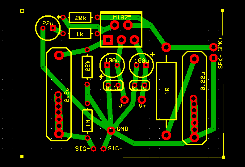

Hey all! In this rainy day I have made a PCB too! 🙂
Feel free to comment! Cheers!
By the 1R resistor for speaker zobel, you've called for a series capacitor with high internal loss, which is a polyester dip cap. That is the intention of National Semiconductor as that is the typical cap for this role. The pin spacing for speaker zobel capacitor doesn't fit. The capacitor isn't that big.
Alternatively, you could go about 4 ohms for speaker zobel, which allows a wide varieity of caps for speaker zobel. However, the size of that 220nF cap will be the exact same size pin spacing as your 100nF caps.
The zobel is in place, but the other half of the thile-small speaker output filter seems to be missing (a small easy inductor and a 3w resistor, typically seen on discrete solid state amplifiers). Omission may slightly raise the idle operating temperature of the amplifier. You might want to check and see if there's an energy consumption difference (heatsink temp difference) at idle.
The 1k series to 22uF is a bass blocker and if you intend to allow low bass to have normal gain (and the midrange to have a normal proportion) then perhaps you would enjoy a larger size cap. Currently, the board's listed values will make the voice band louder than expected, which is very popular for television amplifiers.
A 100uF (and much larger) NFB cap is workable to expand the bandwidth to include bass at proportional gain, selection of capacitor size can be based on either your estimation of Either bass tonality preferences Or the "most expected" woofer size that will be used with the amplifier.
The input filter needs to block at least as much bass as the NFB cap, in order for clean results. Aim it about an octave lower than the "expected" speaker's roll-off.
A 100uF cap is technically a bit small; however, it is fortunately small enough to avoid high frequency failure mode. Another option is 330uF//330nF (with the added smaller cap restoring treble clarity to seemly proportion).
If you happen to want to drive that amplifier directly from a computer or mp3 player, you can change the 1k to 820R and you can change the 20k to 24k. That change to the gain setting (24k, 820R) would give a significant boost, helpful to popular modern source devices.
