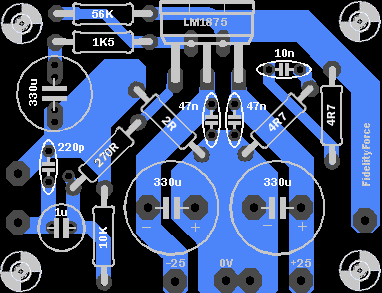

LM1875 PCB
Here is a very compact LM1875 PCB.
I'd like you to look at the "2R" "input groundlift resistor" that has been used to create a "signal star" ground.
That groundlift resistor will help you in PCB design.
I'm sure you'll want the signal star ground feature. However, depending on your application, you may wish to rearrange the small signal+ components for your design.
P.S.
To support an especially weak MP3 player so that it doesn't run into the headphone protection range which is useless to amplify, you can change the amplifier's feedback resistor to 56K, thus the MP3 player set not higher than 70% can push the amp to full blast. Setting high gain relocates the compromise to the power amp so that a modern source can be useful (but really high gain costs a tiny bit of power amp quality). The gain setting shown on that board is already high enough for a computer to push a 25w amp near max without straining the computer sound chip too much. RMAA software, which is free, can help you determine what output level a given computer can do cleanly.
This amp design contains compensation, and therefore, you might get higher quality by setting lower gain (33K feedback resistor) and then push with a preamp as needed.
P.S.

All of the gaps between ground and other traces should be made as narrow as possible, especially those between signal and signal ground. Signal ground should fill every open area on signal side. Otherwise you are making antenna for hum (and RF). Remember to also tightly twist together the signal and signal ground wires, ALL the way from board to input jack.
Also, why connect signal ground and power ground at all? The signal ground should go back to the star ground, usually just after the PSU caps, separately.
I just wanted to show the 2R separating the signal ground from the power ground. And the point is: That resistor is just a really helpful tool to use during layout.
Next step. . .
Personally, I would like to improve the output device quality well before any other complexity is introduced. In my opinion, Parallel Amplifier, is necessary in order to prevent hardships in component selection and do-overs that would surely happen if the cart is before the horse. The "output device upgrade" of paralleling removes the cheap tone from the chip amp. The parallel chip amplifier doesn't require either overlarge or botique capacitors installed at the chip to dump distortion along with some of the audio. Nope. That's not needed. Quite simply, the Parallel LM1875 performs like a small discrete amp of high quality.

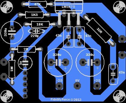

An actual production board would be at least 20% smaller.
Fingers hurt! Oh ouch. Perhaps 20% smaller was a brag after all. But, I did knock out the cost of the big power wasting resistor, the cost of big counter-productively ringing box caps, and the PCB did get smaller.
I wanted to build a gain comp amp for Mp3 player. The amp will go to max before the source starts straining. There is a slight cost to the power amp for doing this, but yet a great relief to the source is more important. This simple plan keeps a modern source within its clean range and therefore in a useful condition. Of course there are more complex ways of doing this, but here it is with just one chip, the LM1875.

So, basically, THIS, will be highly dynamic and VERY LOUD!
