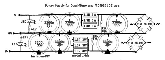

Monobloc (and dual-mono) provides a decent answer for controlling current--One transformer and one power board per Each LM1875. To power a pair of LM1875, you'd need a pair of transformers of not more than 2 amperes apiece. Momentary power for bass peaks comes from the power supply boards.
One pair of these: Antek - AN-0518 to power dual-mono LM1875.
And perhaps a pair of something like this:

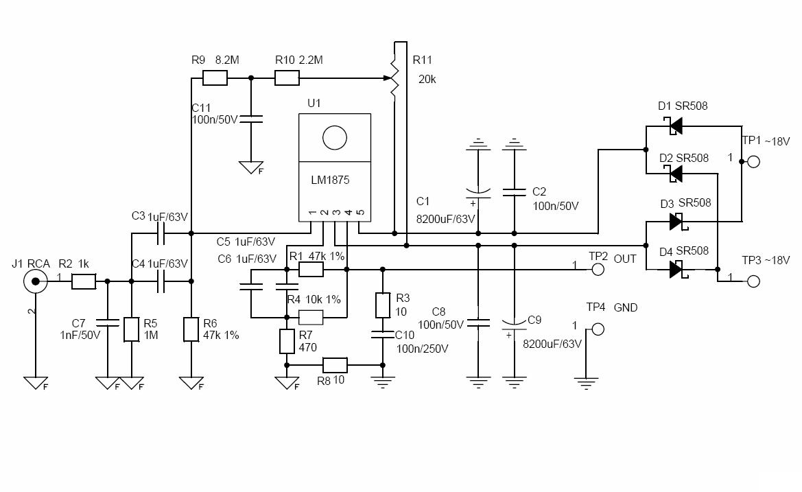

I get the gain from input to output as approx. 25.2db or 18.1 numerically, fractionally higher if you discount the attenuating effect of the input filter.
1k and 1nF give a cutoff frequency of 159kHz.
I am confused by the lack of a Centre Tap from the transformer.
Is this a single secondary rated at 18Vac?
The schematic shows a Power Ground symbol and shows both supply rails connected to the Power Ground via smoothing capacitors.
The schematic also shows a Bias Voltage from the supply rails to the +ve input to set the chipamp to halfway between the supplies.

thank youI get the gain from input to output as approx. 25.2db or 18.1 numerically, fractionally higher if you discount the attenuating effect of the input filter.

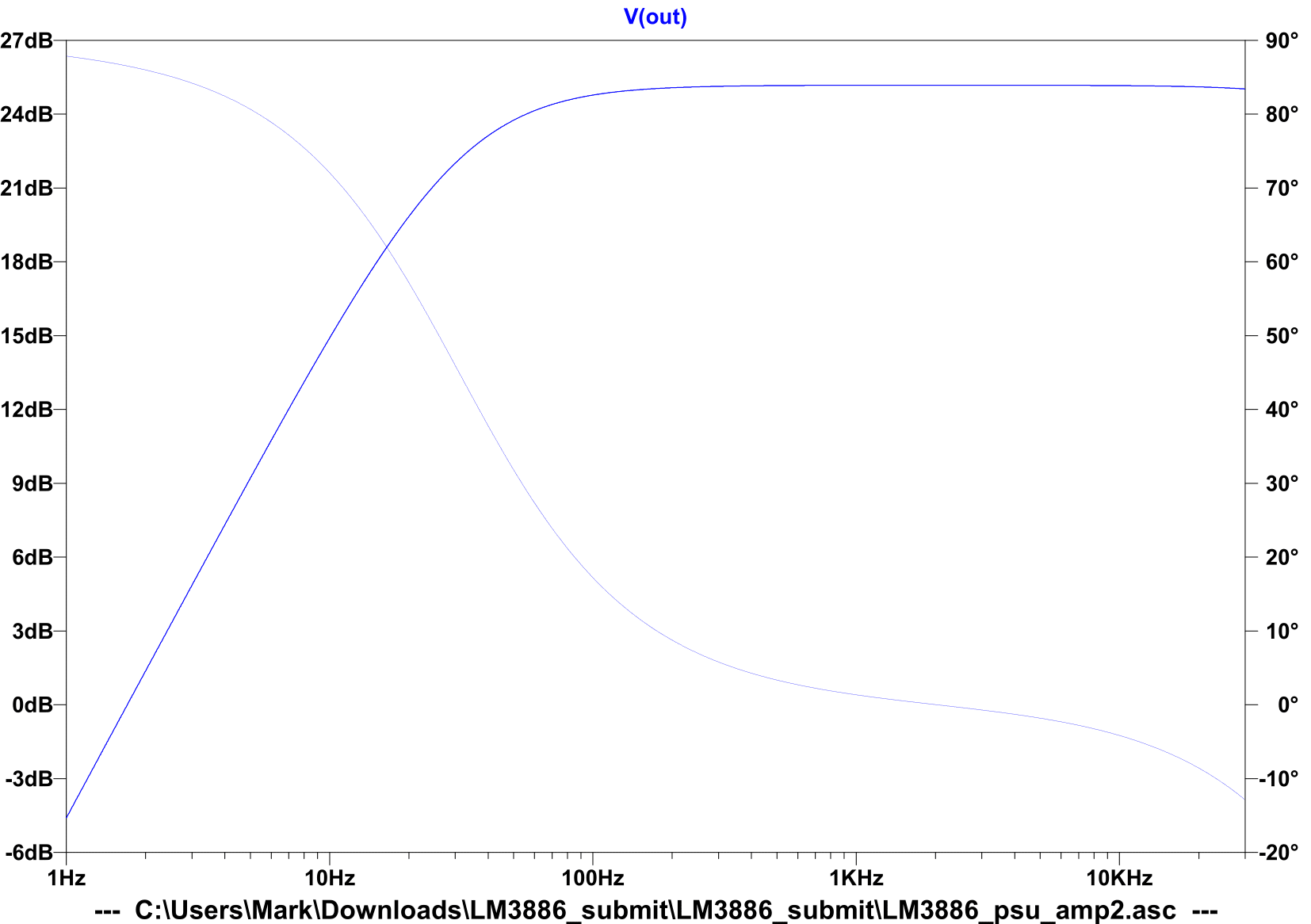

The LF response of that circuit is extremely restricted by the way (C5/6).
how I can change low frequency response - is there need to increase C5/C6 ?
p.s. R9 R10 R11 C11 are not used

the transformer have 18 0 -18 and 18 0 -18 for the other channel

C5/6 should be increased to a combined value of 33uF. That would give a -3db point somewhere around 4Hz (currently around 30Hz)

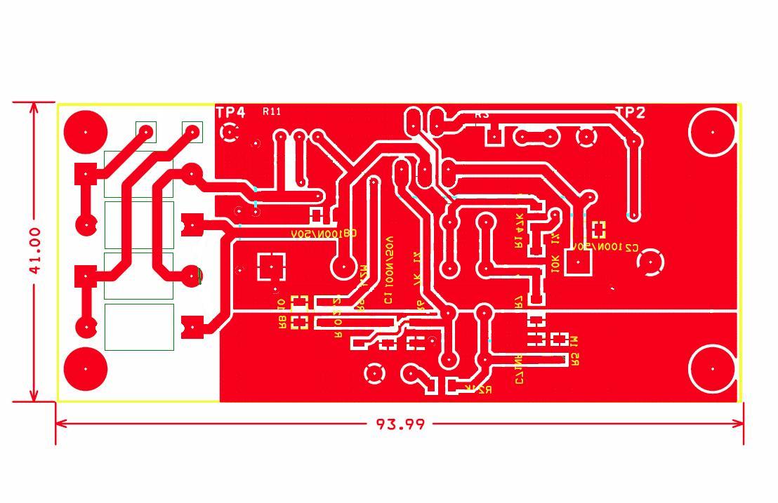

the pcb is for smd elements and some of the capacitor are with leads with spacing 5mm(for C3, C4, C5, C6), so if I want 33uf I have use electrolyticC5/6 should be increased to a combined value of 33uF. That would give a -3db point somewhere around 4Hz (currently around 30Hz)

Its not really possible to do that. The feedback network has two parts to it in this design, the 47k for the feedback needed to maintain the DC conditions, and then the additional 10k and 470 ohm to finalise the gain. That second part has to be AC coupled.
You would have to ask the designer why they chose to do it this way, and not follow the more conventional route.
The best way to see the effect of changing values is to simulate the circuit. You can do that using a basic opamp configured with your parts wrapped around it.
There are on-line tools for determining simple R/C filter cutoff frequencies but non that would allow calculation for a set up like this.
Search for 'R C filter calculator' and you will find many examples.

If you increase the C5/C6 sum to 4uF (is it 2 x 2.2uF?), then your -3dB frequency response will move to cca. 20Hz-ish (17Hz-ish just for the nfb part); which may be adequate for a small-room amp.
That's the easiest route for a "quick fix" imho.
