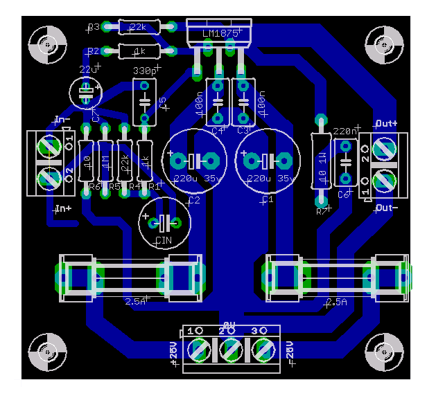

Here are some of the expected comments.
- - Did you read post #30? The rails are reversed.
- Fuses should not be used like that. If only one of them blows, you will get the full DC from the other rail at the output and through your speaker. That can cost you your speaker. Fuses ought to be used in a way that both rails will be interrupted in case of a fault. On top of that the fuse values appear very big and their characteristics are not specified.
- Miter the right angled trace from R2 to C7 or make a straight trace between them.
- Delete the antenna below the In+ terminal.
- Do you really want to use an electrolytic capacitor for Cin?
- Do you know the reason, why Nordic chose R7 with 10 Ohms, while the datasheet proposes 1 Ohm? If you don't, stick to the datasheet.

I have red about the rails.
I don't want electrolytic capacitor for Cin.
I asked about this layout cause i didn't want to do p2p. Is there a better layout for this chip that you are aware of?

Speaker zobel is listed at 10R for two reasons:
1). The simple reason that it avoids putting an unnecessary load on a little amplifier.
2). Protect the resistor from burnout.
1R + a polyester or Mylar cap assumes that the high internal resistance in the recommended capacitor is going to contribute some additional resistance. The resistor will not last unless you use 10w capacity.
4R + a polypro or polyester or mylar cap is a working alternative, without making unwarranted assumptions. The resistor will not last unless you use 5w capacity.
10R can use a reasonable size 1w to 3w resistor. And, 10R + 100n Ceramic provides flexibility for solo, for bridged, or for paralleled configurations.
No. Strange as it may seem, most of the promising ones come with fuse holders. As if it were more important to protect a 2 € IC than a much more expensive speaker.zikinho said:Is there a better layout for this chip that you are aware of?
If you specifiy, what exactly you expect, maybe somebody else can point you to an adequate PCB.
- - Do you want to etch yourself one- or two-sided or rather buy a ready-made PCB?
- Do you want a mono or a stereo PCB? Or even multi-channel?
- Would you like to have the rectifiers on board or separate?
- Can you handle SMD components or should everything be through-hole?
- You don't like P2P, but what about perfboard?

- I want to etch the single sided board myself.
- Mono or Stereo, both would do.
- I have already made a couple of rectifier boards so there is no need for them.
- No SMD, only through-hole.
- Will try perfboard but would like to have etched pcb.
