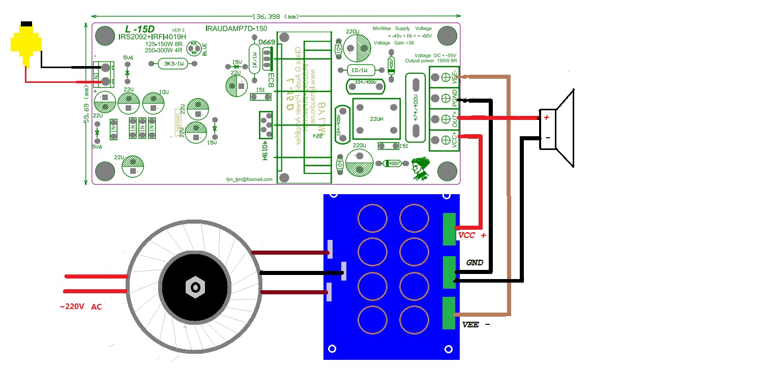

ljm_ljm,
With the heat sink vertical on the board it doesn't look like convective airflow over the fins will be very good, since the board underneath blocks it.
Do you know what is the maximum average power that a module can dissipate when in a closed box?
And how much if the box has ventilation holes above the heat sink?
Also , what are the dimensions of the board? I searched but didn't find them, and the ebay vendors don't give them either.

ljm_ljm,
I send connection diagram in front have a mark on size.
The radiator height about 40 MM. Plus installation about 5 MM copper column。
L15D can use 30 MM height of the radiator. If be necessary, can indicate

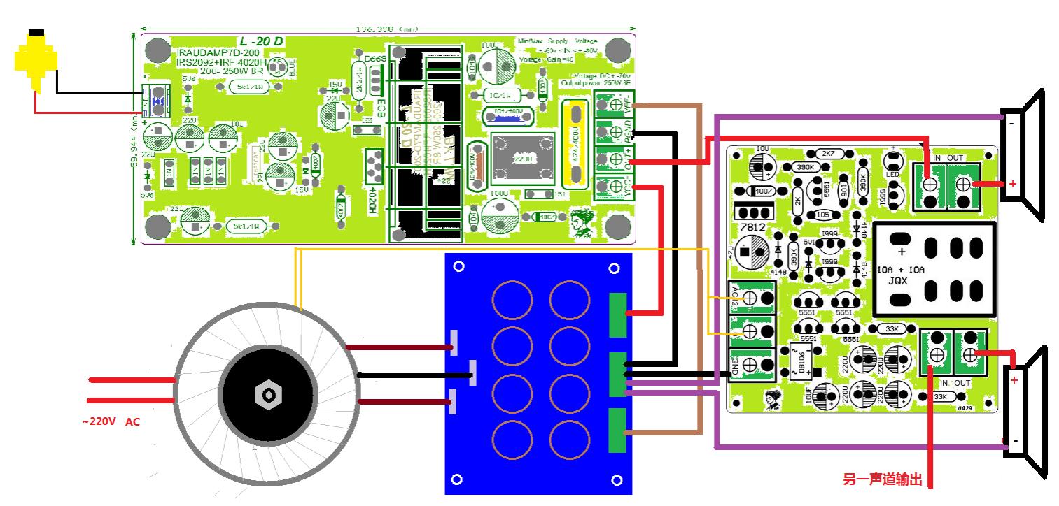

If you are talking about this one: http://www.ebay.com/itm/110620807058?ssPageName=STRK:MEWAX:IT&_trksid=p3984.m1438.l2649, you could remove the 7812 regulator, and run the +12 directly in to the printed circuit hole where it's output pin was. and the ground from the power supply would go on the regular ground point.. It would probably be a good idea to get a schematic for it as well. If you had the schematic, you could pull out the first component after the ac input connector so that the rest of the circuit was out of the way, and use AC12 as the input point (to keep it clean, and then run a wire from there to the (former) output of the 7812..
