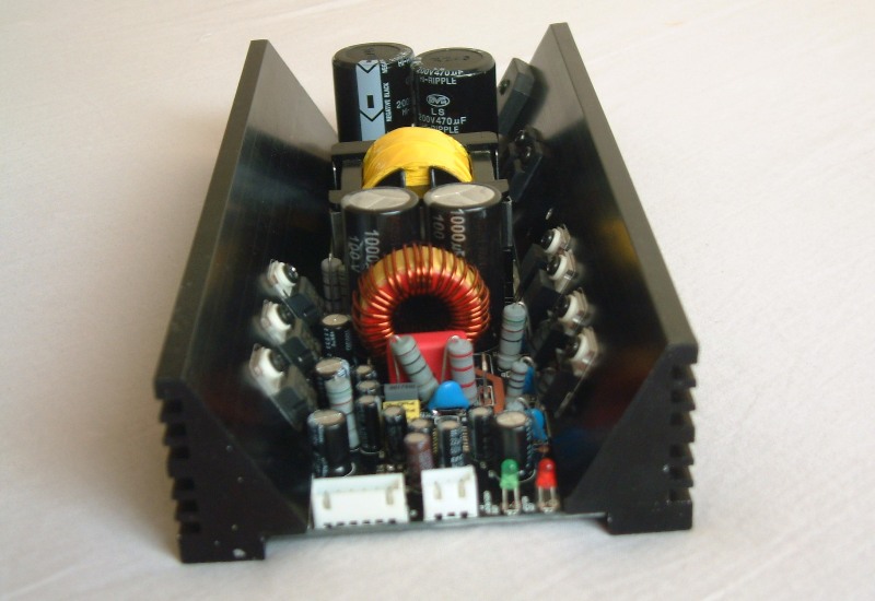

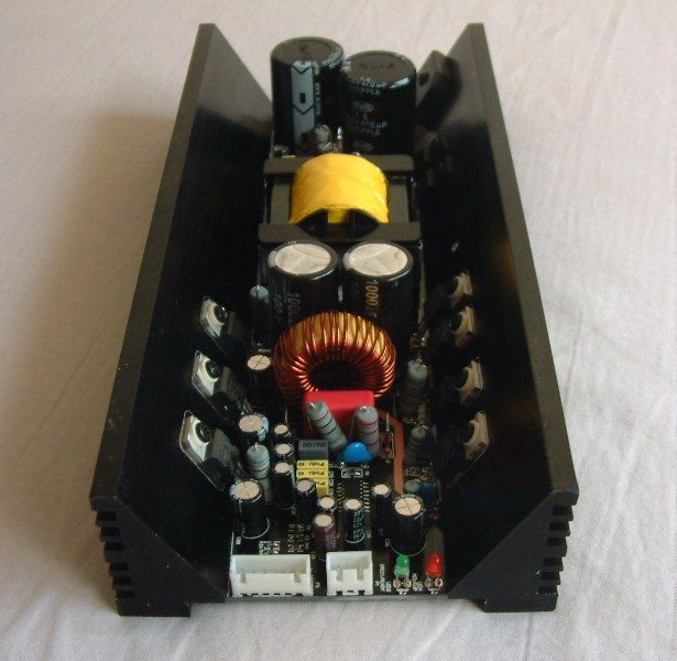

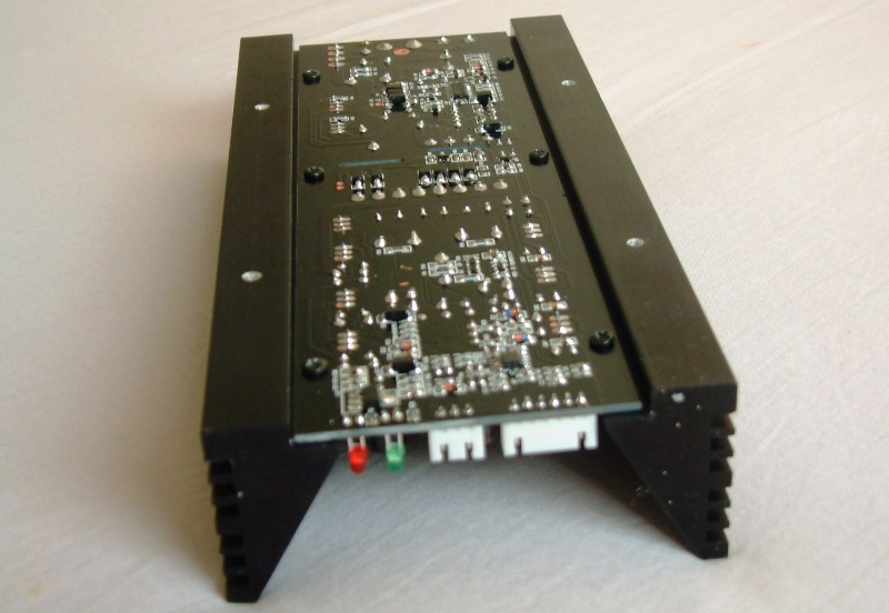

IRS2092 600W board:
I like to use IRS2092 plus IRFI4019, 4020 amplifier.
This is the design of the power amplifier AUDAMP7 reference, they can reach 125 200 W power 8ohms
250-300 W 4 ohms
This is the power of the household relatively appropriate, has the smallest distortion (good effect)
I don't think too DuoRen inside the home use square of radio.
More power and voltage MOSFET and not in ascension.
Also in relation to the inductor capacity. This requires 1 MM copper wire many root in parallel, many people ignore this.
We must use load, to test whether the inductance of the cores can bear.
More power to bring the larger current, make ordinary PCB can't reliable and stable.
Need more thick copper PCB line.
All of these will greatly enhance the production cost, because they will use the non-standard equipment.
With great power transformer and will be very expensive. Finish all of these, and perhaps we only used it 1/10 of the power.

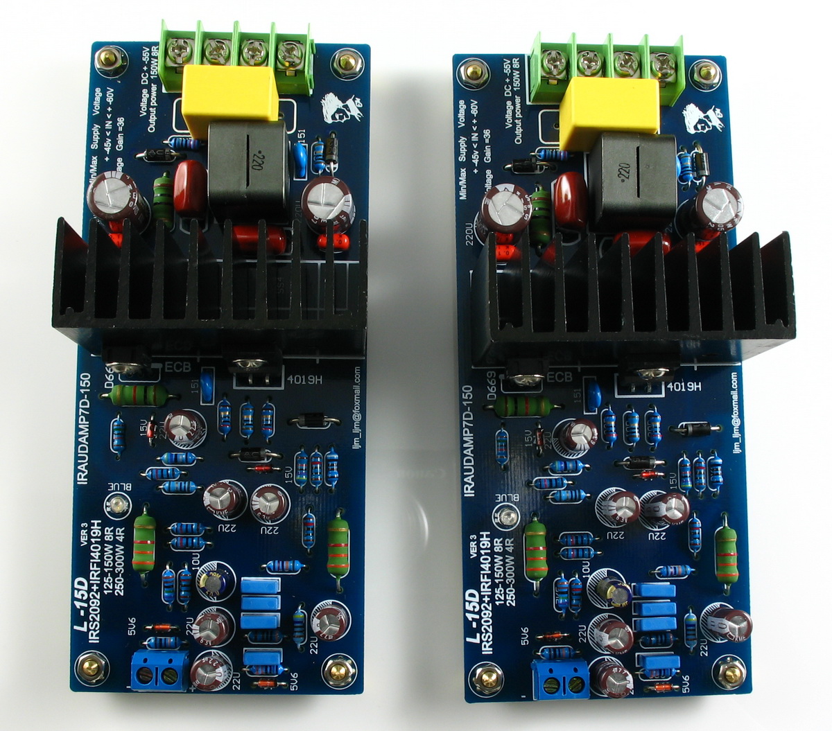

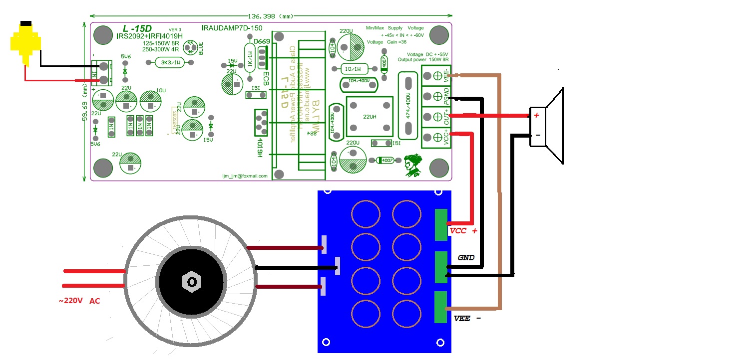

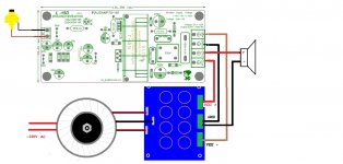

L15D REV3
After constant test, the effects of the PCB
To get a good performance from the apparatus, do not look to give IRAUDAMP7S difference with.
Single ply plate with a more small distributed capacitance effects.
Ljm_ljm, I would like to purchase a pair of your new REV3 L15D's. Can you recommend an online vendor that will have them?
L15D Digital Audio amplifier board IRS2092 IRFI4019H | eBay
Now the version is going to change for REV3.
It has a smaller distortion, better performance.
L15D recommend using DC +-50 V power supply.
Can output the 125 W 8 ohms, the power of the 250 W 4 ohm power.
+-55 V (150 W 8 R) (300W 4R)
