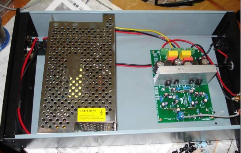

You are going to use a switch power supply, switching power supply I used in the L15D, and L15DX2 above
(IRAUDAMP7S-150).
They are all very good work, and my client installed in the L15D car above. Use a
DC12 > +-50 V switching power supply.
As long as you change the voltage of power supply is less than 10 V +-basically do not have too big effect.
