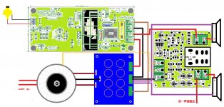

Actually, I was just talking about how to modify a speaker protection board to use 12V DC vs 12VAC, not the L15D itself..
The jlm ones seem to me boards for the experts. Connexelectronic's ones are more user friendly. They even have boards at 150w at 4 ohm, without the need to change components as is required for the l15d to run at lower voltage and power.
A friend asked me to help him make a connection diagram plus protection.
I paste to come over.

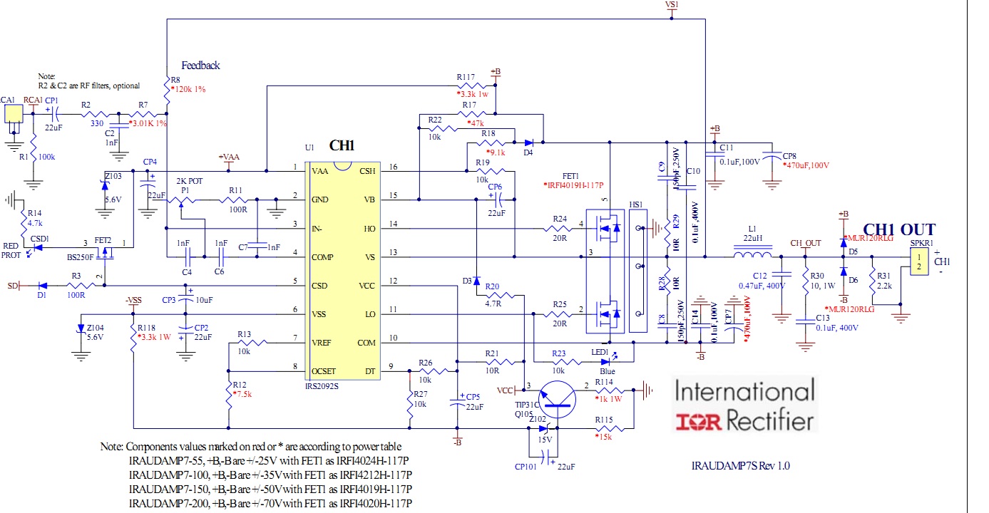

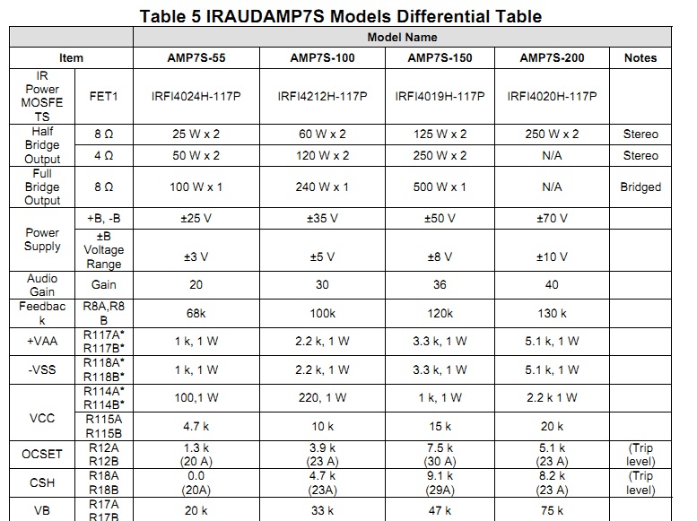

ljm_ljm, I know your L15D and L20D are based on the IR reference design, but looking at the boards, is it correct to conclude that you did not include the over/under voltage protection circuitry(page 31 of the Reference Design document) in your designs? I don't see it in the board layout.
The over/under voltage protection I'm talking about in the International Rectifier 2092 Reference design is for the power supply voltages, not the input voltage..
No power supply voltage forced close protection function.
But the power supply voltage and IRAUDMP7S principle is the same.
The power supply voltage not more than recommended. May be damaged.
Don't lower than the value of the request, will work is not stable.
Can you provide an exact schematic of your design please? I know you based your design on the Reference Design, the differences can be confusing. If users are attempting to replace the resistors to us a lower voltage supply, it is not straightforward to identify which are the correct components to replace.

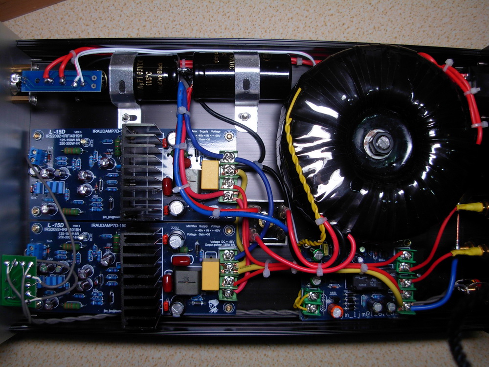

Hi all,
I'm building a 7.2 active speaker system that will require about 20 channels of amplification. They will all be line arrays with some being 2 way and some 3 way. For the amplification, I am interested in purchasing 10 kits (20 modules) but wonder what else I need to consider. I would like to drive my speakers at 4ohm.
1. Could I use those boards and combine them into this type of multi-channel amp?
2. What will be the cheapest way for me to combine suitable power supply in order to power all channels. I rather not have one power supply for each two modules but maybe that is needed?
3. Would the above work or do I need to consider something else?
As you can hear I'm a novice to this but would love to build something myself.
Any advice is appreciated.

Hi all,
Sure, it's been done before.. I think these are great "modules" for multi-channel systems, since they are very small, for the power they are capable of.
Probably something like a SMPS supply from Connexelectronic. Cristi has a number of Power supplies with different ratings, 300 - 1000W, so you could run up to 4 channels per 1000W supply.
No, probably just casing, and layout, and if you want an all in one chassis, or split them up some way or the other..
Exipnos
And the reference design is The same.
The reference.
Or more channels, depending on power requirement and where the amps are located.
What is the difference between these?
Something to keep in mind is that the heat sink fins of the stereo board be vertical, unless you use a fan, requiring a much taller case than the mono boards.
If that's OK, then you can fit more amp channels in a given volume.
What is the difference between these? How does the sound compare between one stereo board and two mono boards?
