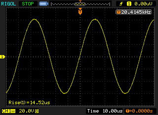

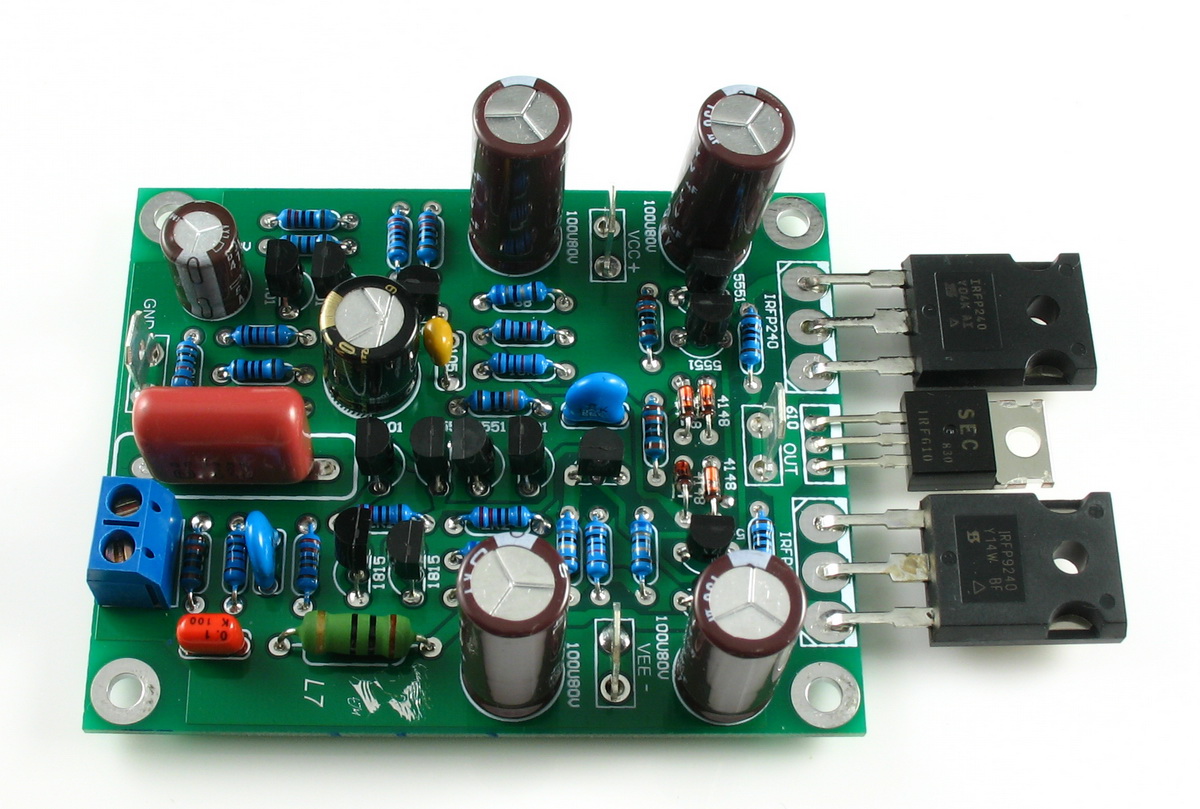

L7 MOSFET AMP
I designed a small power amplifier。
It uses a pair of VISHAY IRFP240 IRFP9240。
It uses the CFP input, and the suspension of the output, similar to LME49830 structure.
It works in very stable.
In the +-56V voltage.it is can out 150W 8R。
PCB board area 63*78MM only

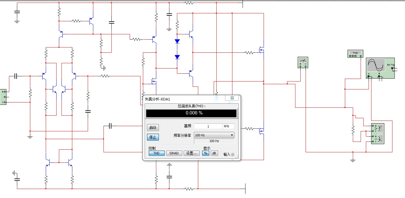

Any chance for schematic now?
It is pointless to make such threads without schematics and only one or two pictures. If this is a commercial product and you don't want to share it only to show the beautiful PCB (actually is very beautiful!) there is a thread for pictures and it will be better to post more of them.

Do not worry.
This circuit can be a good power play IRF FET.
I can briefly explain.
It uses the CFP transistor input stage. Single-ended voltage amplification.
Internal structure similar LME49830, suspension of driving.
It can work very high frequency, and waveform perfect.
I tested with the 2700K HZ.
Does not appear as an ordinary FET amplifier instability phenomenon.

Hi
I see I'm not the only one that uses totem pole BJT driver stage for each output FET gate. I do prefer the totem pole driving stage always stays well within class A. Using simple diode bias may cause one of the devices to leave class A during very fast transient output current signals, also it requires thermal feedback to the diodes because without the degeneration of an emitter resistor, thermal runaway can destroy a small signal device in a few blinks of the eye.
I use 3 diodes and an emitter resistor on the inside BJT to set bias above the largest charge current needed to operate the FET. Many semi-fab companies make triple diodes in a 6 pin SMD package.😉

Please post schematic and pcb layout as many diy enthusiasts will like to build the same. Extremely professional pcb does not look diy product.

I see I'm not the only one that uses totem pole BJT driver stage for each output FET gate. I do prefer the totem pole driving stage always stays well within class A. Using simple diode bias may cause one of the devices to leave class A during very fast transient output current signals, also it requires thermal feedback to the diodes because without the degeneration of an emitter resistor, thermal runaway can destroy a small signal device in a few blinks of the eye.I use 3 diodes and an emitter resistor on the inside BJT to set bias above the largest charge current needed to operate the FET. Many semi-fab companies make triple diodes in a 6 pin SMD package.😉
I am using IRF610 as the bias voltage provided. And with the output stage FET to maintain the same temperature.

If you have a L7. You will find the above parameters in detail. L7 is a very simple DIY AMP.

My comments is in reference to the TO-92 driver stage(s), the undegenerated comp class A BJTs that are detached from the diodes that bias them, not the Vgs multiplier bias control for the FETs.
