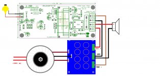

I’ve been lurking this and the L20D thread for some time and have a few questions about the boards. I’m building an active 2-way bookshelf speaker with a full range driver and a bass woofer where I plan to use the 2 x L15D boards + 1 x SMPS inside each speaker. The full range driver is 8 ohm 20W and the is woofer 4 ohm 150/300W (nominal/peak). For power supply I’m planning to use the SMPS300RE +-45V.
- Will the speaker drivers’ impedance difference be a problem for the L15D boards + SMPS300RE?
- Although the SMPS300RE is not taking advantage of the L15D’s full potential (as opposed to e.g. the SMPS500R), will this SMPS be sufficient considering the speaker drivers I’m using?
- Is the heat generated from the boards so high that I need to vent the speaker enclosure or even place external heat sinks?

It should use the L15D + - 45V DC power supply.
The L15D the fever is lower than the L20D 25D. He can be full of power without the need to increase the radiator.

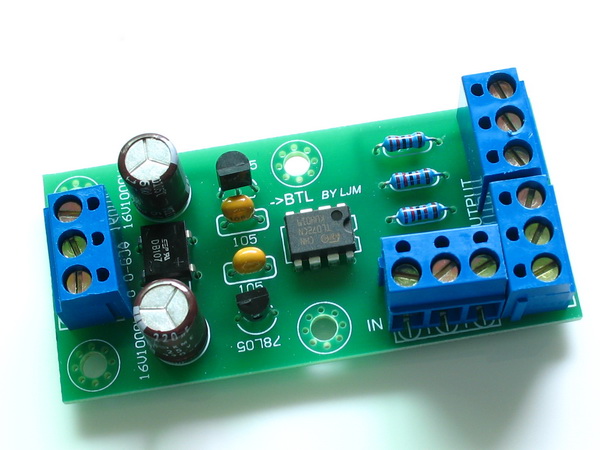

So is there anyway to BRIDGE two of these modules? and what would the power rating be?
Recommended to use this.
Its circuit by IRAUDAMP7S.
It can achieve 500W power 8 OHM

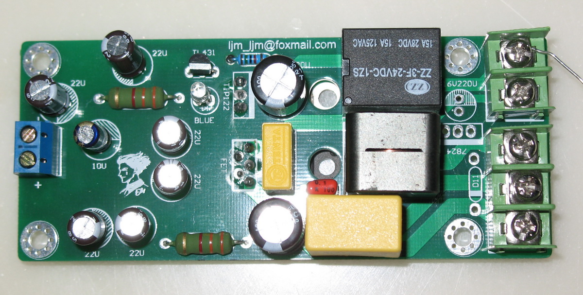

According to the datasheet of the original IRAUDAMP7s has multiple protection features that have not been included in LJM designs.
Anyone know if its necessary in original (or ebay copy ) IRAUDAMP7s amp add another protection circuit as a delay for anti-plop or similar?

Speaker protection board, including anti-pop delay are easy to find on ebay.

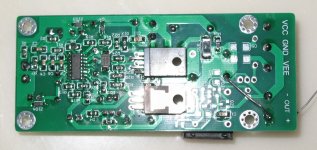

In fact I have a design similar products.
But after testing his performance is not the L15D good, so I gave up.
I repeated the same reference design based on the IRAUDAMP7S.
But every time the failure of the test in all SMT less than the performance of L15D.
400K HZ PWM frequency. Inductors, capacitors, filters.
Waveform distortion. L15D DIP parts. Distortion is very small.
At present, I still have no way to using SMT instead of DIP.L15D version.

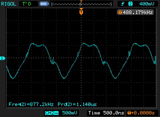

SMT test the performance of the oscilloscope performance.
Not a substitute for L15D, maybe I can be solved in the future so that it can be smaller.
