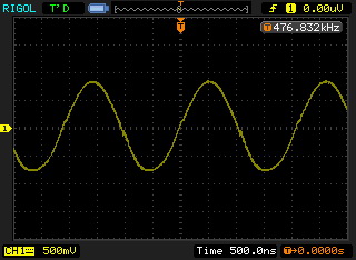

In fact I have a design similar products.
But after testing his performance is not the L15D good, so I gave up.
I repeated the same reference design based on the IRAUDAMP7S.
But every time the failure of the test in all SMT less than the performance of L15D.
400K HZ PWM frequency. Inductors, capacitors, filters.
Waveform distortion. L15D DIP parts. Distortion is very small.
At present, I still have no way to using SMT instead of DIP.L15D version.

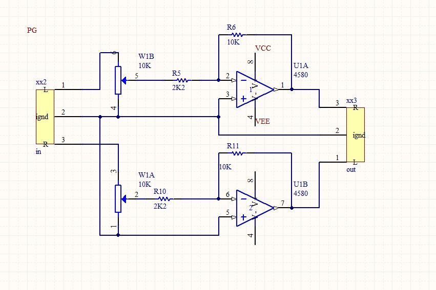

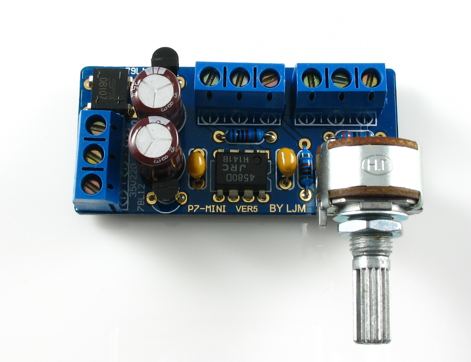

The L15D amplification gain is about 36 times. About can increase the 120K resistor. Gain to improve.
I suggest to add a preamp can add an op amp gain.

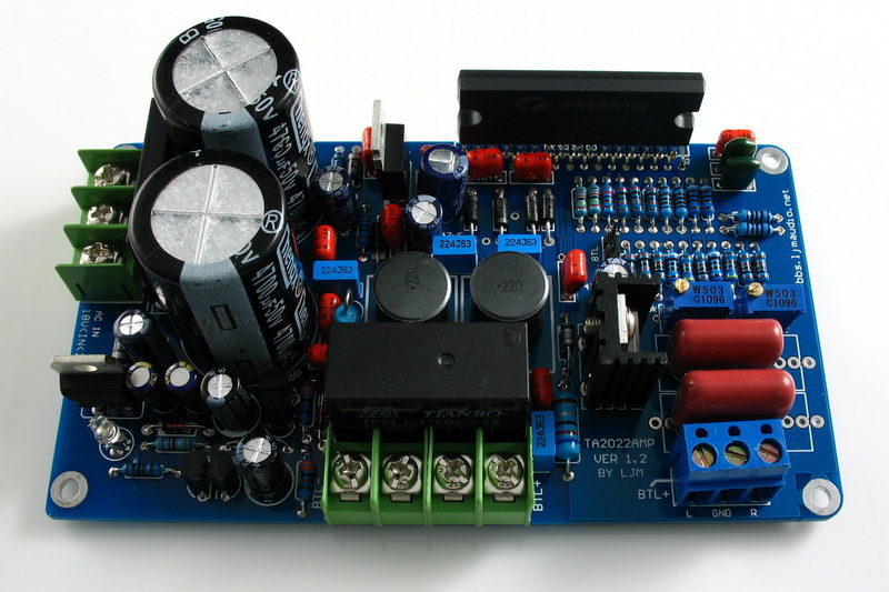

Apologize if this is covered elsewhere, I couldn't find. I want to use a pair of L15D per side as bi-amp controlled by Minidsp unit. My old speakers were rated 60w max new. I'd like to avoid adding a pot, as I will have master volume in the dsp and can pad if necessary there too. If I supply a lower voltage..say +25 or so, will that limit the output to 50w peak? If so will L15D still work ok? The lowest distortion area of L15D is 5-35w, right where I want to run them.-Thanks
L15D can not be less than less than +-35V.
If you do need to +-25V I recommend using the TA2022??, LM4766??
Perhaps they are more simple.

Thanks LJM. Currently I placed a TL072 preamp before the L15D using a non-inverting config. The set again is 2.5X only but I have a fairly loud hiss coming from the output. If the input of the preamp is not connected, it's gives out a audible hum at the output. Any idea why?
Thanks!:confused:
Thanks!:confused:
Cancel the pre-amplifier. If there is no noise, the noise is generated by the pre-amp.
Preamplifier noise is likely to occur..
Or short circuit L15D signal input IN INGND. If there is no noise.
Description of noise generated by the input signal.
Thanks LJM for the advice. Its working fine now.
I didn't need the preamp after all. My problem was I plugged into the wrong source where it has a 10K resistor across the line level. Now its working great with a 10000uf rectifier at a Vs of 46V.

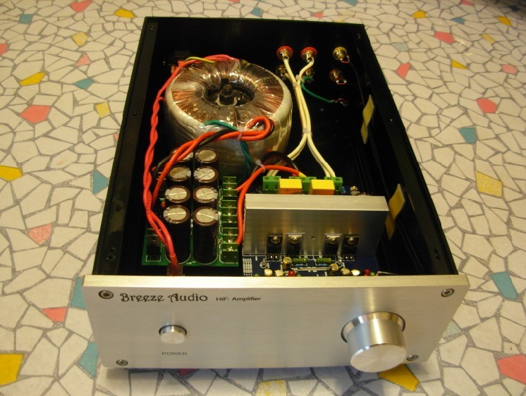

I am planning to go for stereo L15d. I have 4 ohms speakers. Also have a pass b1 bueffer. I need to get a linear psu 50-0-50 volts DC right? Is there a recommended one. Would like to build one myself, not a module. Are 63 volt caps enough or do I need to go for more. What kind of trafo is a good option, ei, torroid or r core. I need speaker protection curcuitry. Do I need a soft start module also, any recommended ones? I will probably get these from fleabay. Most of these run on 12v right, will check anyway before getting the trafo etc.
