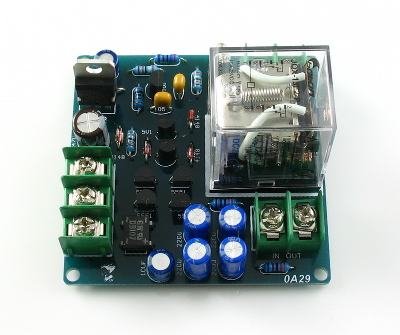

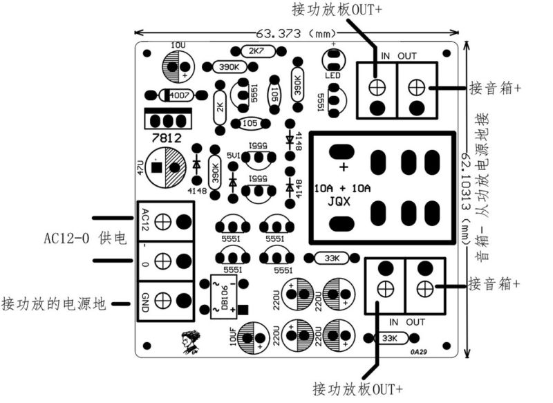

Alittle help for my friends

If I use this, i dont need soft start?
sofstart is needed if you have big capacitors with your linear power supply, to limit the inrush current at power on. Regardless of speaker protection.
It's difficult to set a limit : imho, with a total of less than 30.000uF filtering capacitors, you don't need softstart. Above, you may consider.
With (serious) SMPS you don't need an additional softstart, as they have one built in.
