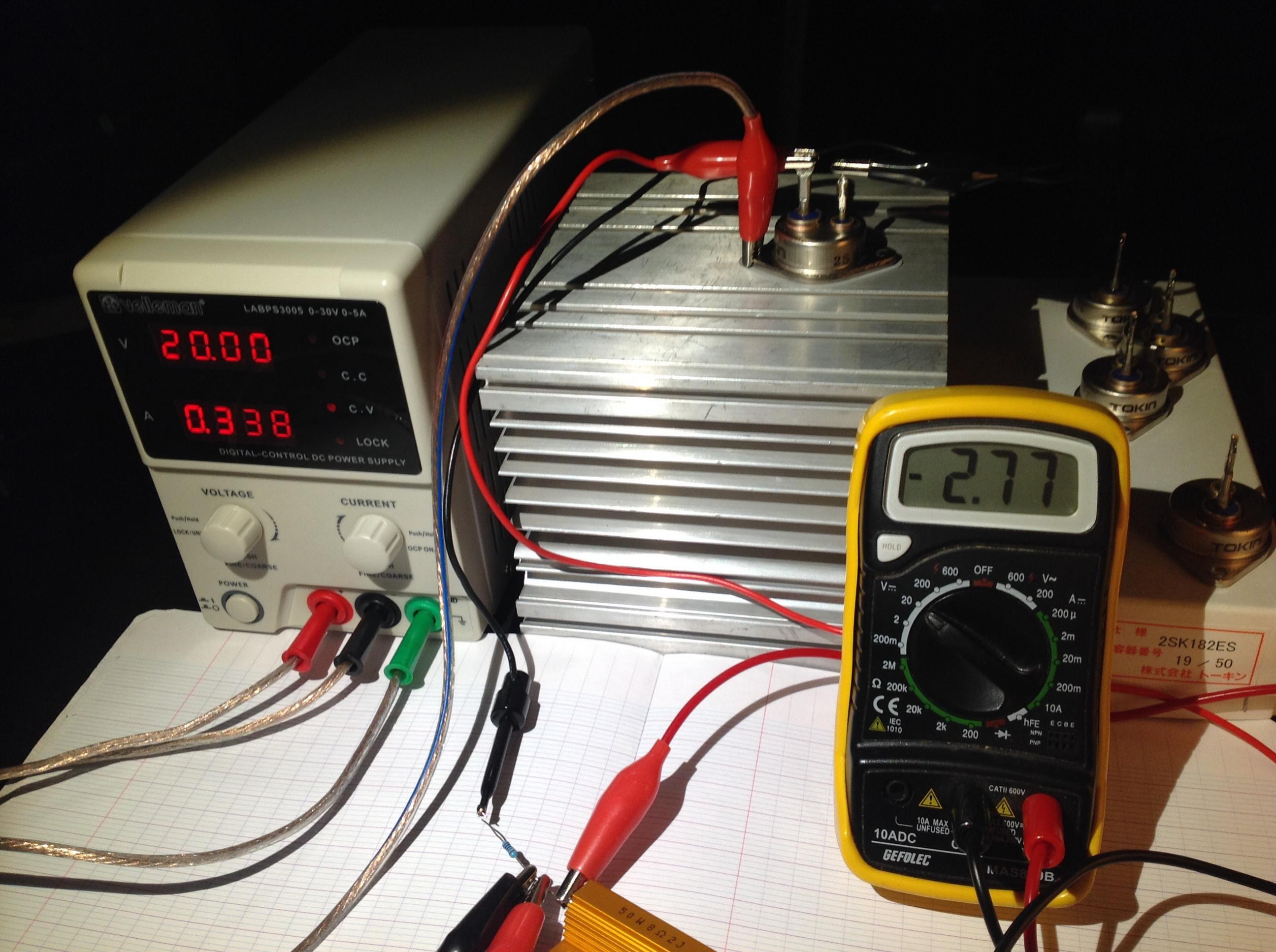

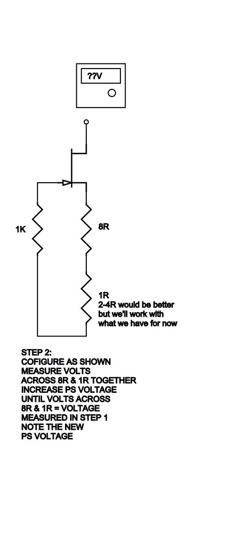

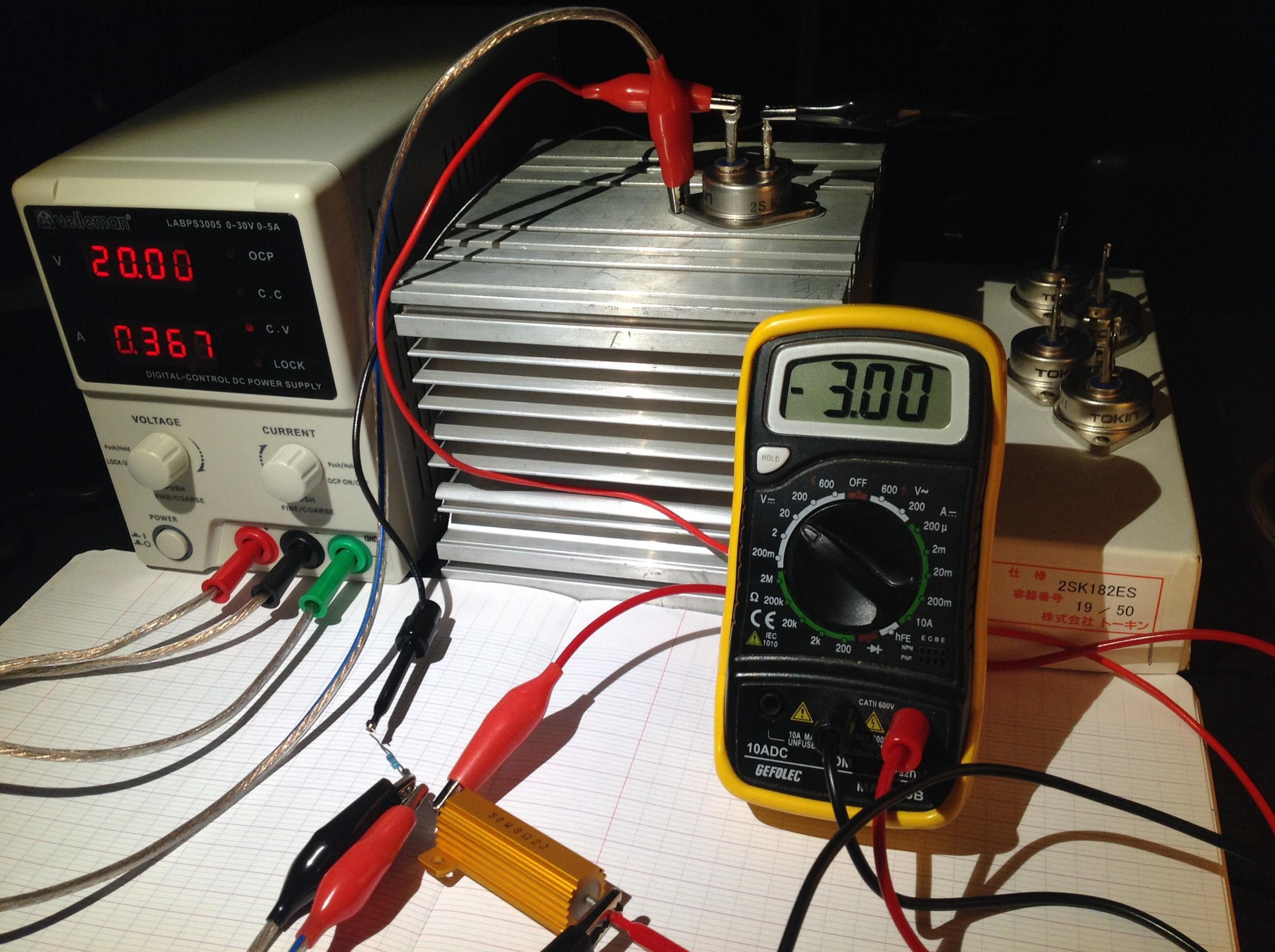

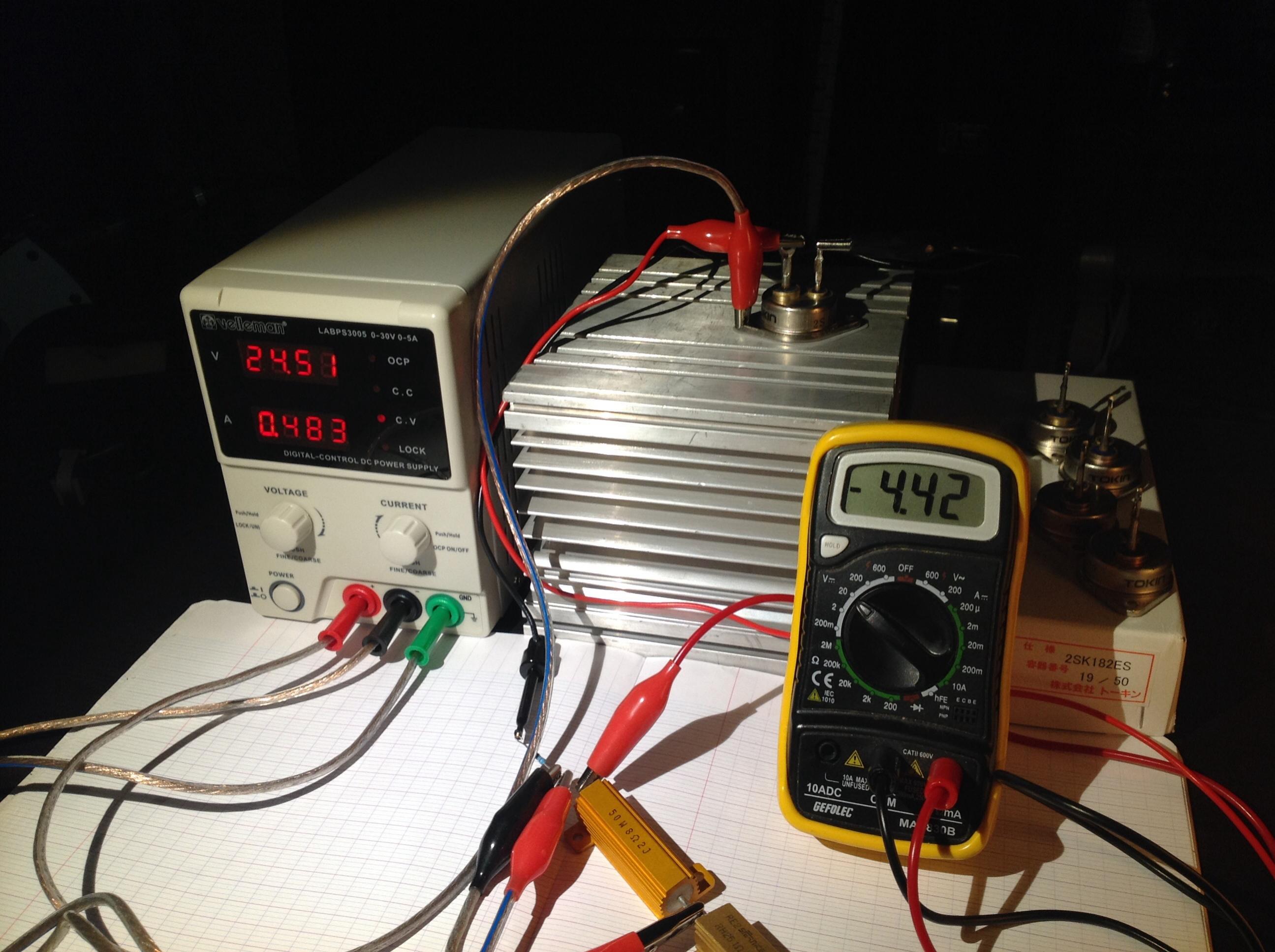

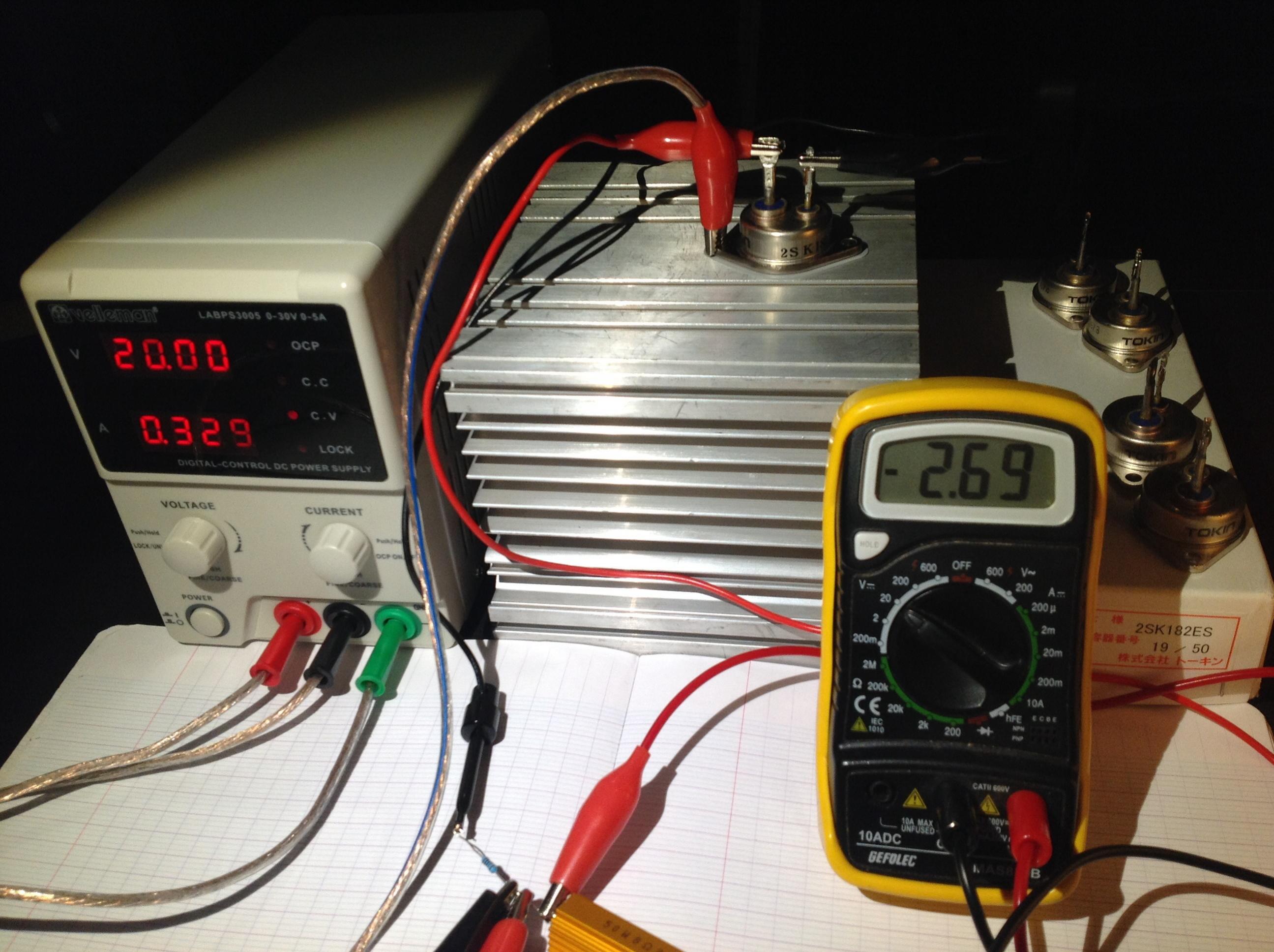

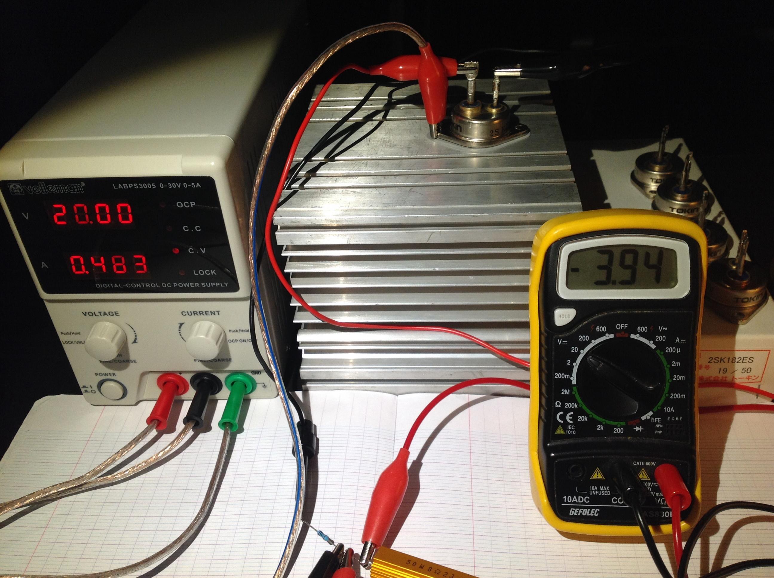

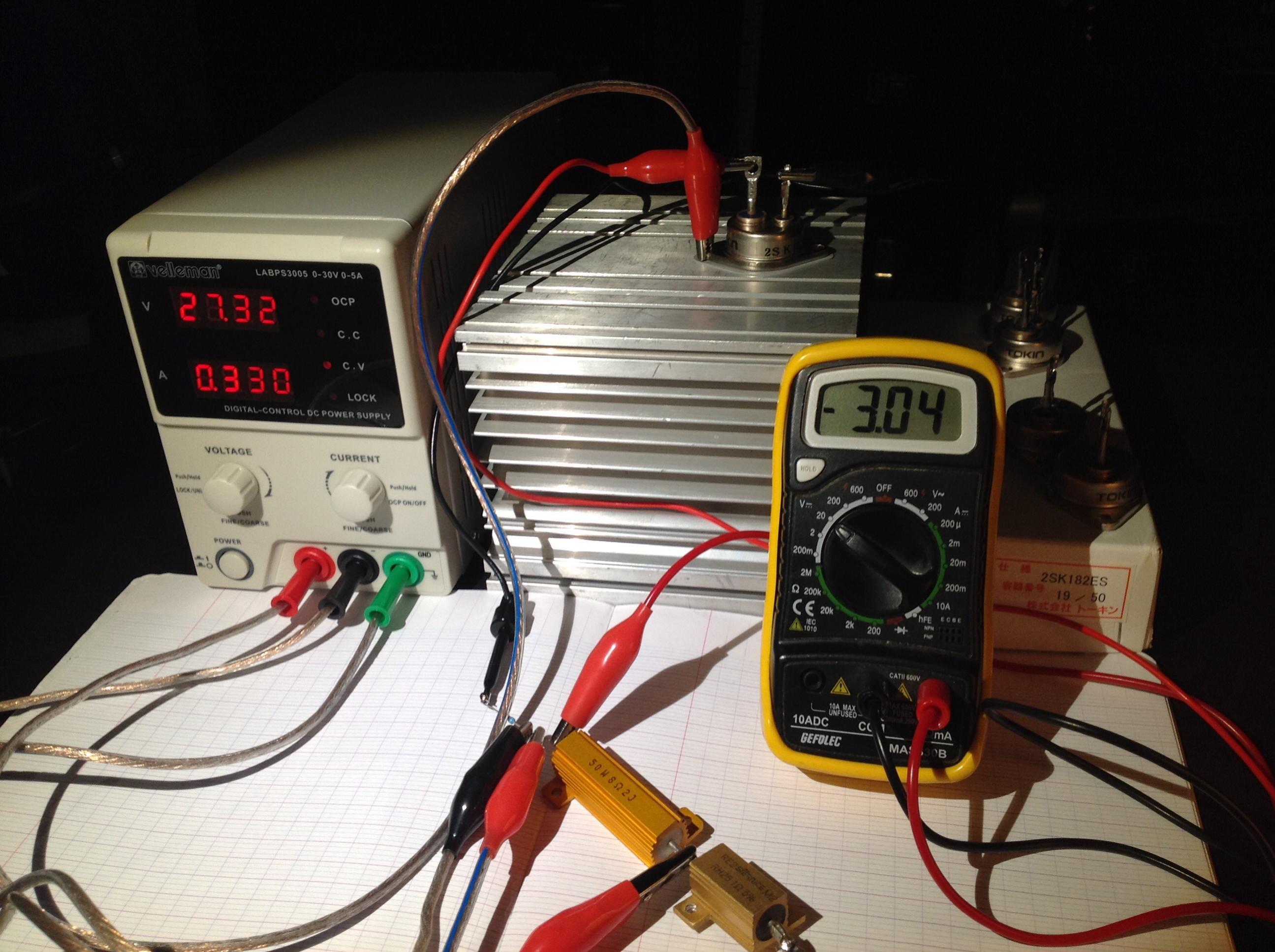

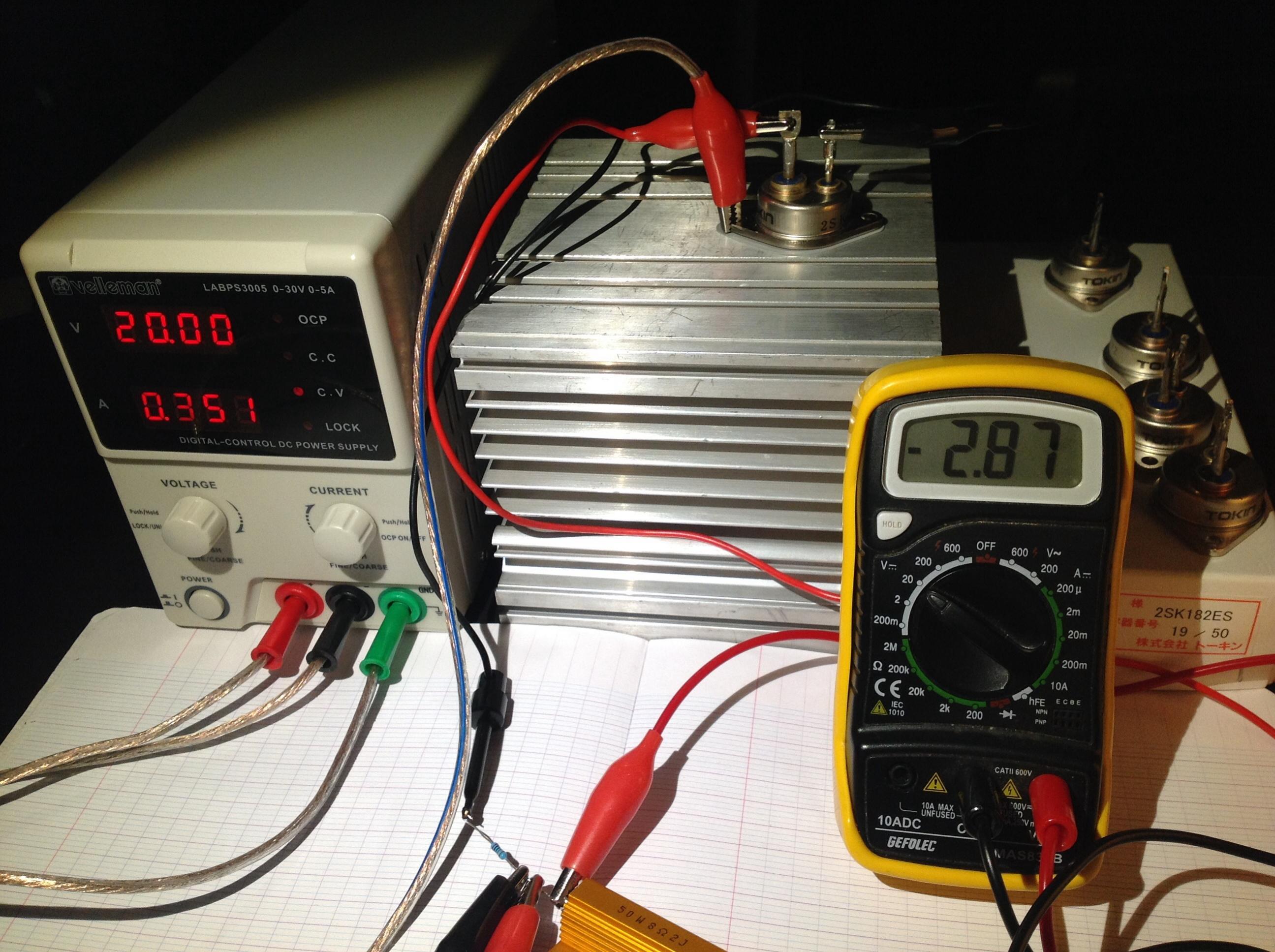

Test Step 1
border="1"
| class="tcat"| #
| class="tcat"| SIT 182 ES
batch nr
| class="tcat"| 20 V
| class="tcat"| max 2A
||1||1Z2670 || 3,00 || 0,367
||2||1Z2671 || 2,77 || 0,338
||3||1Z2672|| 2,69|| 0,329
||4||1Z2673 || 2,87 || 0,351
||5||1Z2674 || 3,94 || 0,483
| class="tcat"| #
batch nr
| class="tcat"| 20 V

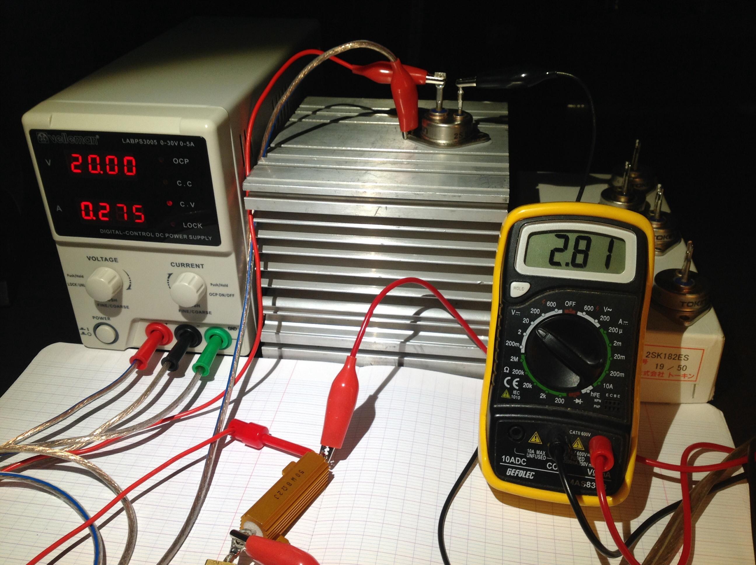

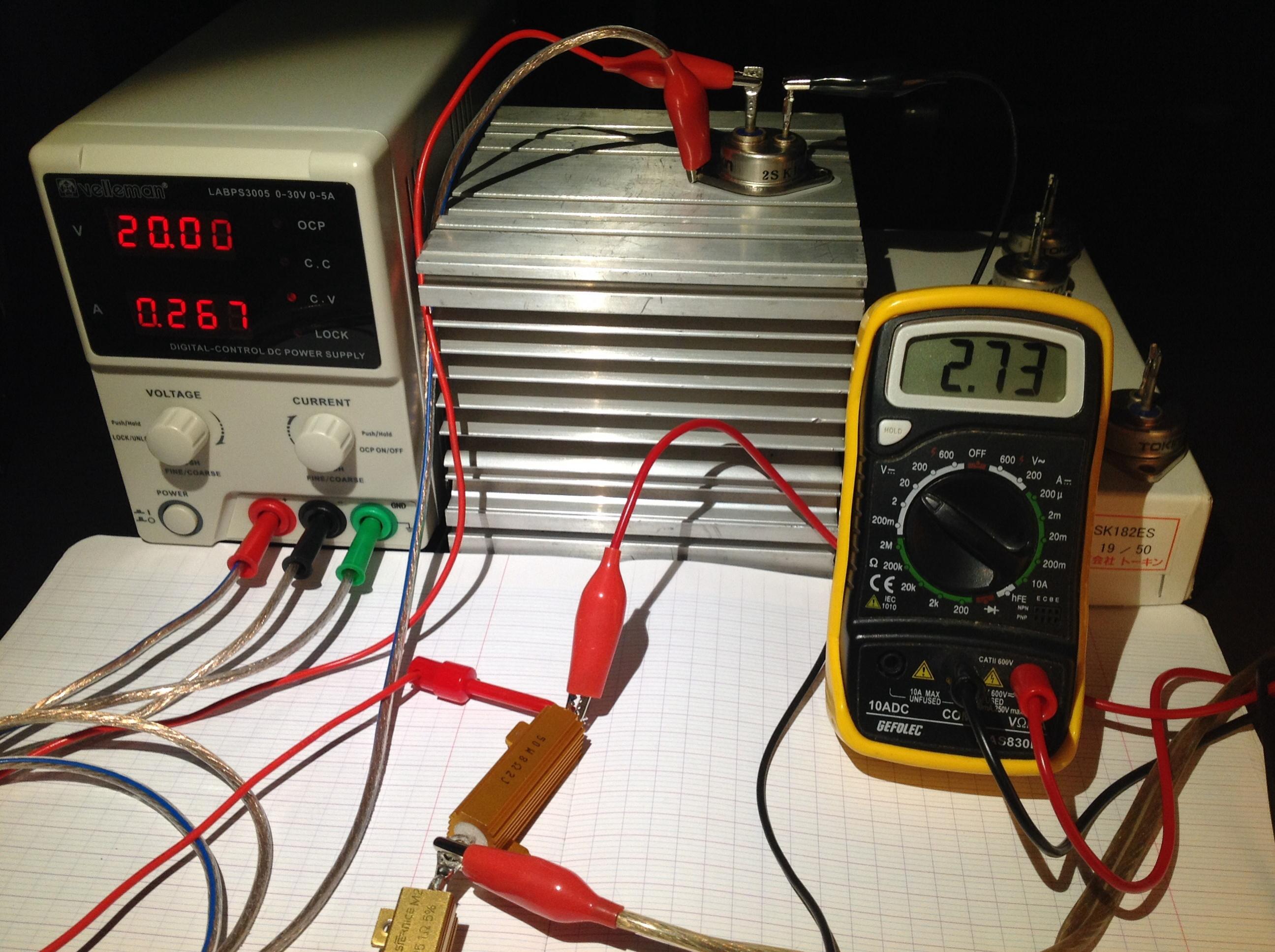

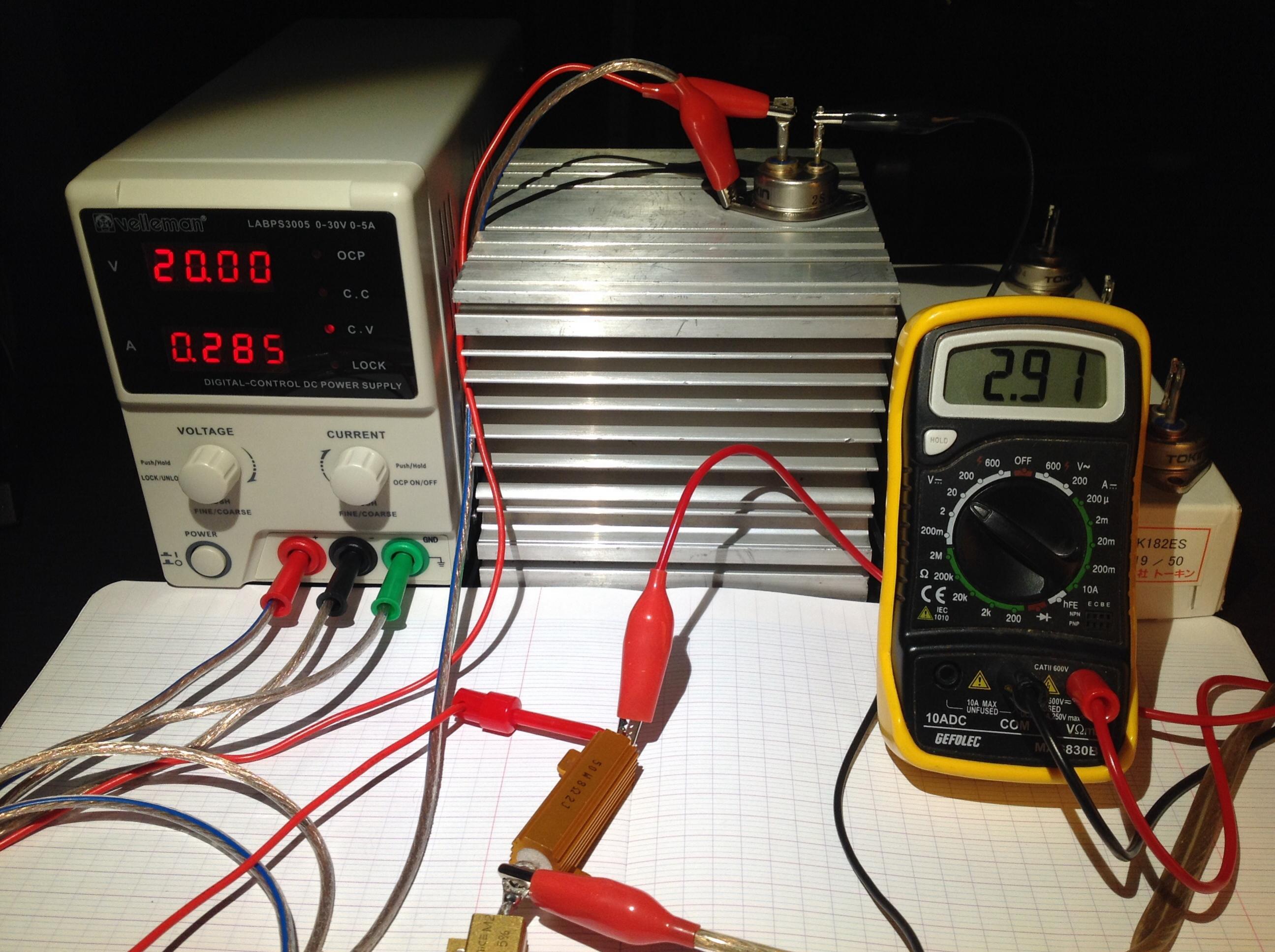

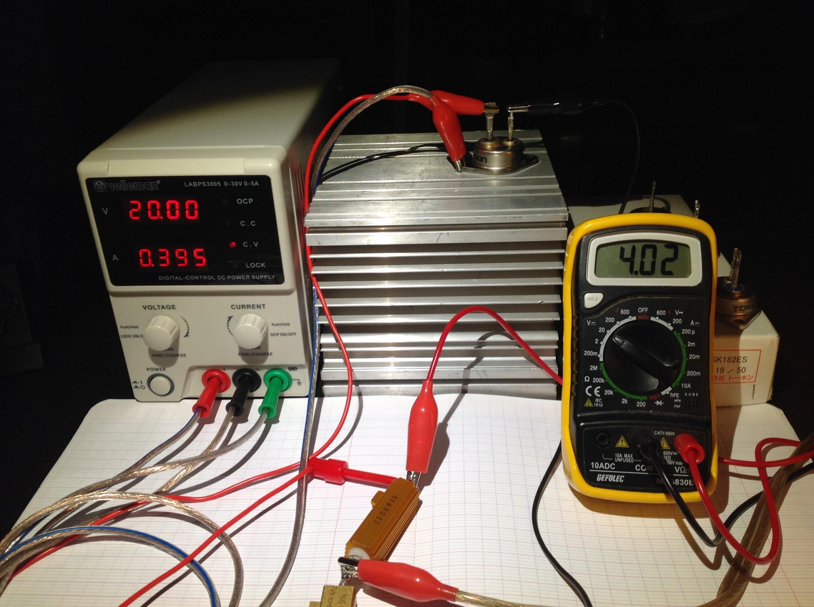

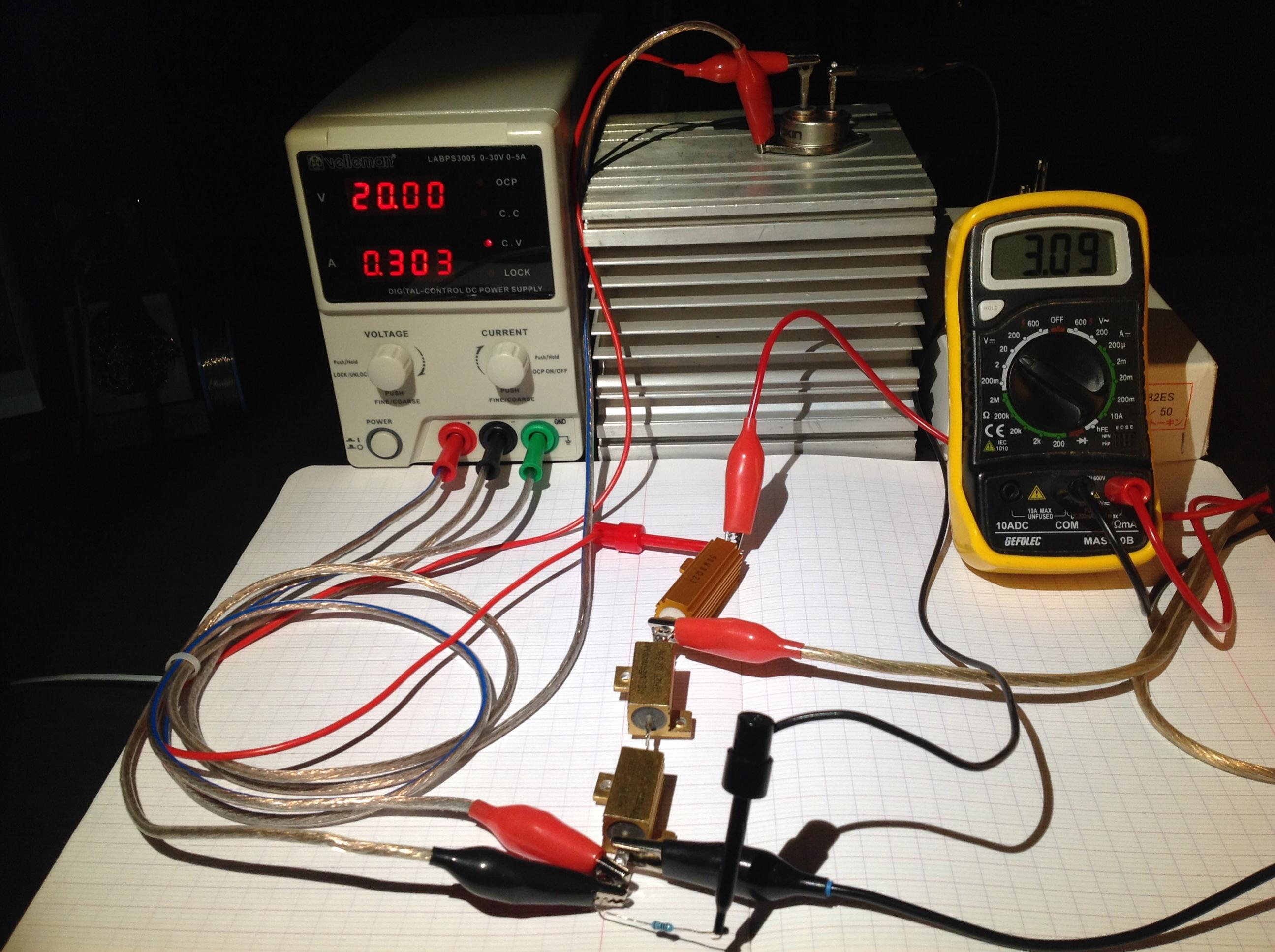

Test Step 2 (first 20 V with new power resistor value 8,2 Ohm+ 1ohm + 1 ohm=10,2 Ohm)
border="1"
| class="tcat"| #
batch nr
| class="tcat"| 20 V
||1||1Z2670 || 3,09 || 0,303
||2||1Z2671 || 2,81 || 0,275
||3||1Z2672|| 2,73|| 0,267
||4||1Z2673 || 2,91 || 0,285
||5||1Z2674 || 4,02 || 0,395
| class="tcat"| #
batch nr
| class="tcat"| 20 V

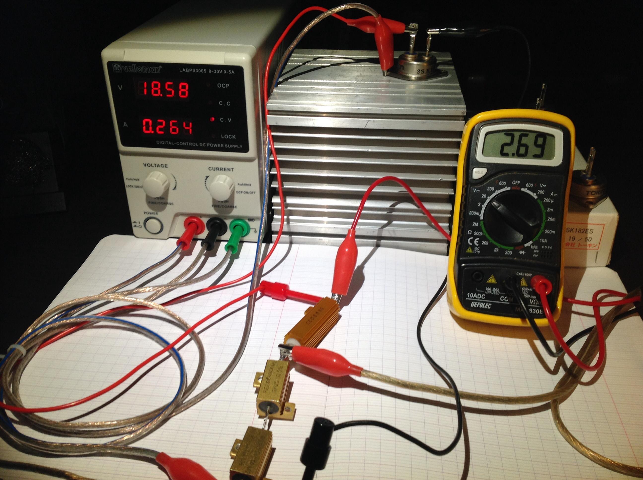

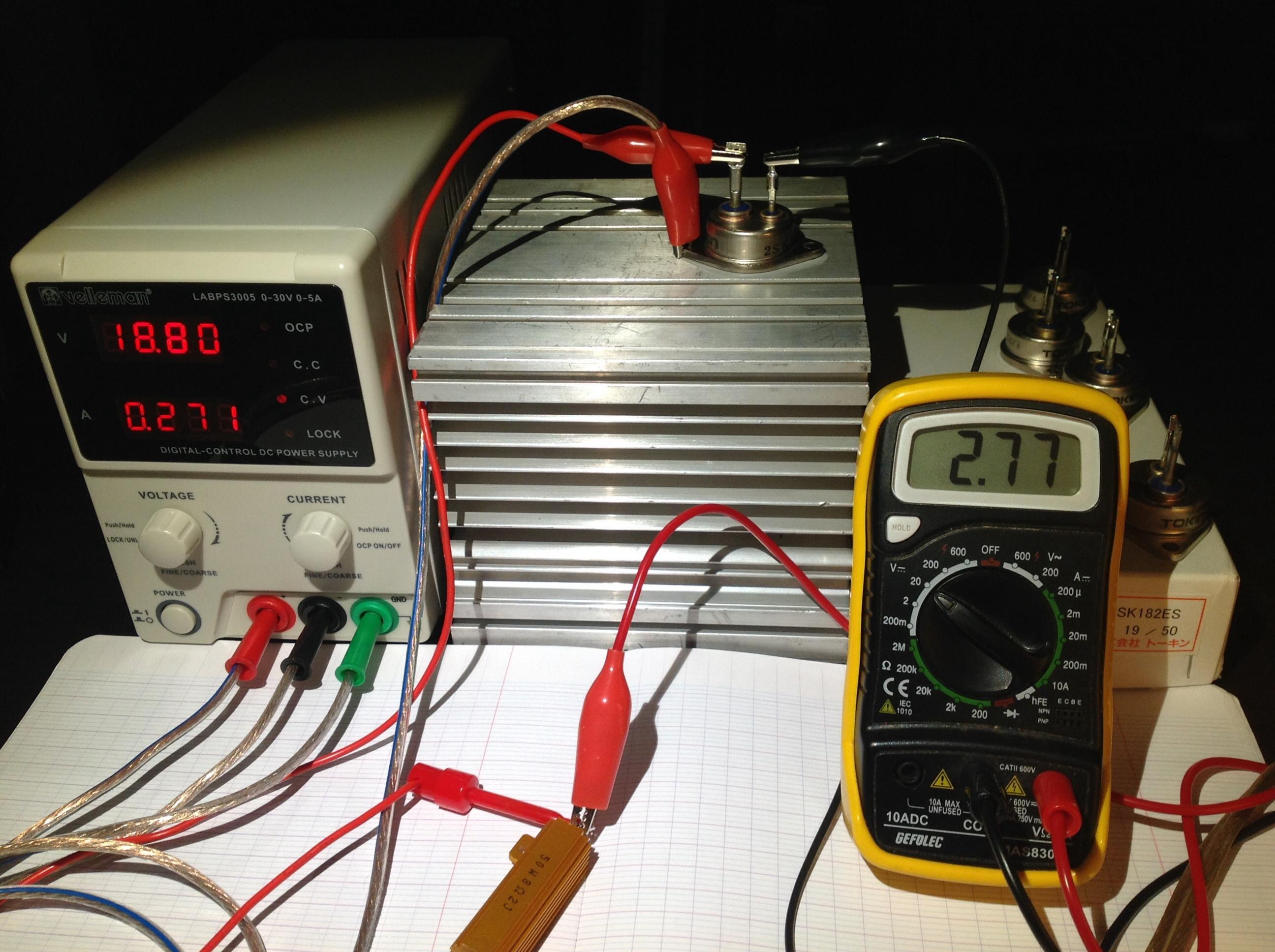

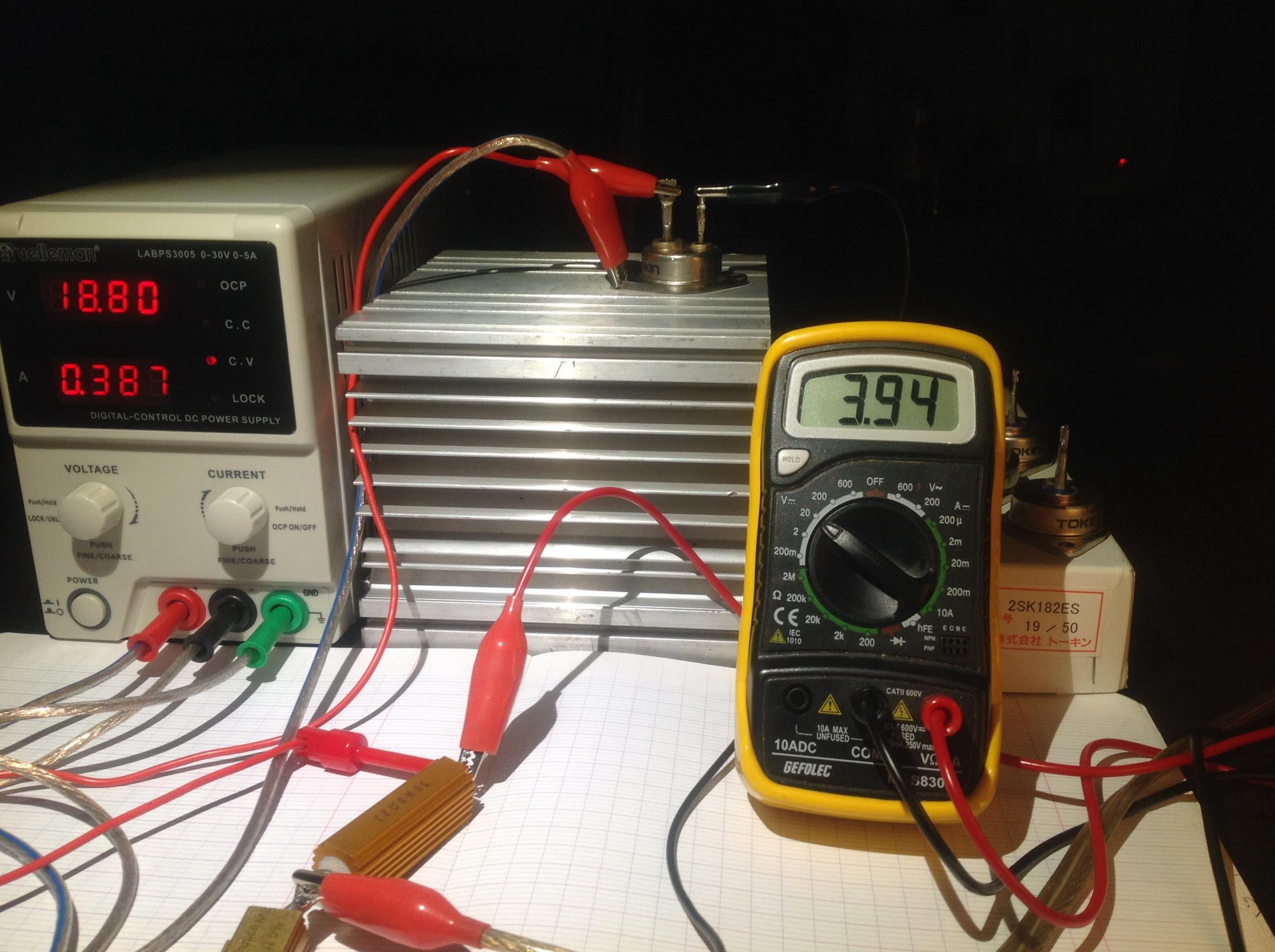

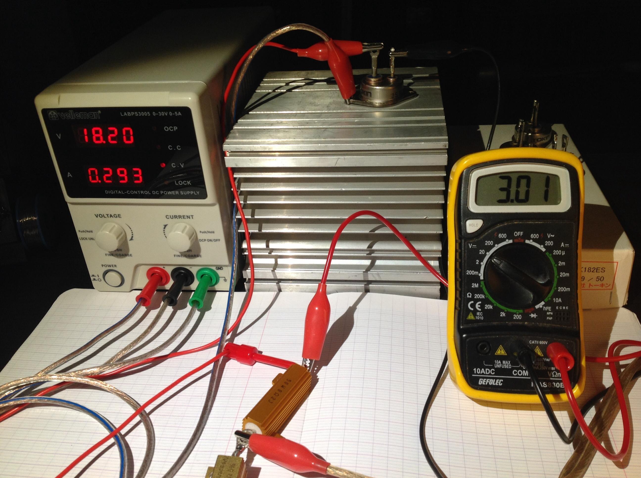

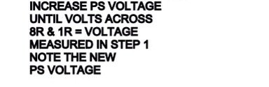

Test Step 2 (next phase with adjustement to find voltage from test step 1)
Some times tension are not precise around 0,01 Volts. All is correct ?
Anyway with curve tracer and other 2SK182ES received
datasheet things cristalise step by step.
Have a nice day 🙂

| class="tcat"| Voltage
Step 1
| class="tcat"| New PSU
Voltage
||1||1Z2670 || 3,01|| 18,20 || 0,293
||2||1Z2671 || 2,77 || 18,80 || 0,271
||3||1Z2672|| 2,69|| 18,58 || 0,264
||4||1Z2673 || 2,87 || 18,80 || 0,280
||5||1Z2674 || 3,94 || 18,80 || 0,387
Have a nice day 🙂

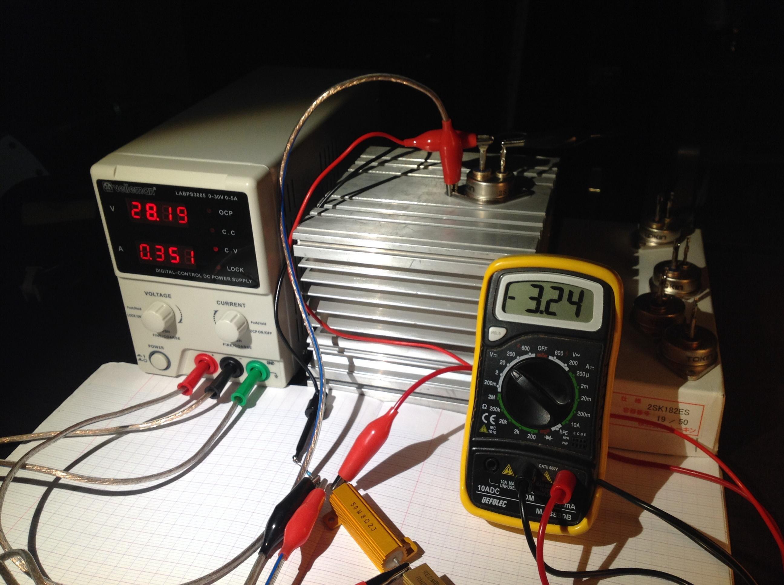

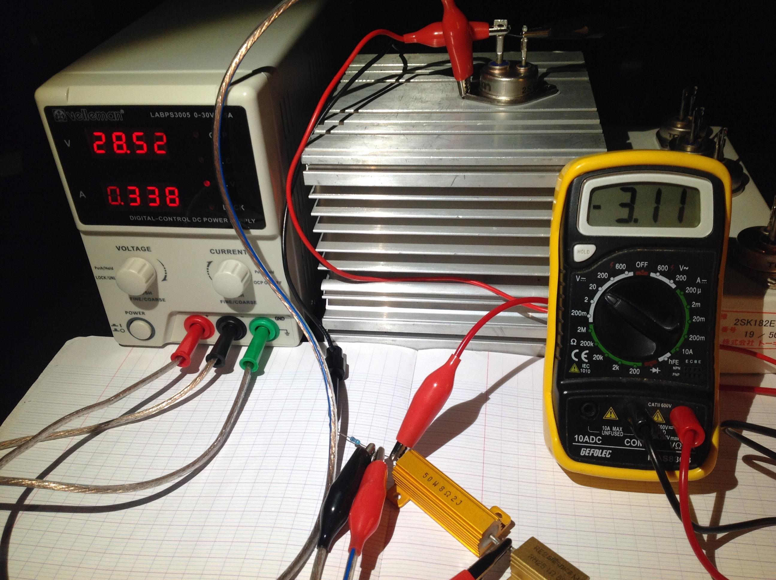

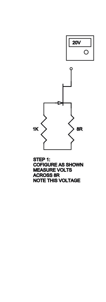

@soundhappy

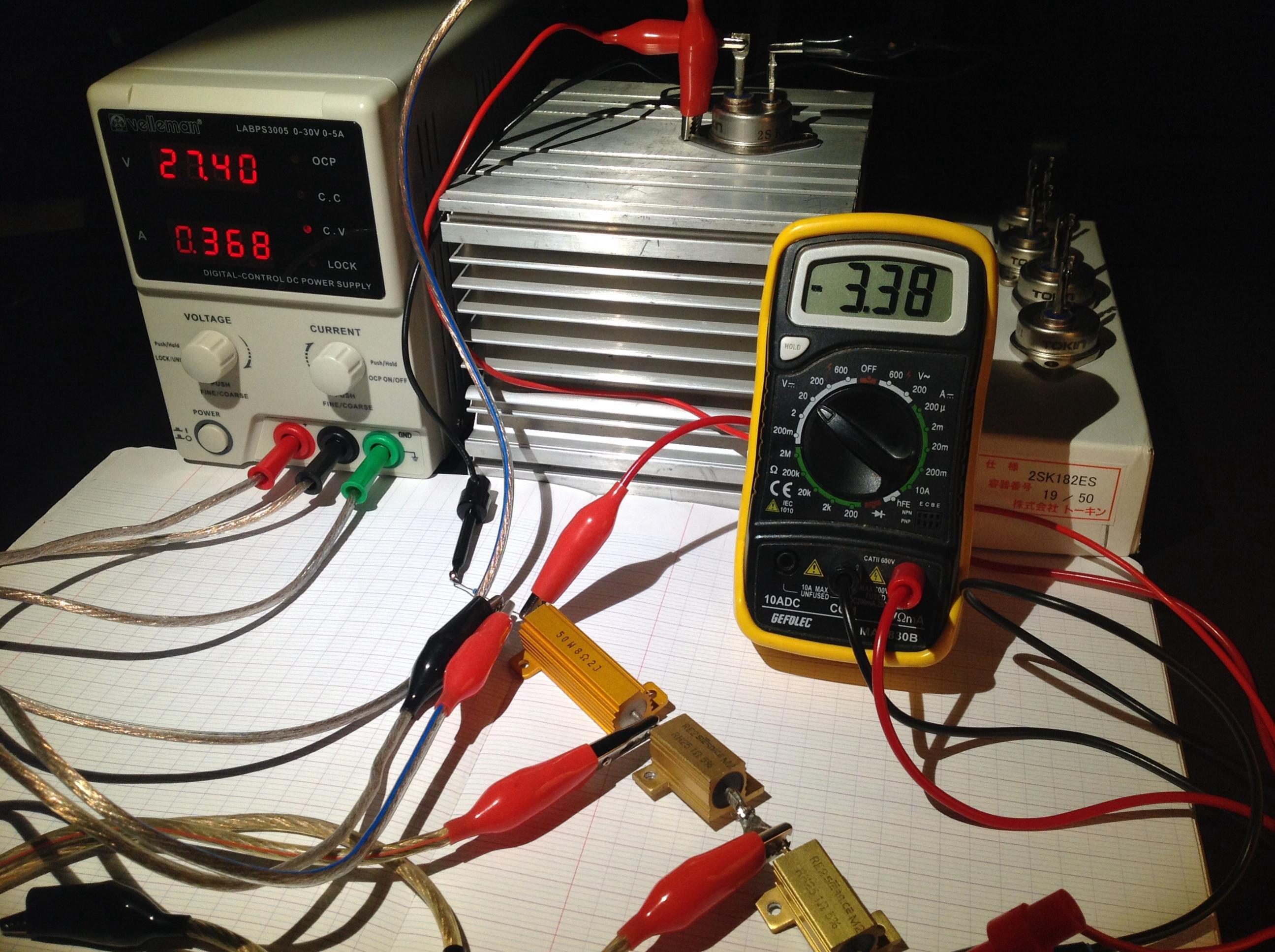

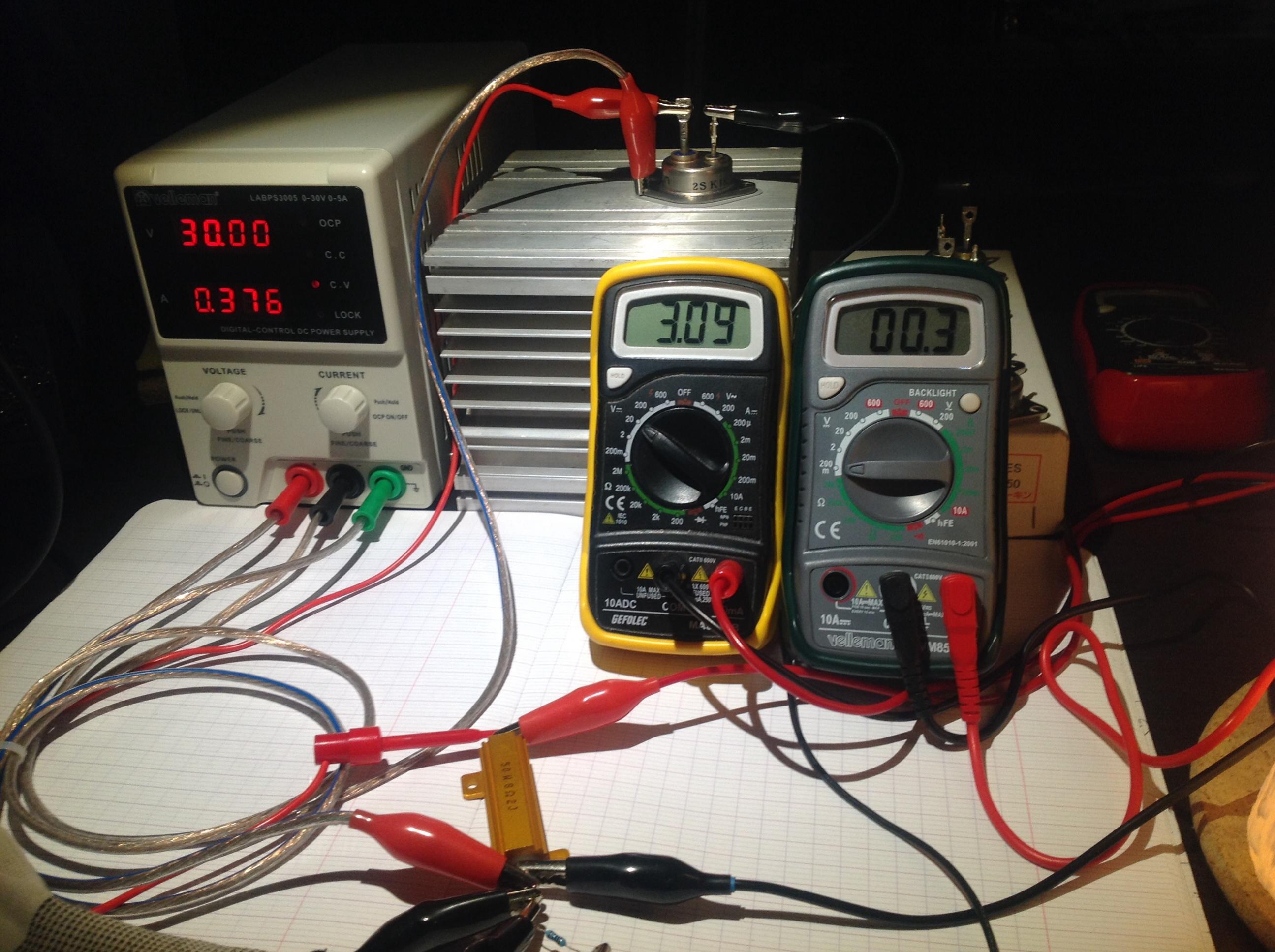

Thanks. I'll review and report back. Don't forget to get a set at 30V (original test).
Yes i report set 30 V / small 1K reading too@soundhappy
but with 10,2 or 8,2 ohm reading ??
Have made other with increased psu voltage
to find the same current with 10,2 ohm power
and was compare with 8,2ohm test results.
Just for fun good time 😀

| class="tcat"| Current 8,2Ohm
||1||1Z2670 || 3,38 || 27,40 || 0,368
||2||1Z2671 || 3,11 || 28,52 || 0,338
||3||1Z2672|| 3,04 || 27,32 || 0,330
||4||1Z2673 || 3,24 || 28,19 || 0,351
||5||1Z2674 || 4,42 || 24,51 || 0,483

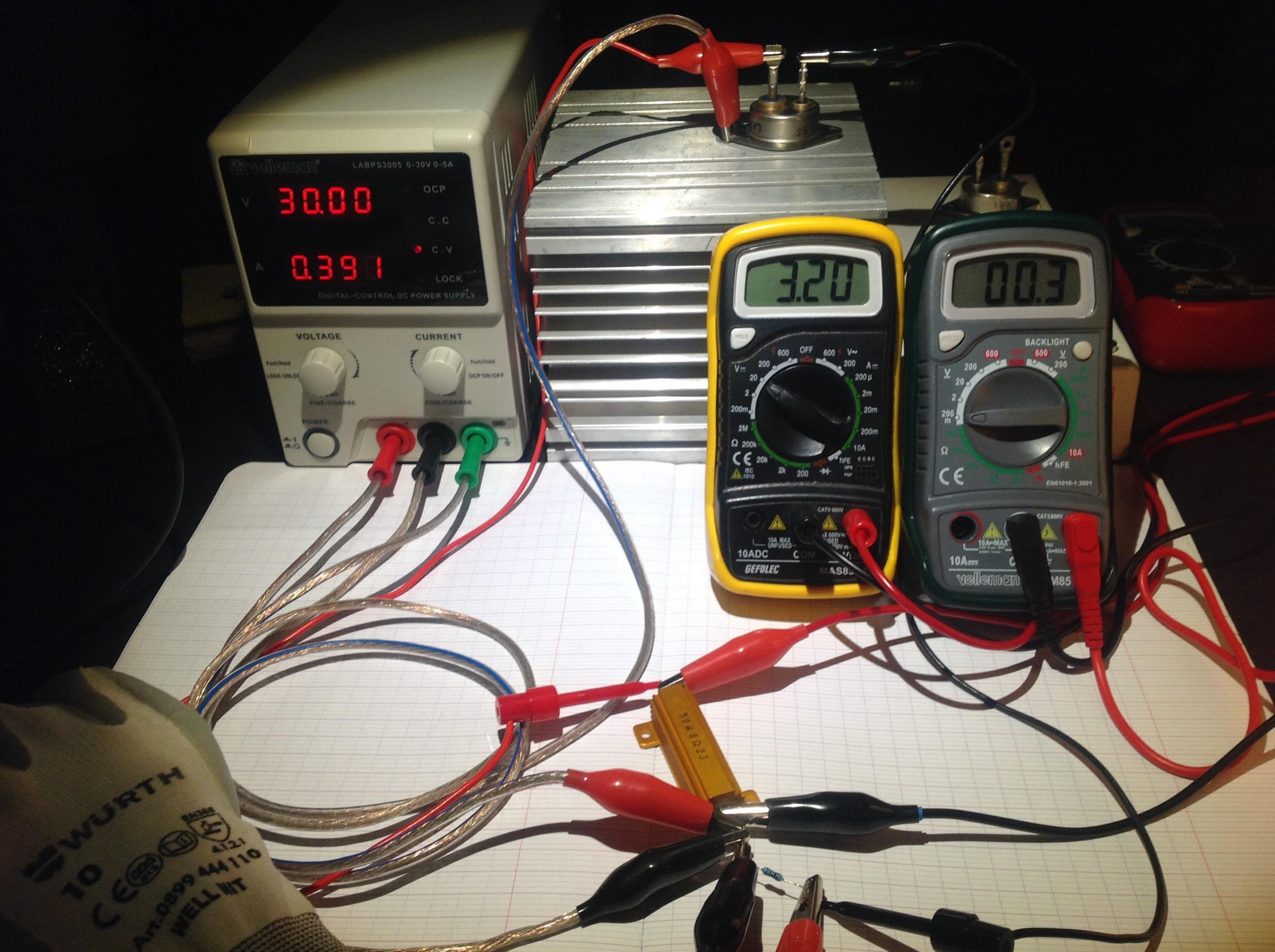

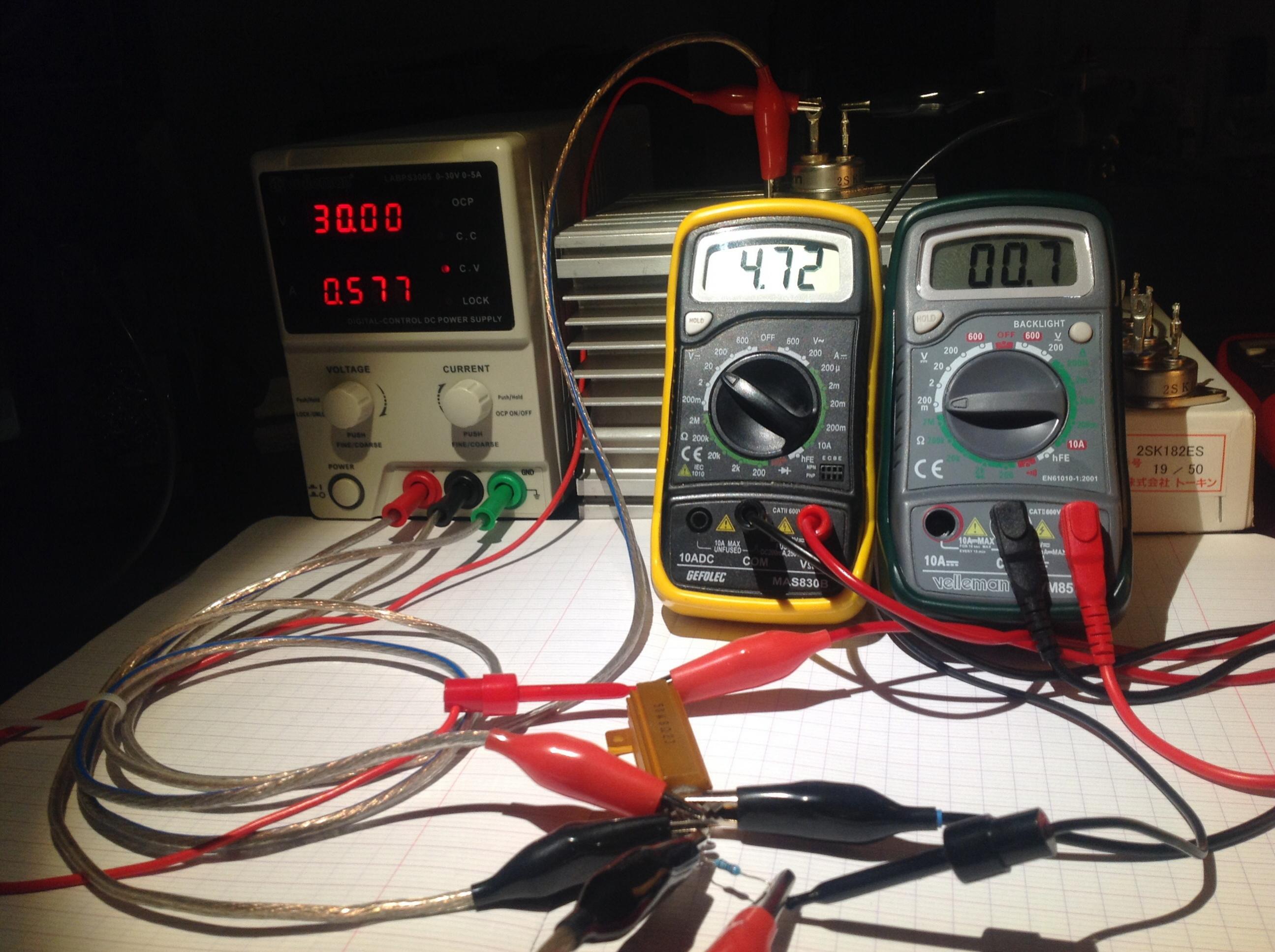

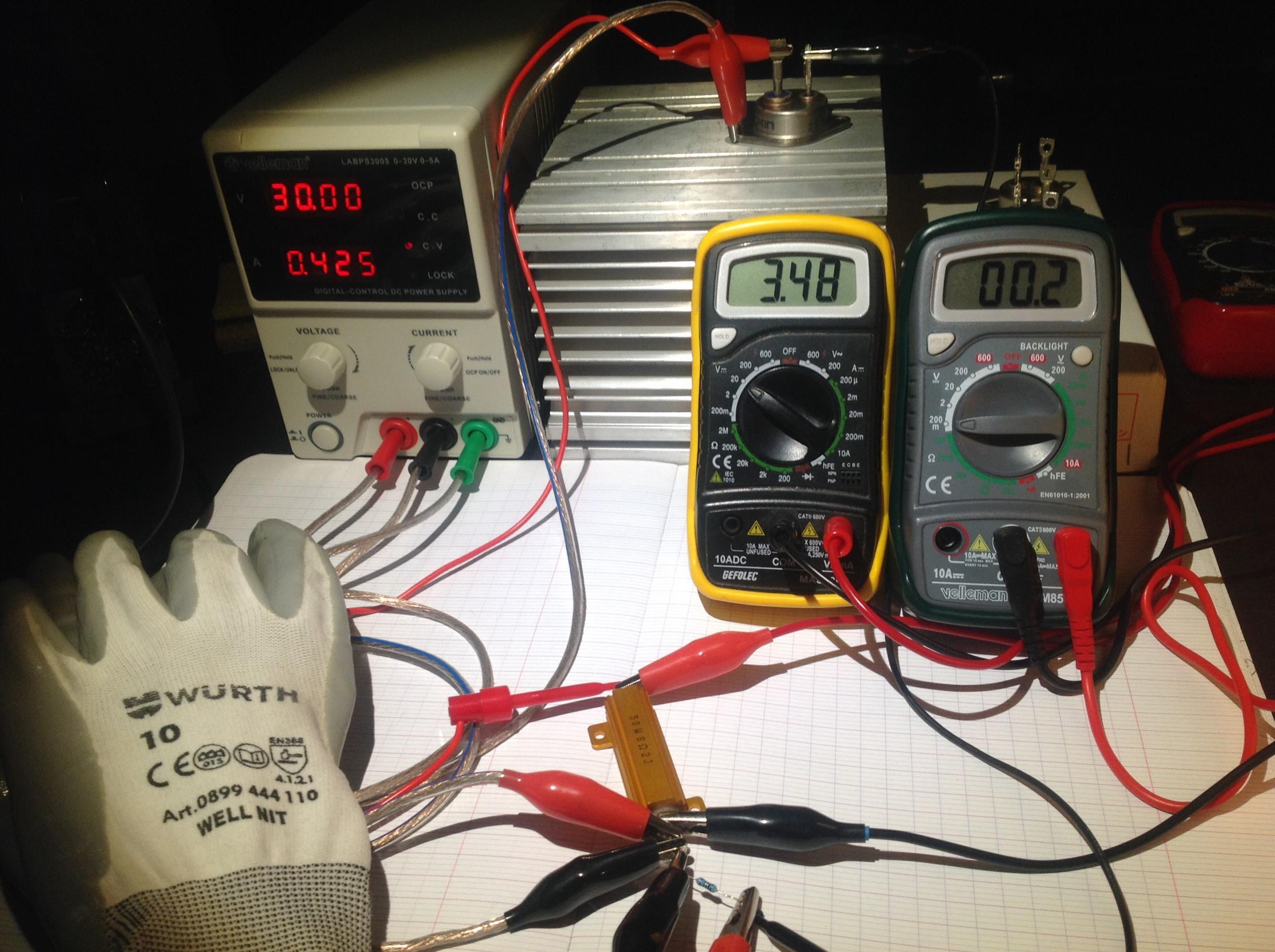

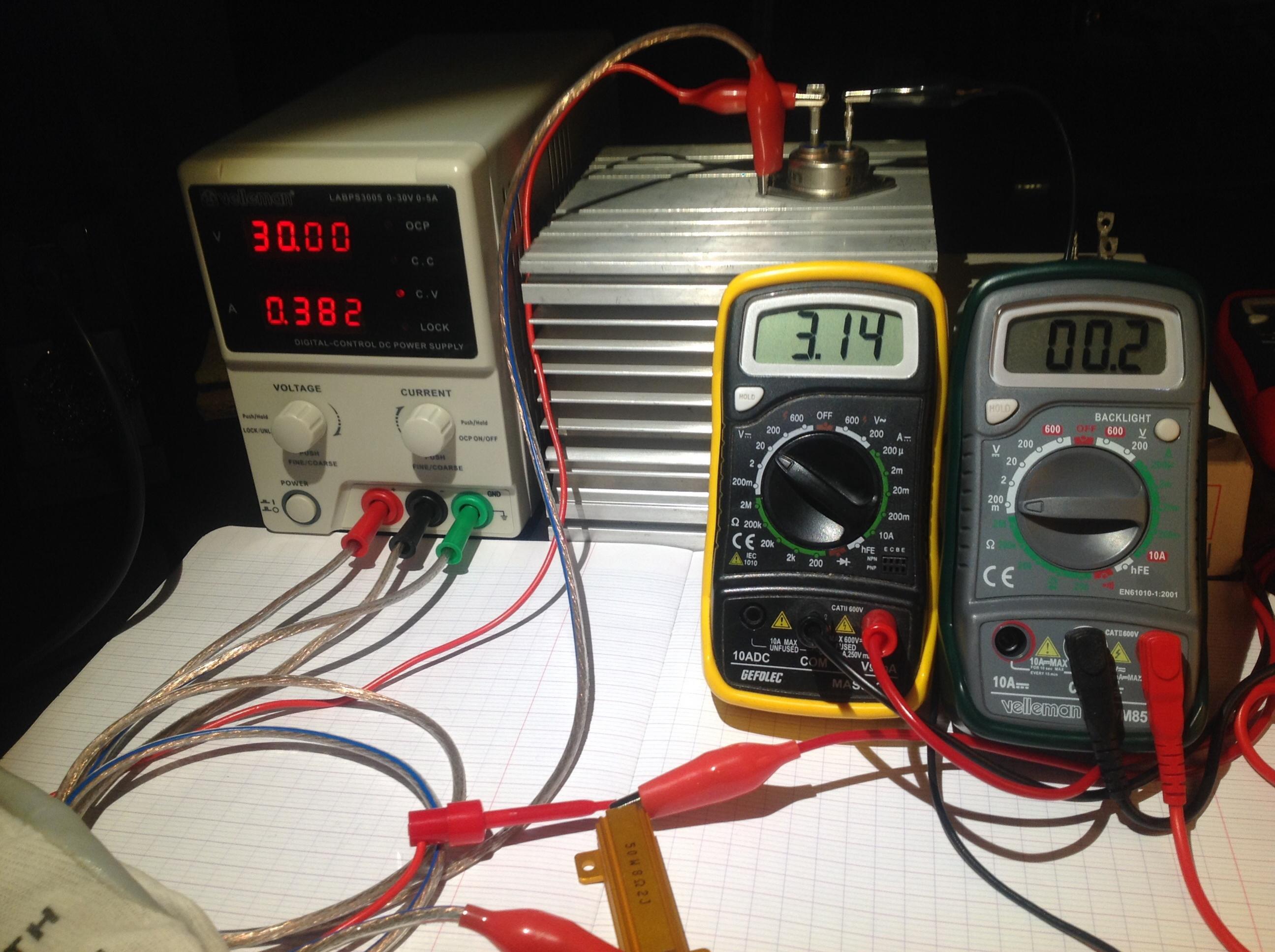

PSU 30 V test
with 8,2R ( left yellow )
with 1kR ( right green)
border="1"
| class="tcat"| #
batch nr
| class="tcat"| Voltage on
8,2ohm
| class="tcat"| Voltage on 1K
| class="tcat"| Current 2A max
||1||1Z2670 || 3,48 || 0,02 || 0,425
||2||1Z2671 || 3,14 || 0,02 || 0,382
||3||1Z2672|| 3,09 || 0,03 || 0,376
||4||1Z2673 || 3,20 || 0,03 || 0,391
||5||1Z2674 || 4,72 || 0,07 || 0,577

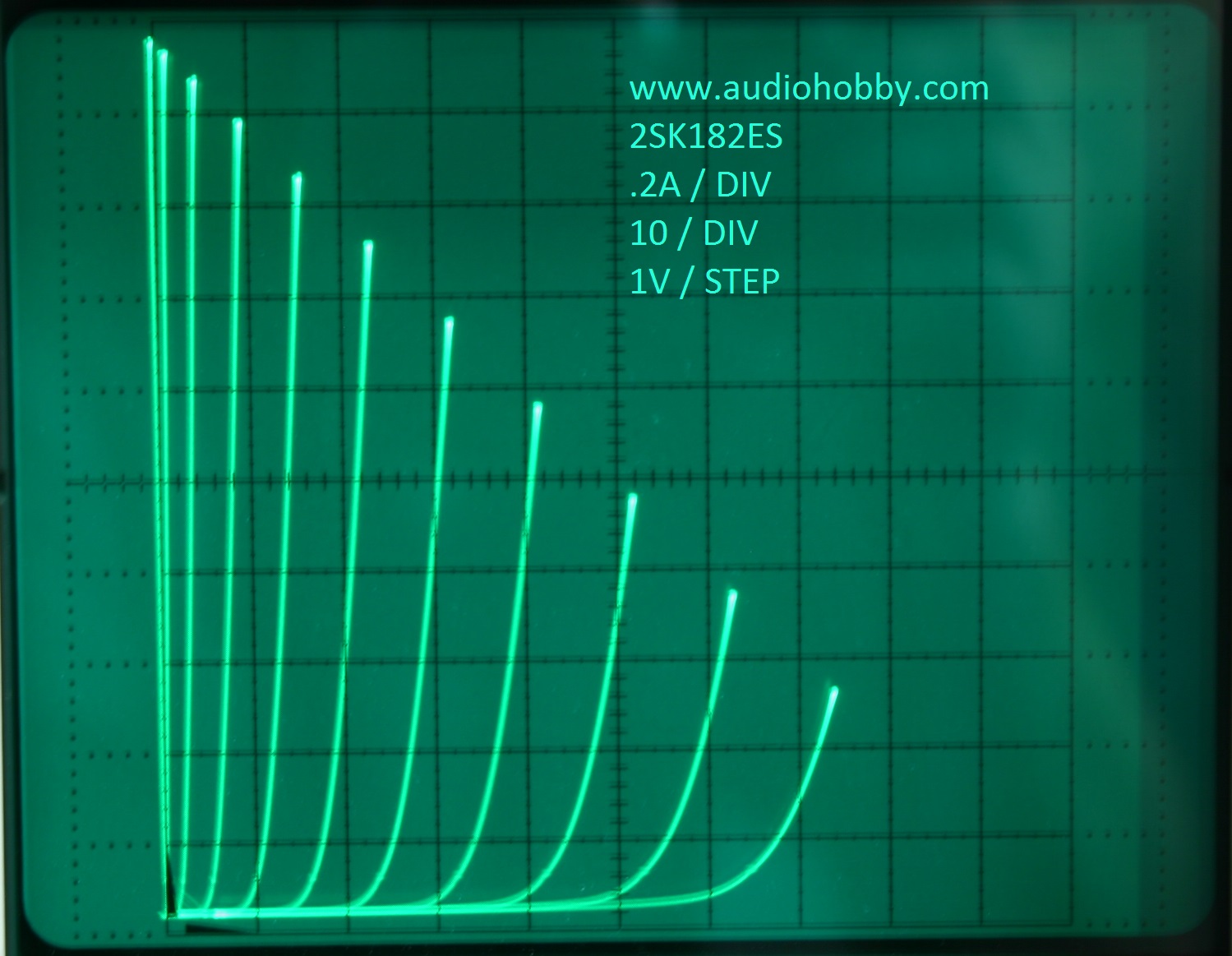

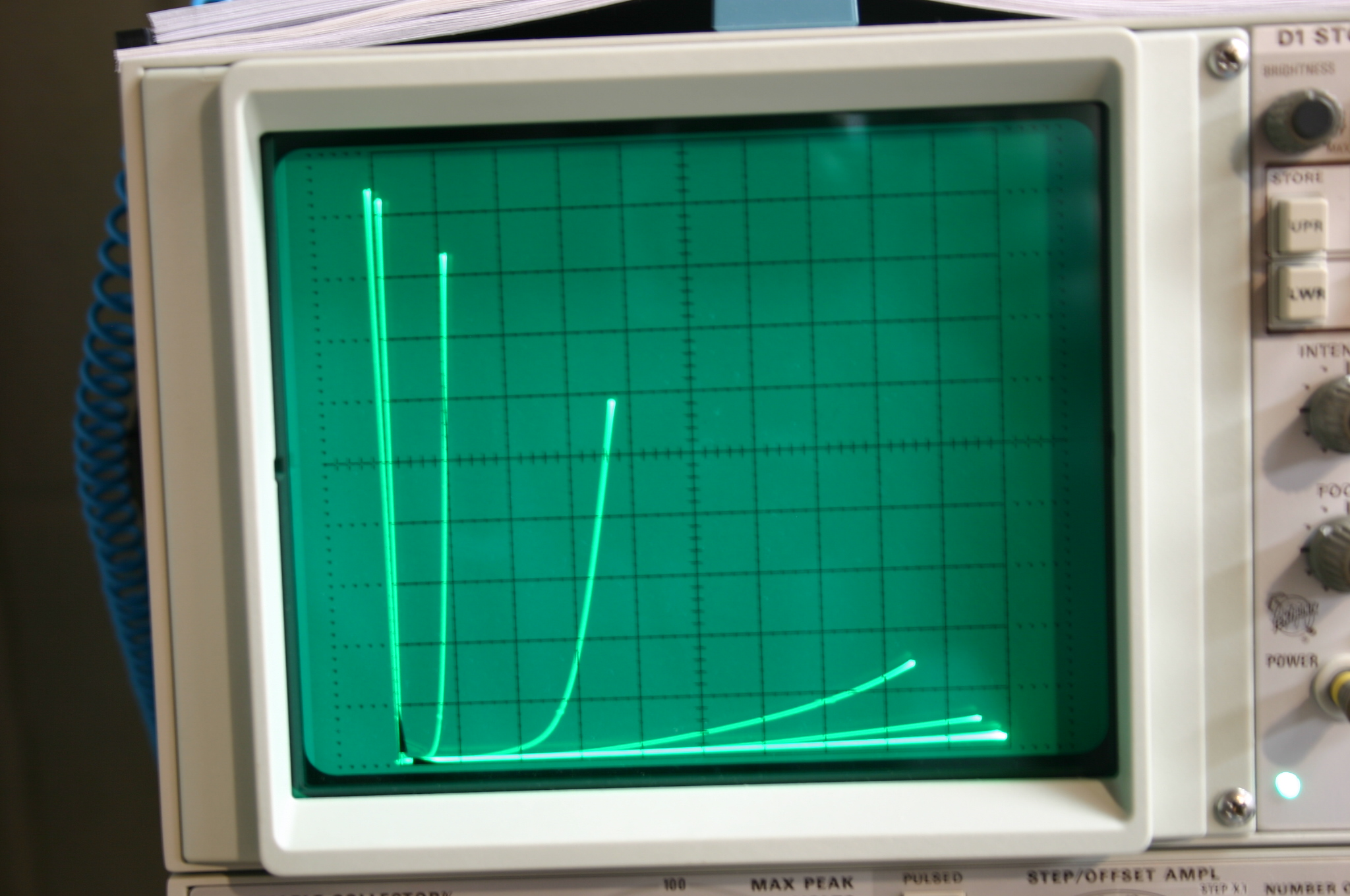

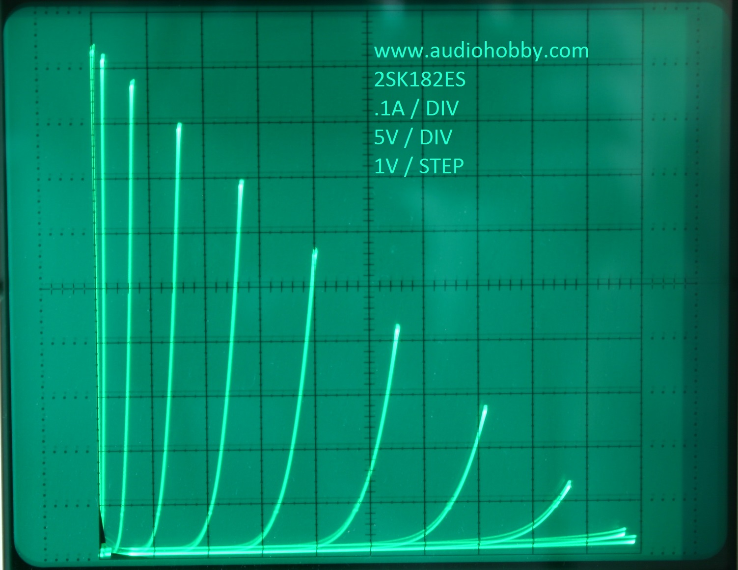

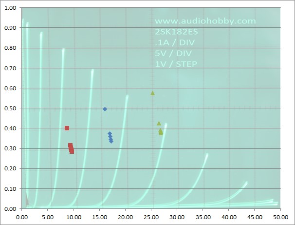

I have good news.
PSz sent me some of his 2SK182ES for testing and they look great!
So, my parts were bad, as I suspected. It happens. I will drown my sorrows in a beverage of some sort.
Here's what a good 2SK182ES looks like:
And... congratulations soundhappy, it appears you have good parts, so we can get busy designing a little amp for you 🙂 Be sure to thank Paul for trusting me with his transistors.
