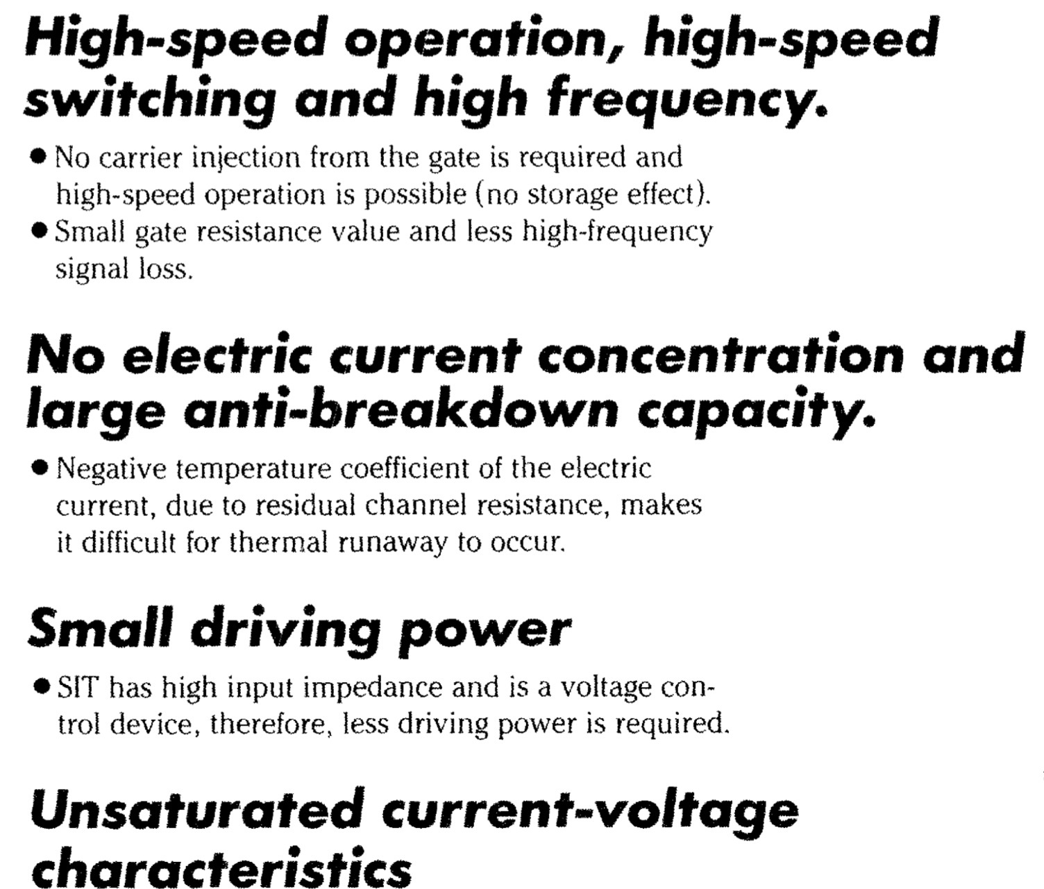

Any comments on Tokin datasheet interesting points ?
and next question : what influence of turn on/off switching time in micro seconds ?
Dady's sit's THF 51 have very short 50 micro seconds and 180, 182 five times more.

This datasheet was directly from Maxonic Sibatec
great guys i find it in email
Anyway nothing better like mesurement on bench.
