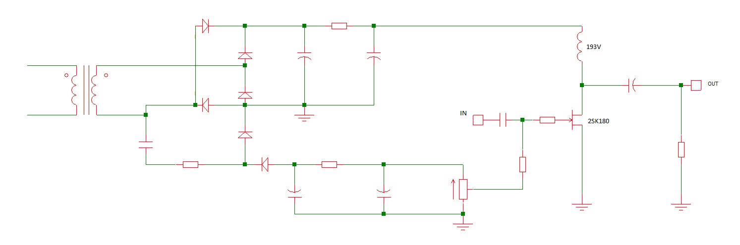

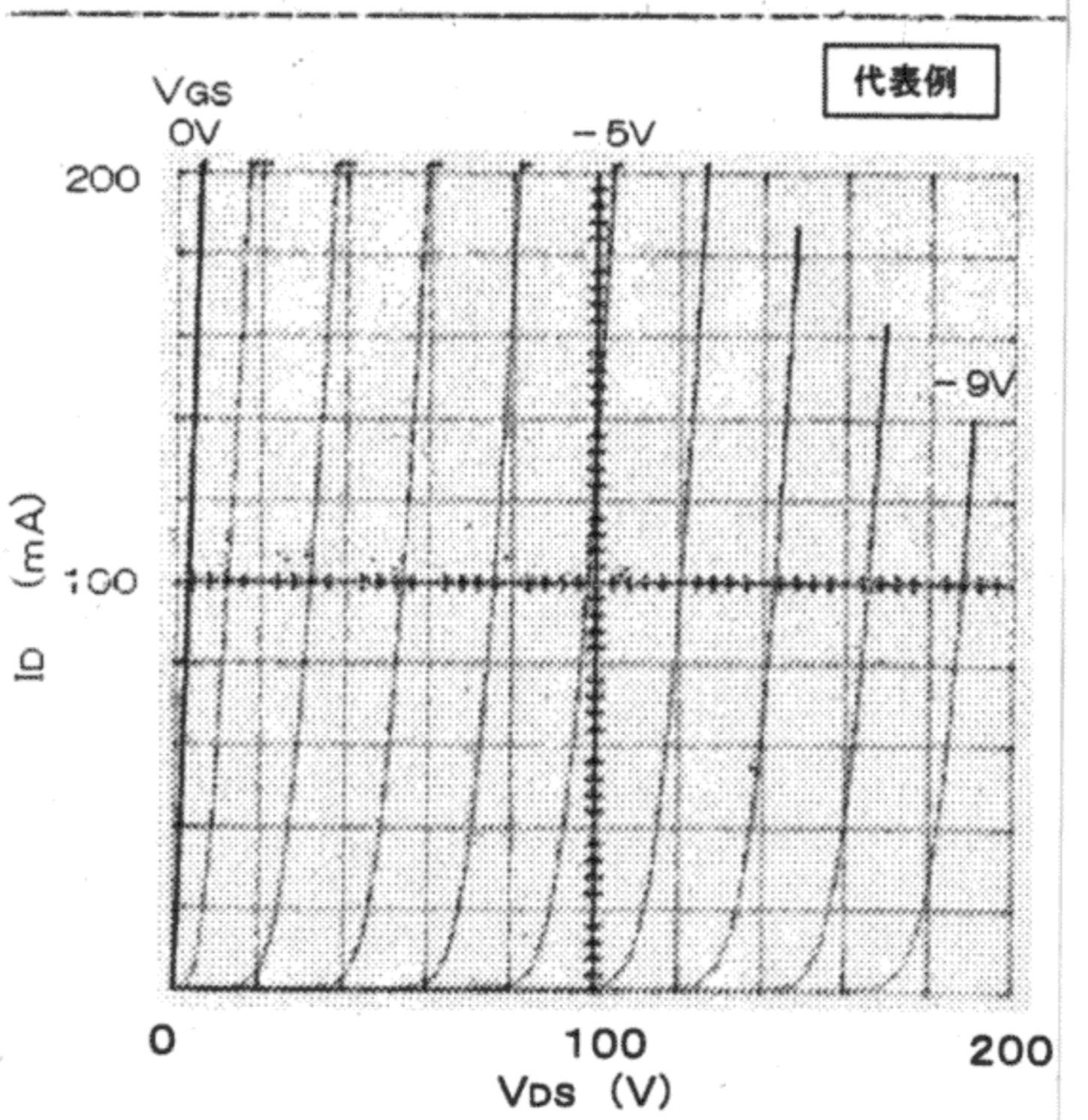

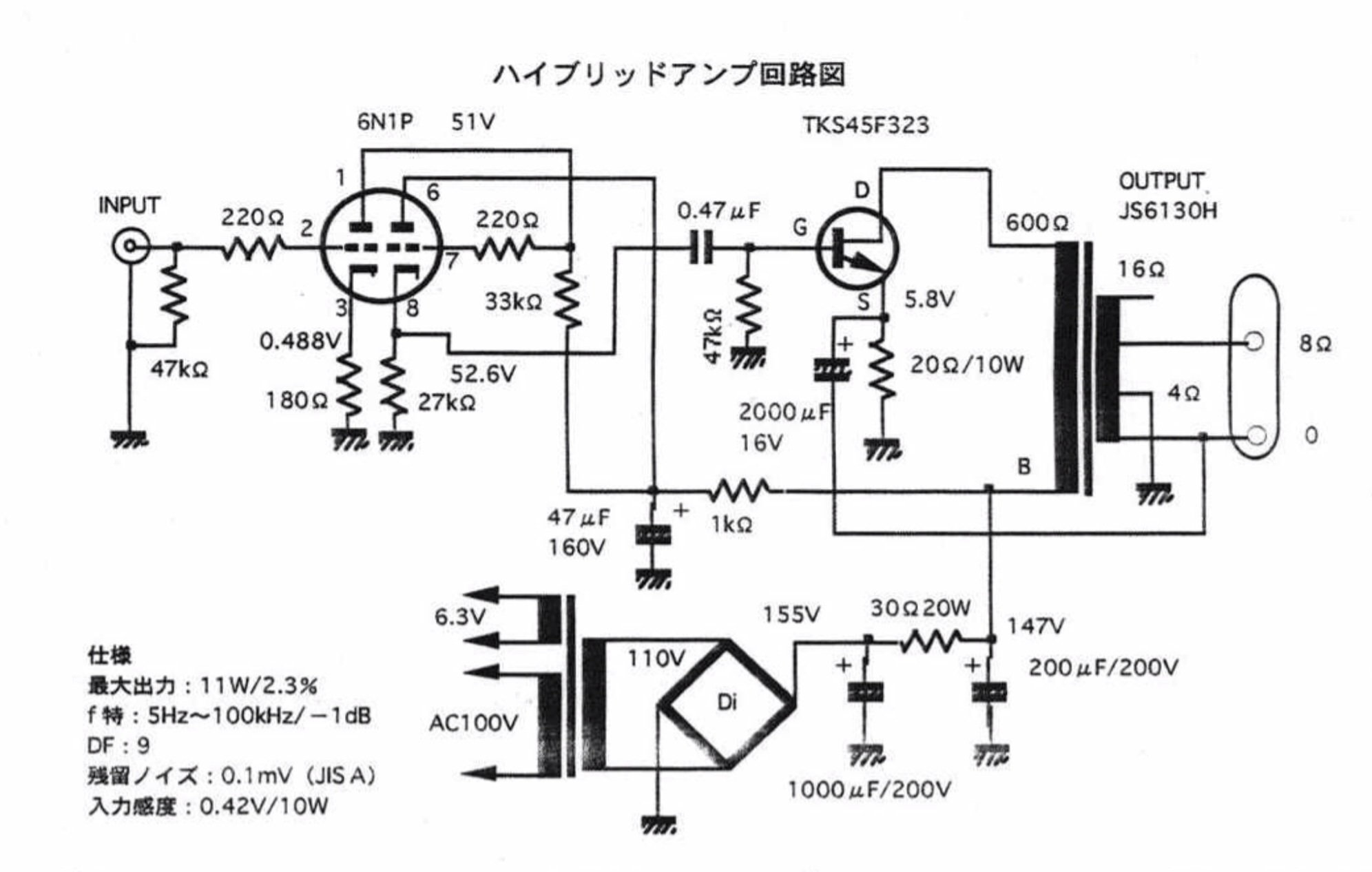

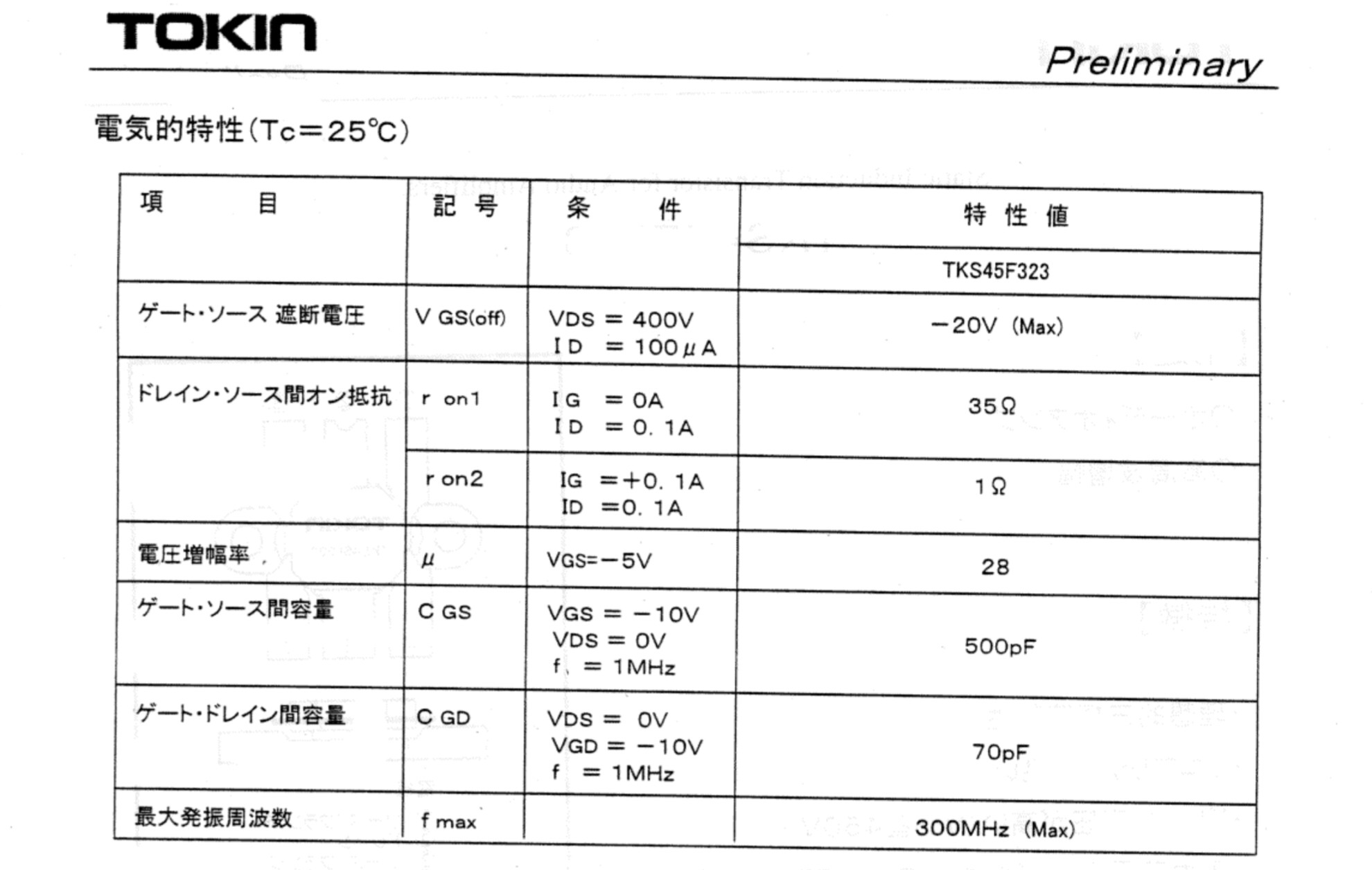

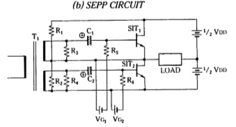

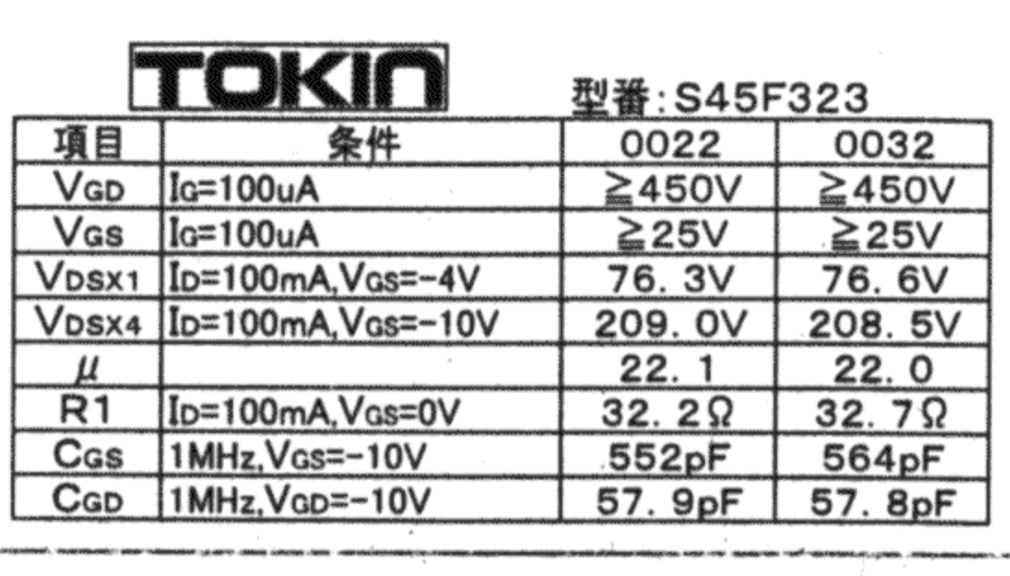

In the absence of Sea Ranch secrets here are the circuits swimming around my head these days. Gathering parts and planning layouts...
That SEPP circuit is straight from a Tokin app note.
The other circuit was lifted from a DeLite thread and lightly modified. I like the bias portion, just need to wire it so that a scratchy or open pot wont cook the SIT.
Kewl stuff 🙂
Sort of a "SIT F6" kind of thing there. Does the app note provide any interesting insight?
Check out Gerd's little bias arrangement too.
Ah yes, that is another favorite. I found a nice page on back bias:
What is Back-Biasing?
Edit:
App note doesn't really have any new info. It just presents that circuit as is, but it shouldn't be too hard to fill in the blanks.

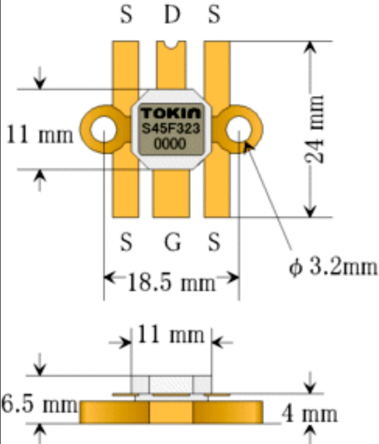

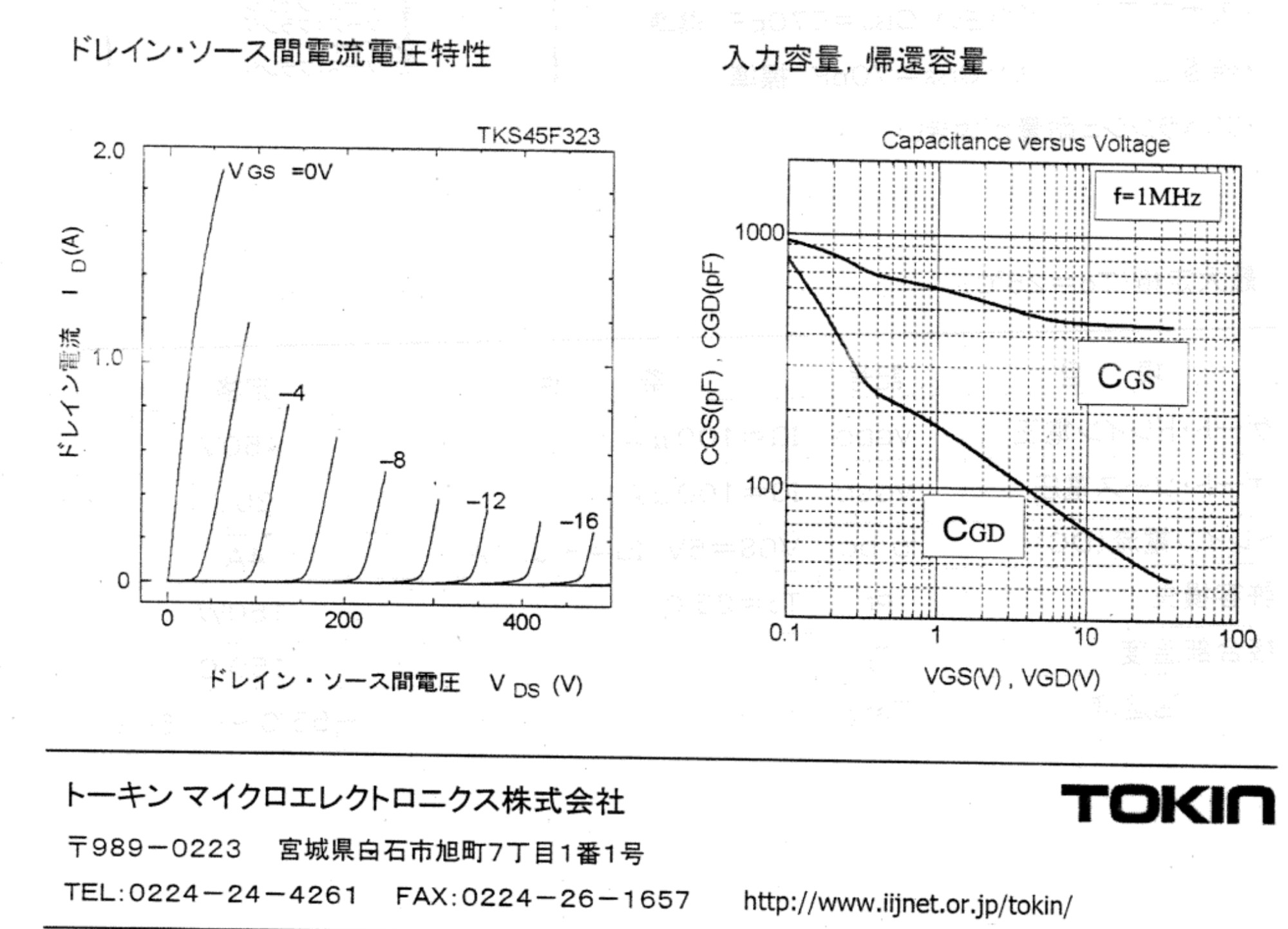

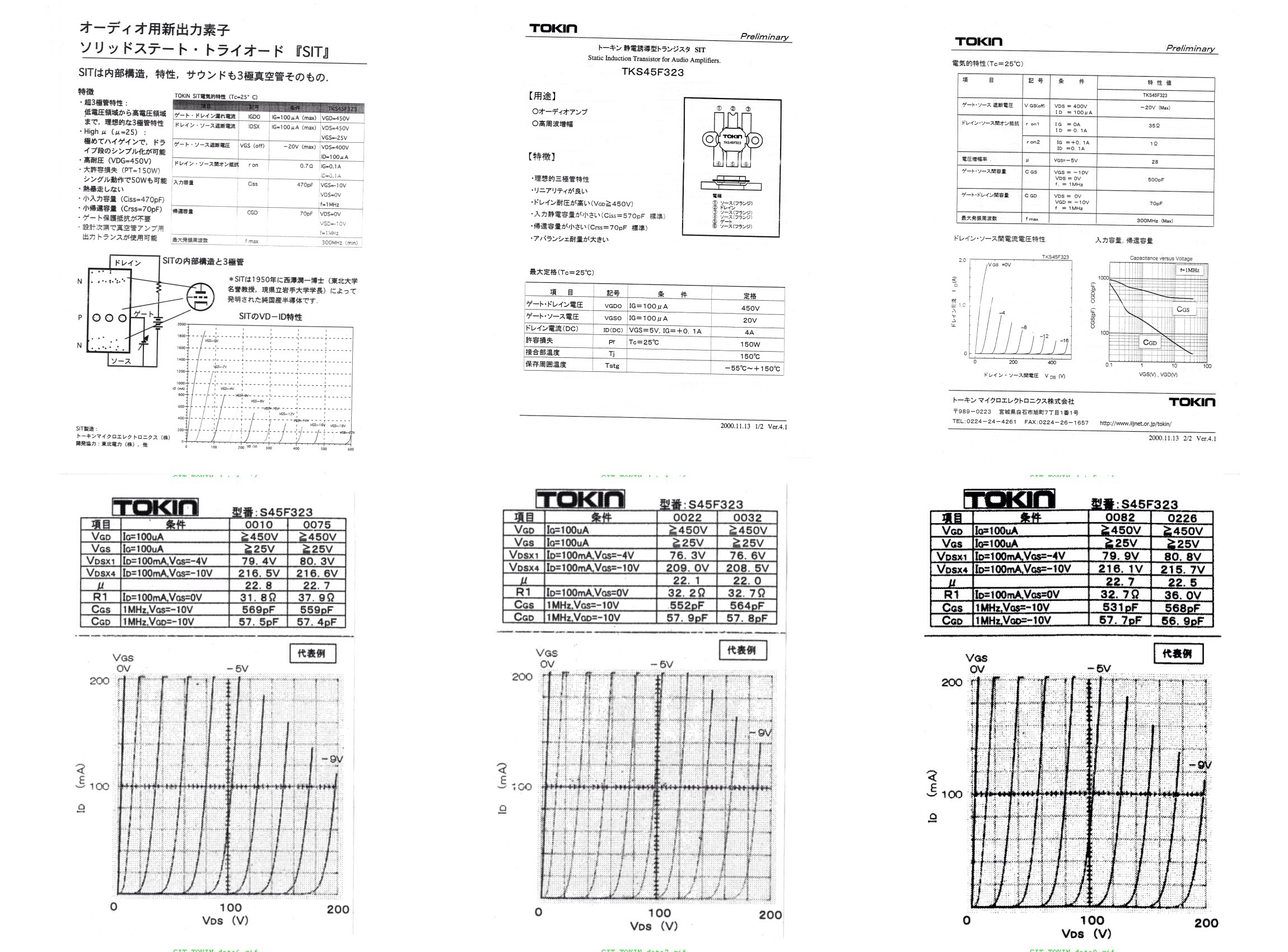

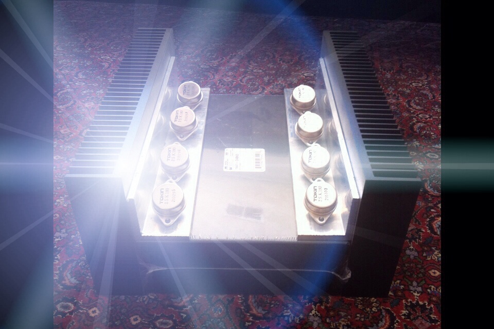

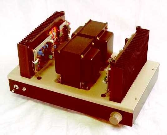

Its just for inspiring Diyers about sit amps topologys.
I don't have any but maybe we find together
So many secrets with Tokins to explore
Best regards 🙂

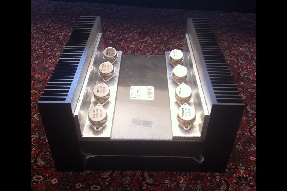

SIT OTL No.1
Best regards 🙂
SIT OTL No.1

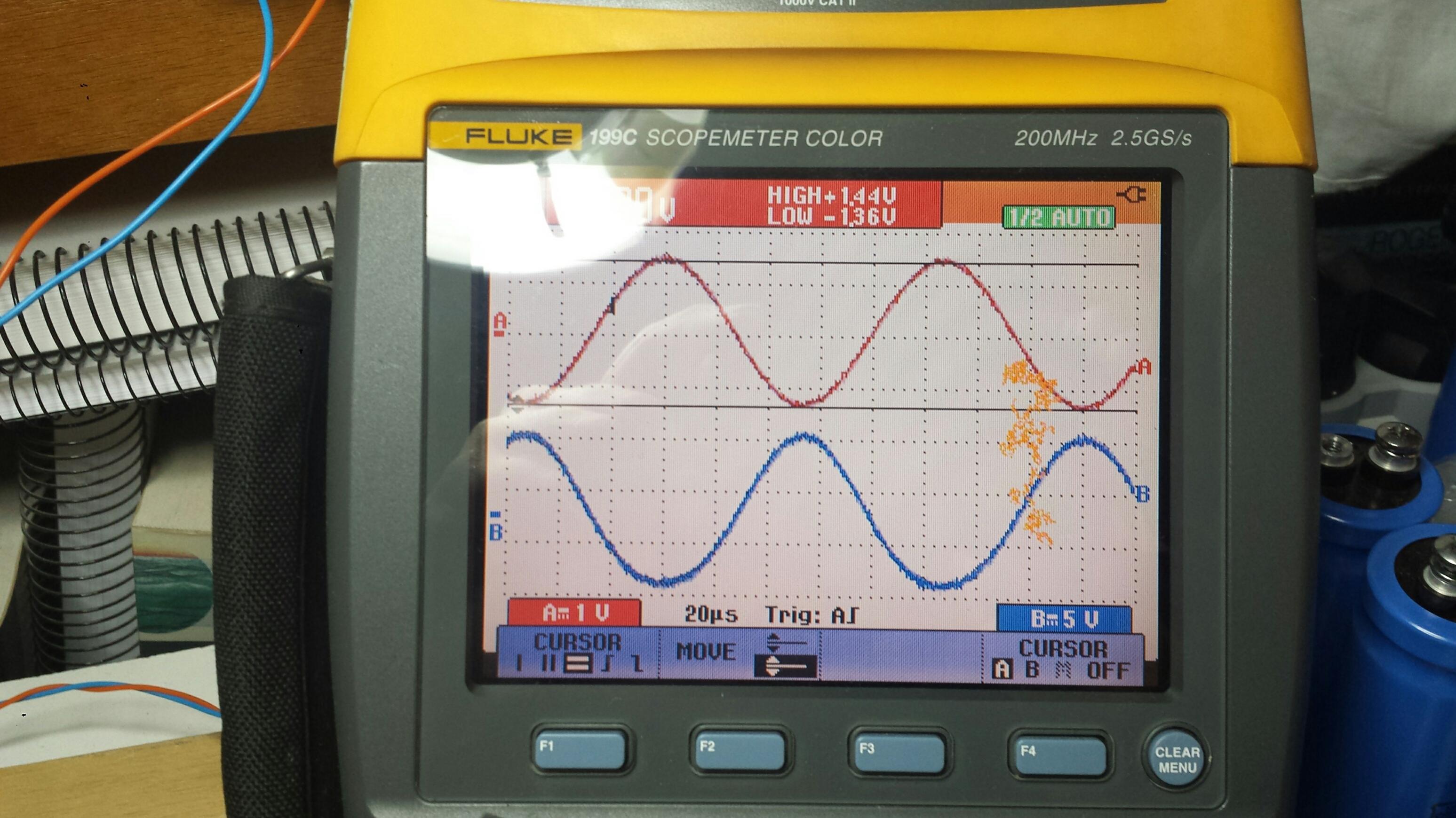

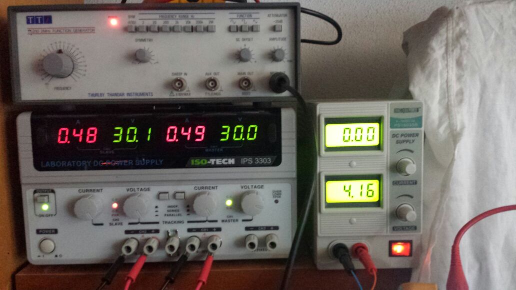

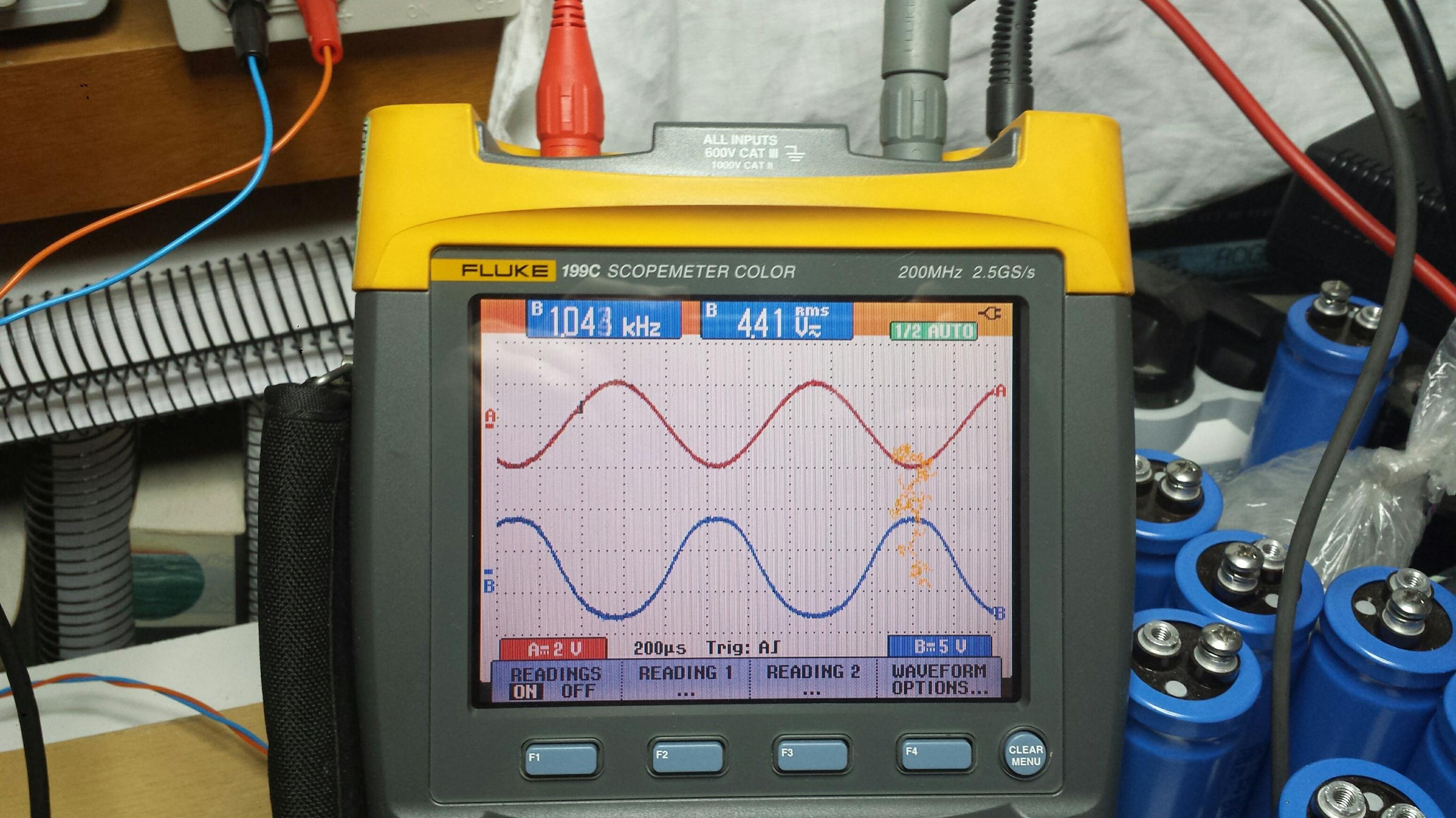

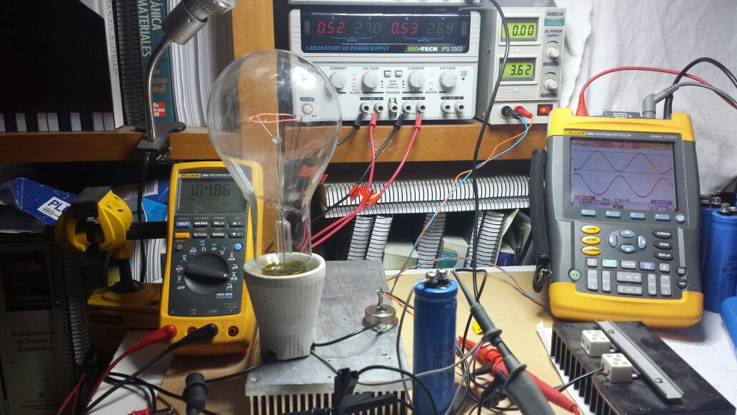

Hello all. I have build lamp amp using 2sk182. Results are very exciting... Power supply are two PS in parallel and 30V, one 500W 150V bulb and 8 ohm resistor.
Very interesting 2SK182ES on lab bench work .Hello all. I have build lamp amp using 2sk182. Results are very exciting...
Congratulation and please send us more results
about sweet spot and findings.
Thanks Jama. Kindly regards

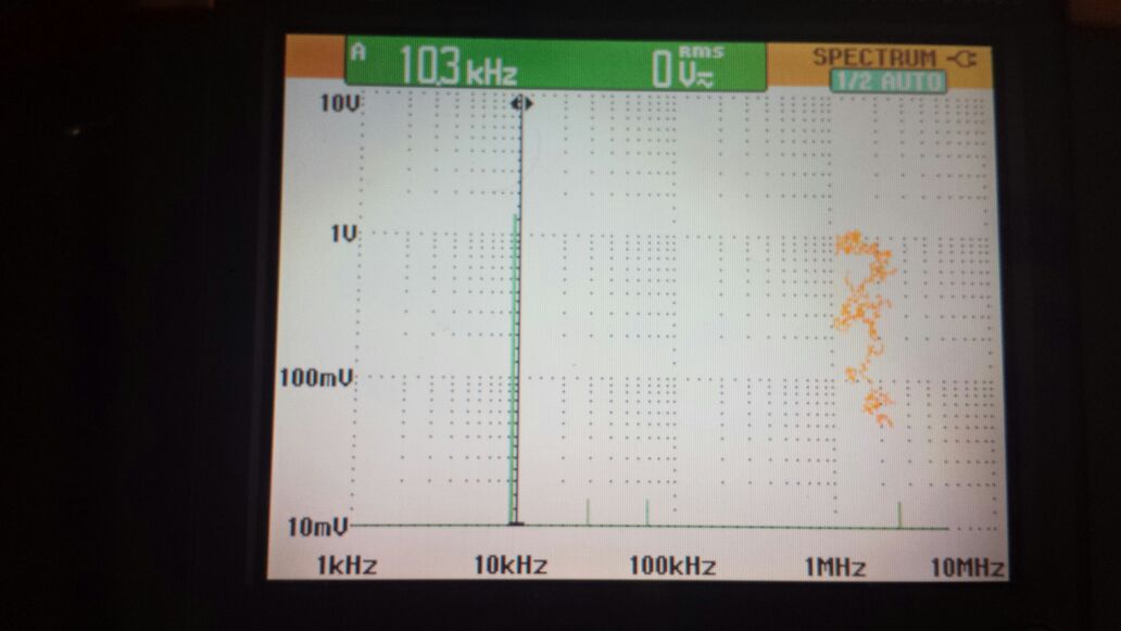

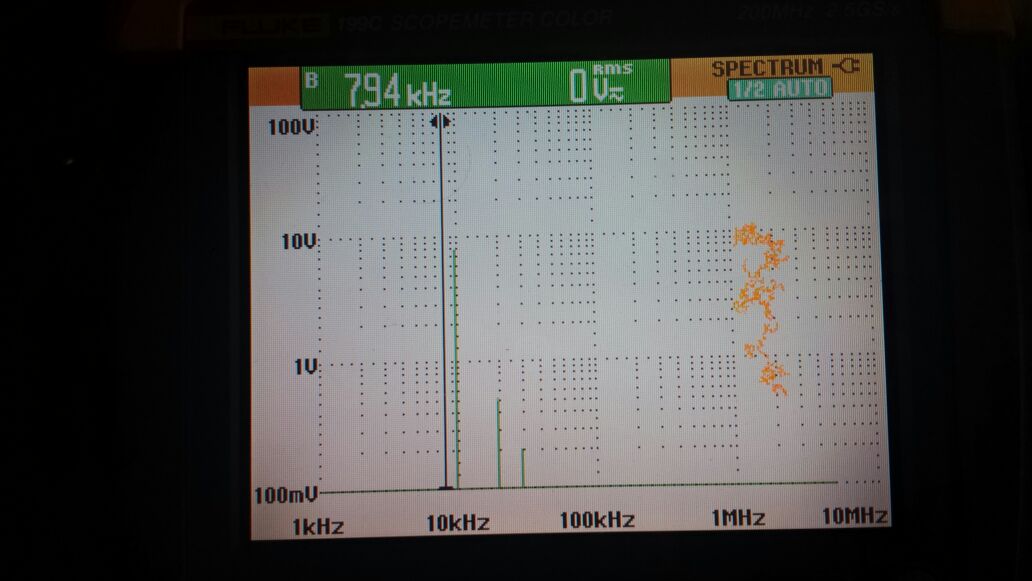

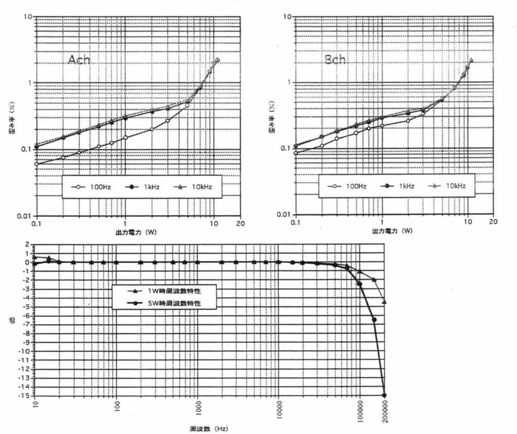

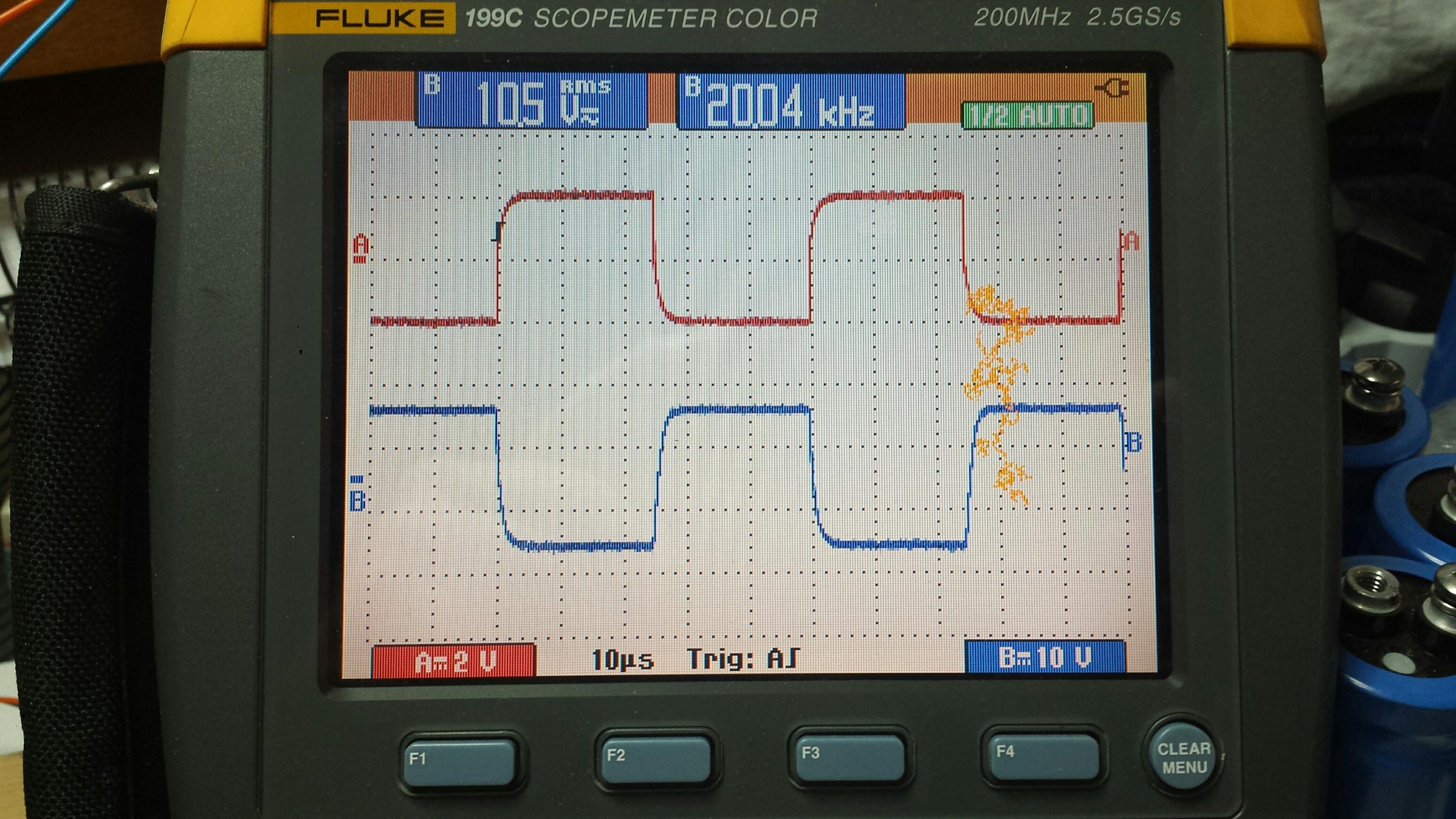

From other freq I did spectrum using scope tools. One image is input and the second one output. Second and third harmonics...

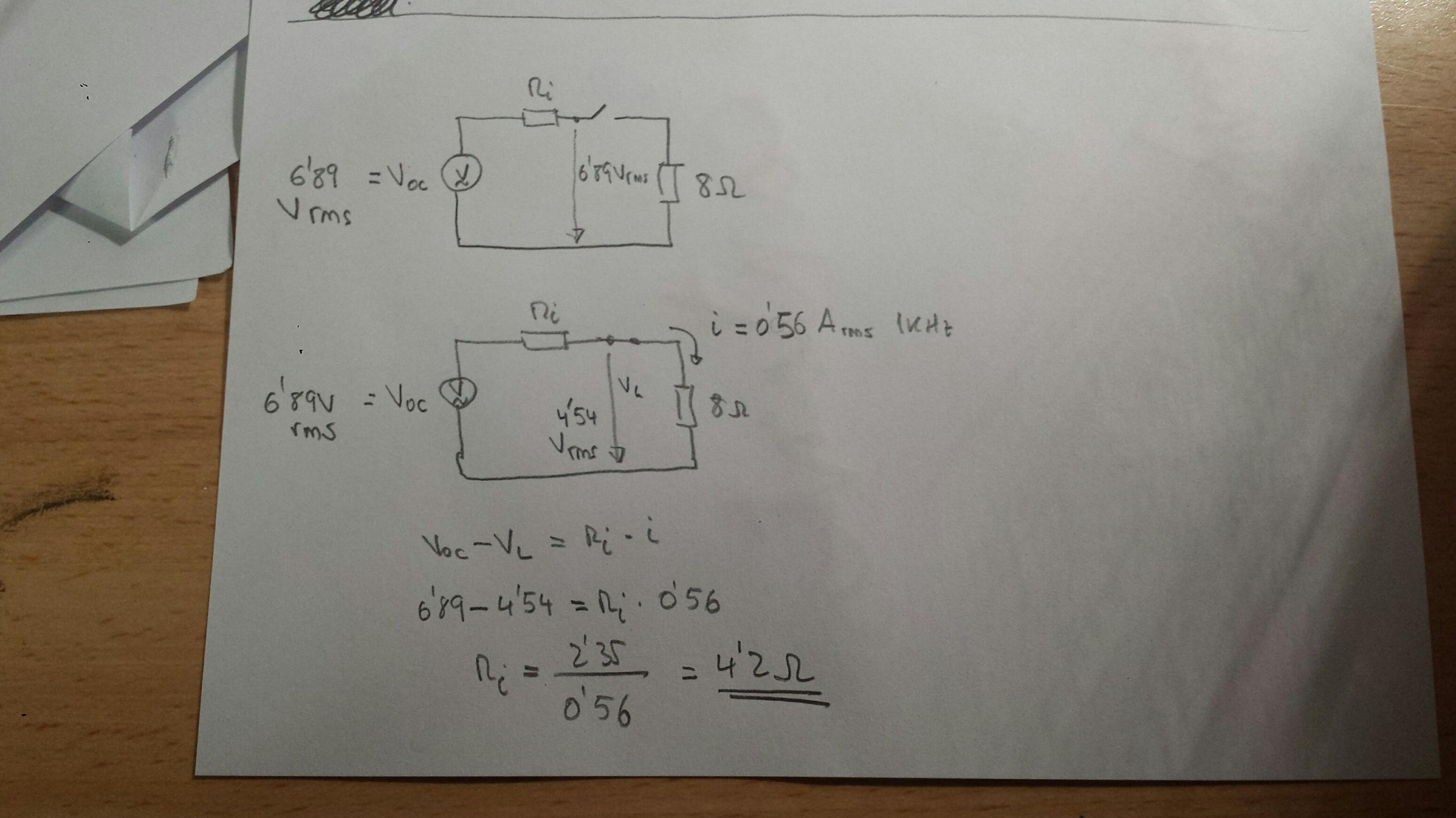

Very cool jama - what was the output voltage when the reading was made ? (Rms/pk-pk?)
Also see if you can measure the output impedance of your amp ...
