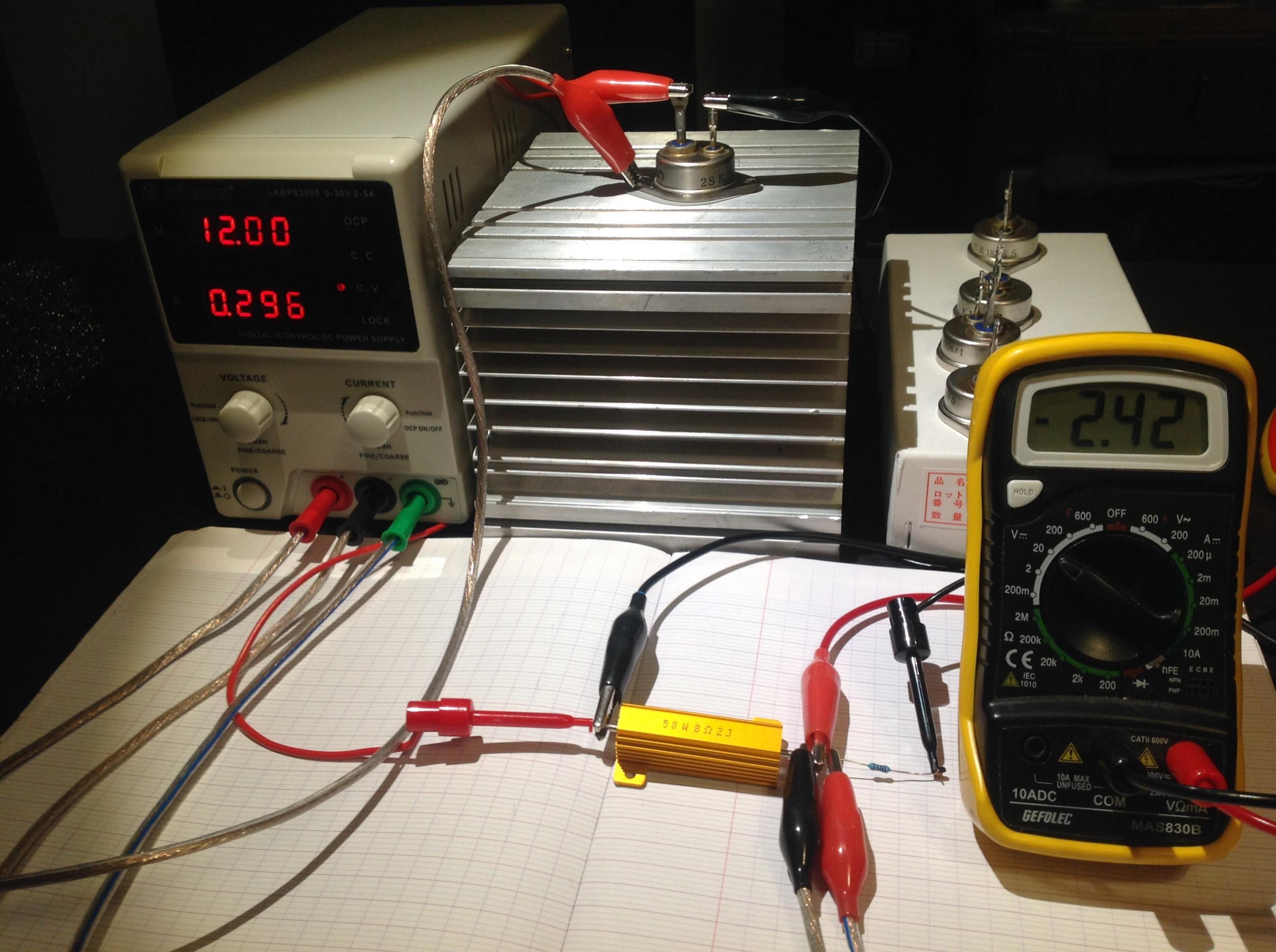

Hi Michael
Received 8 ohm 50 watts today and i am ready to test 2SK182ES
this evening just last question :
ground are connected with (-) on lab psu ?
Thanks for answer.
Best regards
Christophe
Yes. And I tied (-) to safety ground in the video.

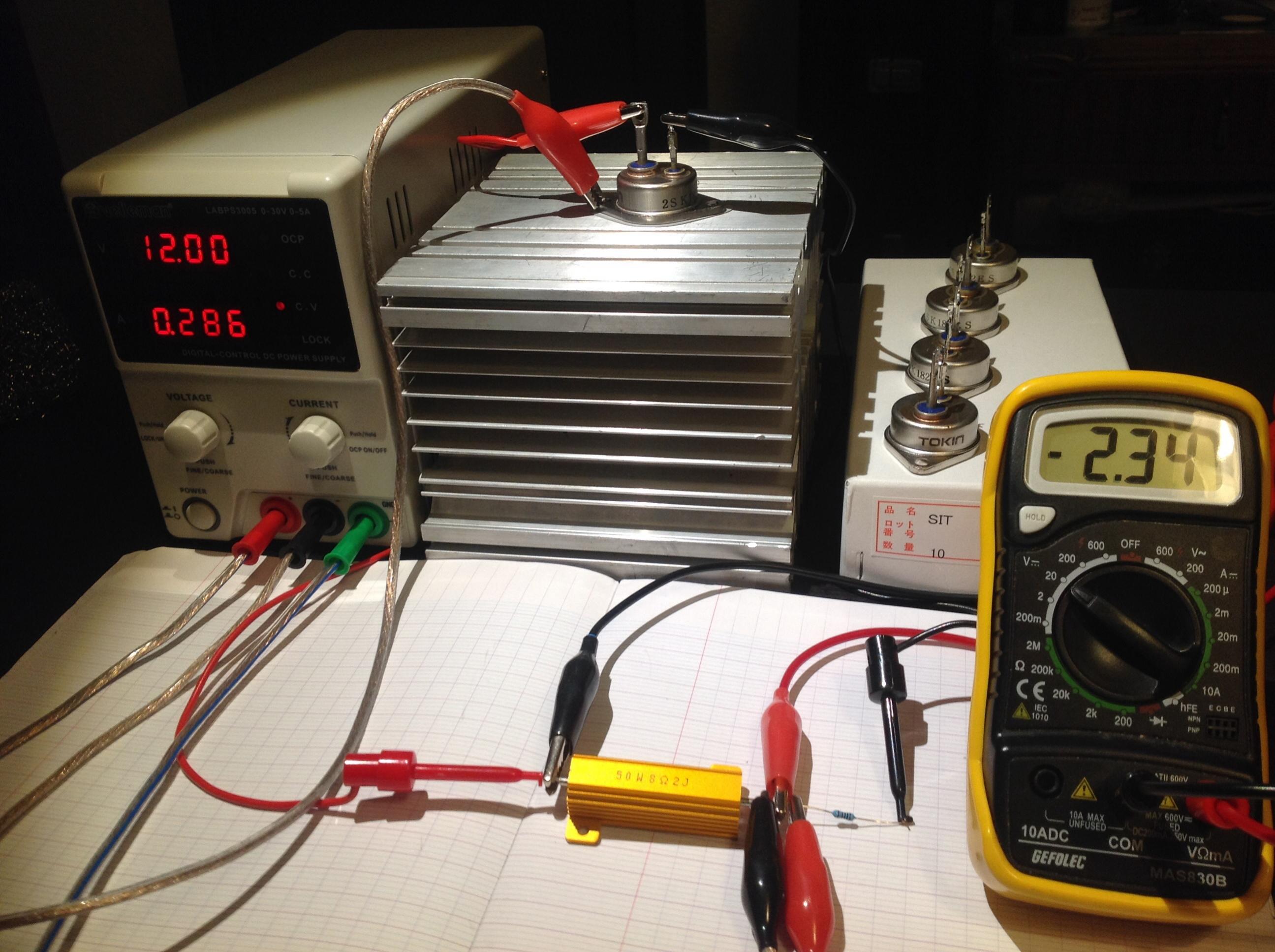

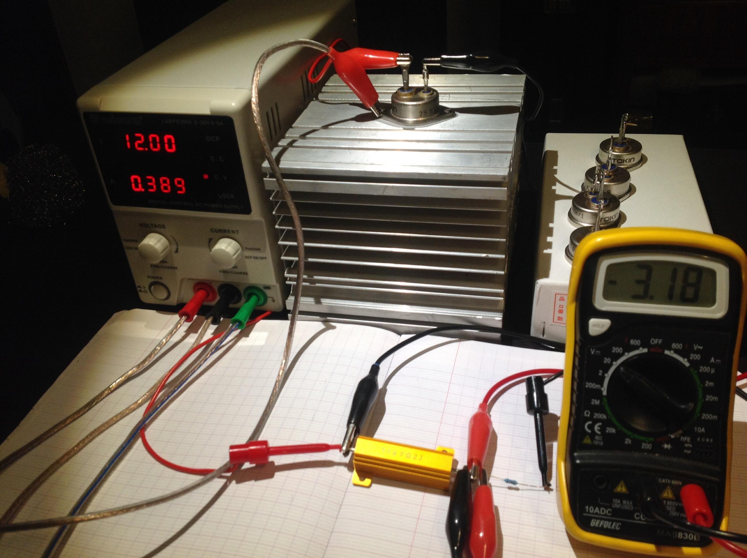

Hear sit test photos with 8,2 ohm resistor / 12V / 2A
Best regards
Christophe
