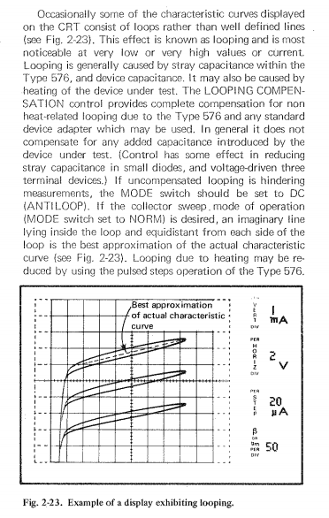

Here's what Tek has to say about it in their manual.
..... and we're not landing a probe on Mars or anything. 🙂
Well, many additional thanks for this copy from the Tek manual! I guess the phenomena I stumbled upon is sufficiently explained now!
But as I'm active in aerospace research anyhow, well, Stereo on Mars, one day, who knows?

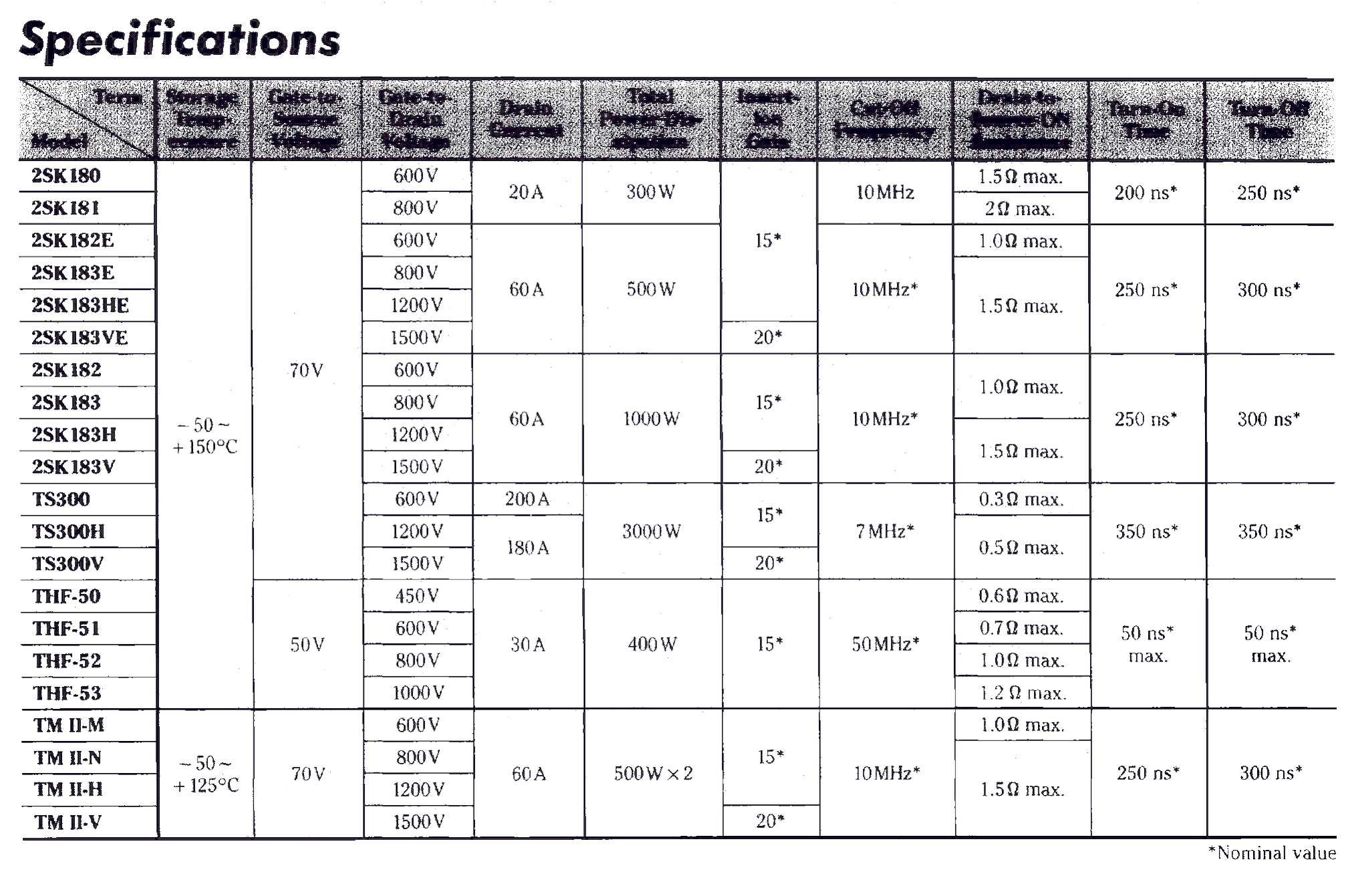

Great job on 2.1, I enjoyed it!
I'm excited to see the 193v numbers.

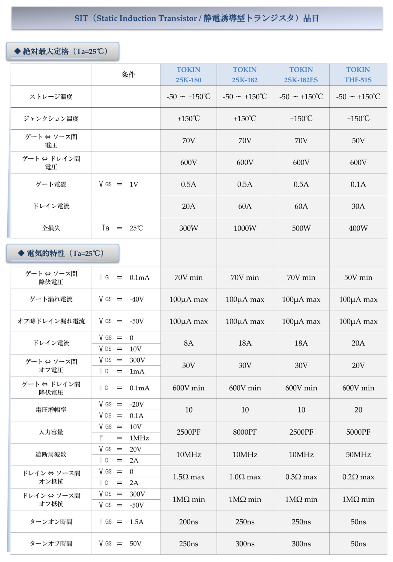

The 2sk181 is the same package as the 180, but has slightly different ratings.
181 is 5A IDSS, 800v with drain resistance of 2 Ohms vs the 180 which is listed as 8A, 600v and 1.5 Ohms. All other listed specs are the same.
I only have one 181. It came in a shipment of 180s accidentally. I haven't blown it up, so you can pull curves from it if you want.

Hi dear Michael and Diyers
Thanks for such great Lab Hangout #2.1 Formidable !
😀 just visionned four times in loop mode 😀
Sit´s are less rocket science i have learn something useful from this passionate video ah next time
Tokin
amp in action woow
2SK182ES are not tested was occupy this days but impatient test tommorow at the evening but ....?
I remember for 2SK180 was council from dear Nelson
http://www.diyaudio.com/forums/pass-labs/244926-ironamp-video-posted-12.html#post4004819
My question : for 2SK 182ES test parameters are they different ?
Kindly regards 🙂

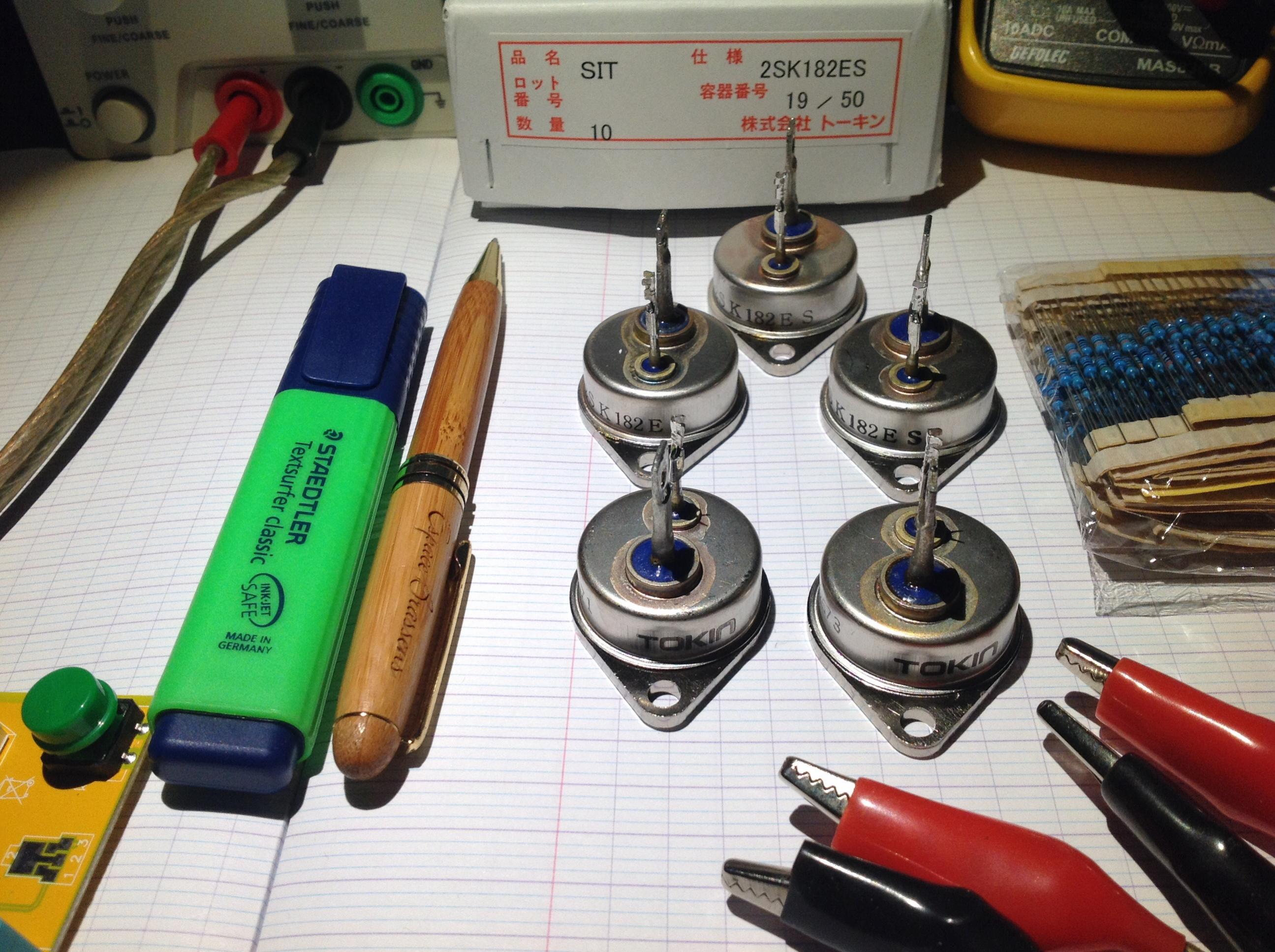

@soundhappy
Have you had a chance to check your 2SK182ES yet?
I traced both of mine and they are identical. So, they are either identically defective, or that's just what they look like. In any case, we'll find something fun to do with them. I'll check the gate leakage in circuit this week and see if maybe that's throwing things off a bit in the test amp.

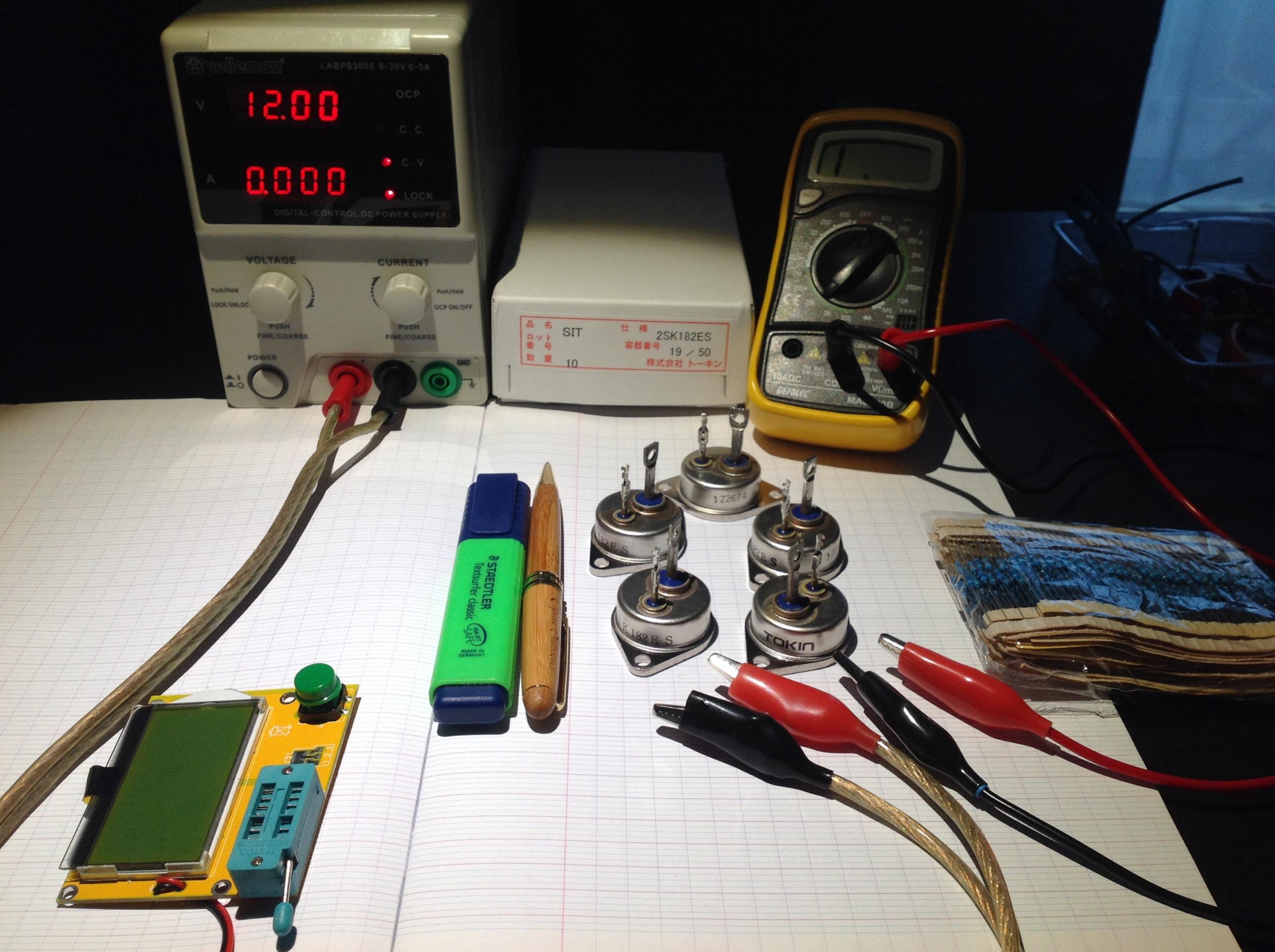

Hi Michael and Diyers
Only basic equipement on bench and i am ready to test 2SK182ES
please tell me what i can do with one multimeter, lab psu and resistors ?
Prefer ask experimented & avoid mistakes.
Hope yours response be useful for another diyers who are passionate by sit transistors.
I report values with pleasure .
Thanks a lot and have fun 🙂
Christophe

Nelson's instruction are a great start. Do you have a 10 ohm power resistor or something of the sort?
Would a demonstration help?
