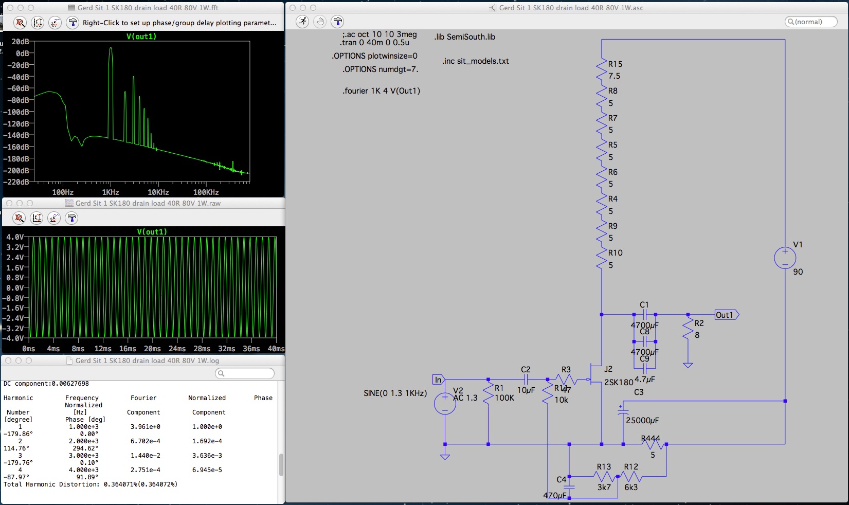

this seems to be the right place for SE players with the bulky SITs-----🙂

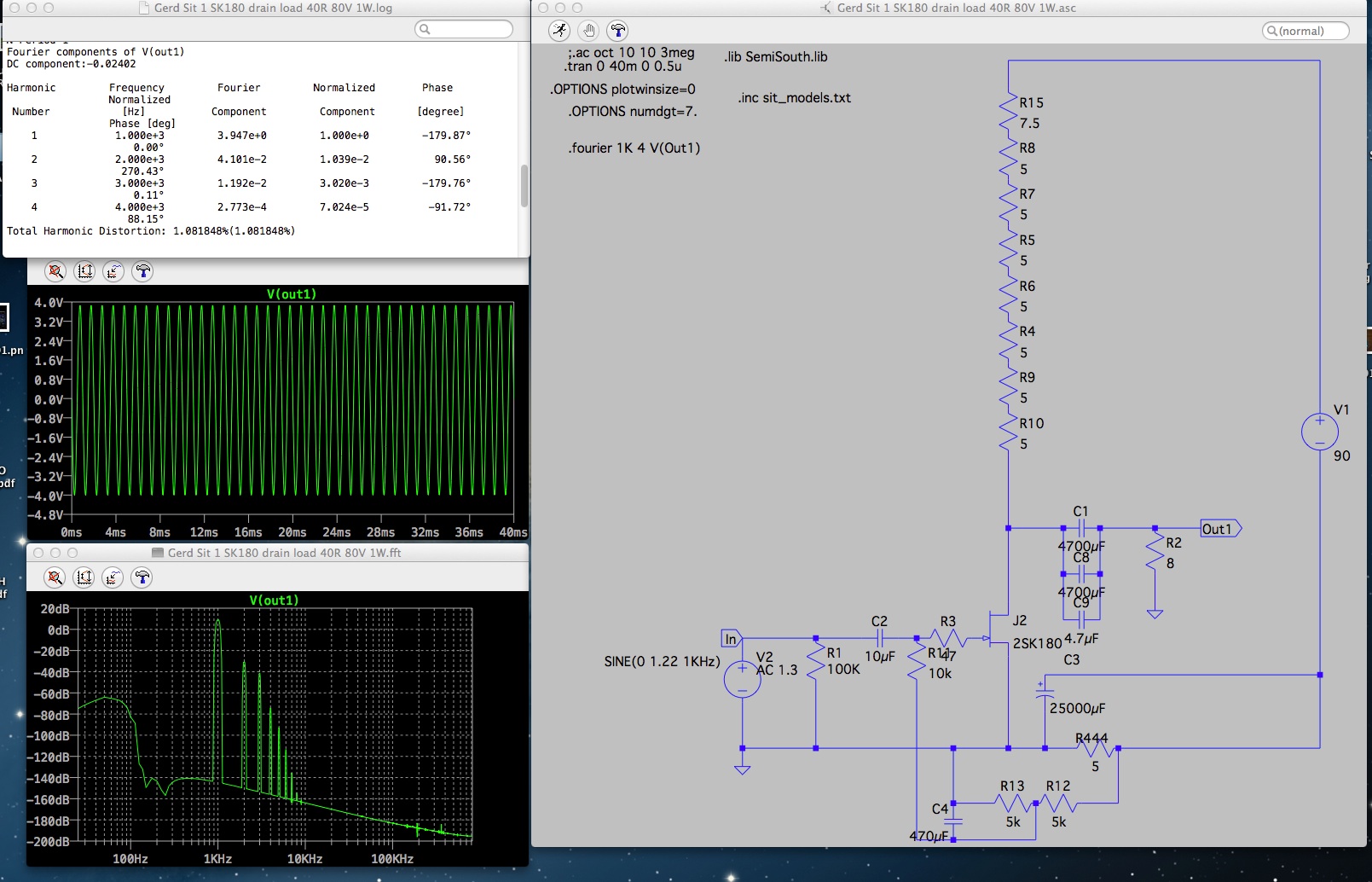

this is a simulation I did some months before. The hint to use such a big drain resistor between 40 an 45R came from Mr. Pass itself when I wrote him.
I am not happy with the distortion at 1 Watt/8R, I could get lower but I wanted this nice k2 around 10dB over k3 and this spectra like organ pipes.
It still has to be build. I have already all the caps for the PSU and the bridging of the 5R resistor delivering the negative biasing voltage for the SIT.
But I eschew the money for the Ohmite 100W, so I will simply take two bulbs in series.
I made the SK180 model with the help of Mike R homepage.
