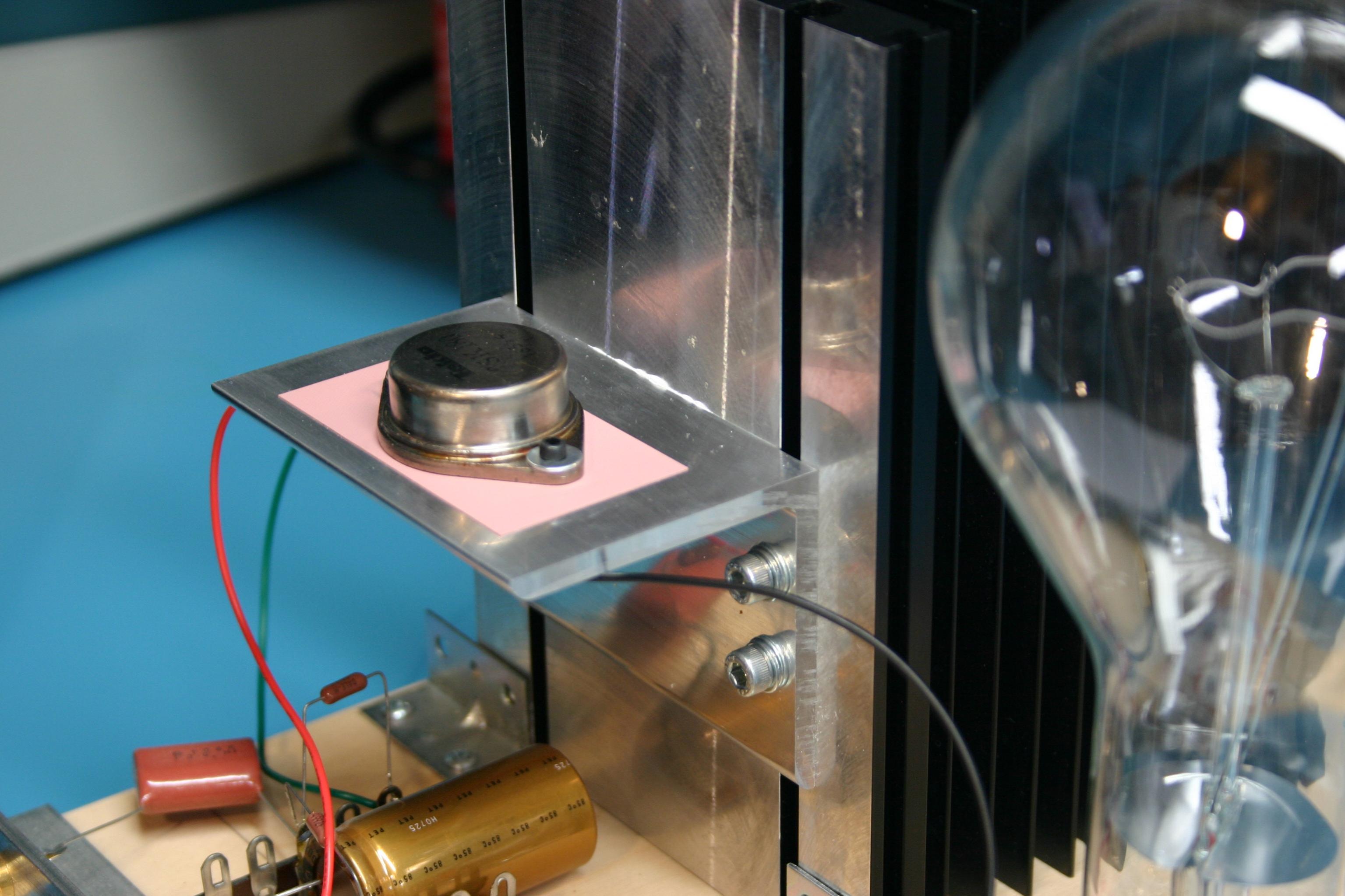

Dear Michael, how is the resistance of the lamp?
Here on Spain we are looking for this kind of lamps but only should get 125v /500W with E40 socket. Maybe We should use a couple in parallel.
One question, now I am getting more tools, I have only a scope and a generator, but the circuit for trace the curves, which circuit you made?

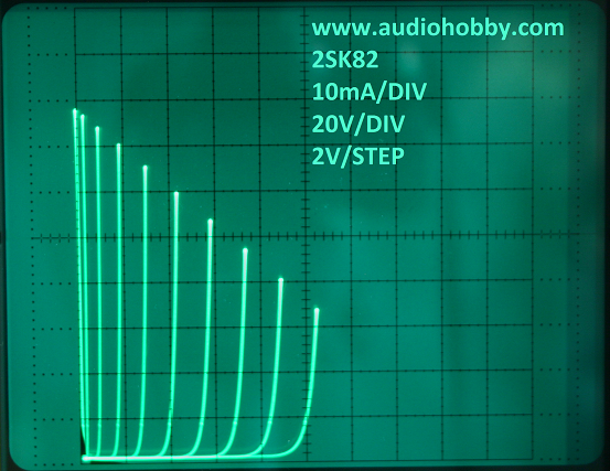

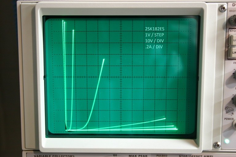

The 2SK180 seemed perfectly workable. I was seeing around .280% THD at a watt for the amp in the video, with THD around 1% at 4 watts. The big guy (NP) is working on something using this part, so I'll defer to him. I'm not gonna preempt the master.

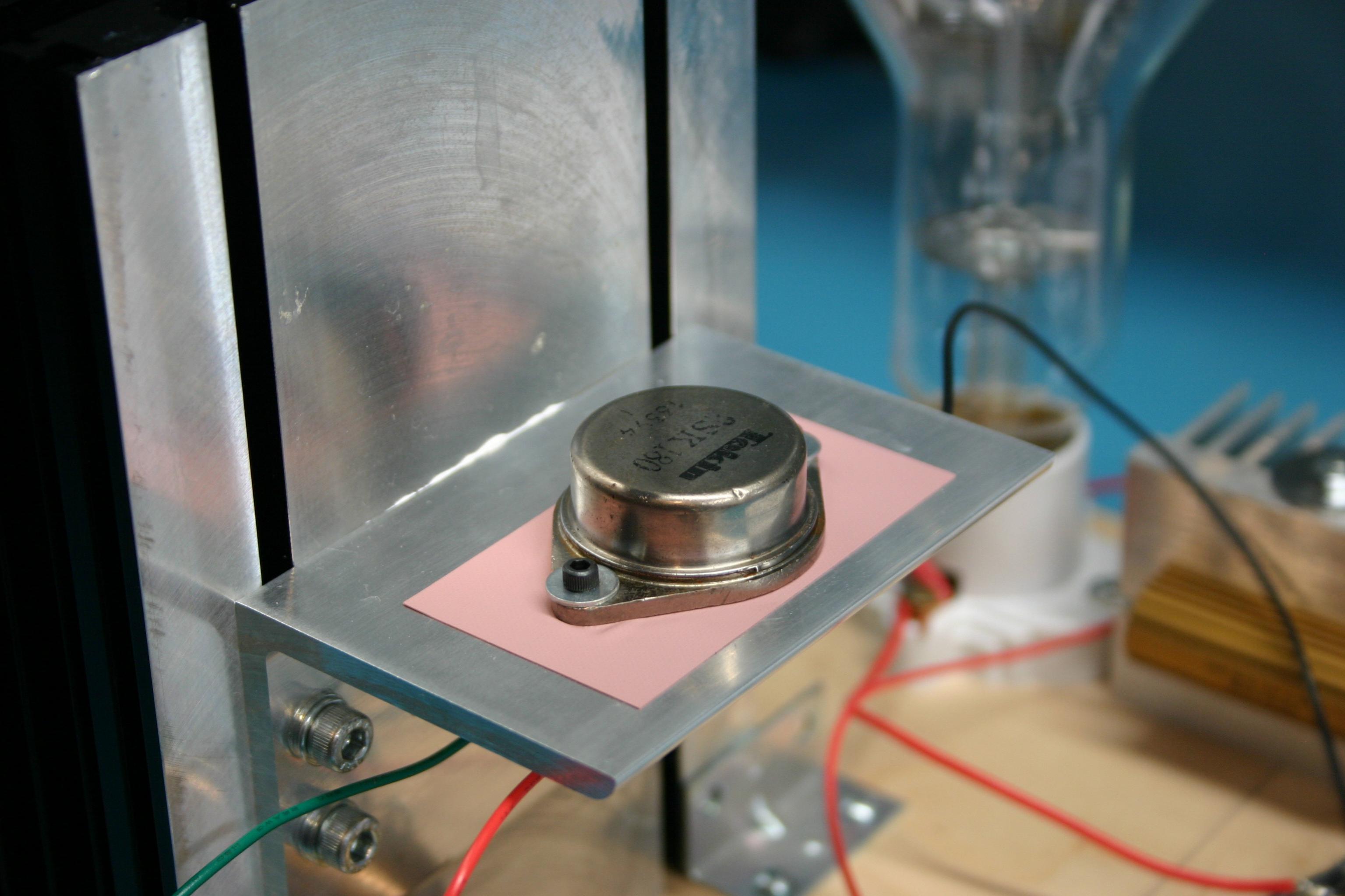

The 2SK182ES I tested is pretty nasty. If you look at the curves, ideally we'd like those traces to be parallel and evenly spaced in the region where we intend to operate the device. When they're not, our output waveform gets squished and stretched, and this squishing and stretching causes harmonic distortion.
I beat on it pretty hard, running the current and voltage way up to see if I could get anything good out of it, but alas there are some problems even load line cancellation can't overcome. This might be a good part for a multi-kilowatt class A amp.

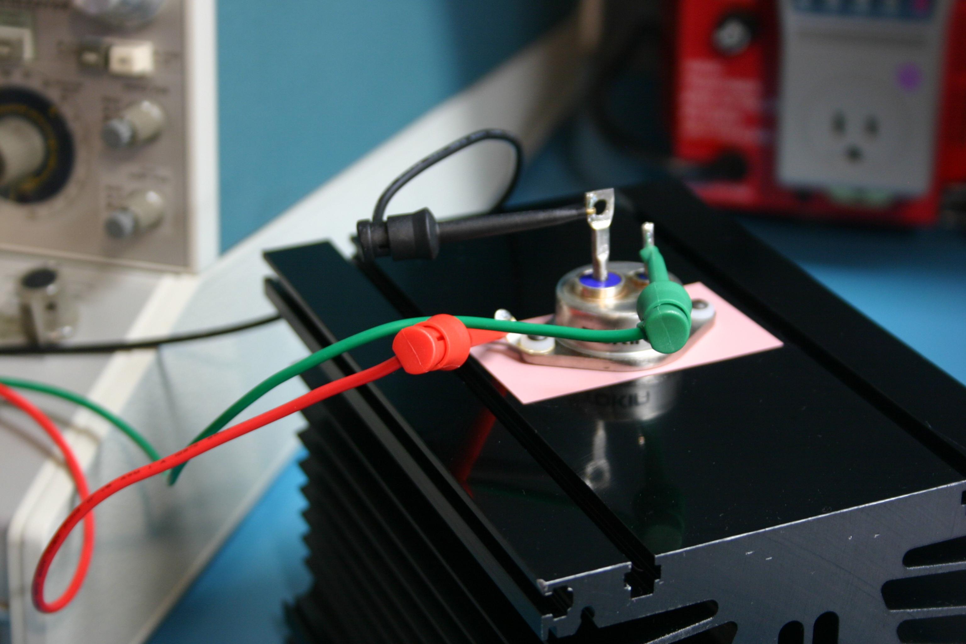

I used a Tektronix curve tracer to make those curves. I detailed a method to make curves with an improvised curve tracer in the original L'Amp article, but it's tedious and you must be careful.
2 300 Watt bulbs in parallel is about 11-13 Ohms.

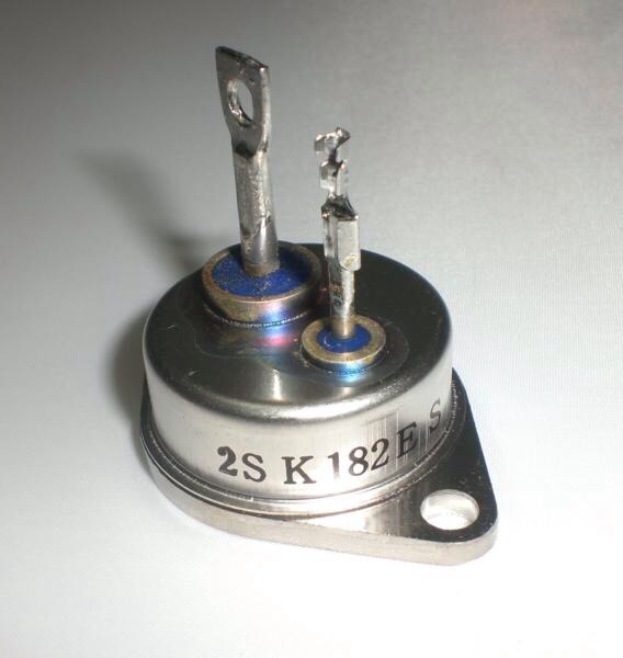

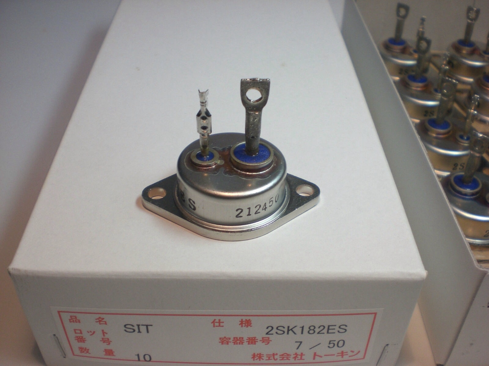

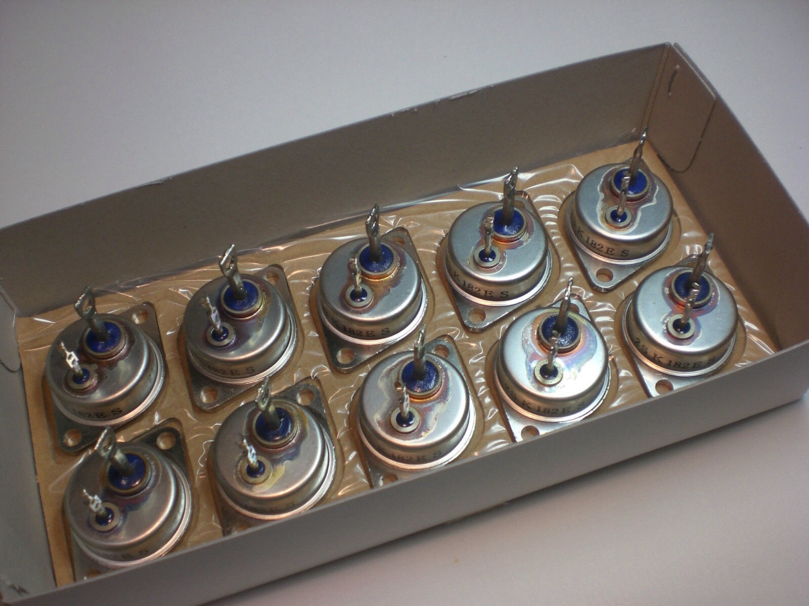

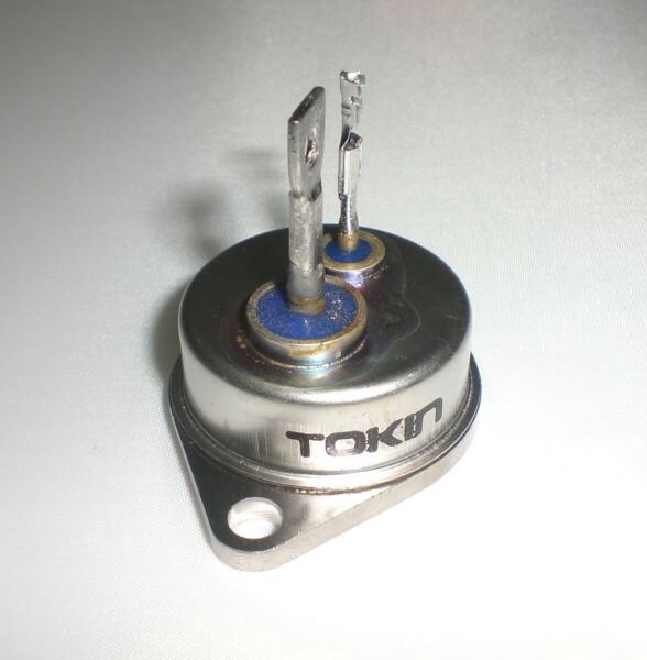

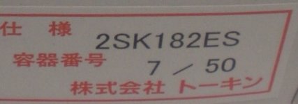

Now i wait 2SK182 ES delivery from Tokyo 😀 i report after reception hear is link for interested diyers :
1pcs NEW Tokin Transistor 2SK182ES Made IN Japan Shipping Charge Free | eBay

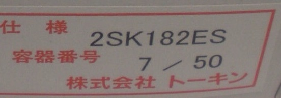

7/50 on box is Tokin SIT grade or something other parameter ??

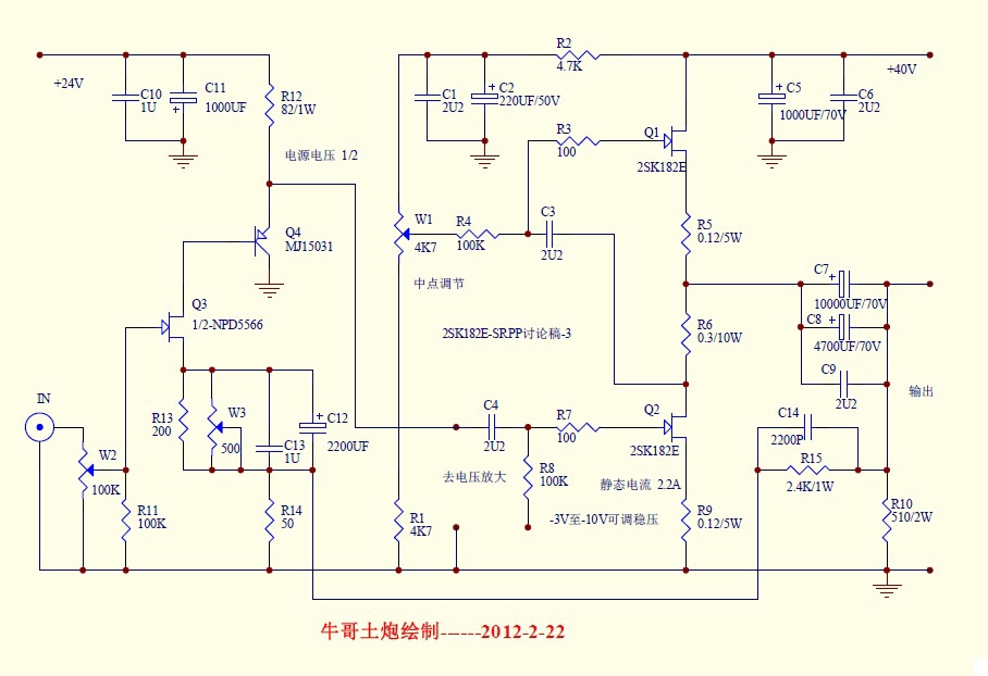

My amigo have showed me this topology with 2SK182 ES
http://www.diyaudio.com/forums/soli...t-sti-2sk182e-pipe-srpp-circuit-feasible.html

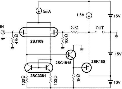

We have mimimalistic topology for sit amp with 2SK180 too
SIT Power Amplifier
L'Amp
with biger sit´s are interesting upgrade.

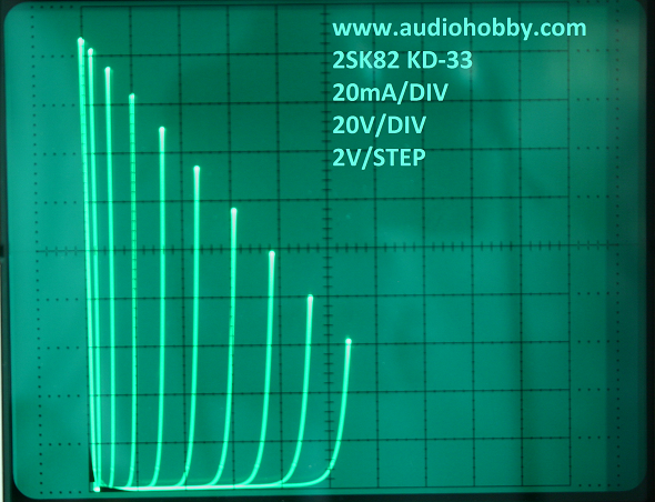

SITs are said to behave more linear and to have less capacitance at higher voltages. I therefore selected 140V/200mA as the OP for my 2SK82 parafeed prototype. This selection was additionally based on the SIT model available from M. Rothacher's homepage (described in Linear Audio #6).
The 2SK180 should allow even higher voltages. So, to start somewhere I tried (first time ever) to take some curves around a potential higher voltage OP for the 2SK180.
Applying the convincing simple methodology described by M. Rothacher in his L'amp article, I used a 230V/230V transformer, a SF4007 diode, a 10 Ohm resistor a bench power supply and the scope I inherited by my father in law to get the curves below.
Apologies for some slight misalignment of the different pictures, but I guess the main messages comes across:
- the devices impedance seems to vary to a considerable degree
- at higher gate voltages (starting from -7.5V) a hysteresis develops
Just to make sure I don't invest my time in a project that will not work, I took some further curves around the selected OP for the 2SK82. Lower gate voltages are varied here to stay below a maximal current of 360mA. These curves show the desired linearity (ok, lower range of measurements, but..) restoring my motivation to finish my 2SK82 amp.
My questions concluding this are:
- what might be the reason for the observed hysteresis of the 2SK180 (also observed in the original Sony 2SK82 data) ?
- Maybe the voltage of up to 310V is still to low for the 2SK180?
All the best,
Ulrich

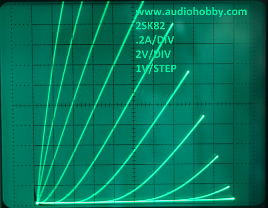

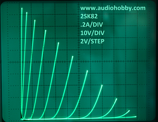

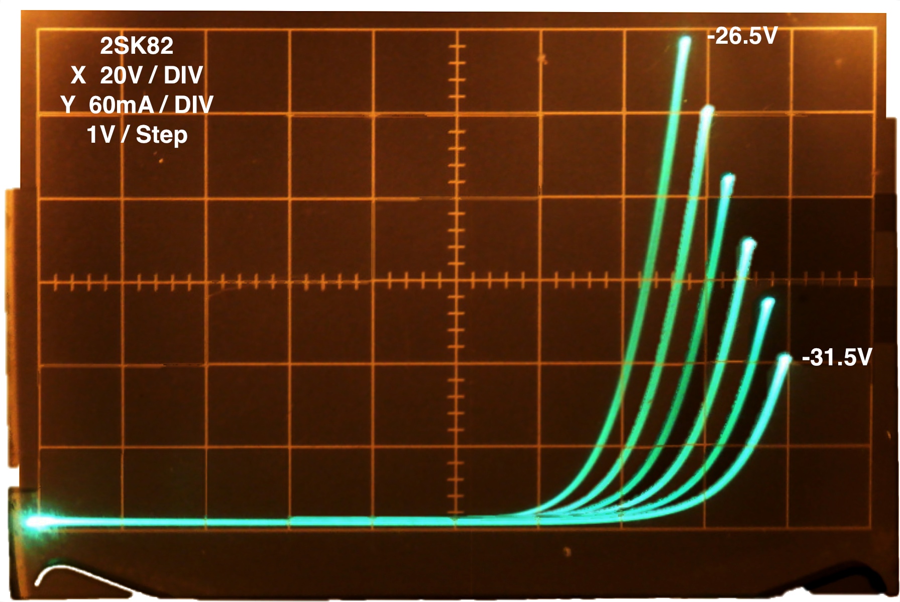

You're sweeping a half-wave rectified sine, so your sweep goes up to the peak voltage then back to 0. Little things like interelectrode capacitances, and other effects (even temperature) could lead to those little loops. This is typical. Commercial curve tracers include various methods to help trim some of that out. But, they're really not a cause for alarm. In fact, I erased them out out of my original composite images, keeping the same half of the loop.

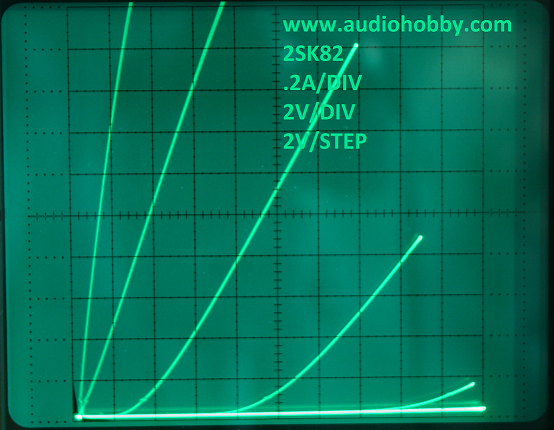

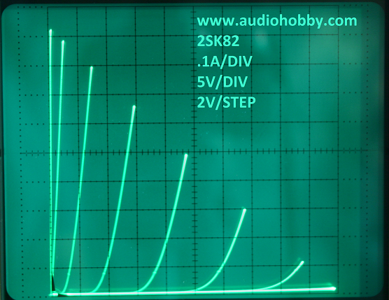

Nice job on the curves, by the way. I admire your willingness to endure a tedious task. Here's a whole bunch for the 2SK82 made on the Tek:
.... Little things like interelectrode capacitances, and other effects (even temperature) could lead to those little loops. This is typical. .... But, they're really not a cause for alarm....

many thanks for this clear words on this. Seems it's good to have such a nice Tec device: don't know how long it would have taken me to explore the 2SK82 like you did and provided us with!
With the hysteresis judged as typical and no cause for alarm, I still tend to conclude that the 2SK82 seems more linear than the 2SK180, except I'm mistaken again (due to missing knowledge).
