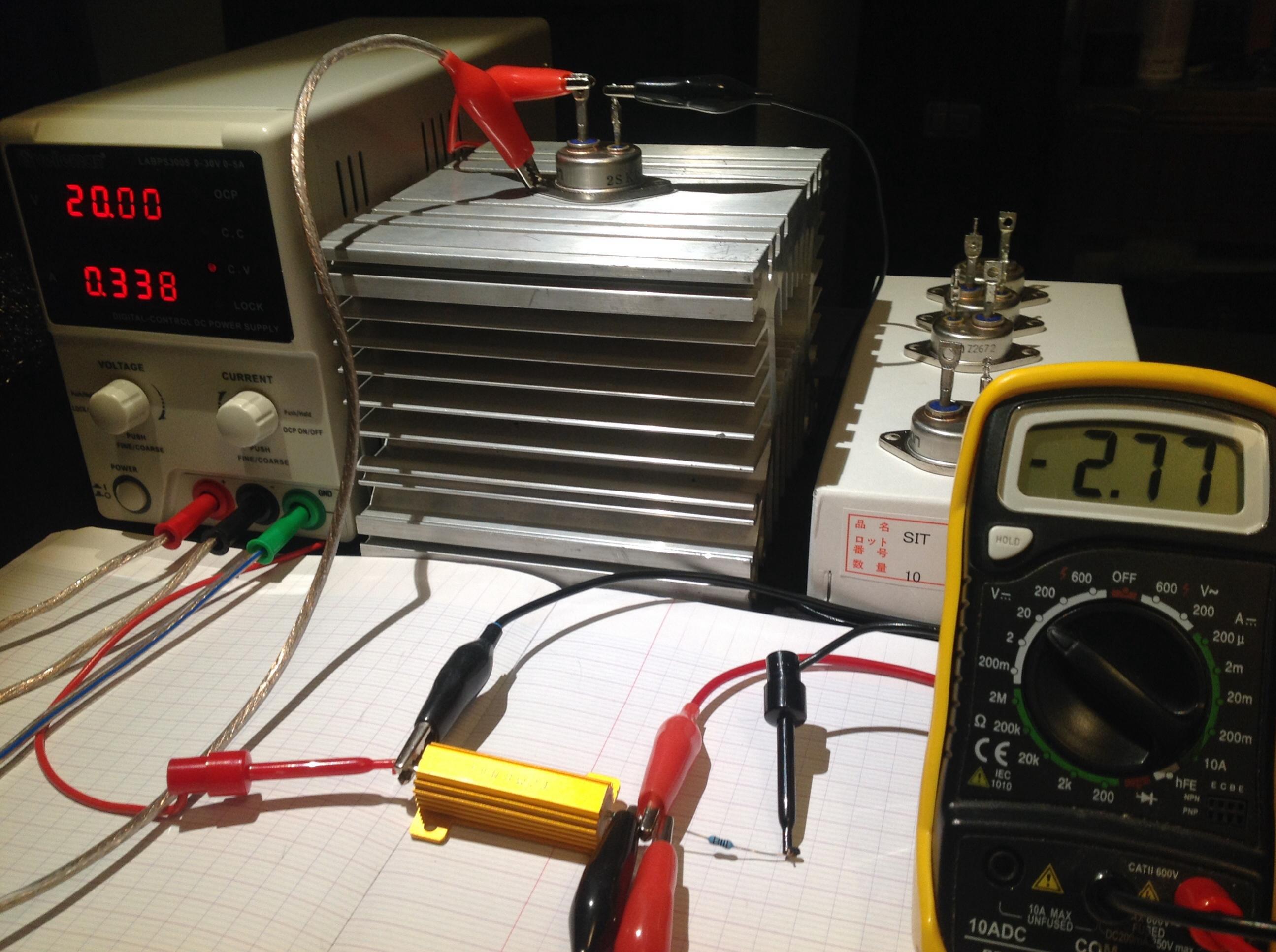

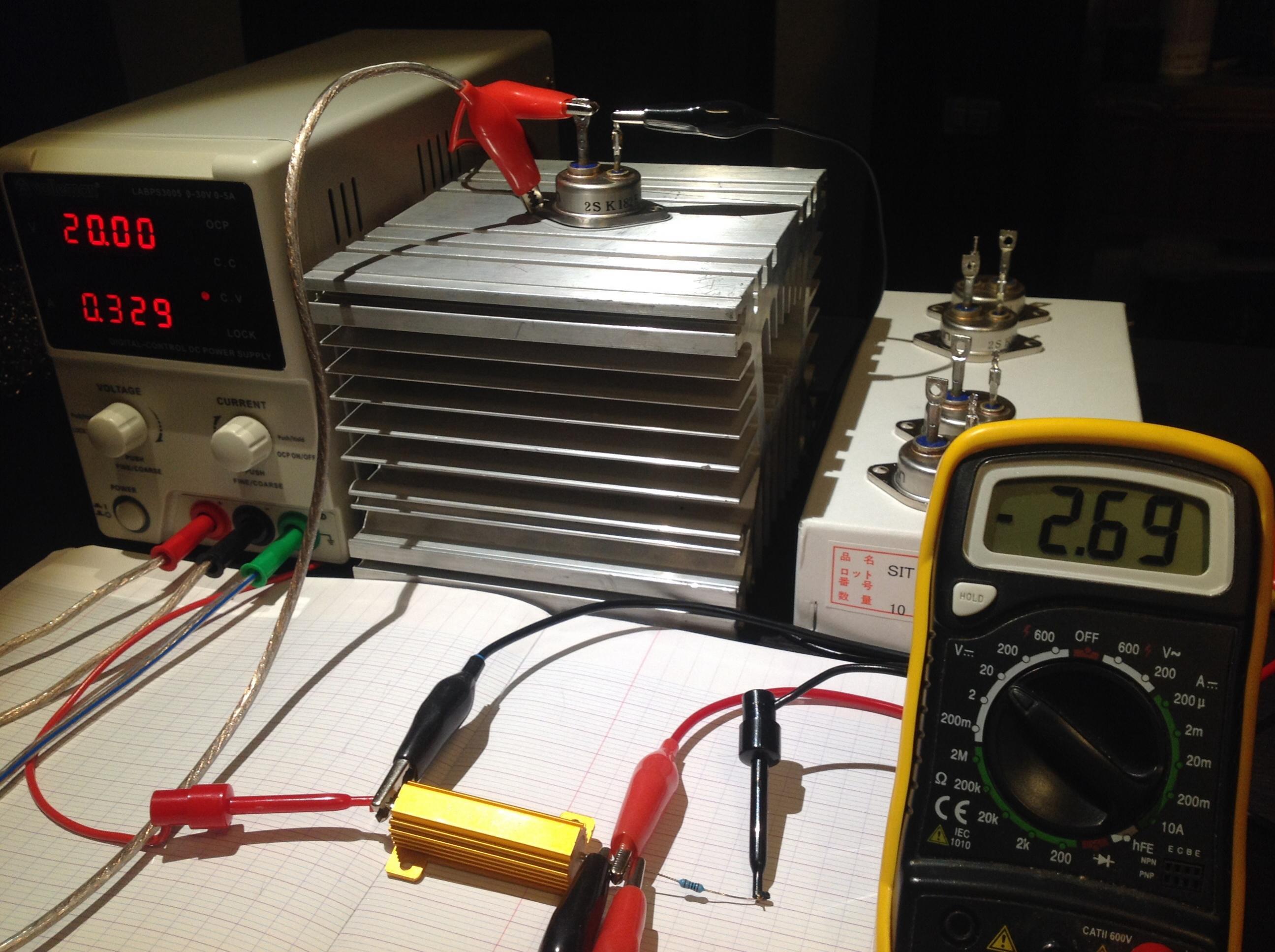

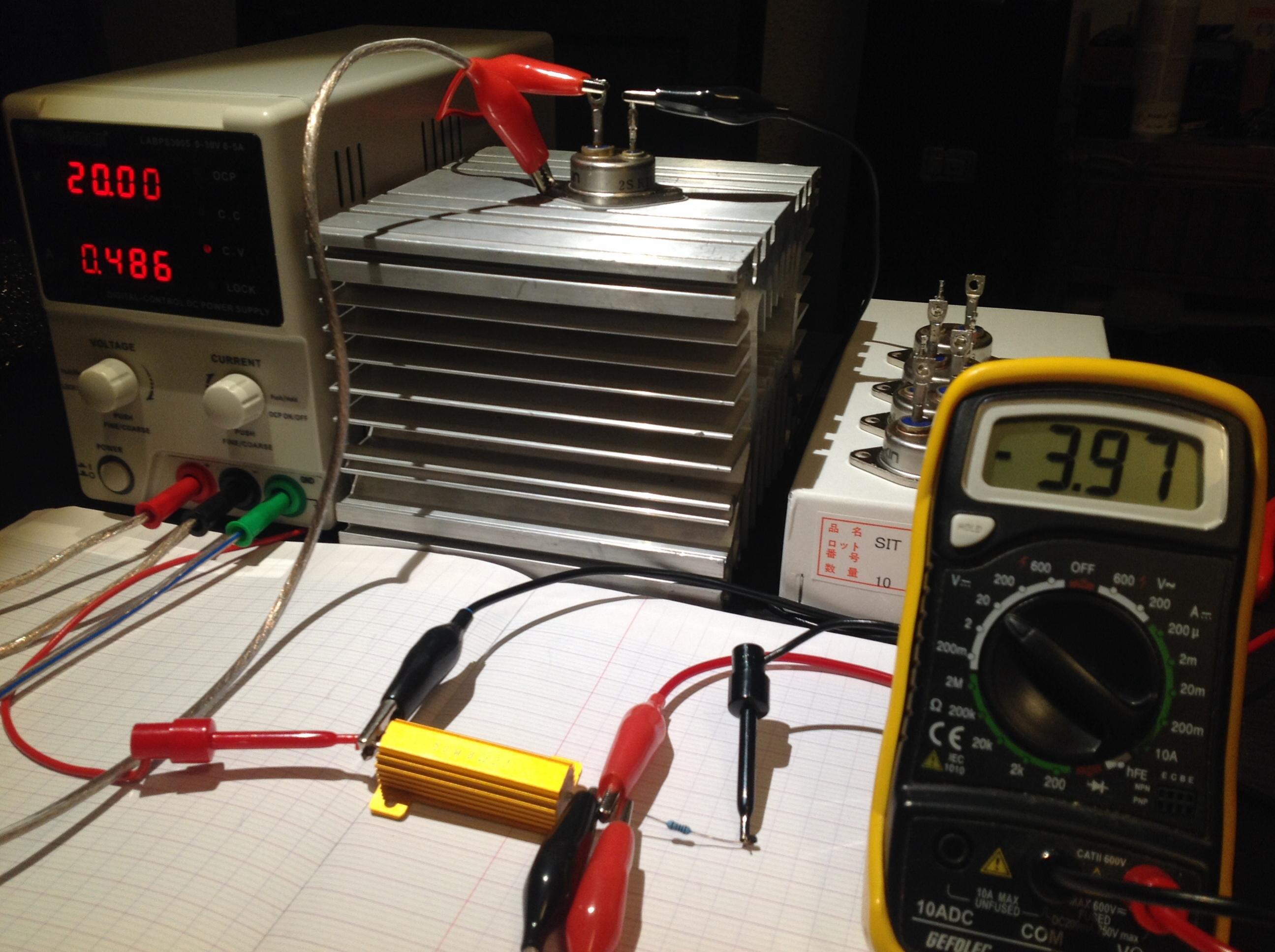

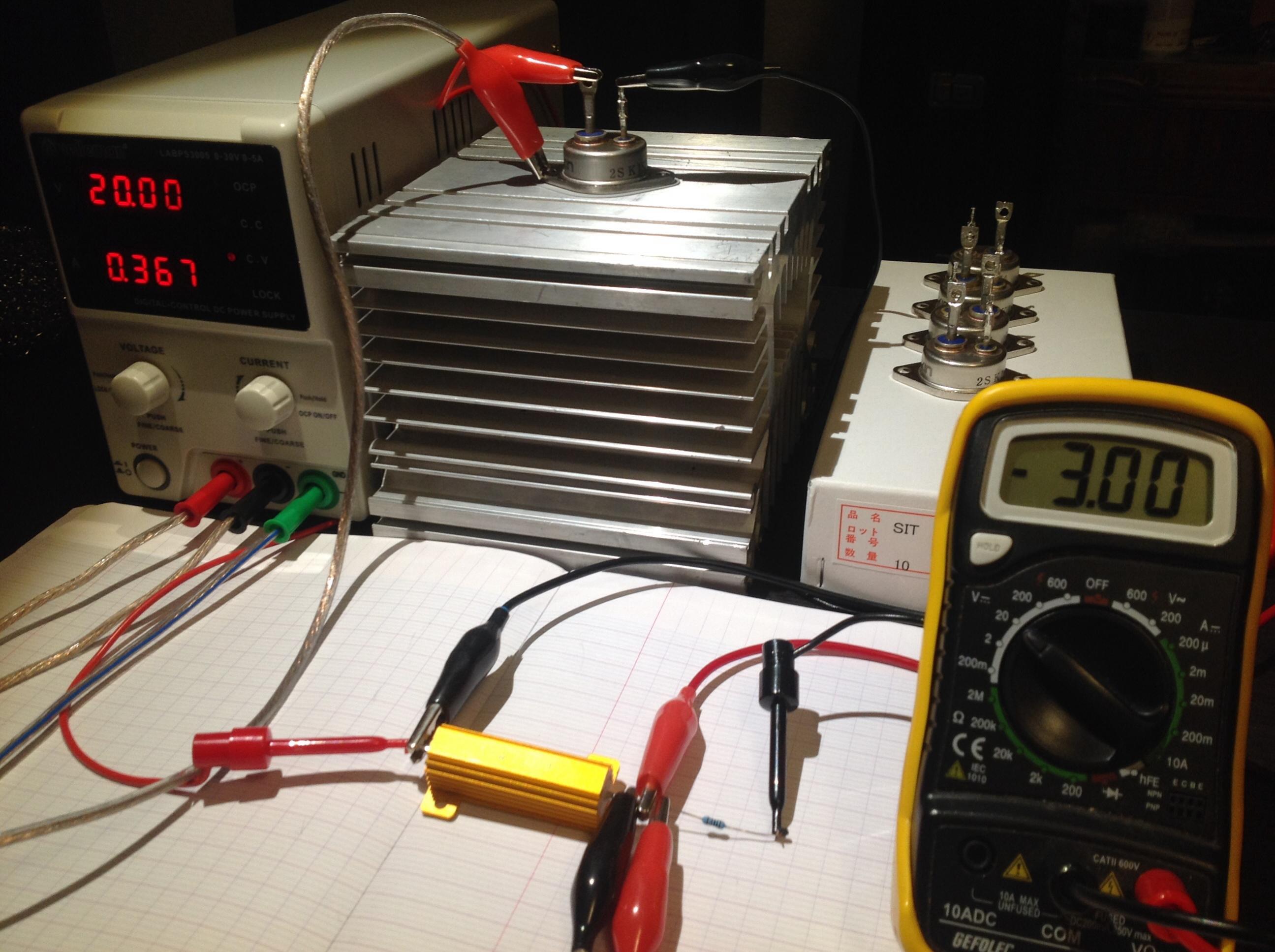

2SK182 ES Tokin in test 20 V / 2A 🙂
The same sit numbers order on photos only voltage change.

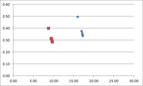

| class="tcat"| #
| class="tcat"| SIT 182 ES
batch nr
| class="tcat"| 12 V
| class="tcat"| max 2A
| class="tcat"| 20 V
||1||1Z2670 || 2,51 || 0,308 || 3,00|| 0,367
||2||1Z2671 || 2,34 || 0,286 || 2,77 || 0,338
||3||1Z2672|| 2,26 || 0,276|| 2,69|| 0,329
||4||1Z2673 || 2,42 || 0,296 || 2,87 || 0,351
||5||1Z2674 || 3,18 || 0,389|| 3,97|| 0,486

Making lots of assumptions, that's mu average = 3.5 ish

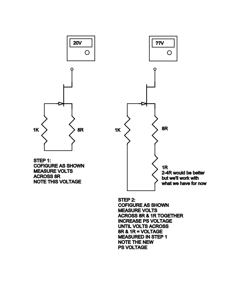

Can you take another set of readings at the 30V (or whatever the high range of your bench supply is)?
Also, do you measure a little voltage across the 1k resistor?

I recall you said you have a 1 ohm power resistor in your junk box.
Here' something else you can try while you're having fun.
Thanks Michael for schematics
