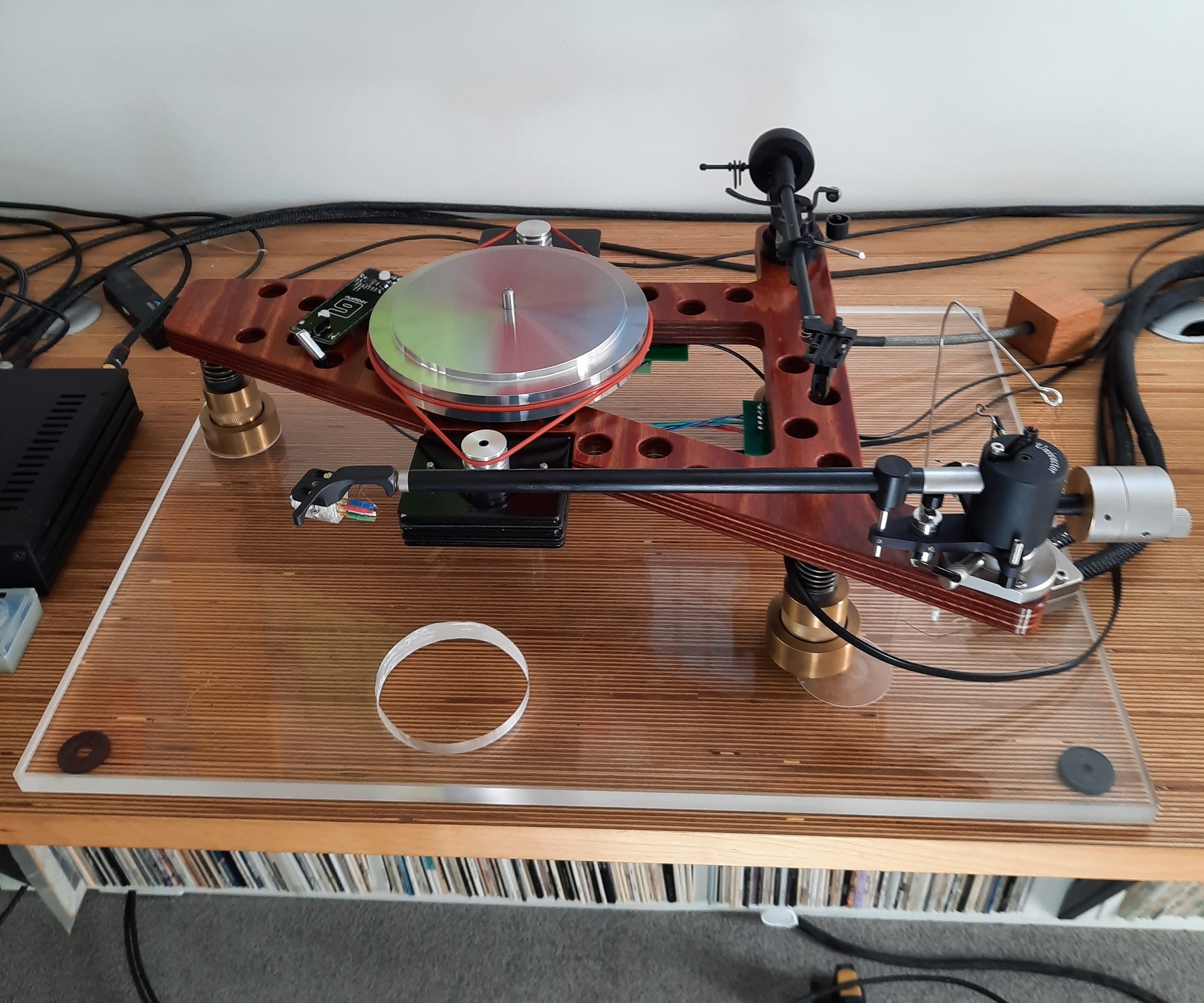

Or you could go to a two-belt, 2-motor situation - like in the pic below.
You have to ditch the plinth, though! 😉
My 'SkeletaLinn' has a Karousel bearing plus Tranquility, sits on 3x springs and, obviously, is belt-driven. Originally, I had a Linn Premotec motor driving it but, after finding the 'Number9' speed controller (alas, no longer available), moved to 2x 24v Rega Premotec motors.

I use 24v Rega motors on my 'SkeletaLinn', driven by Steve Tuckett's "Number9" motor speed controller. He's no longer with us but I'm sure I remember him telling me that these motors operated fine within a certain speed range (say, +/- 10 or 20%) but did not like being run outside this range.
So I think 3x the specified frequency would not be a good thing.

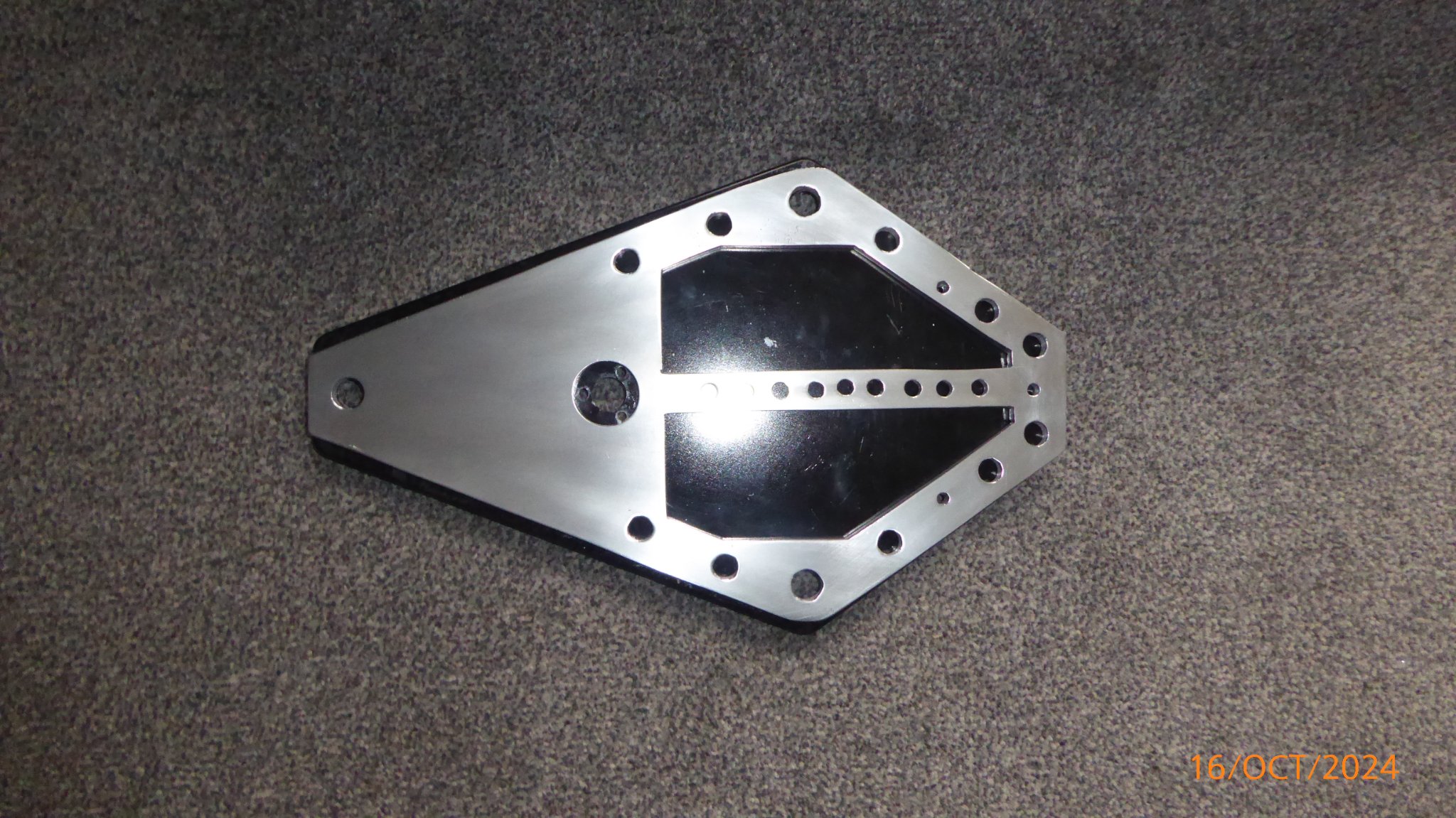

I made a 10mm duralloy sub chassis and arm board for mine and I'm working on balancing those components. As for damping the sub chassis, mine rings like Big Ben until the arm board goes on then nothing, The arm board is bolted through with sorbothane between the arm board bolts. I know some people will say this is wrong but I use my ears to distinguish whether it works or not, and it does.
I think the main problem with the Linn sub chassis is balance, one spring does most of the work (nearest the arm) while one just acts like a swivel. I'm a relatively adept mechanic and this doesn't seem correct to me. It means the sub chassis does not go up and down, it moves in an arc swivelling from the single spring. The sub chassis I have in now is my own made Mk 1 (duralloy) this works very well and brings out more detail and depth of soundstage. Hopefully this version Mk2 I'm working on now with deal with the balance issues.
Sound is subjective so it's a good idea to listen to what people say works or not, but it will be subjective and an idea you can use or not. This modification works for me and I like detail and depth of sound stage, I also like my turntable to sound like a turntable and not like a scientific clinic.
I can post a pic if you're interested if I can work out how to do that.
This is the Mk 2 that I'm working on now. I've still got to make a balance for the non arm side but as you can see I've left all the solid plate on the single spring end already. I have to get the arm out of my deck to do the balance adjustments and where to place extra weight and have a carbon fibre centrepiece that holds the bearing, The bearing fits on the underside of the carbon fibre disc and that is bolted to the sub platter. I already have that fitted on the other sub platter and it works very well for keeping the platter low enough. It's sitting on top of a standard sub chassis in the picture, I use that as a guide.
