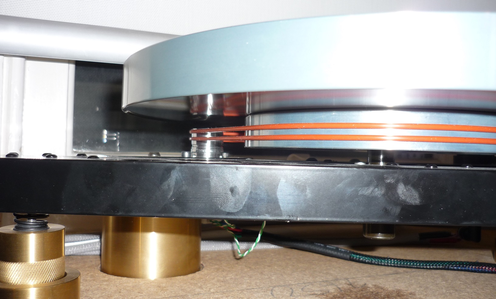

Nigel, what's your take on belt material? I think Linn's belt is made of nitrile but I've just found out you can buy nitrile belts of different 'stiffness' (or 'elasticity') - so I'm wondering whether:
* stiffer is better ... or not?
* is silicon (of the same stiffness rating) a better belt material than nitrile?
* and how do O-ring type belts perform, relative to a flat belt?
I've just taken delivery of some 'O-ring' type belts (ie. round cross-section) made of:
* nitrile 'N70'
* nitrile 'N90' (much harder to stretch! 😱 ) and
* silicon ('N70').
Here's a pic which I've just taken of the silicon belts on my 'SkeletaLinn'. (That's with the platter turning.)
There's a grooved pulley on the motor which holds the belts very nicely 'in place' - so they don't fall down the LP12 inner platter on start-up ... and then rise, as the platter gets up to speed, like the flat belt on the Linn crowned pulley does.
I look forward to your input.
Andy

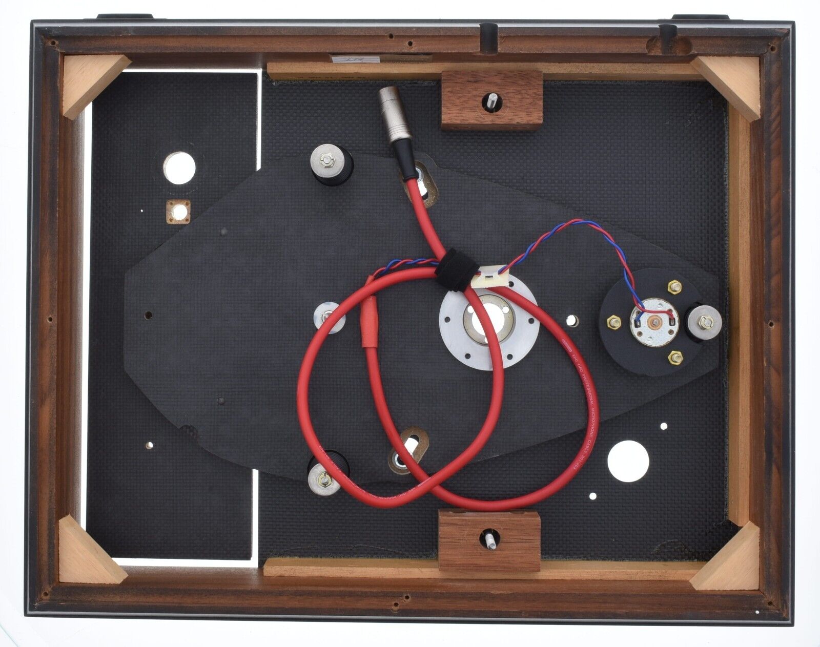

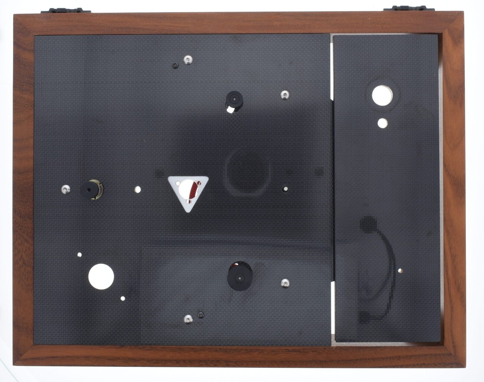

I have followed this (old) thread with interest, especially the possibility of designing an improved sub chassis for the LP12. Has anybody successfully implemented such a thing?
Old thread I know, just wondering if anyone has the dimensions of the LP12 armboard, I want to fit a Hadcock GH228 to an LP12 that I am building up slowly, but the geometry of existing armboards are wrong and blanks are silly money for what they are.
Hi Batty, I no longer seem to have a dwg of a Linn LP12 armboard but the dimensions of the Graham LP12 armboard that was supplied when I mounted a G2.2 on my LP12 are: 299 x 101 x 8.5mm.
Andy

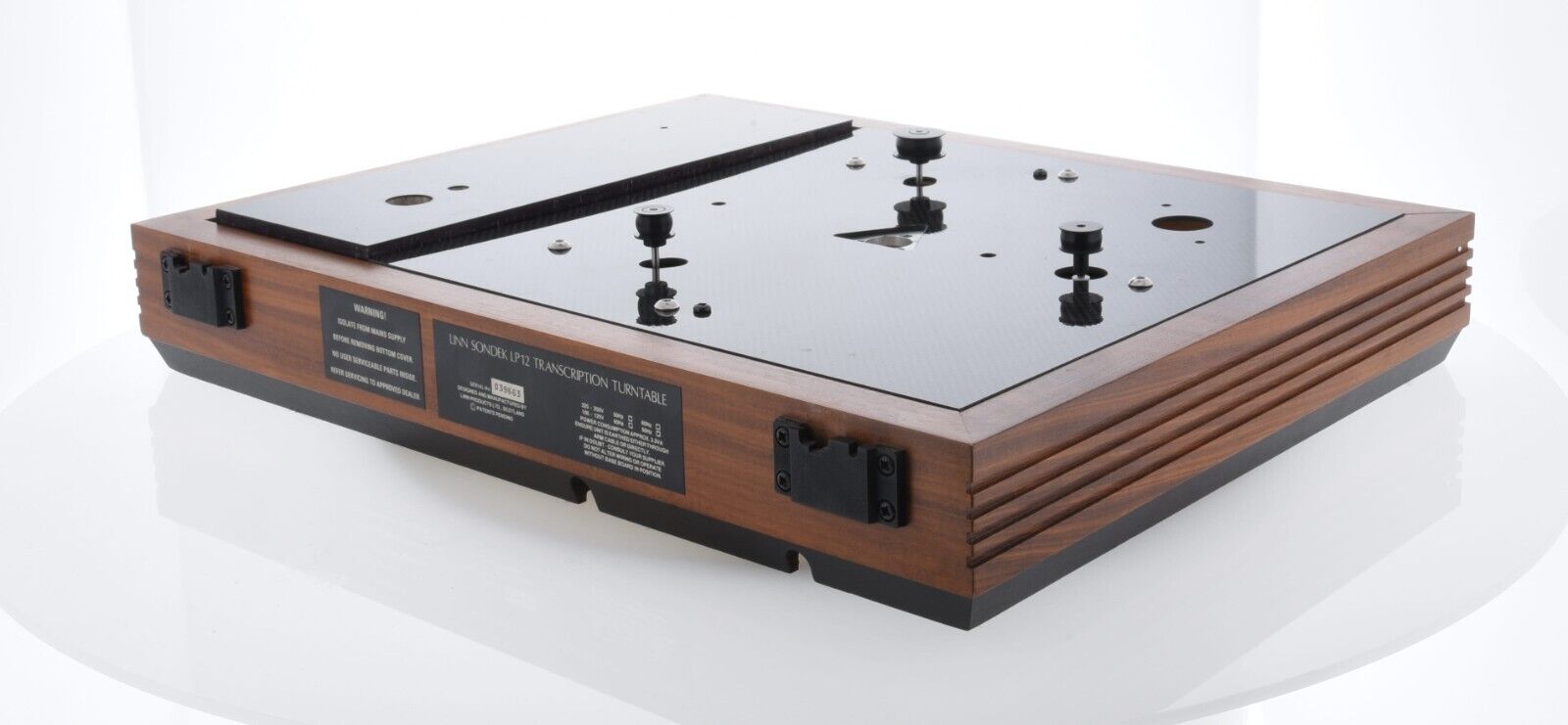

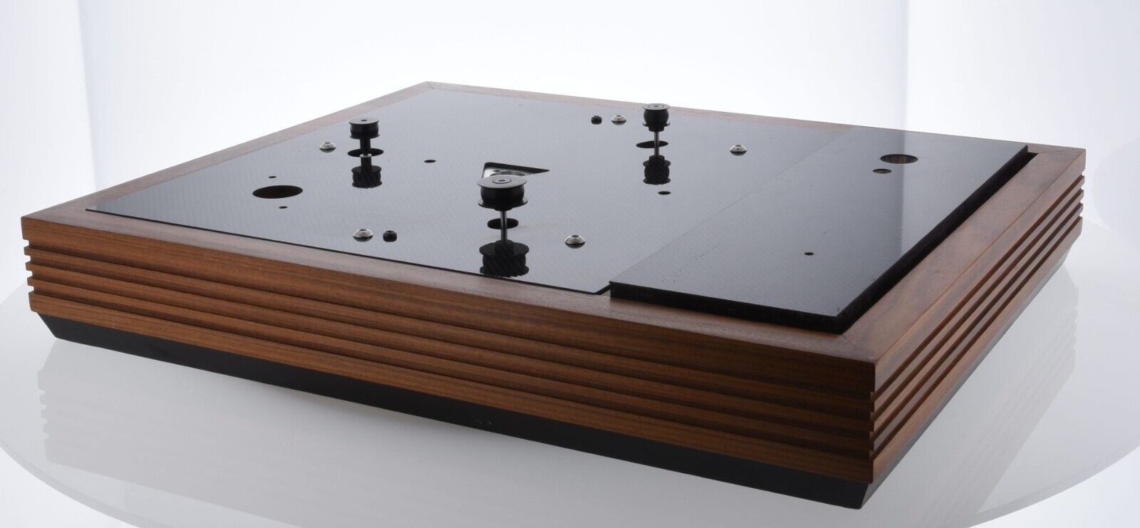

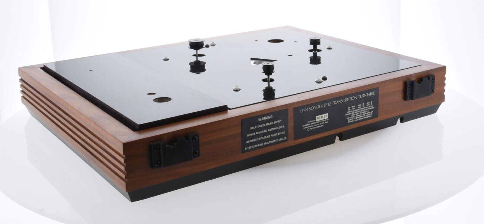

this seems to be an interesting approach (converting to a 3-pulley belt drive system):
https://www.ebay.at/itm/295210392456?hash=item44bbe91b88:g:9OUAAOSwj2JjCEsH
obviously from the owner of this company:
https://www.enjoythemusic.com/superioraudio/equipment/0808/funk_vector_link.htm
https://web.archive.org/web/20080216232158/http://www.thefunkfirm.co.uk/V_Link.htm
