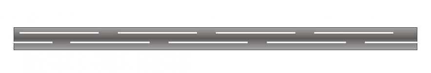

Here is a belt mod. Kindly evaluate if it is worth. One can glue nylon thread pieces to the rubber belt as shown in picture. This will solve creep and slip problem as during rotation one side doesn't stretch. I think it will be as good a torque drive as idler wheel. One can use much softer rubber material as belt is already reinforced by the thread and we get increased damping.
Regards.

I've never seen anything quite like that, so I'd be invested to see how it works.
I have a very large 'footer' on the motor pod on my Kuzma. It allows me to put a lot of tension in the belt to overcome slippage without the tension pulling the motor pod off balance. Due to the high drag bearing set up in use slippage needs to be addressed.
I'd like to try a belt that was reinforced with some fibre, I know it would couple motor vibration a bit more but I'd like to see if slippage has been fully addressed in my deck. I thinking has, but never say never.

Thats why thread pieces are separate. To isolate from vibrations as much as possible and I am guessing if more softer rubber is used it would increase damping. Think of rubber as holding the nylon thread pieces. 🙂
