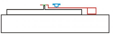

Here is an idea to measure vibrations/rumble. Make a jig (shown in red) of suitable material (should transmit bearing noise and vibrations) where a delrin thrust pad (green) rests on spindle. Carefully rest the needle (blue) as close to spindle as possible turn on the turntable. you can measure the output from tonearm cables. I guess if one can tolerate the minor delrin thrust pad and spindle noise added to the actual reading this could be a good measuring device.
Following is what I had posted earlier but am repeating so pardon me. In the past I had digitized some vinyls and cassettes. Some recording software has facility to remove tape hiss and vinyl surface noise. For example when blank portion of cassette tape starts you record it. This becomes a noise sample. Can easily be seen in software. Now when one records the music content one can remove this sample noise data from the song. My recordings came out very clean. We can use the same method for vibration/noise measurement. All one needs is a test record with blank surface (Used for anti skate setting) Carefully drag by hand the stylus on this surface to take noise sample. Next put on the vinyl on turntable and actually play and record this surface again. Remove the previous noise from actual turntable running recording. This would probably get you accurate noise reading. Just newbie thoughts, criticism welcome.

A silent record would be good to locàte unwanted noise and a way to monitor experiments. My concern though is it wouldn't detect the sound that is getting sucked out.
A record with incremental frequency tracks would be better. Then the ideal could be compared with the actual with overlaid traces. Then noise and attenuation could be tracked.
whilst listening is the key, if trying different ideas it would be much quicker to be able to adjust on the go. To keep having to reassemble, plug in and warm up a system would add difficulties.
