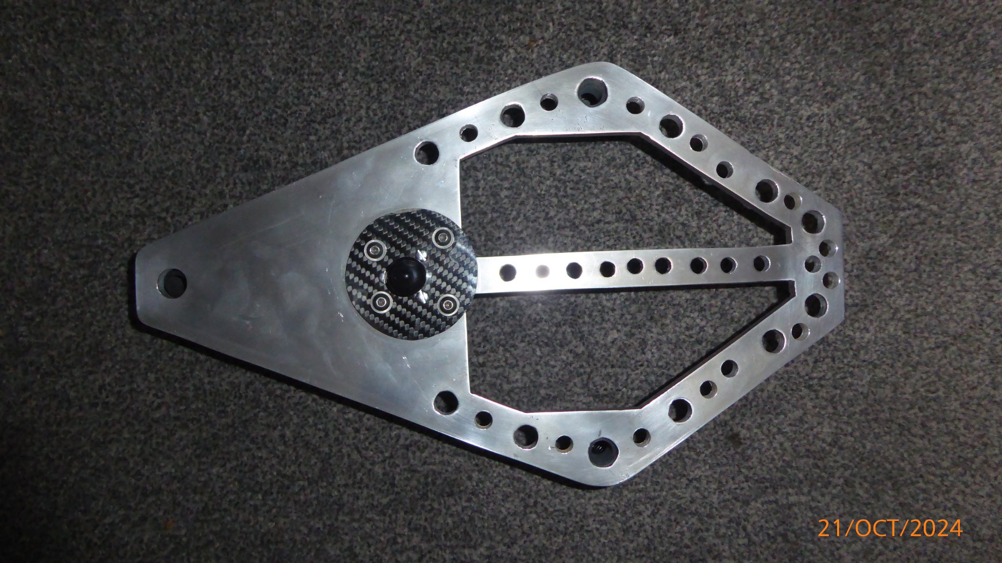

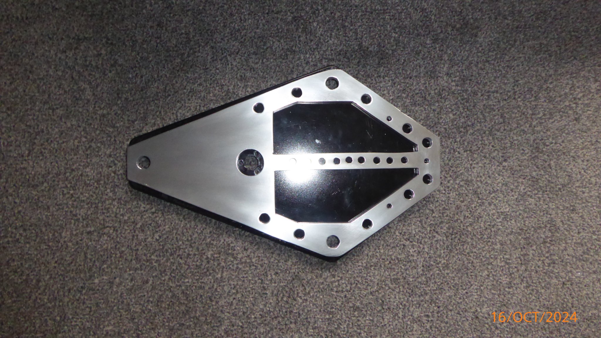

The Mk 3 I'm processing currently is a mod from my actual Mk1 Sub platter, just removing more weight and resetting the bearing housing. (See Pic)
That's a really interesting thread also thanks for pointing me to it.
I've just weighed the Mk 3 with the bearing fitted and it comes in at 718gr, which for 10mm alloy I think is pretty good. I'm also looking at taking more weight off the arm board as that's also 10mm solid alloy at the moment. I'm fairly limited in what I can do as I'm only using hand tools, but as I've already said appearance is the last of my worries, so if it takes holes to get weight off then I'm up for that.
So far cost is negligible and mainly just work hours, which I have plenty of being retired, I'd like to keep it like that. I have lots more alloy plate so can keep trying things till I get somewhere.
The Mk2 sub Platter works fine and the sound is very detailed, clear and expansive, but like most enthusiasts I think I can always improve it.
Thanks again for the idea, truly grateful for a new direction to go at.

That sounds very cool indeed, especially using a silent groove to measure the noise.
I'm not speculating here (but without the scientific noise measuring instrumentation) and using only my hearing.
On my Mk2 Sub Platter (goes completely against solid mounting) I mounted my arm board using sorbothane between the fixings of the bolts through the arm board and washers on the underside to the sub platter, and also under the fixing of the arm collar to the arm board and washer bolts. That gives me a little adjustment for the arm board to be levelled as well.
Those simple to implement mods seem to stop anything that I can hear with my ears in silent grooves also, there doesn't seem to be any transmission of bearing noise, and it only cost me around £20 for a sheet of sorbothane. And yes I am looking at sorbothane under the spring mountings and if I can under the bearing mount as well although room is an issue here..
Believe me here, I'm not dissing anything anyone does or reports, I'm just interested in different options and opinions, especially ones that anyone can do without too many specialities being involved. Simple mods can and do work if you are using your ears, as it is your deck your listening to.
Mine is definitely very quiet, has a massive soundstage with lots of detail and clarity. This is what I want and if I can do mods that anyone with minimal skills can manage then that's a bonus for me, and others to try out cheaply.
I think Linn decks are fine and if you want to leave it like it is that's great, if you can do stuff cheaply and simply for a little money, all the better. If you can work hand tools to a decent standard to fashion sub platters, arm boards etc, even better. But you can definitely make them sound far better for little money outlay (and lots of work). The deck is a simple mechanically sprung system where tuning that particular part can make a real difference, especially when it comes to resonance control.
By the way, having fallen foul of just listening to my system for noise before, I no longer yearn for that, music is my first love, not my system it's just a way of playing vinyl well.
I hope I didn't offend you as I'm very sure your deck is pretty awesome and far better than mine.
And thanks for the input it's very interesting.
