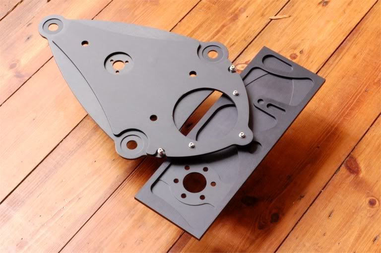

2. Linn's Keel - which did away with the lossy connection between armboard and subchassis (which was required with the pressed-steel subchassis) - at last delivered low-level detail retrieval ... and made the LP12 sound much better (than a pressed-metal subchassis equipped deck).

I became convinced of this when I bought a Cetech carbon-fibre laminate subchassis, back in the early 2000s. The concept with this was that the armboard was bolted to the subchassis ... providing a rigid connection. I thought my LP12 sounded much better with the Cetech (compared to the pressed-metal subchassis) - but the Cetech got a bad rap from a lot of people because you had to be careful how hard you tightened the bolts holding the armboard to the subchassis. (Too hard and you stressed the skins of the armboard - this stress put a hard 'metallic' edge on the sound.)

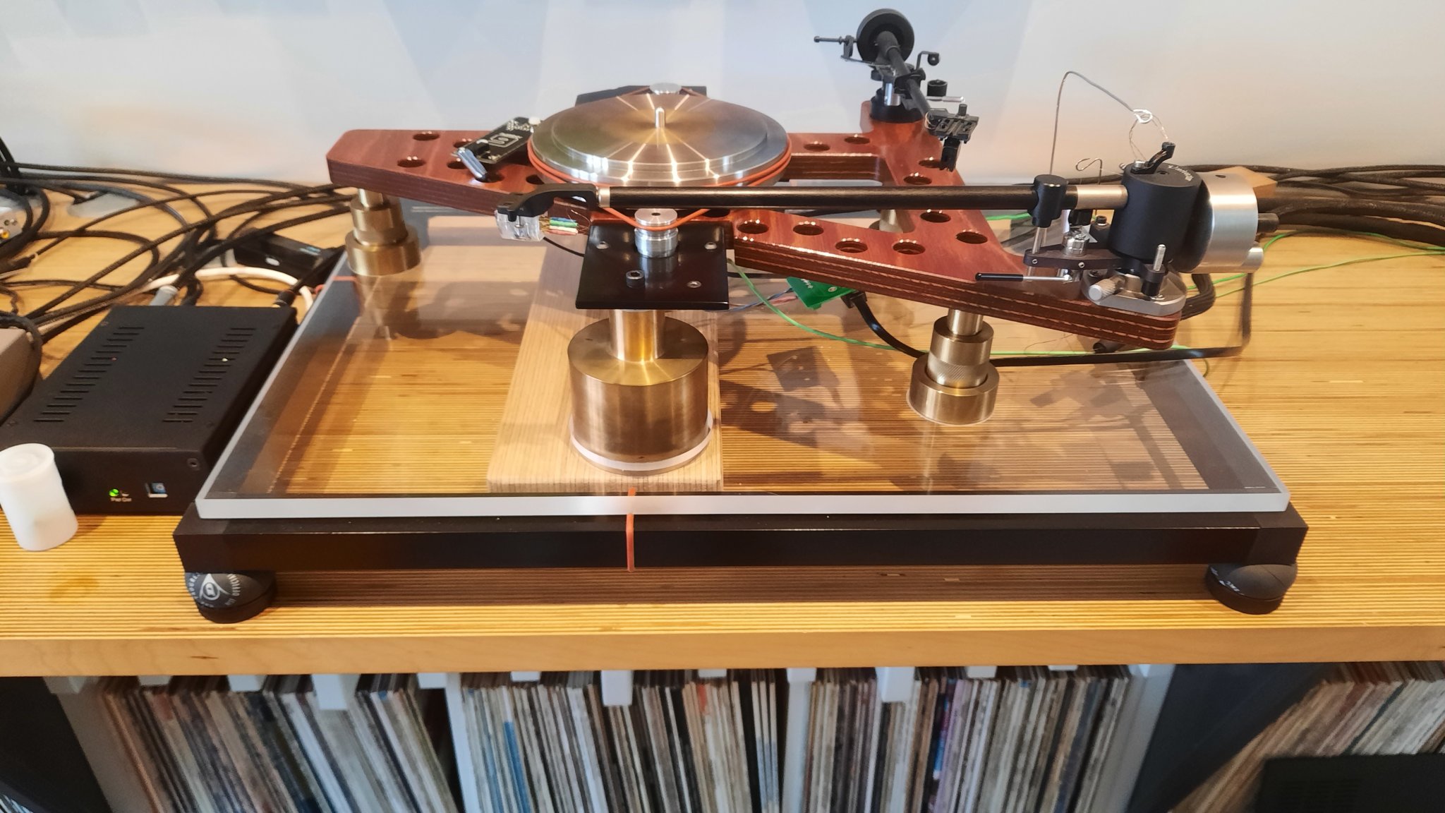

I use an Al tube frame resting on squash balls to support the perspex base of my 'SkeletaLinn' - this is a pretty good isolator.

That SkeletorLinn.... At what point does it stop being a Linn and becomes a Frankenstein? Does the bearing, motor and "keel" define it? And how do you reach to the back tonearm?
That's a very impressive build. How many tries to get to that point?

That SkeletaLinn.... At what point does it stop being a Linn and becomes a Frankenstein? Does the bearing, motor and "keel" define it? And how do you reach to the back tonearm?
Yes, that's a good Qu! 👍
I would suggest it's:
* fundamentally, the bearing
* but aided by:
a. springs and
b. belt drive.
At least - that was my conclusion when a friend came over for a listen (who owned an LP12) ... and said "that's definitely a Linn"! 🙂
Although it started off with nearly every part, standard Linn - including the springs, belt & motor - now the only 'Linn things' left on it are:
- the outer platter
- and the Karousel bearing.
The rear tonearm is easy to reach ... but cart alignment on this arm is tricky. 🙁
Hah - this is v4! 😀

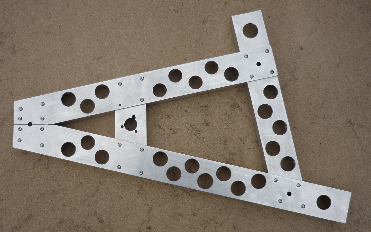

v1 was a 'chassis' made from 40 x 20 aluminium C-section ... which I assembled using my trusty hacksaw and drill:
This turned out to have too much weight on the LHS spring - so I made the v2 chassis (again from C-section) by extending the apex of the triangle, 50mm to the left.
Then I found someone who had access to a CNC machine - so got a same-dimensioned chassis made from 18mm Delrin. Unfortunately, it turned out this v3 Delrin chassis wasn't stiff enough - and sagged with the weight of the inner & outer platters. It also, strangely, caused an annoying static to be present after every LP was played. 🙄
So v3 was replaced by v4 - the same dimensions ... but made from Panzerholtz.
