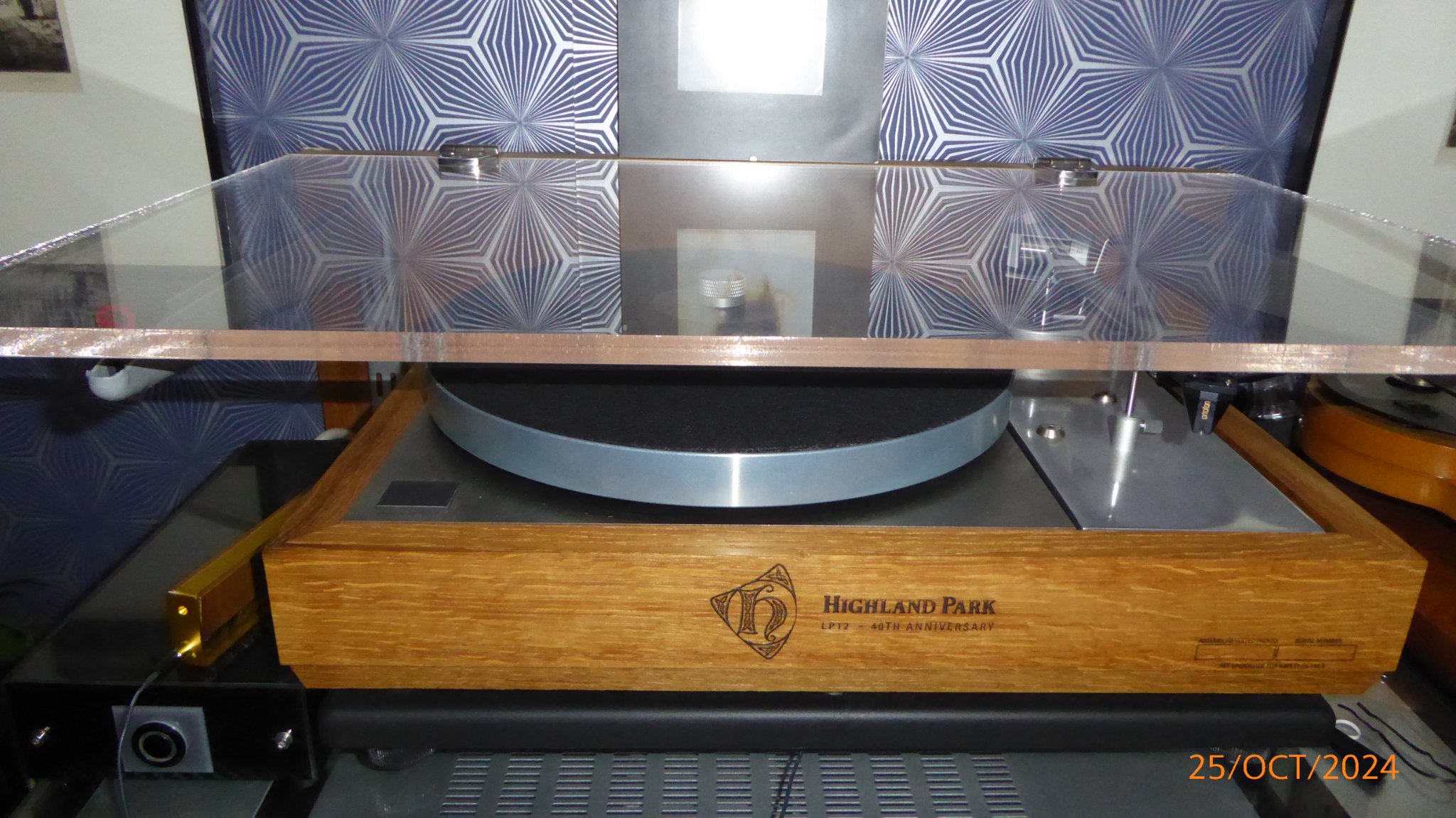

Mine is on a steel shelf bolted to the wall with 6mm toughened glass. Has a 10mm acrylic baseboard with 15mm thick sorbothane feet and then on a Townsend seismic sink. No lid or anything to rattle so external vibrations are not an issue even with loud music playing as my speakers are in front of the turntable.My LP12 sits on Trampolin 2 feet, on a Target TT5, spiked to a the floor which is on the slab. So far I have not noticed much, if any "ringing", as the table sits on a very stable stand and vibrations seem to be "sucked" away. I can walk, jump in front of it, and the tonearm sits still. No sounds coming out of the cartridge at all.
It's the internals I'm trying to control, it works fine with what I have at the moment, just always seems like I can get it better, and some folks reckon metal to metal connections on the arm board/subframe brings out more detail.
I'm going to try both on the new subframe while I have it on the shelf above so I can work on it more easily.
I'll post results (if anyone's interested) after I've tried both (it will be subjective as always) or (by ear) as I haven't got any electronic testing stuff. I do have a good ear for detail though, as does my musician wife, and she's brutally honest.
