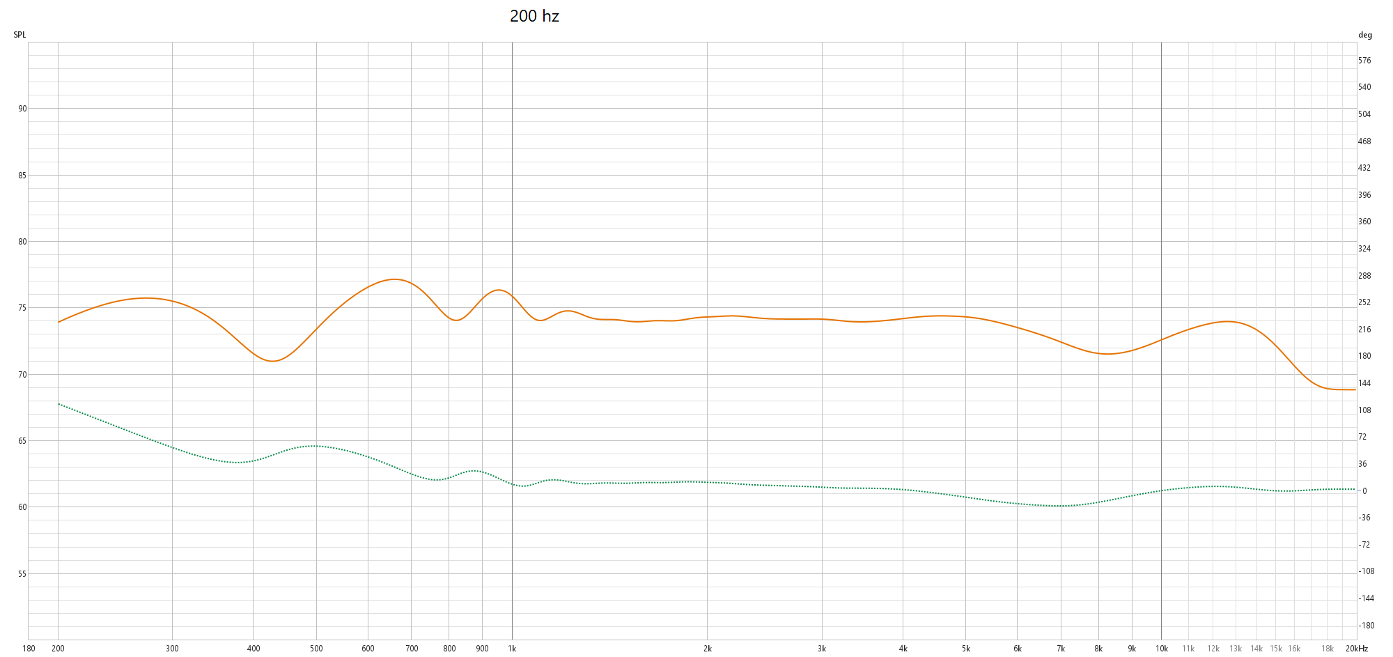

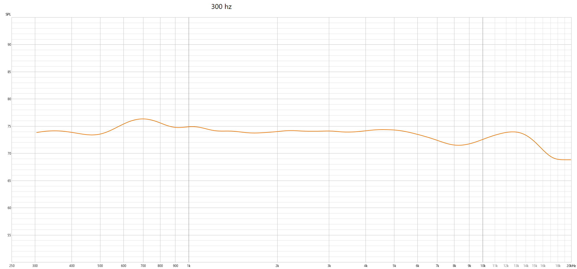

300 hz

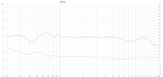

Last was ca 7-8 cm above my ear, and the one before that (gated to ca 350 hz) was earlevel.
Left speaker only!
Are you using REW? Has smoothing been applied? If so, how much? I usually use 1/6th during x-over work.
That's really impressive for the speaker standing on the floor, and not raised. Can you move the gating down to 200hz without a bunch of wrinkles showing up in the response?

Yes using REW
Speaker stand on the 62 cm high 15 inch ported Dayton rss390ho in 100 liter, pointing on mic/me in the sofa 3,1 m away, but mic at 2 m.
Will try gating to 200 hz and post it here soon 👍
I know you probably don't want to make a lot of work trying x-overs, so I'll assume that there's no need for more Sims. But Sims are fun! Can you post a 300hz gated frd of mid, and tweeter with 1/6th smoothing?
What smoothing are you showing now?
I always use Var smoothing in REW (its like 1/6)

REW has an option to show below the 300hz gating as a dashed line. It is said not to be as accurate below the gate, but sometimes visually, the dashed line makes it easier for me to tell what I'm doing. You might like the feature. Gating generally shows a low end roll-off. I just ignore that, and think of it as flat below the gate, even if it's not.
Nothing magical about 300hz. If you can get to 250hz, that's a hair better than 300hz. The end result will be close with either gating. It's tricky with 3-ways, or 2.5-ways to get good low frequency accuracy. If you were making a 2-way 300hz gating would be suitable, no question. I spend a lot of time listening, and making changes based on both what I hear, and measure.

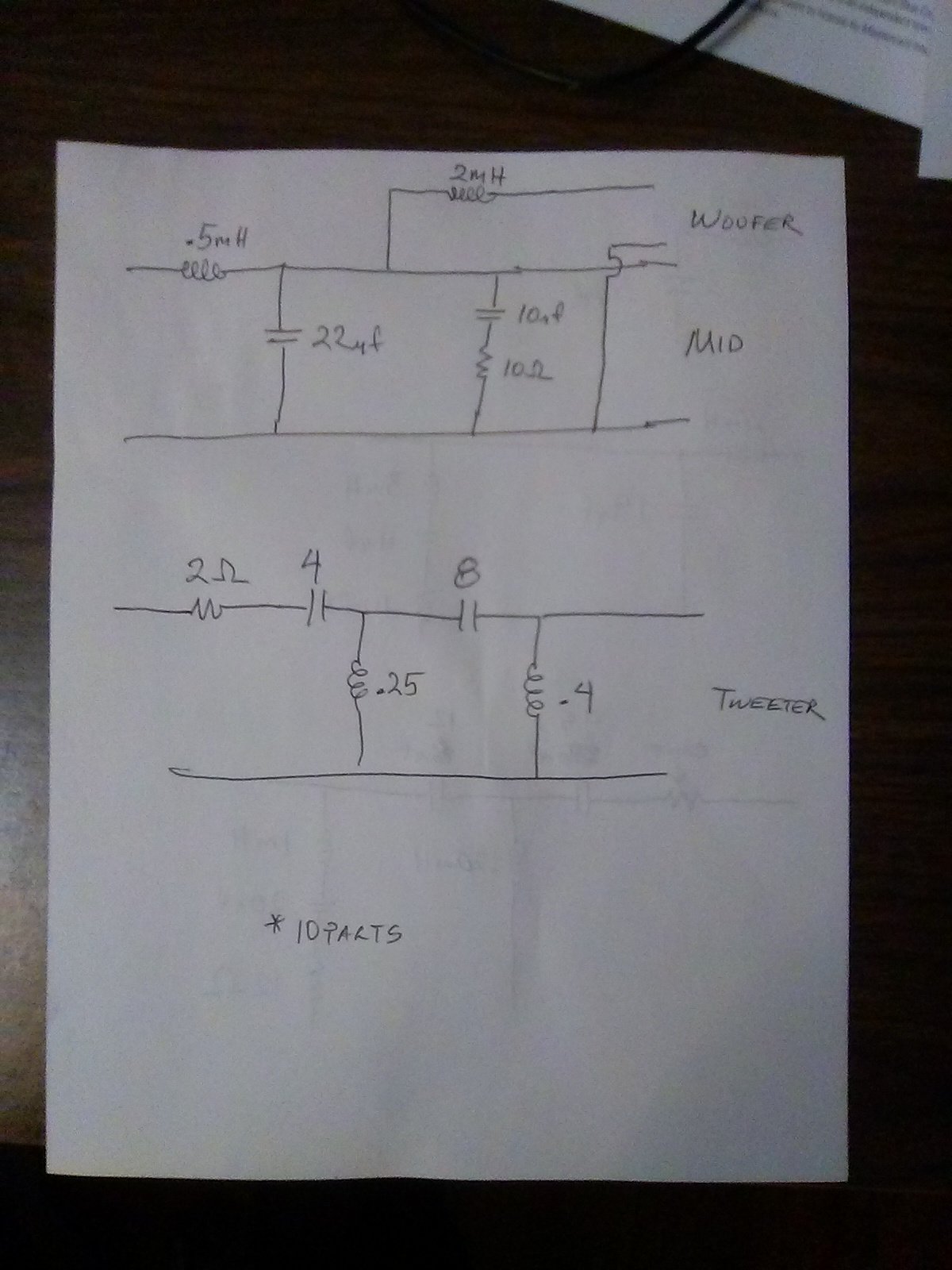

Check this out. I drew the schematic in an awkward way, but it is essentially correct, I think. Only 10 parts in the x-over.
