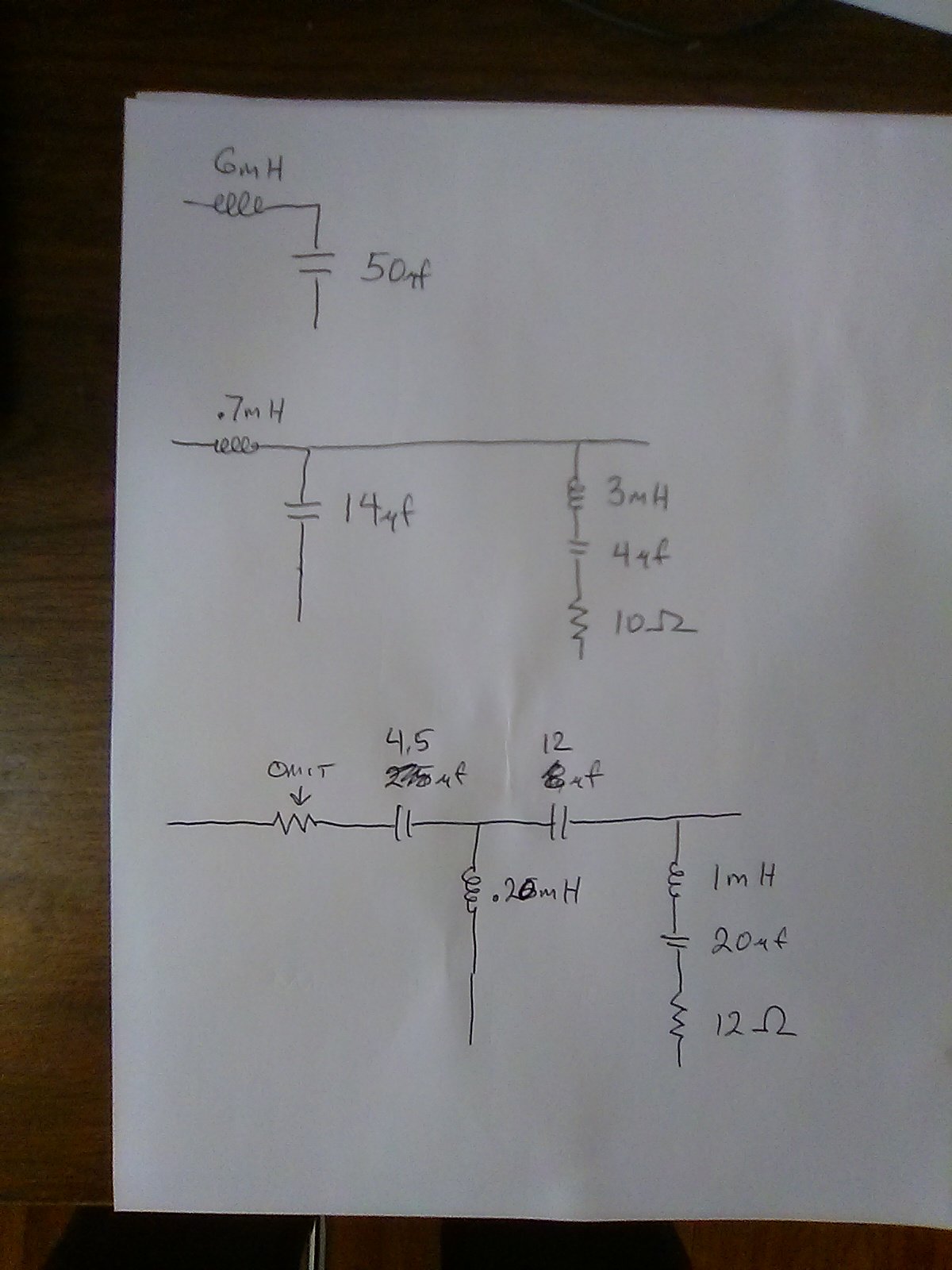

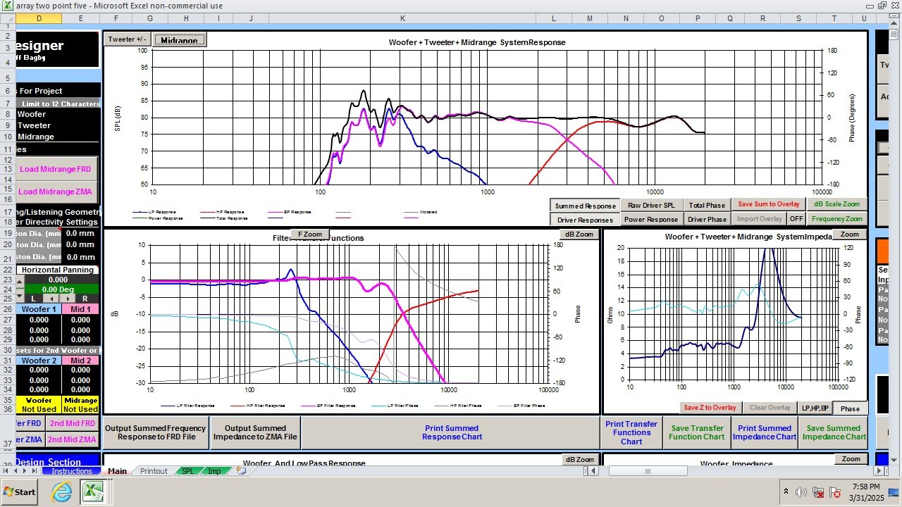

That probably changes the ideal filter, but here's the one I was working on. Try this filter in your sim. I can also show you one where the woofers go up higher. If you cross to the sub at 200hz there's not much being played by the outer woofers using this filter. It really becomes subjective.
I will simulate you values 👍That probably changes the ideal filter, but here's the one I was working on. Try this filter in your sim. I can also show you one where the woofers go up higher. If you cross to the sub at 200hz there's not much being played by the outer woofers using this filter. It really becomes subjective.

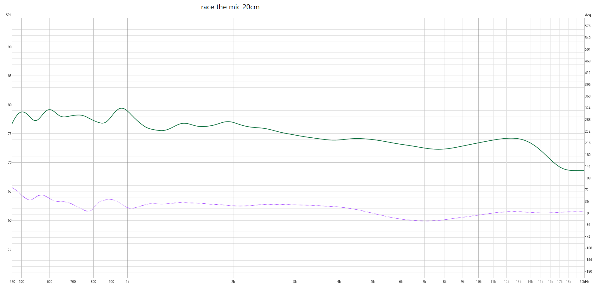

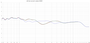

Just take 2 measurement from my sofa on left speaker, mic at ca 2 meter 1/3 up on speakers hight.
So mic is around the lowest midrange above the 2 lower woffers.

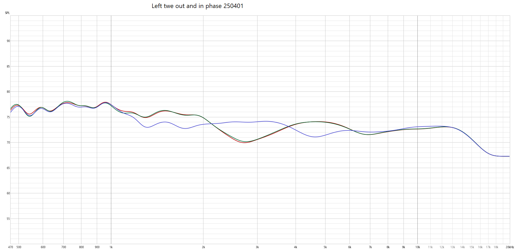

Tweeter in phase and out of phase

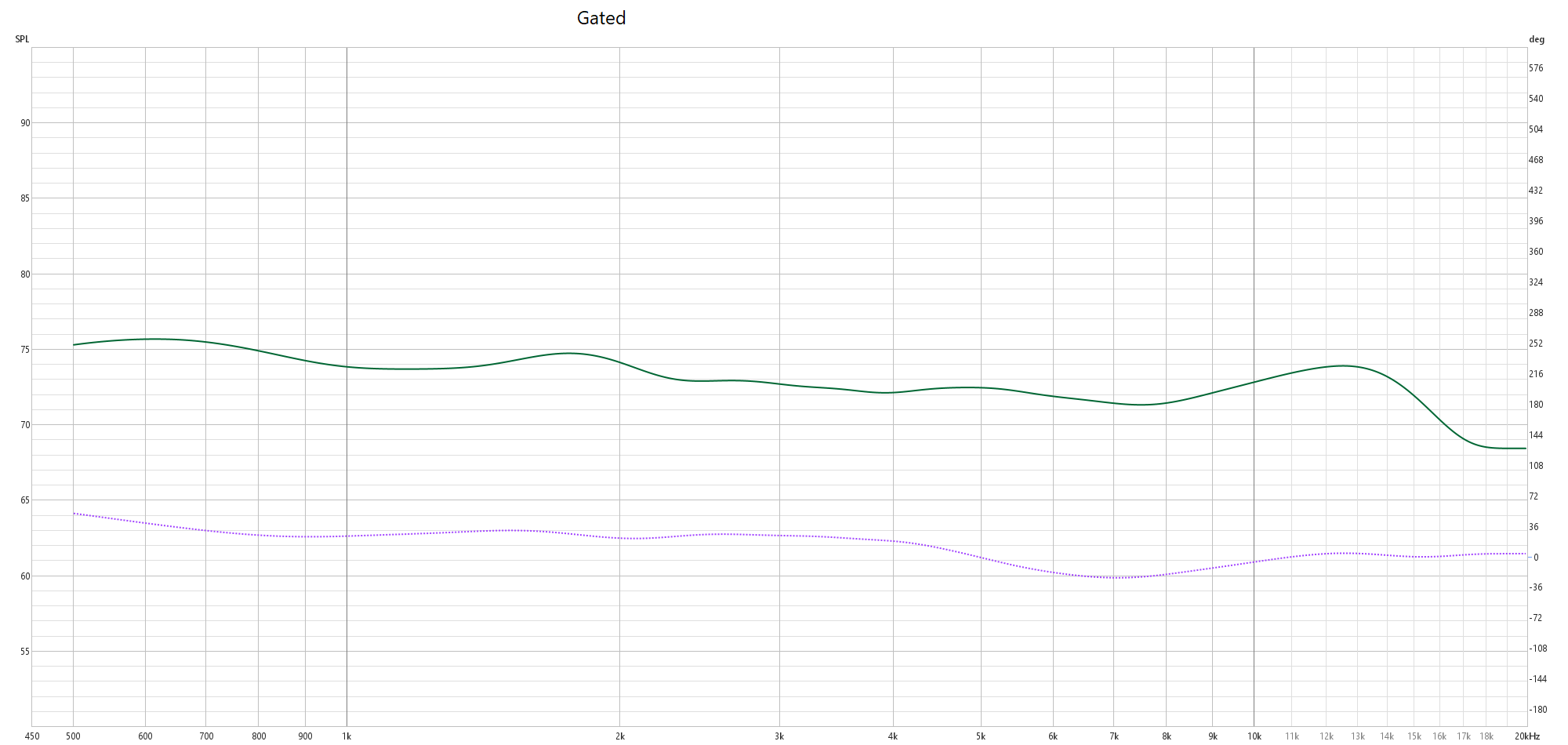

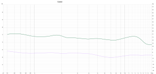

Can you convert measurements to gated? I use REW to measure, and it's easy to do, after the measurement has been made ,in that software.
The one time I used non-gated measurements for x-over work, I did not like the results.
Is this "Gated" ?Can you convert measurements to gated?
It's hard for me to tell, but if I interpret those measurements, it seems like the ideal listening axis is closer to the second measurement.
Can you show me gated measurements? That would be just the speaker, and without reflections. However, since the speaker is near the floor,they may be a mess anyway.
Yes it is. Can you gate lower. Maybe to 300hz, instead of 500hz? The response will just stop below 300hz. The lower you can go, the better, but room reflections will limit how low.Is this "Gated" ?
