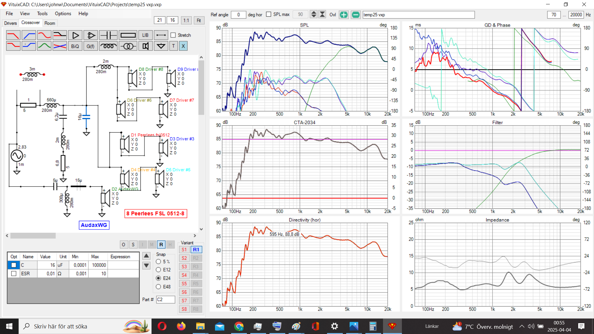

How do you reckon two 5" drivers 1 meter apart at 300Hz sum at different locations in space? The sim was if both drivers where in same location....Not if they are the same distance from the mic, and identical drivers.
How much error do you think there would be at 300hz from a 2" error and equal spl?
How much from a 3" error at 800hz where one driver is 10dB lower in level? How many dB?
Why not sim reality instead of fiction?

Okey, understand 👍The x value would be zero for all
Get that to 👍The z offset would be like for a very deep wave-guide
Yes that radius is trickey haha.I don't know the curve radius of your speaker, but I assume that when you measure, the woofers are all close to the same distance from the mic. Small differences make little, to no difference at low frequencies.
First 4 drivers from bottom is flat ( 2 bottom woofers and 2 bottom mids )
Then 3 driver ca 2,5 to grades tillted forward ( mid+twe+mid as a MTM)
Then top 2 drivers ca 5 to grades tillted forwards. ( top 2 woofers )

I was not addressing you as you could see in my quote. OK, I would advise to read up on how the positions x,y,z is used and defined in the program and also set the mic position that is equal to that what you have in your listening position and check out what you get. This would help you to reach the FR that you would like ot listen to. It will also give you an other result than if you have all xyz to 0. When you listen to a speaker in a room, 10% is coming from on axis and the rest is from reflections, thus, a speakers behaviour in all directions is important. xyz pos has a great impact on this behaviour.
Your spot on Dan 🙂Don't take this the wrong way but the theory puzzles me. Part of this speaker will be a line source and the other part will be a point source. And like any two way speaker both will be producing sound at the crossover frequency.
That is my goal.
A 2,5 way linesource with pointsource behavior.
So far it working real good

I have no use to tweak X,Y and Z for all drivers in my Linesource simulation, think its more for 2-300.000 $ speakermanufactor to have some PR
My curving/radius is there just for the reason, that all drivers sound will meet my ear in the sofa about the same time.
Then whether I succeed in it, is another matter hahaha
The xyz functions are easy to use but the situation is complicated since the reasons for invoking each axis are different, and the positional controls have limited scope which affects when you should use them.
You must not enter x, y and z for each driver without a specific reason and I'll outline these for a typical case (your own way is OK if you understand the consequences).
Measurements are usually timed to include delay. Changing the z parameter individually would double up on the delay differences. Measurement is the best way to capture those and it is unnecessary, complicated and potentially misleading to extract a delay figure to include in the simulation. It is also unnecessary to do if you want to successfully arrive at a delay figure to apply to a DSP. The most common use for the z parameter will be for people with USB mics.
The x and y parameters are the primary way that Vituixcad calculates the spatial effects of the combined aspect of the polars. For the simplest case this means the crossover region itself, since you don't measure the drivers together (you want it to change as you change the filters). It is also suitable for line array use (etc..) affecting power and lobing beyond the individual polars.
This intended use is the reason that the manual states that individual drivers should be measured around their own axial planes, since again we don't want to double up on (some of the) effects.

There are certain things that these parameters do and things which they don't do and this affects what they can be used for. They change the relative delay (phase), they change intensity with distance and they change the spatial summing in a couple of different ways.
They do not change the baffle effects such as the baffle step and response variations, and they do not change the path length around the cabinet on different sides. Eg therefore you could hide them behind a virtual baffle and still see output.
There are two things that come from this.
1. With unique speakers you have to measure according to your specific simulation needs,
2. You have to re-measure if certain types of change are made or certain simulation intentions are altered.
