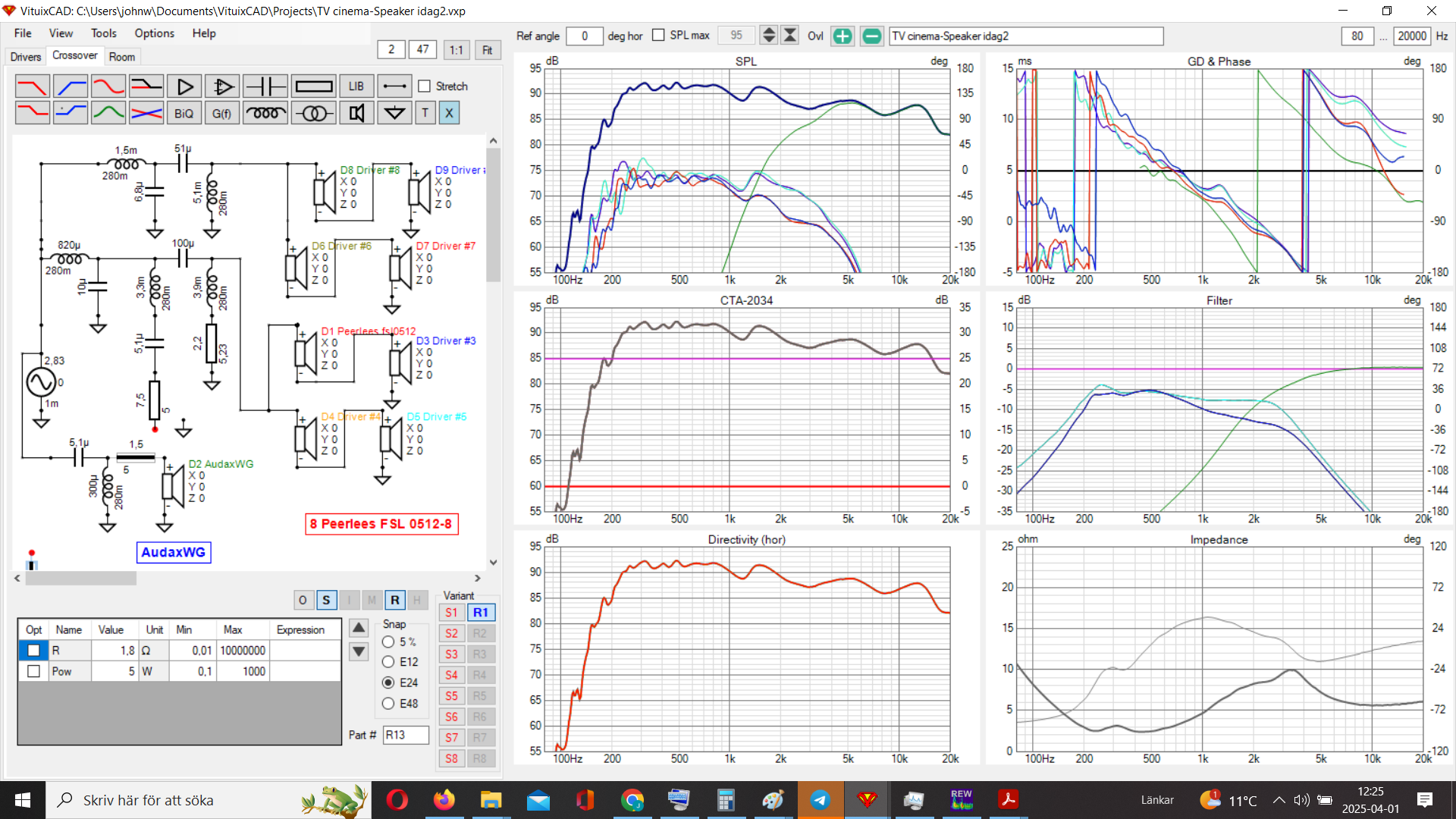

And now iv´e tried to "trick" SLP-Trace in VituaXcad, by halved the ohm scale and then create a zma file for every indevidual woofer.
So now ZMA/impedance files are "more" correct, and i maby have more to work with in my simulations...
Possibly need a notch around 1200 hz, but we will see.
best regards John
The mid filter.
That 6.8mH coil, and 2.2 ohm resistor is dropping your impedance. What is the purpose of that leg? If you need to shape the response, there may be better options.
The two bottom woofers in series would be 16 Ohms. When the two top woofers are added, (also 16 ohms), the woofer filter sees 8 ohms. That would be like a sim for one woofer, but with a 6dB higher spl. I'm not defending software, but maybe you are misinterpreting it.

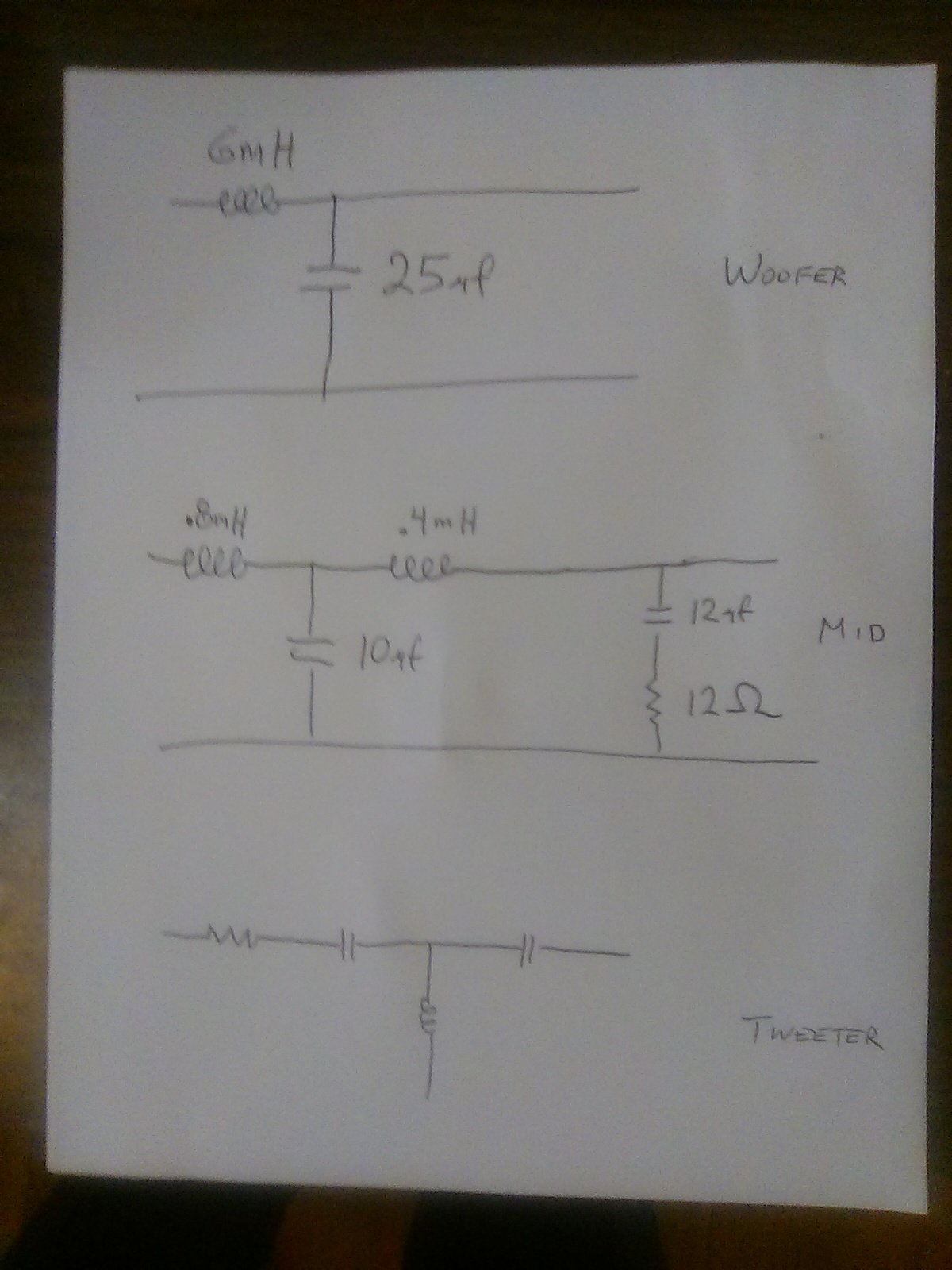

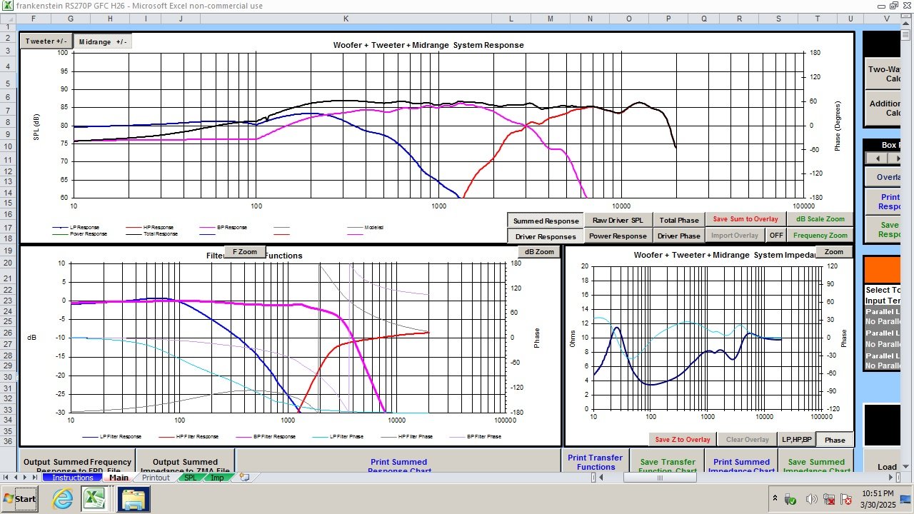

This is how I would try to make things work.
The low end looks like it's rolling off, but that is due to the gated measurements. There's no high-pass on the mid.
Don't look at the low end. It looks like these files had tails added,which is something I only tried recently. Mostly look at the filter transfer functions. Outer woofers would roll off early, like the blue response, and most of the mid-range (red response) , is from the mids.

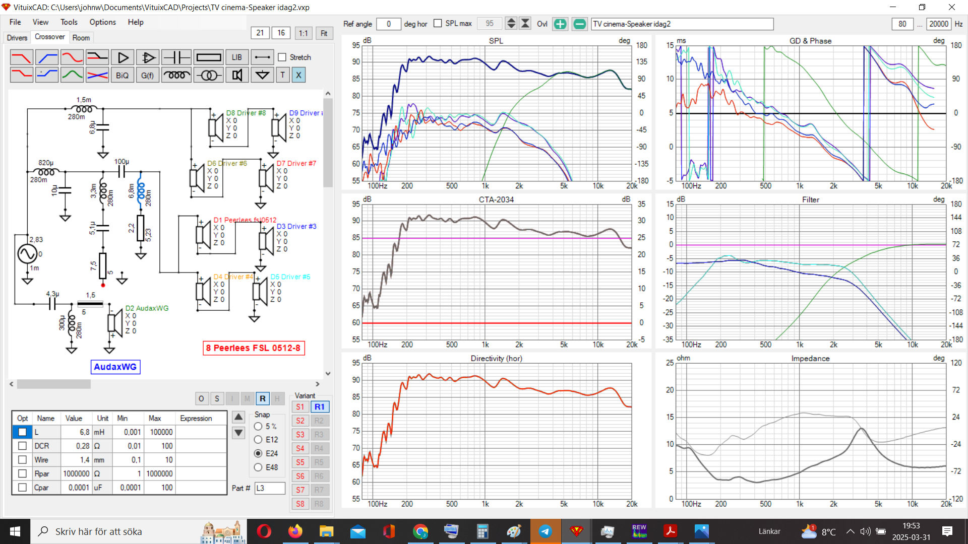

Jawen would you mind showing us what 6mH and 50 uF does do when applied to the top filter leg, simply replace your existing values and post the results if you don't mind.
Maybe play around a little bit on tweaking the values just to get a nice cut off of the 4 woofers response at 250Hz or so. Maybe it will show a huge suck out, or certainly mess up the flatness of the response. It should be something close to temp25's data in terms of roll off.

Its 12 dB HP att ca 200 hzThe mid filter.
And yes it lower the impedance.
Do you mean its better to just have the 100-150 uF coil, and have 6 dB HP?
Correct!The two bottom woofers in series would be 16 Ohms. When the two top woofers are added, (also 16 ohms), the woofer filter sees 8 ohms. That would be like a sim for one woofer, but with a 6dB higher spl. I'm not defending software, but maybe you are misinterpreting it.
But its small differances in measurements on upper woofers and bottom woofers, and poeple all the time say´s "measure all driver" and then simulate.

Here you go Ray 🙂Jawen would you mind showing us what 6mH and 50 uF does do when applied to the top filter leg

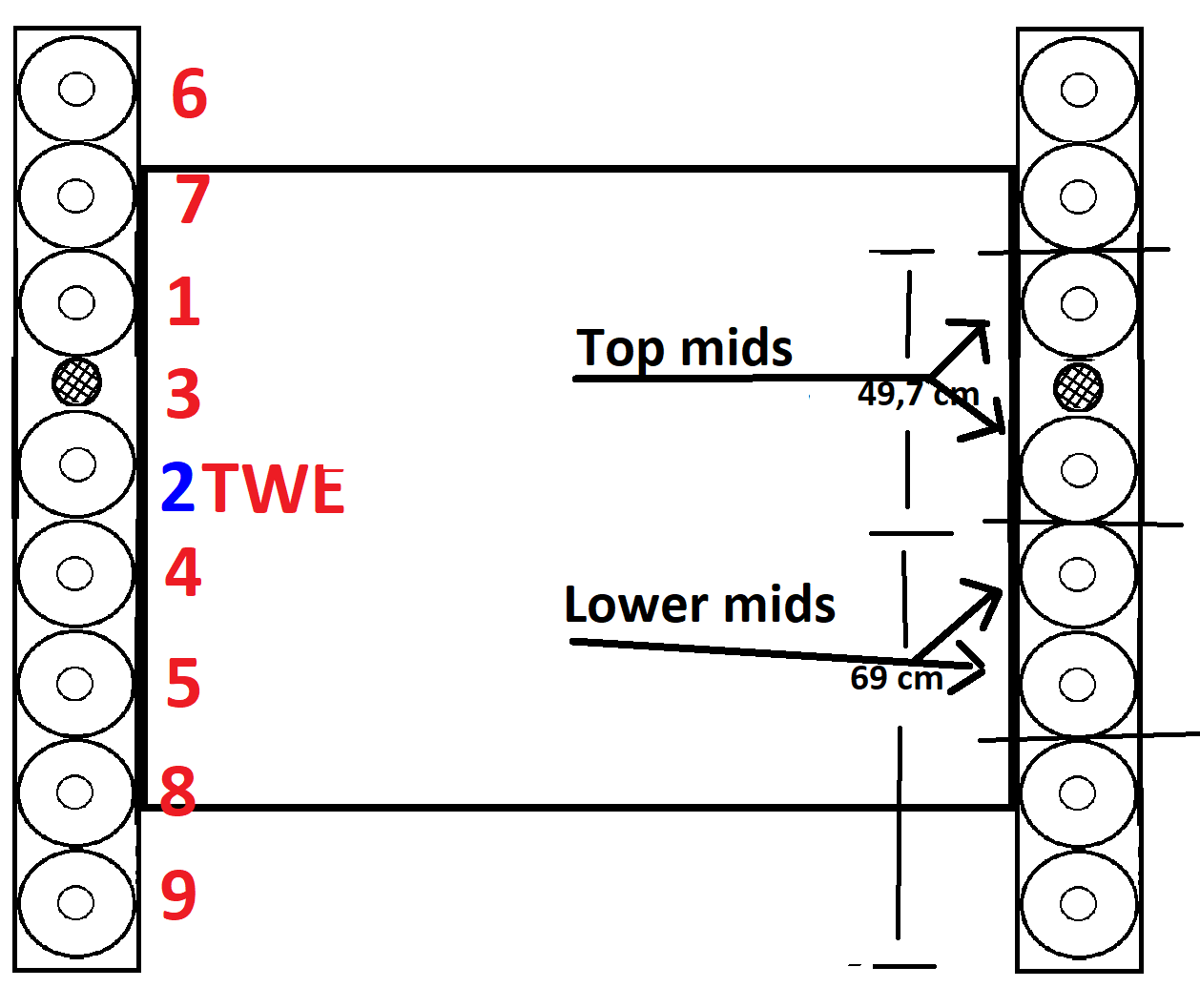

And from PGN use SPL Trace tool in VituaXcad2.
Just to be clear, topp 2 midranges is the ones obove and under the WG tweeter.
2 lower midranges, is the 2 between 2 lower woofers and the midrange under the WG tweeter.
regards John

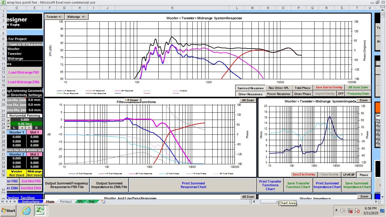

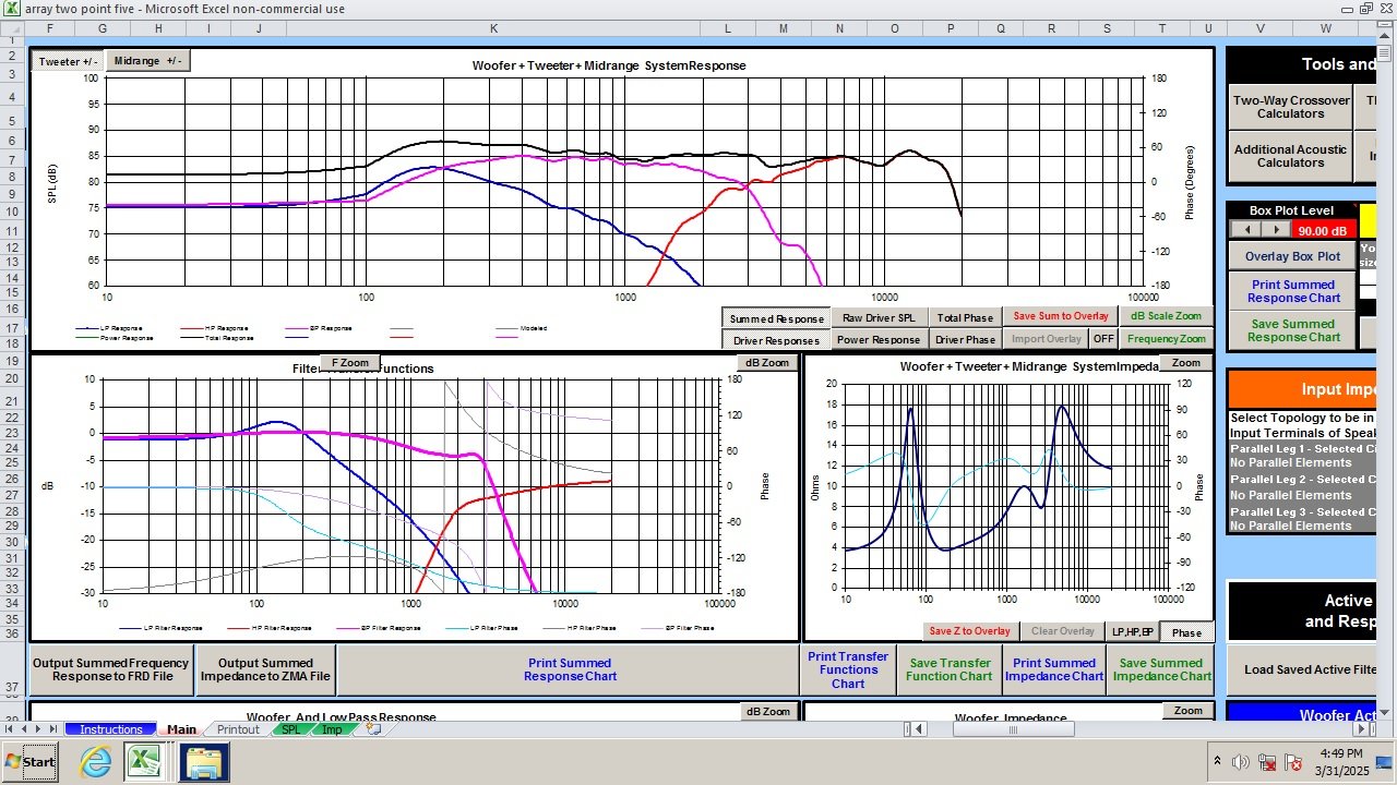

Here is a sim of a 2.5 way using my gated measurements of a 5.25" Peerless woofer. This may have a similar response to yours. I don't know that this filter is a good one, but it seems like maybe it is. Maybe you can try it in your sim, and see if anything is usable.
I can't sim the mid section of your filter in PCD. I really can't tell what it's doing.

Here's a sim of just 3 drivers, and not in an array. There's some padding on the tweeter, so in the array, the tweeter needs no padding because the extra woofers boost their range more.
I can post the filter later. It's not terribly complicated.
Rolling the woofers off earlier did not seem to add as well to the other woofers below 100hz. So, here the .5 woofers go higher than what I was shooting for.
