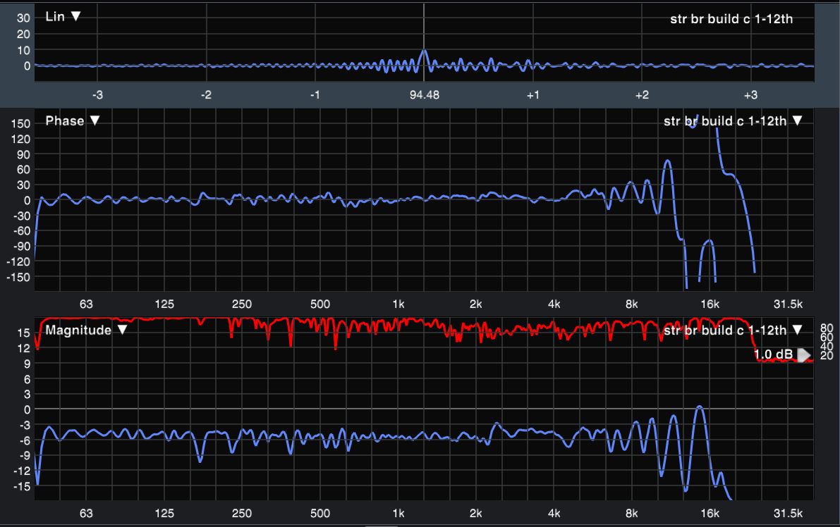

Hi ra7, that was the 'tuned in-room' measurement ....
here it is as requested
Mark, I'm confused. Why doesn't the tuned measurement look as good as your 4-way measurement? Or, was the 4-way an outdoor measurement, and the line array tuned one an indoor measurement? I would try to tune the indoor line array measurement (all sound included, not anechoic or FDW) to the B&K curve as a start.
Hi, sorry for any confusion.
Not sure which tuned measurement you are asking about vs the 4-way, indoors or out?
And nope I haven't been comparing the line array indoors vs 4-way out.
To make sure i don't create anymore confusion, let me contrast what measurements I've done indoors and out.
A quick aside first ...(Ron, I know you keep working to convince me that I have to think of the line and the room as an inseparable system, and i completely agree with that in the end.
But before I try to jump to that end, I really feel i have to understand the line outdoors. Thank you very much for your patience my friend )

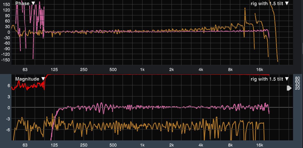

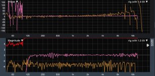

OK, outdoors first. First graph below is the 4-way and the line.
4-way is pink; line is orange. No smoothing mag or phase.
The 4-way is actually just the 3-way main portion w/o sub. All my designs cross at 100Hz to the sub, I will be using the line the same way.
Both speakers' corrections were done with FirDesigner. The 3-way uses 4096 taps per channel, the line 8192 taps.
The first thing I noticed outdoors was that the line does not clean up as easily as the multi-way. Second was the lines high end wildness above about 4kHz.
(This was what prompted all my speculation/line theory questioning about c-to-c spacing earlier in the thread.)
ra7, you were asking about the red coherence trace earlier.....in this first graph the coherence is for the 3-way...notice it's ruler flat 100% above HPF...that's as good as it gets..
The second graph is exactly the same as the first, but now coherence is shown for the line array trace..really good till about 4kHz, then further evidence of interference.

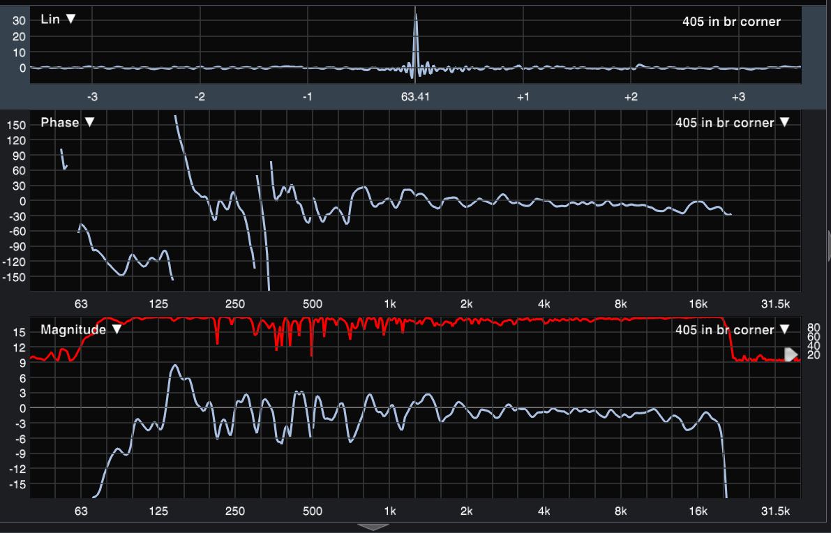

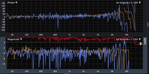

OK Indoors.
3rd trace is the line array with outdoor tuning; vs indoor with indoor tuning.
Outdoor is same as previous two graphs. Orange.
Indoor is the same tuning that was posted in #134. Blue
But this time indoor has no smoothing or FDW. Jagged indeed.
Indoor tuning was to one spot about 10 ft away, about 4 ft off floor.
Normally, when i tune a 4-way to a single spot like that indoors, I get curves that look only a little more ragged than outdoors.
(I don't tune to a spot like that because i know with FIR doing such is bull**** tuning.)
But the fact that the 4-way will clean up near perfectly to a single spot with 4096 taps of FIR, and the line won't come anywhere close with twice that, makes me realize I have a lot more to learn here..........
Anyway, hope all the above clears up any confusion i may have made re measurements and comments about them.

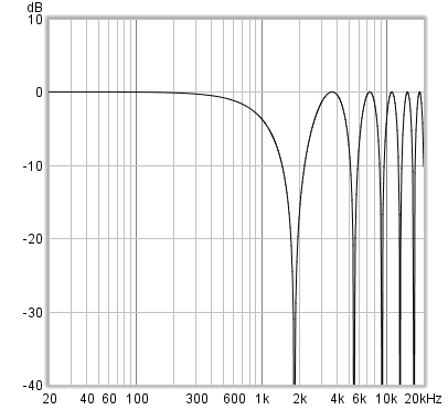

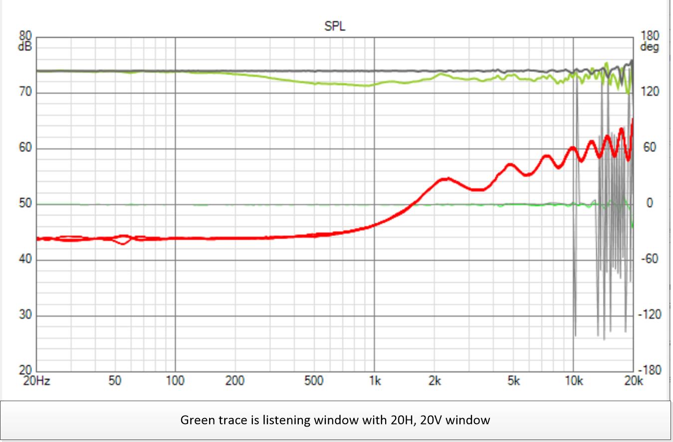

controlling the wildness in the top octave
Given the questions about ripple/combing/wildness in the top octave, I searched the literature for an answer and failing to find one turned to Vituix simulation. For the most part, the line source approximation starts to degrade where the spacing equals half a wavelength and is just about completely gone at a spacing of 2 wavelengths. Thus, we are advised not to go there. One source, I forget whom, acknowledged that might not be an option and rationalized that much of the degraded response might be above our hearing thresholds.
But there is some hope and it shows Mark's wisdom in preserving the option for shading. In Vituix, I see two things:
* shading can reduce the magnitude of the combing ripple
* the combing ripple can be equalized away - the corrections hold over a sufficiently wide horizontal angle to be useful.

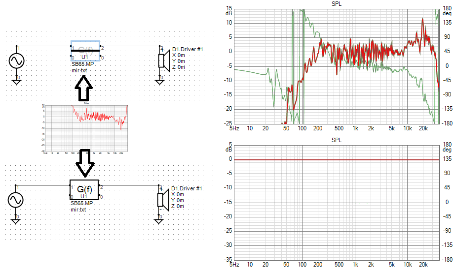

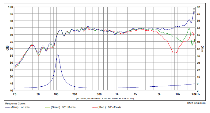

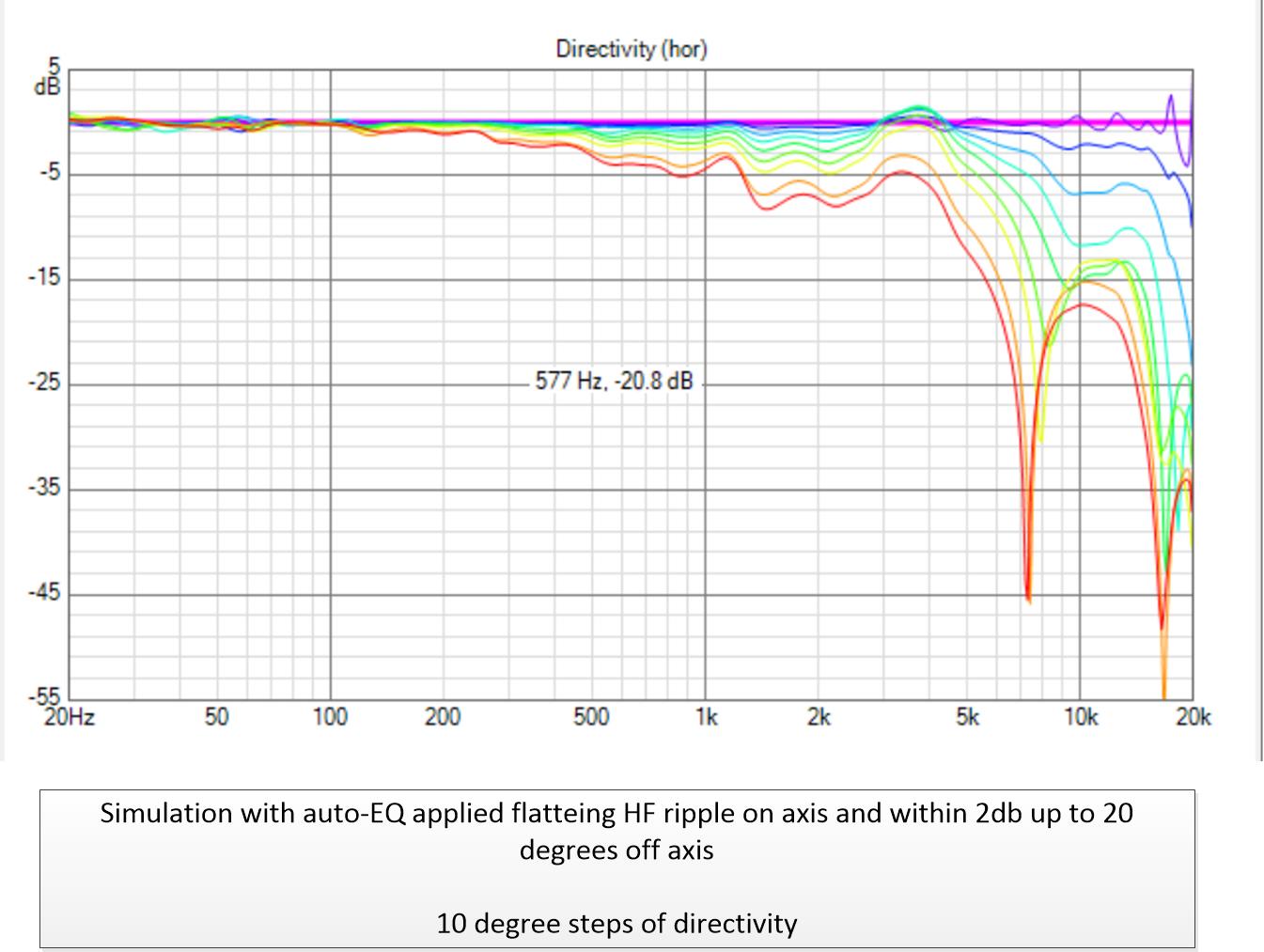

The attached screenshots are of the Vituix sim of my 32 driver SB65WAC25 array. The weighting isn't optimal; its literally the first I tried to determine if the approach was worth pursuing. The center 8 drivers are full on. Each group of 4 drivers going away from center is 1 db down relative to the previous group. Inspiration can be found in Dave Smith's paper. I wanted to approx raised cosine weighting; the sinx/x was too complicated for my taste. I'll look for more optimal weightings and happily accept help there as some of the math makes my brain hurt.
The Vituix simulation is just a simulation and has yet to be correlated with reality. Its based on my set of 10 measurements over a 90 degree arc of a single driver in a test box with approximately the same baffle width of the array I have in development. Vituix uses this directivity when summing the responses of all the drivers in the array. I've done manual equalization of the array's response so I can look at the directivity un-normalized.
The simulation doesn't include ground/ceiling effects and shows limitations when I try to include them. I trust the differences between two sims - i.e. weighted vs unweighted - a lot more than I trust absolute results.

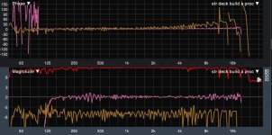

First screeshot below is a 3-way in the same room corner as I've been posting for the line. It has spatially averaged outdoor tuning. 1/12th. Light blue.
Then comes the same indoor line trace shown previously on its own, with 1/12th smoothing to make it more intelligible. It has tuning to a single spot. darker blue.
I wish I had the 3-way completely tuned to the the same specific spot, I will try to produce those for comparison when i can tear up the bedroom again. That might help examine the dramatic difference I see in FIR's ability to tune to a single spot... (which i guess was what i was trying to explore in previous post.)
I'll also try to grap the line inside with outdoor tuning.
I make out two general observation on these traces.
First, the line totally rocks in its low end control...the infinite line theory works!!! Look at the performance and coherence below 250Hz. And the HF combing theory in play, is pretty obvious too.
Second, the point source totally rocks in its high end control, but has no control down low in comparison to the line. The two traces also show how much IR is dominated by HF response....
I do know there is a ton of acoustic room tuning needed to give the line its chance to improve the HF. That and maybe the shading that nc535 just played with.
Can you explain the traces in the weighted vs unweighted a bit?
I'm having a harder time following them than i thought...

Let's see if this little bit helps:
Red traces are the driver or driver_group voltages
Black traces across top of SPL is "total SPL on axis"
The green that follows below that is a listening window average, 10 degrees H and 10 degrees V, if I recall correctly
The gold trace is an overlay showing the un-EQ spl of the flat source
The other green trace is from "show minimum phase". I could have shown normal phase but it would filled the screen with wrapsl.
The EQ is 12 PEQs. I haven't figured out a way to auto-EQ to flat. I should be able to export to REW, from REW manually back to Vituix. I would love to EQ out those HF ripples and see how it holds over directivity, now that I see same/similar ripples in your SPL (2nd graph in your long post)

Hi Jack maybe easyer said than done but in short export that response with HF ripples and open it in "Calculator" tool under "A responses", now pick "Mirror A" and set "dB" number so that at 1kHZ point response is aproximately lowered to zero dB SPL line, hint there is a "A" button at lower left to re focus graph area. Now push "Calculate & Save" and load that into a new upstream filter of poweramp called "Transfer funchtion file" in schematic window.
You can see example below for my own SB65 on a big cardboard baffle 1/48 smoothing exported from REW, alright in below after EQ response gets flat as a pancake from DC to lightspeed but that can be edited manual directly in frd file so that stopband slopes from original is replaced in the mirror file, or you can take it back into REW where the "Merge B to A" filter in "SPL" tab can merge those two stopbands slopes back over a two run session.
Another intersting thing in VituixCAD is if you load that mirror in a emty session to a driver, you can pick "View"/"Impulse response" and create a IR wav-file that will EQ that driver flat as pancake when loaded directly into JRivers convolution engine. Think this is very neat feature and actual if one has a very neutral speaker or head phone reference set one can use the "SPL trace" tool to trace a transducers datasheet response and then load it same way as above to hear how that driver will sound raw out of box.
Assuming you have uniform spacing in your array, it's easy to see that the inter-element delays (delays between neighboring drivers) at the listening position will be minimal for drivers at ear height, and maximized at the ends of the array. That's just simple geometry. That's why shading helps with the ripple, though it also decreases the directivity of the array.
Although the same EQ might address the ripple across a wide azimuthal angle, what about at elevation angles? You might not have to move far up or down to need a different EQ.

You were right it was easier said than done but not too bad. Tricky part was getting the db number right. Trick is to enter half the distance you want the display to shift.Hi Jack maybe easyer said than done but in short export that response with HF ripples and open it in "Calculator" tool under "A responses", now pick "Mirror A" and set "dB" number so that at 1kHZ point response is aproximately lowered to zero dB SPL line, hint there is a "A" button at lower left to re focus graph area. Now push "Calculate & Save" and load that into a new upstream filter of poweramp called "Transfer funchtion file" in schematic window.
Here is result
Skepticism is warranted.Assuming you have uniform spacing in your array, it's easy to see that the inter-element delays (delays between neighboring drivers) at the listening position will be minimal for drivers at ear height, and maximized at the ends of the array. That's just simple geometry. That's why shading helps with the ripple, though it also decreases the directivity of the array.
Yes, it is easy to see and has already been so observed.

You were right it was easier said than done but not too bad. Tricky part was getting the db number right. Trick is to enter half the distance you want the display to shift...
... one note for shared graph there is we get exactly same view if one right click and pick "Normalized", but this right click command will not influence all the other graphs plus it can't generate a neat IR wav file to do quick covolution EQ tests.
Looking at curve maybe my analyze and worry is wrong but that hot 3600Hz area is not looking good in relation to our hearing sensitivity in ISO 226 2003 equal loudness curve plus crosstalk interference for a stereo triangle (theoretical HRTF in REW divide a perfect IR with another perfect IR delayed about 0,27mS). Wonder if reason of hot 3600Hz area is because of shading or its design of baffle geometri (diffraction) and can be avoided some way, if we look the three axis in SBA datasheet there is no signs at 3600Hz there.
I think the issue around 3600 through 4600 hz is due to merging clos mic with distance measurements when I didn't have a lot of overlap between the two. I should have done another clos mic at the same time I was taking the directional data.
If I replace the merged measurements with the distance measurements alone, without redoing the mirror filter, that region gets smoother while the LF gets bumpy
