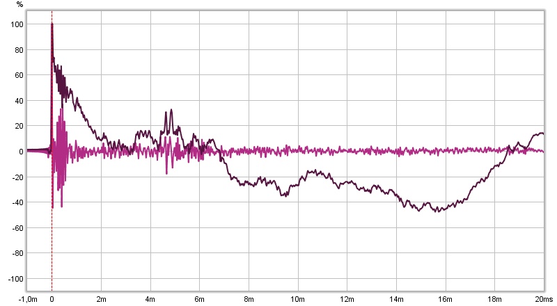

Mark, I don't think you got what I was saying, let's see it in graphs:
IR result with global EQ to get the magnitude flat:
Now let's run that trough DRC-FIR:
FIR allows change over time, not the same bump at a certain frequency that always stays the same over time. This is set to minimum phase though, within the DSP solution, computing wise. These two IR's sound quite different, even if the magnitude would be set the same.
You are not correcting a single crossover-less driver here, you have a whole bunch of them. They arrive at slightly different intervals at the listening spot/area.
See how the reflection at 4.5 ms is still there though? But the impulse has been turned back to it's original shape, instead of the diffuse top end of the IIR EQ magnitude correction by itself. This isn't room correction. It is correction of the drivers to act as one.
Not unlike a multi way, this correction isn't a fix for every position, but not fixing it isn't a valuable solution either. I do choose a distance and averaging multiple measurements can make it optimal over an area. Move up/down or left/right and you still get the benefits. Move far enough away (not a valid option in my listening space) and things might not be as optimal anymore, but it would still be way better than not adjusting it at all.

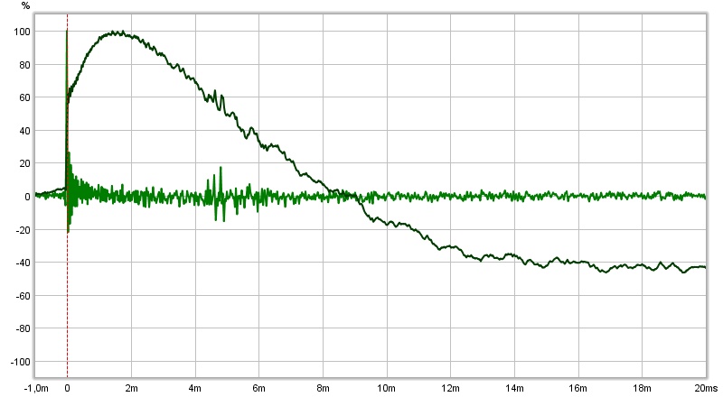

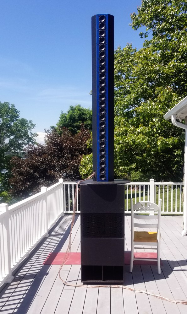

Today, for grins I put a straight array on top of one of my subs out on the deck. Crossed them at 100Hz with a linear phase LR72, because that's the low-pass in place on the sub.
I used the same indoor FIR file built off the average indoor measurement last posted, albeit with the HPF added.
Sounded pretty dang good for a quick throw together 😀
What was fun was trying some simple steering... I curved the top of the array to an 18ft listening distance radius, and the sound which was at ear height shifted to middle as expected. Then I amplitude shaded the bottom up, starting with -2.5dB to 0 shading at the top. Sound image climbed to the top section nicely....way up there!
