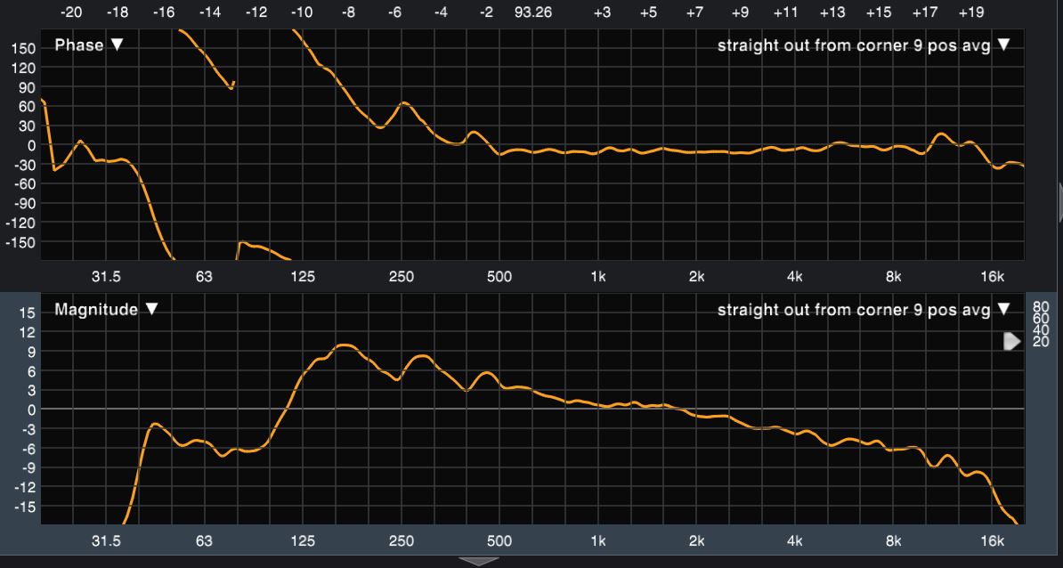

b. averaging has really worked.
I've settled in on a 9 position average, comprised of on-axis and +/- approx 30 degrees, taken at about 1/4, 1/2, and 3/4ths of the array height. About 8ft mic distance....mic distance doesn't matter a lot to the average (within +/- a few feet.)
A raw average of the speaker out in the room is below, one that I'm currently using for the FIR file correction.
I'm only using full octave correction, which keeps sounding the best.
IIR would really work fine imo, no real need for FIR other than the ease of automatic EQ built in the FIR generator.

I like the sound of the arrays moved out of the corners the best, more open sounding. Like Nvphotos said his 'White Whale' thread.
Measurements are much nicer to work with too, as I haven't yet used enough absorption in the corners to tame tuning needs.
I would keep the lines out of the corners but bass simply becomes too anemic. Sustained bass notes are ok, but dynamics aren't there.
x-max rears it's head when trying to eq bass response up to the needed level. RHosch, I think you are going to be happy with your ND105-8 inclusion.
c.using the same EQ, the same FIR files, as the straight array has whether in the corner, or out in the room....
