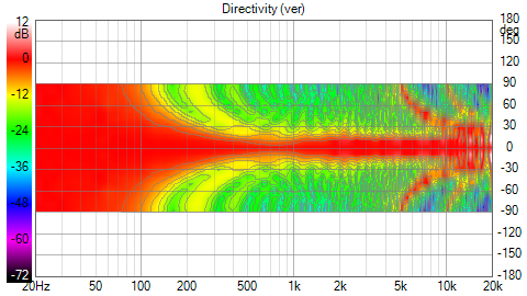

The reason I wanted to use the auto-eq/mirror filter because in looking at polar charts, it appeared that normalize might be emphasizing the vertical sidelobes in the HF. Looking at them now, I don't see much difference in the sidelobes but I do see a more intense and uniform mainlobe, compared to the manually equed mainlobe.
attachment.php
Yes, normalize is equivalent but learning how to create mirror filter was worth the time. I'm not sure what my workflow will be when I have a real array to tune but that might be part of it, at least for a quick start.

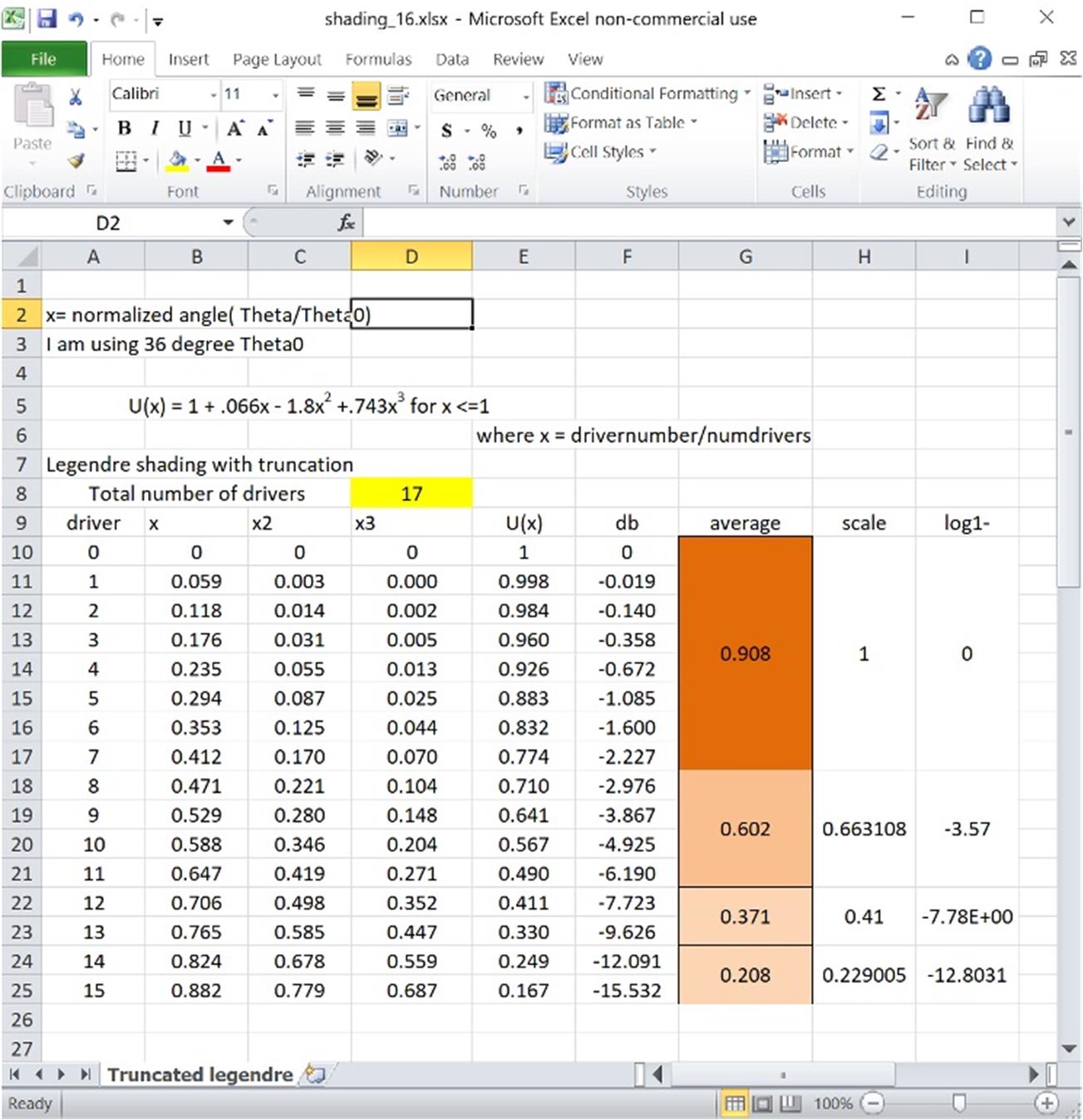

Would appreciate thoughts on shading implementation for a 16 driver CBT array. I would prefer not to use 8 or 16 channels of amplification, even 4 channels would not be ideal as this will actually be a 2 way array similar to the CBT36. And the ultimate goal is for a multichannel system... so 8 or 16 or 32 channels per speaker times 7+ speakers...
Well, hoping there is a more practical way. Would be willing to dedicated 2 channels for the 16 woofer column. Using a mix of otherwise identical 4 and 8 ohm drivers I can work out shading to follow the Legendre curve pretty closely with as many as 8 steps sparingly using a power resistor here or there. But maybe that isn't needed.
How would you guys approach passive shading of a 16 driver column? I have debated whether to treat it as a 16 driver arc (top driver down 40dB) or an 18 driver arc with top two dropped. Is there a straightforward wiring scheme for groups that I am overlooking?
The tweeter column will use 48 drivers, 3 for each woofer, and i assume that once I solve the woofer column scheme I can duplicate it fairly closely using 3 tweeter groups.
Thanks.
I posted a spreadsheet earlier in this thread showing several options for 24 driver shadings. The methodology can certainly be adapted for fewer drivers. Chances are you already have your own.
Typically the first two groups can be done w/o resistors; just by series paralleling differently per Keele papers and Griffin thread, then resistor dividers for remaining groups.
I would do 16 drivers as 8,4,2,2.
I would start from a larger array - 18 or 19 - and truncate down to 16 where the weights get small.
With reasonably efficient drivers the R's are no big deal except for the inconvenience of having to put them somewhere, which is less inconvenient and costly than the multiple amplifier alternative. Yes there is a slight frequency dependence of weight due to driver Z variation but its small if you use both a series R plus another R across the drivers to swamp their Z.
How many groups do you need? Jim Griffin was satisfied with 3. Keele has done 5. I doubt you need to do more. Vituix can model the weights and show you the resulting vertical directivity, allowing you to optimize/compromise sensibly.
I read the thread and saw the spreadsheet mentioned but didn't actually see it. Will go back and look for it. Thanks.
Downloading vituix now to start learning.
I may use two amp channels for the woofer column simply for power requirements but not certain of that.
I think I will truncate the array. -40dB seems a waste. Even the next driver at -24dB is doubtful whether it contributes substantially to the steering. 18 truncated to 16 seems most reasonable.
Although my current xsim 8 segment curves do look pretty. 🙂
Thanks again.
Here is an update on my spreadsheet modified for 16 drivers.
I added the refinement of scaling the first group to exactly 0 db.
Truncating from 17 instead of 18 worked out better in that the second group came out to -3.57 db which is what you get using the Keele/Griffin series/parallel connections of two groups with 2n and n drivers respectively.
attachment.php
  • shading_16.zip
    shading_16.zip
