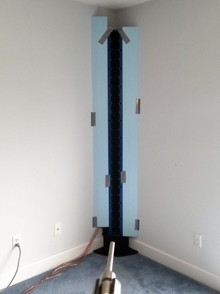

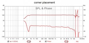

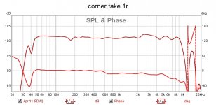

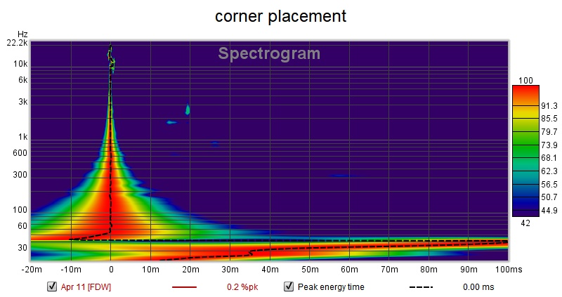

Anyway, with regards to the floor to ceiling corner array, I have been doing most testing in a normal 8 ft ceiling room with smoother side walls and less furniture etc.....as pictured below. Sorry if the big room pict led you to believe all my impressions have been coming from that placement alone.
I'm really not all that concerned with side wall reflections right now, as I know that's just a different form of "floor bounce" so to speak, and is something I know how to filter out of measurements.
That said, I'm not a fan of FDW for such filtering (throws away too much info imo). I prefer averaging multiple measurements, or better, a moving mic that can track group delay as mic moves. Smaart is a very capable measuring tool if you're unfamiliar with it.)

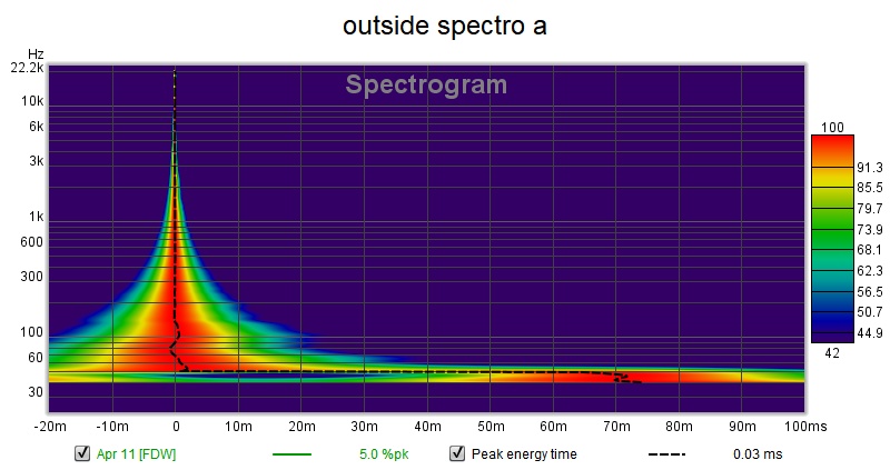

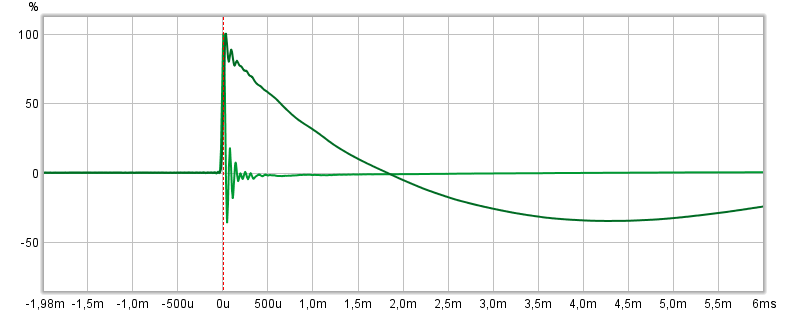

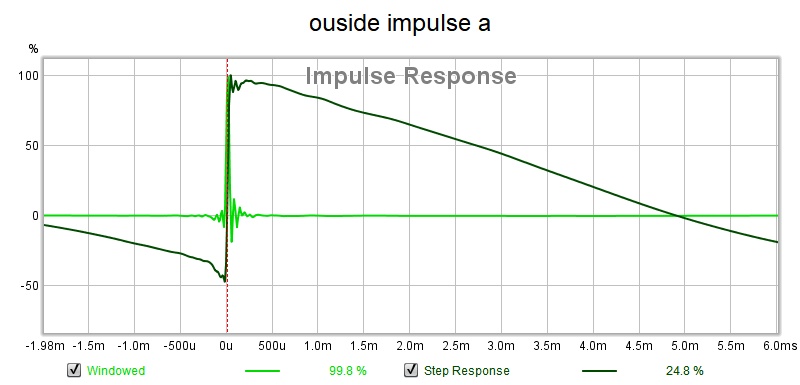

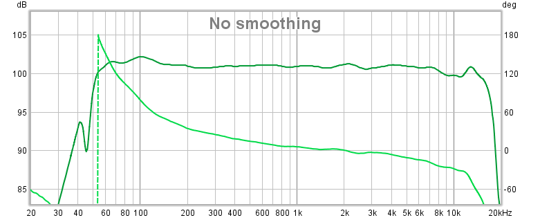

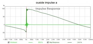

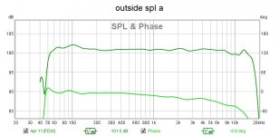

A quick moving mic measurement is below, as well as one of a close miced single 4 driver section.
What I'm really interested in, is seeing how well the 'infinite line theory holds up 'floor-to-ceiling in a corner.'...particularly how high up in freq the theory appears to work.
Stepping back to the big picture game plan..... as always, my goal is to first separate speaker from room, then separate those two from how the line-itself interacts with room.

I don't know which frequency dependent windows you have used so far, there is a big difference between the implementation of it in REW compared to the one used in DRC itself to do it's processing with.
Any work done with EQ with longer windows or even waving the mic is "letting in" part of the room itself without any regard for 'timing' of that first wave front. A lot of measurement points averaged could get you closer to the true speaker IR though and keep actual phase data.
But if you let back in the reflections in the actual listening session(s), it will still have it's way with the outcome and color its sound in many ways. These aren't horns that avoid the room. May it be for good or for bad.
All phase wraps in ra7's measurement point back to something happening in the room, if you gate it before reflections happen, they will disappear. Or if you look at it with a frequency dependent window, it will disappear as well.
Looking at that picture with the much cleaner wall you showed, I still see the transition from that temporary wave guide to that wall. It's like a horn that changes shape midway. Like it or not, it will also determine the outcome. The more gradual it will flow, the less detrimental it will be. Right now it is at the same distance for all drivers, so it does not get filtered out by the array itself.

An array as measured outside still resembles a finite array. It needs to have at least the floor and ceiling to be able to "mimic" or come close to an infinite array. So that's why I keep hammering on the limited use of taking the outside measurements as a reference. You don't "see" the array as it was ment when it's outside, at least not how I like to see my favorite kind of array.
The frequency dependent window is to separate the frequency data of the first wave front that 'hits your ear' from the rest of the room response. My specific window is as short as I can get away with in the mid frequencies and longer up top to account for the delayed arrival of high frequencies (from the upper and lower drivers). That specific view gets "corrected back" to an ideal (well almost) IR by DRC. The window is no longer than needed to 'look' at what the speaker has done, from a listeners perspective.

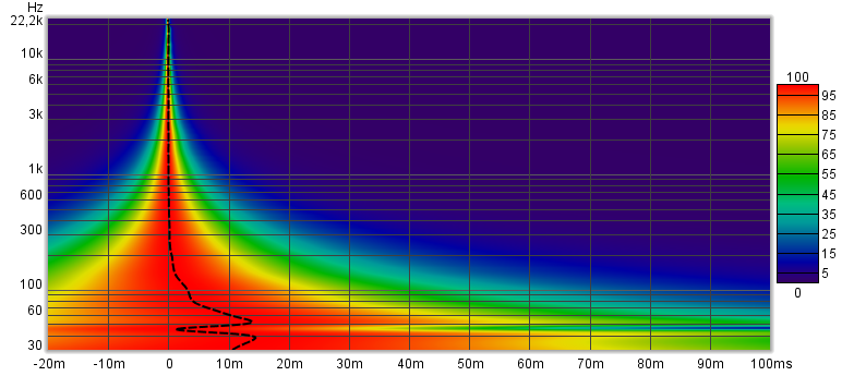

Try and correct an array to flat, at a single spot, with an early waterfall graph as your guide line until it looks somewhat like this (at listening distance):
If you have a waterfall like that (ain't going to happen without support from the room *) then open the correction by itself, doesn't matter if it is consists out of IIR EQ tweaks or is FIR based. The example here is FIR (minimum phase above 500 Hz) with (P)EQ applied afterwards.
If you open that correction curve by itself you'll start to see where combing becomes an issue (at that distance). You'll start to see excessive peaks (compared to the other correction tweaks) in the correction curve that points you to the combing dips. That's when it will become clear to you there actually is combing happening and at what frequency it starts.

All you see with these phase wraps and arrays is a form of interaction. The most important part though is when those wraps start. Not the fact that they are there. The more you avoid those reflections, the less wraps you'll see. I have them, those wraps, but can get rid of them in my processed top end if I gate before the first clear reflection (that I didn't quite get rid of, due to restrictions set out by my sweetheart) at just over 7 ms.
Meaning I have ~7 ms of reasonably clean top end phase behavior (at the listening spot).
Unsmoothed:
Graph posted earlier on an APL_TDA thread...
Now go back and look at how long those high frequencies really last. By the time 6 ms have passed, we already got a clear picture of that top end, as needed for placement and imaging. Tonal balance might still be a "work in process" in our head though. As that perceived balance also determines how something sounds. Which is why you couldn't EQ out a room if you wanted, as our head simply analyzes what parts that neat frequency curve exists of. Arrival timing being a definitive part of that analyzing.
Don't fear the wraps, but keep an eye on why they are there and especially when they form. I can set quite a long FDW when in cycles mode while still keeping the phase plot as expected. Meaning my ears get a pretty clear shot at that first wave front, before the room starts to mess it all up. That's something also seen in the other plots I've shown before like the APL_TDA plot or the later REW wavelet variant.
You do remember these are floor to ceiling speakers right? Not a single driver as measured outside, away from boundaries. How on earth could it avoid the room while also reaching your ears 😀. So forget about those wraps for a moment. Set up or prepare the speakers to get the least reflections in your IR till about 6-7 ms or more (goal for me was to get them at least less than 10% of the main pulse). That way it did not cause abrupt phase changes anymore. The first 3 ms clean up being critical!, up to 6 ms advisable to improve imaging, up to 20 ms for nutcases like me.
It gets both easier and harder though, once the early ones are removed.
If you can't get that first 6 ms clean (don't look at the "series" or "train of arrivals" under that ~0.5-0.6 ms mark as that is part of the spread out arrival of the separate drivers in the array. Restoring that, for example with DRC (much easier than trying to do something similar by hand) will even out and clean up that part of the IR. If you have reflections below say the 6 ms mark that stand out, use an average of a few measurements around the sweet spot.
If that average turns out cleaner, you could use that to feed trough something like DRC. That is, if you're willing to try that route. If done in 44100 format, just get me the IR and I could return a FIR. Try and keep the measurements centered around the exact sweet spot though. We need at least one fixed position to focus on. The exact sweet spot could help us maximize the imaging and balance.
If all goes well, I can assure you you get to keep a very neat result in a large area. There are enough people with arrays with great results that didn't go as far as me with early reflection control. Averaging has helped a lot in those cases to get it more consistent. Once you have the IR a bit more in shape, the next step would be to start looking at slightly longer and different windows for tonality. That could include the moving mic technique if you already know what the target should be. That is a whole other part, that also might differ from what you're used to with the other speakers. Room interaction with the arrays is going to be different, so the preferred balance might be different too. This balance is one of the most important parts to find, when drawing your own frequency curve. It can really make the difference between good and great. Throw in mid/side EQ and I'll still be typing this reply next week!

Mark, referencing post 122: if the third image is your measured FR in front of the arrays, then that is the sound you are going to hear, which is to say it is not going to sound very good. First, I would get out of measuring exactly on axis in the corner because it will introduce a cavity dip from not having the drivers all the way in the apex of the corner. I would measure closer to your listening position and try to adjust the response close to a B&K curve with all the sound included (no FDW or any other filtering). Try that first and see where it gets you.
I would not get too hung up on REW's phase response. Sometimes I go back to Holm to see the phase response because what I get in REW does not make sense. Anyway, phase response is not so important for this design, so, don't worry about it.
Also, what is the red trace in the magnitude chart?

wesayso, I'm seeing what you mean about the side wall reflections needing to be eliminated, particularly from vertical ridges running parallel to the line array.
Yesterday, I started to get semi decent looking tuning from the corner placement, but with alot of chaos at certain frequences looking at Smaart's live transfer. And REW's spectrograph would show disjointed activity at those chaotic frequencies. So I went outside and the chaos ended....and then I knew to start playing with the room. REW's spectrograph has been really useful finding the reflections.
I have a foam topper and sleeping bag on the walls next to the array, which also has the foam board wings in place.
Attached plots are below. I feel like I'm beginning to get somewhere.
Biggest problem is that REW doesn't like Smaart being around in my 'puter even after I close it....I get pops during the REW sine sweep, and phase goes truly wonky, until I go through a full reboot process????
ra7, those plots in post 122 were raw response without any tuning.
At that time i was just trying to understand combing in light of the 1/2WL "rule of thumb" and corner placement.
The red trace is coherence, or how good the data is in terms of output matching input signal. It's a great indicator of how much of the room is getting into the measurement, or multiple signal sources.

Mark, can you post the "tuned" in-room measurement?
Also, those graphs you just posted have massive scale. Can you post the first graph with a 5 dB per div scale and from 20 Hz to 20 kHz?
Hi ra7, that was the 'tuned in-room' measurement ....
here it is as requested 🙂
Hi all, me being me, I had to try to try a quick tuning session outside...
here's a few graphs
I'm going to listen outside the rest of the day.
Then tomorrow, I'll listen to how that tuning sounds indoors in the corner, using only high and low shelving to adjust tone.
That's kinda my standard operating procedure.
I'd like to compare that SOP vs specific tuning to a spot..

here's a few graphs
Will report listening impressions
...Will report listening impressions
Hi Mark while that flat phase at lows looks you probably prepare for a linear phase XO point to a sub down the road, in meantime will think without that sub sound from line should be much better and natural 3d when phase is minimum rule as below 🙂
Hi BYRTT, yes, you correctly anticipate I plan a flat phase tie in to a sub.
And you also raise one of the most interesting questions around imo.....that being, what type phase sounds best down low?
My current opinion is that it depends on how a recording was made....
I think if made on flat phase sub monitors, we want flat phase tuning.
I think if made on min phase monitors, min phase tuning...
I mean, kinda simple really...other than how the hell was it actually recorded, ie how many min phase orders of crossover were used, or is it an enlightened studio using lin phase??? haha 😕
But for me, I hear so much extra bass definition saying 'goodbye group delay' hello flat phase, I don't care anymore. If a song was recorded with excessive group delay, well, can't win em all.....most songs rock flat phase to my ears
I really believe ditching min phase down low is part of the new magic coming to us all...
Have you seen the new breed of monitors like Meyer's bluehorn? I'm in 😀
See, like i was saying to ra7...a lin phase zealot
