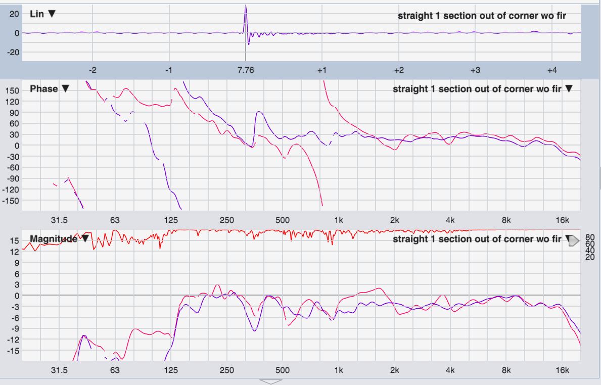

Could you post the frequency response of the block of 4 drivers compared to the "full Monty"?
Here you go Art,
One 4-driver section (3rd section down),
raw measurement taken with array in the corner (red), and out 2-3ft from corner (blue).
Mic was only about 6ft away before I ran into pool table, so floor bounce around 360Hz.
So far, I'm not a fan of corner placement.
Freestanding, out of the corner a bit (kinda like the picts of wesayso's rig) has been making for better measurements and sound.
What's interesting and I don't yet fully understand, is why a phase wrap pops up when put in the corner (820 Hz in this plot, changes a bit depending on particular room corner, but always pop up once in corner).
I'm guessing the phase is the sum of the drivers output with corner reflections, which would increase the effective focal distance some, and make for more time lag...?

That response looks quite good for just four drivers, +/- 3dB from around 140 Hz to past 16 kHz. My 6 driver units may be OK with no EQ.Here you go Art,
Your corner phase wrap guessplanation sounds reasonable to me, though surprising that the upper octave, where the driver dispersion drops to only about 45 degrees would also show the same response as below. It would be interesting to see/hear what happens with "waveguides" (or pillows) from the edge of the drivers to the walls.

One quick question about your downloadable measurements.....
the phase traces...normally, when I see alot of phase wraps, they get cleaned up when constant delay is removed (estimated IR shift).
Your files appear to already have been shifted, but the wraps remain???? I've never seen that before.
I see that FDW removes the wraps, but I don't know REW well enough to understand what is going on..

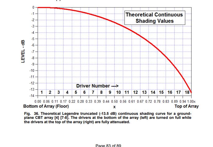

One suggestion for mark100 is to vertically amplitude taper the CBT version to approximate a Legendre roll-off across the speaker's aperture. Assuming 6 banks of 4 drivers each for 24 drivers in his stack, I suggest that the bottom three banks (call these banks 1, 2, and 3 from the bottom upward), which are the 12 drivers closest to the floor, operate at full amplitude--say 0 dB reference. The next highest 4 drivers (bank 4) should have an attenuation level of -3 dB, then bank 5 a level of -6 dB, and finally bank 6's 4 drivers produce an level of -12 dB.
Don Keele uses a similar attenuation taper--albeit three levels--for his CBT24 speaker which uses 2.5" diameter drivers. My Modified CBT24 project follows Keele's suggestion and my speakers exhibit great sound in my listening room.
Thx Jim,
I've been planning on applying shading via the curve in PE's CBT36K assembly manual...which at quick look appears close to your recommendations.

re' weighting
I would recommend taking the series approx to the Legendre curve, dropping it into a spreadsheet, and computing weights from there.
U(x) = 1 + .066x - 1.8x2 +.743x3 for x <=1
where x = drivernumber/numdrivers, starting x=0,1...
Doing this, you'll want to truncate the top few drivers For example, compute the curve as if you had 28 drivers then judge that the weights of the top 4 are so small you might as well drop them from the array. I did such a spreadsheet (attached) and with truncation, the weights Keele and Jim Griffin used started to make sense.
So convenient to just drop the weights into your DSP/amp gain. You also get to experiment with frequency dependent weighting so as not to lose any of the volume displacement needed at the low end.

re' weighting

re' weighting
Waay cool spreadsheet, thx !!!!
(who/what is JR 3&4 step?)
It will be very convenient to drop into dsp, indeed!
