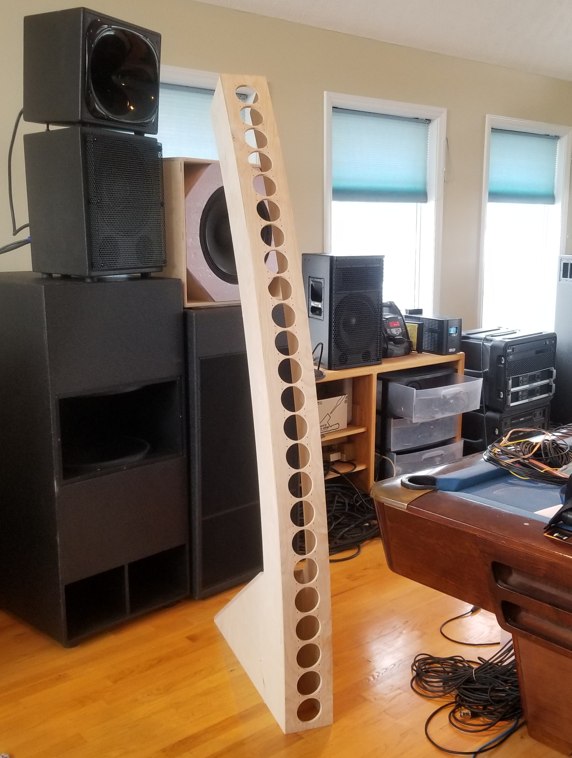

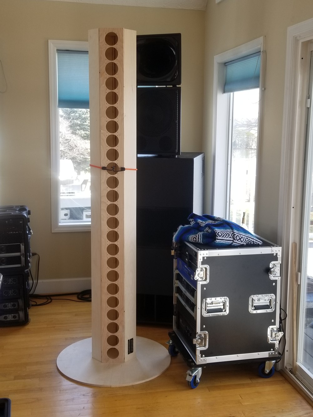

Projects are going pretty smoothly.

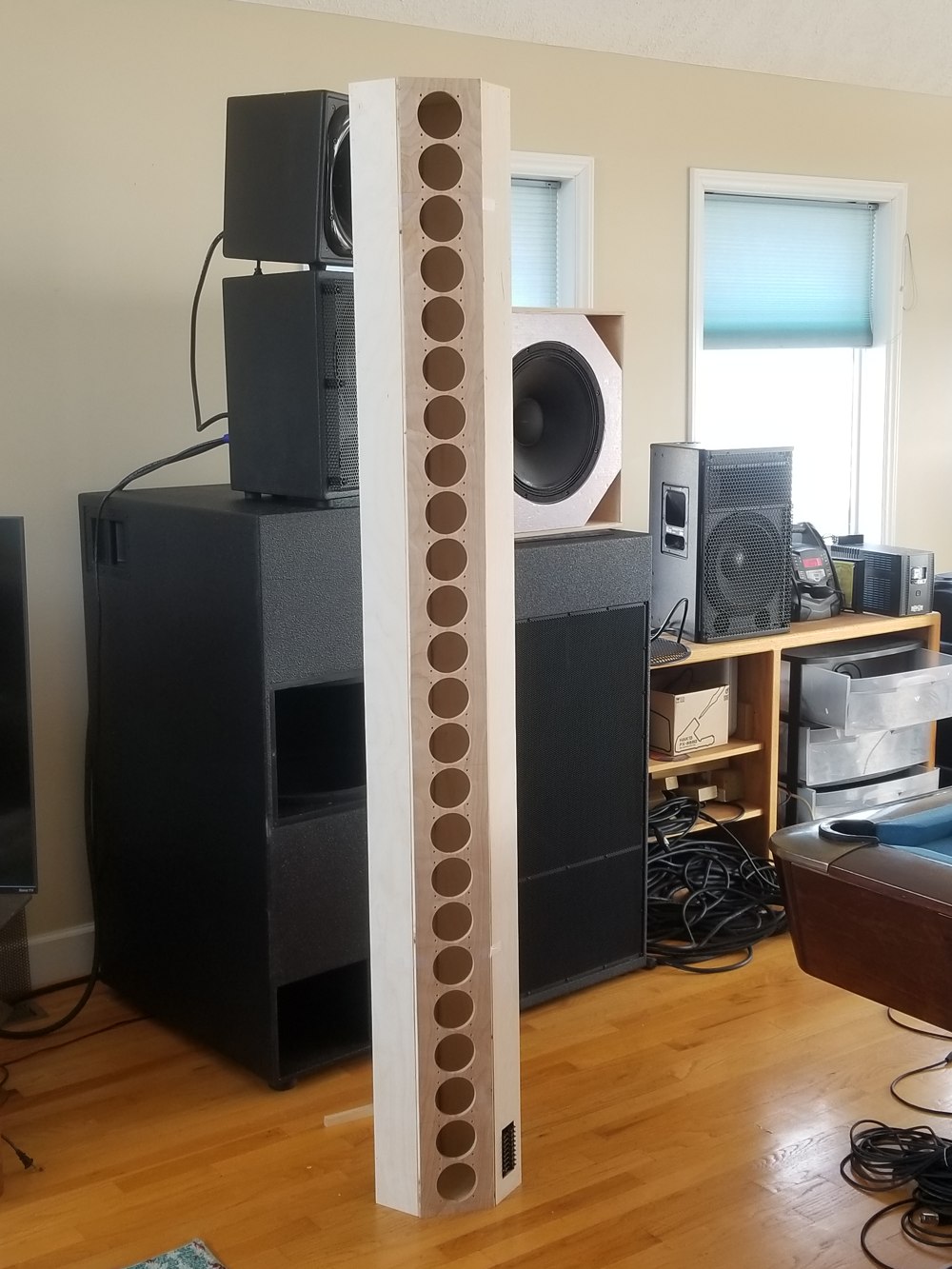

The only real surprise has been how much more difficult the straight corner box has been to plan, cut, and glue ..than has the CBT. It's hard for me to keep the relatively narrow, 7ft long, pieces for the straight box true all the way thru glue up.
And I must admit, I got a little overly confident/tricky with the interchangeable driver baffle. Ended up missing the baffle width for the straight line by needing to trim 4mm width. Fortunately, I knew to complete the straight box first, as the overall design makes it very easy to trim the CBT's width to fit the baffle. It does look like the removable baffle is going to work fine...I got lucky I think 🙂
I needed to slow down and figure out removable base plates, to get the proper t-nuts or inserts into the boxes' bases before assembly.
The big circle in the attached pict is for free standing straight. I'm making a big elliptical base for the CBT. And I still have to make a straight base for corners, where the room's base and show molding won't let the box snug to the wall. Oh, and straight box needs a handle(s) like a PA box.
I'll be glad to get the boxes done and painted so I can move on to assembling the driver baffles.
A few iron out details remain...
Perhaps the biggest...despite a lot of searching, I still haven't found a gasket/sealing idea for the TC9's (used front mounted).
Any easy recommendations welcomed !

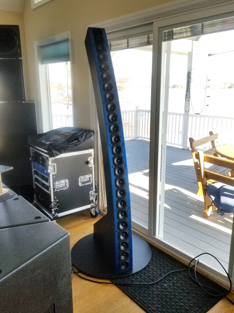

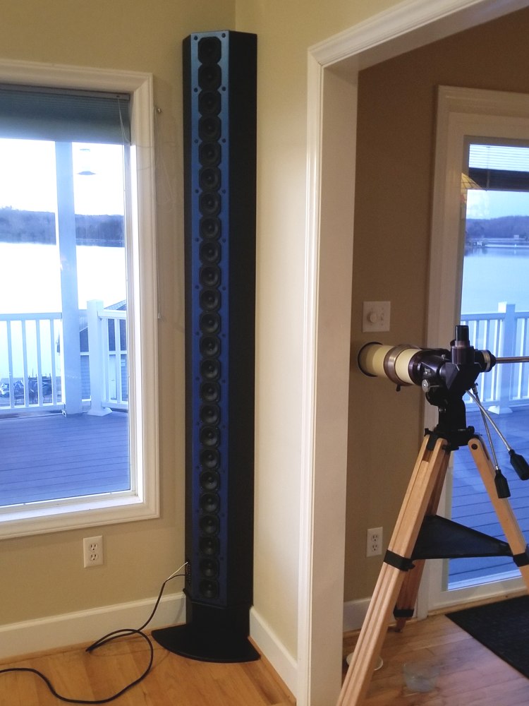

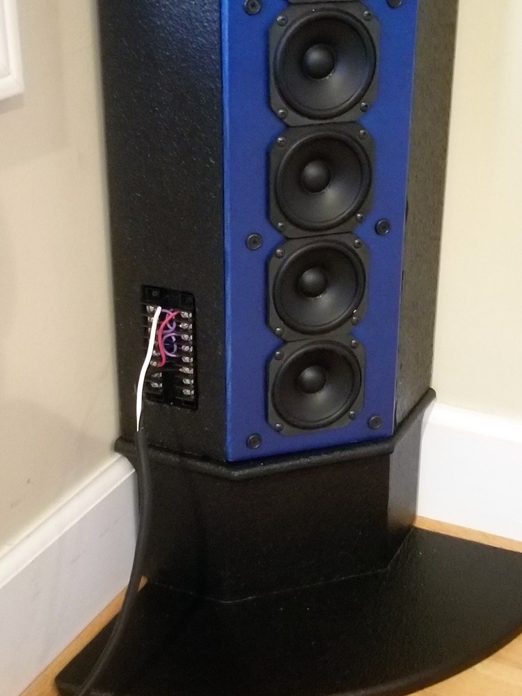

Happy to report the straight/CBT line array project made first sound yesterday. (It slowed down a little because I spent 5 days going to a Rational Acoustics class for making measurements with Smaart..wonderful experience.)
Anyway, I put the first finished driver baffle into a straight-line box, with a base for corner placement.
The Murphy clone seems like the simplest way to begin learning about the arrays, as no shading or delay are involved.
Fired it up with all 24 drivers hooked together to provide about a 5 ohm load. All seems to be working well 🙂 Played with a little high and low shelving, but nothing else yet. Gonna finish all the boxes and the second driver baffle before any further tuning.
I'm already loving the terminal strip breakout for driver connections, which has ended up with connections for 6 groups of 4 drivers each. It's so easy to change configurations....
Decided to try o-rings for sealing the drivers to the baffle. Made them out of 1/16th o-ring cord. Mounting the drivers and wiring them has been easier than I expected, yay!
May get a CBT version fully done today.
Can't wait to measure these things and start tuning..

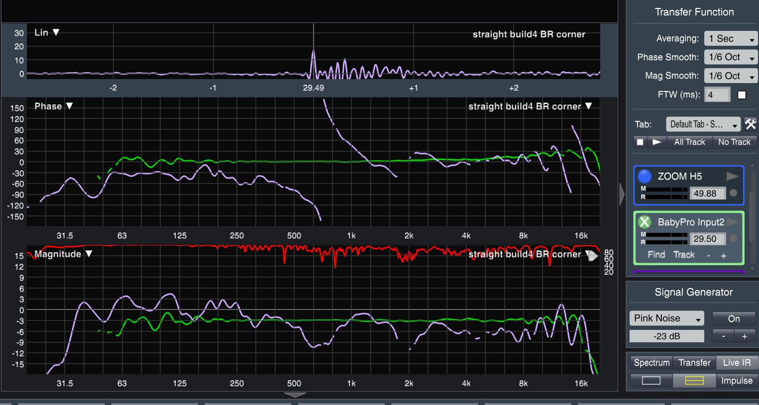

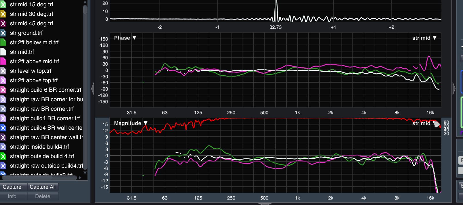

True to my often stated outdoor tuning preference, I took the straight line outside yesterday and made a first stab at measuring and tuning.
The first graph below is raw response (blue), and then tuned response in green.
Tuning goal was flat mag and phase using 2300 taps of FIR. I really needed quite a few more taps down low, but the 2300 setup made for a very handy first try.
So far, I'm not sure anything can smooth the high end above 8kHz....lots of interactions going on up there...as in 24 drivers worth LoL.
Second graph is the tuned response (now green obviously)
and its measured response (light purple) in a room corner that has 8ft ceilings.
I've tried putting the speaker in the corners of a few different rooms. At this point I'm not so sure what to think about the clear number and size of the interactions with the corner walls. I'll probably try freestanding moving out of the corners some, and maybe in the middle of walls next.

I think the impulse ripples after the peak impulse come from two causes...
first, the multiple drivers as per ripple seen outdoors. The ripples peaks are about 0.07ms apart. The impulse you see posted is just Smaart's quicky live IR. Better measurements are from the fullblown IR measurement section. I need to study them before any real conclusions, though.
second, I think the multiple drivers' outdoor ripple gets amplified when put in a corner.
Indoors, I tried driving just one block of 4 drivers and impulse really cleaned up vs all 24. I then took a pillow and tied it in front of 3 of the 4 drivers...even further cleanup (as we would expect I guess)

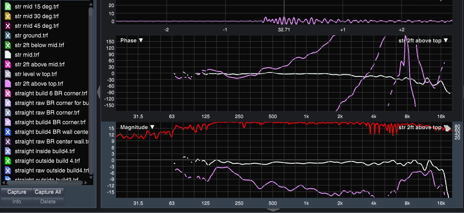

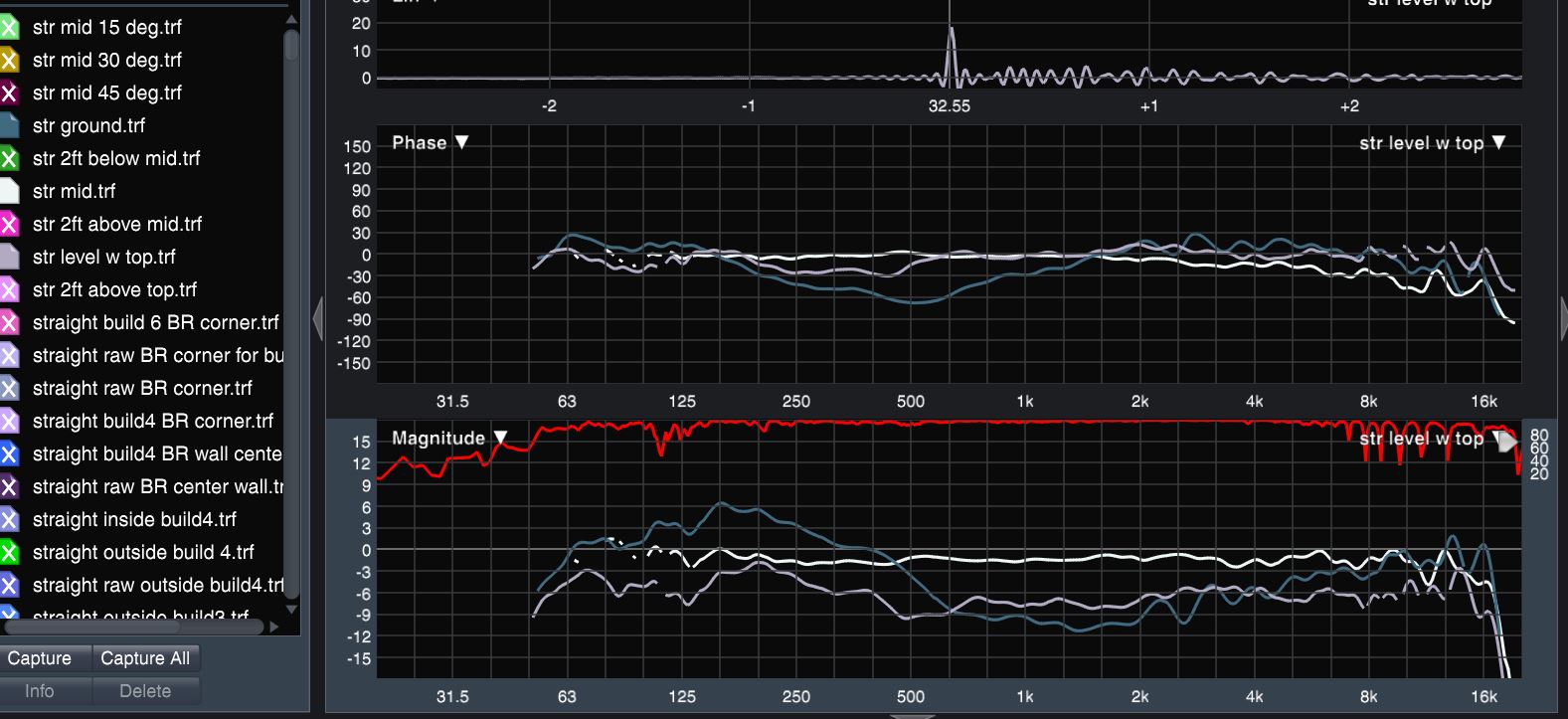

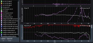

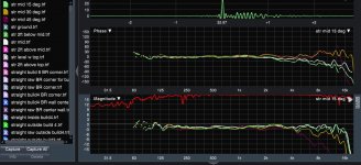

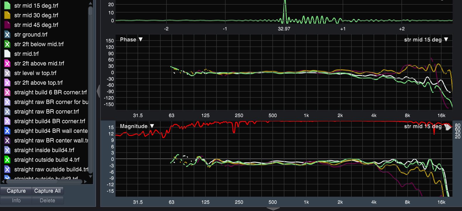

Thank you Art !!
I've been making measurements at only about 4m, since this is an indoor project mainly. Line is about 81" tall.
I've attached a few plots..
First is mic at mid (white trace) of line, and at plus 2ft from mid, and down 2ft from mid.
Second is mid again, with mic on ground, and even with top of line.
Third is mid again and mic 2 ft above top of line. Couldn't even find an impulse peak haha
Last are some quick horizontals with mic at mid....15, 30, and 45 deg off-axis.
Sorry for not including trace colors in the above descriptions...hopefully it's easy enough to glean from trace panel.
