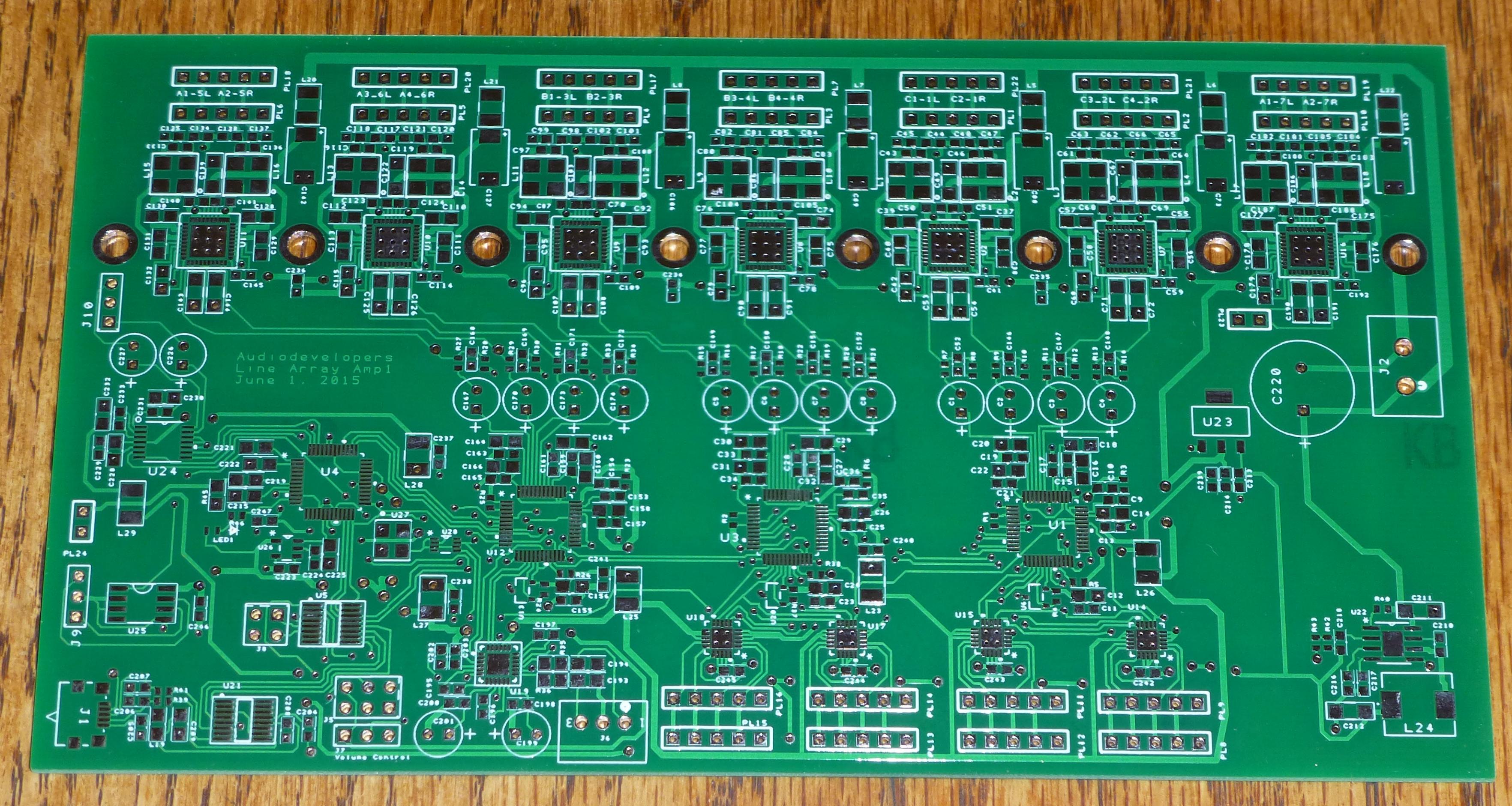

I've been dropping hints in various posts that I might be interested in updating the 22-channel amplifier design that I used for my line array prototypes, but so far there hasn't been any response. Is this something that would interest enough people to make a group effort worthwhile?
Each board would have 3 ADAU1701 chips for crossovers and delay for 24 channels, and there would be a total of 10 SSM3582 chips for 20 channels of amplification, each at about 20W. There are two additional DAC outputs for driving a pair of subwoofer amplifiers. The delay, shading and crossovers would be controlled via a cell phone app using WiFi (MQTT protocol). See this article for more details: 10. Case study #3: A line array with DSP – Audiodevelopers Reborn.
For me, it would depend. I don't want to build a board but I could easily be tempted to buy one if the price were right. I'm not negotiating, just being honest. I've gone some distance down a different path; already have half the amps I would need for electronic curvature and I'm using PC for DSP. In fact, I would be interested in an 8 channel amp board or two, no DSP, balanced inputs.
I'm also not sure I want to do electronic curvature; with a straight floor to ceiling array it shouldn't be needed. Looking to this thread and perhaps an update to yours for confirmation. But your technology is ideal for shorter arrays, like I might use for surrounds and ambient.
Looking at chip specs, I see the AD family you are using is in the 90 db S/N range while the more expensive solutions I'm moving towards are 10-15 db better. I'm not sure that matters though given the background noise level in my home ( it did matter when I was using a high efficiency CD) and your other features (like wireless) are really attractive.
A firm requirement is for FIR, does your board do that?

How much would the fully done up board and app cost?
I wouldn't try to sell these boards--I'm too old to be soldering boards full of QFN packages.
There is a lot of work required to update this design, and I'm just poking around to see if there is enough interest to make it worth the substantial effort.
